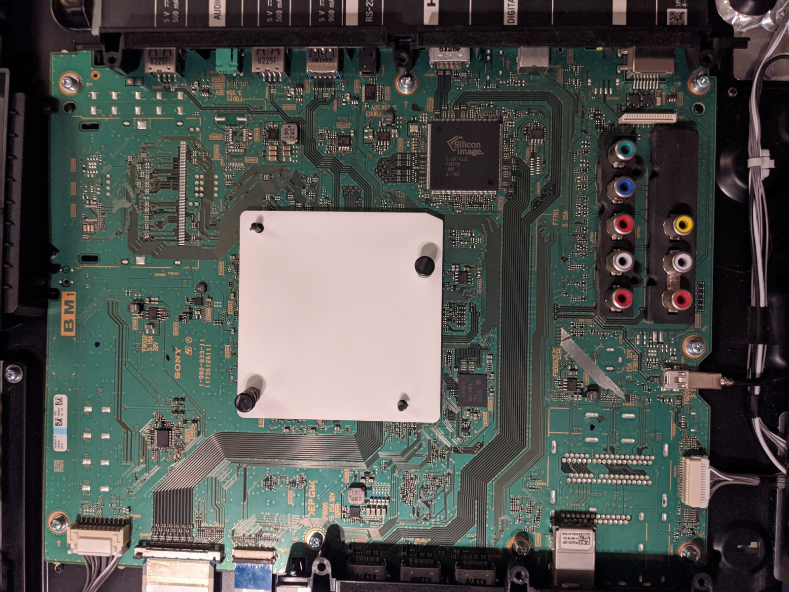

    Upon picking up the tools again and before doing anything else I removed and replaced the Tcon and Main board with the previous ones that were in there originally. Sent the ebay main board back $144, still have tcon $20. So now I'm back where I started but with a repaired power board. Powered on the tv and it goes into what it's doing now, flashing solid red/green/blue/white/black, then vert/horz stripes. It does this endlessly.

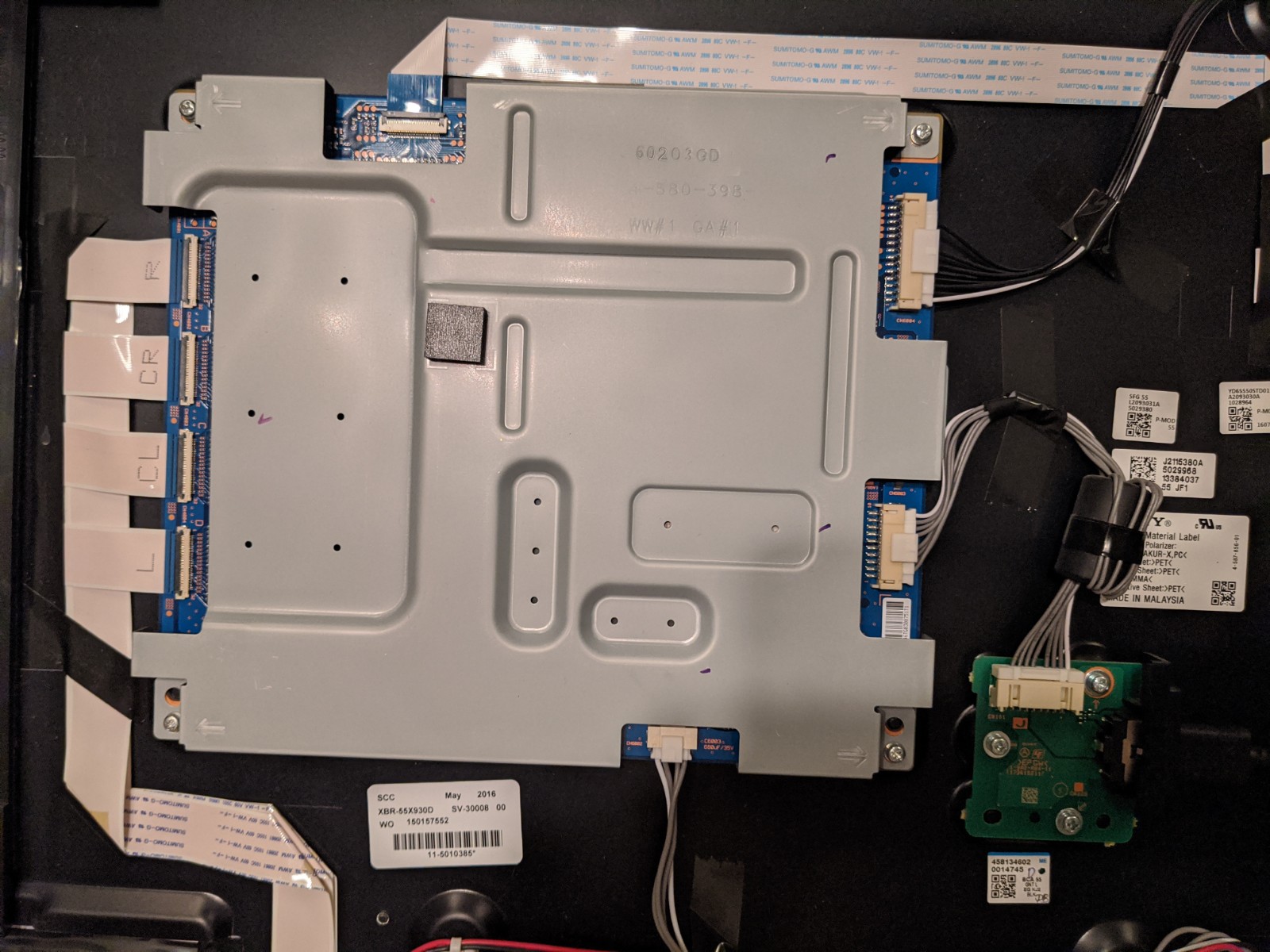

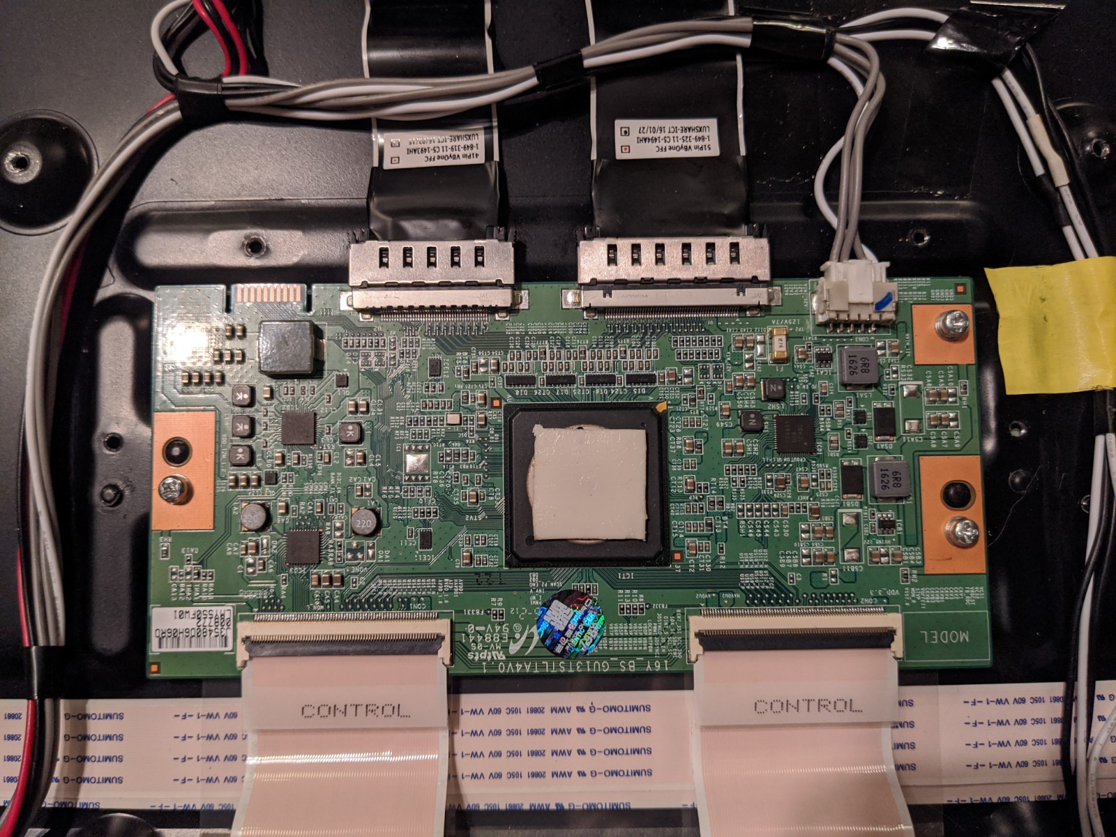

    I have tried wiggling the wires leading to the tcon board to see if I can create some effect that should appear such as flickering or lines or anything at all - no luck there either. This would typically tell me that the tcon is bad BUT I had a second tcon board and it does it with both boards and I doubt that they would both be trash especially since one is fresh off ebay (I realize it could be bad but am saying it's unlikely to be bad.

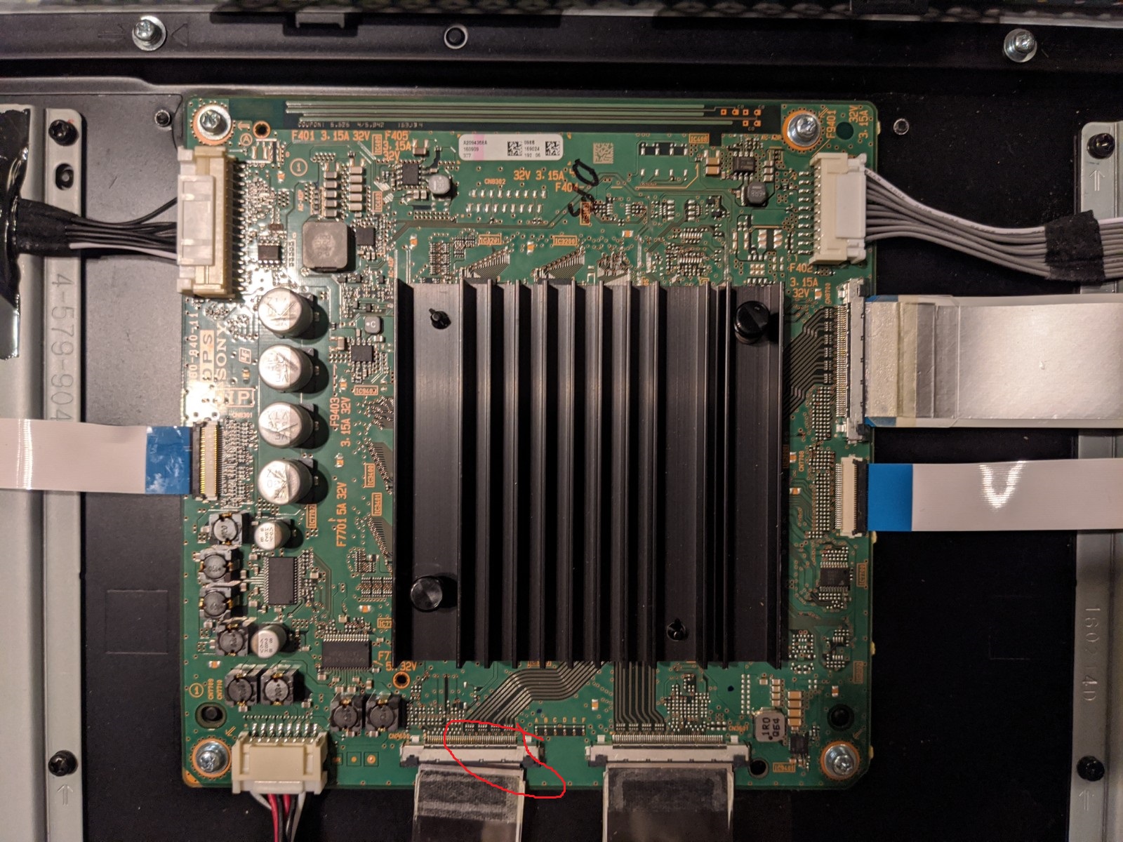

    In the first pic (powerboard2.jpg) you'll see a red circle pointing out that I am aware of the messed up ribbon cable coming off the powerboard going to the TCON board. Rest assured I have wiggled and tugged and given it enough moving around to try to induce some sort of interference to give indication if this is the issue and I can say, even with that ribbon on crooked like that it still functions ok - I mean, unless both tcon boards I have are no good then this should be revealed at this point.
    I have indication via the led turning from white to green telling me a hard factory reset is being performed and then after some time I hear the melodic music in the back ground but the RGB flashing screen persists with NO on screen menu's visible or anything else to guide me to get out of the test pattern or anything useful at all. This should be such an easy fix if only I could get this description of events in front of the right person I think I'd be able to get an answer. Please Help!

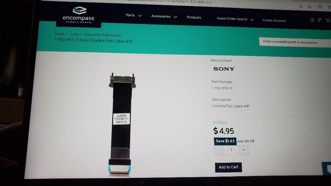

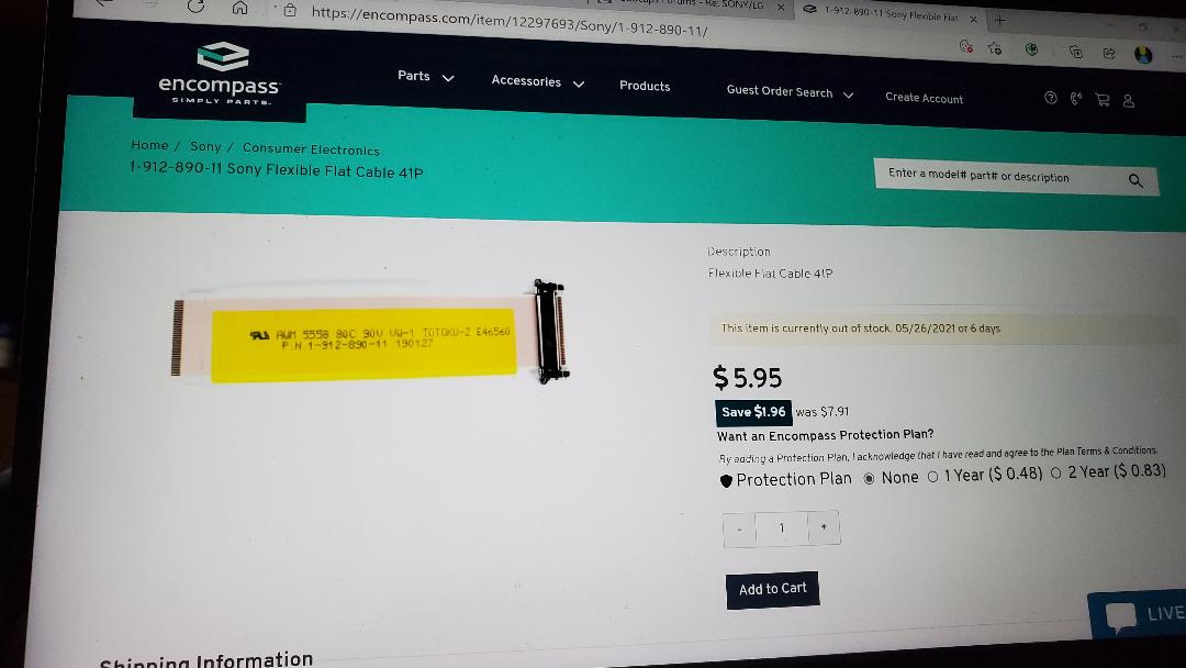

      here are the picture on www.encompass.com

        if you damaged one of the flat white ribbon cables with the blue plastic holders they are harder to find because sometimes they come with the panel before it goes to manufacturing. try downloading the newest version of sony software on usb and plug it in after you turn on tv. Be patient and it will reboot at the end and turn back on. sometimes takes 30-40 minutes so dont turn tv off or unplug when your doing this.

          When you get the color pattern test on a Sony TV like this, it means the T-con is not receiving info from the mainboard. Not because the mainboard is broken but because it's not plugged in. This means the ribbons are loose, or not aligned right. However when that happens the mainboard is no longer paired with the rest of the TV, and you will have to pair it again. In order to pair it, you will have to do what bruce mentioned which is download the software from the Sony website linked below:
