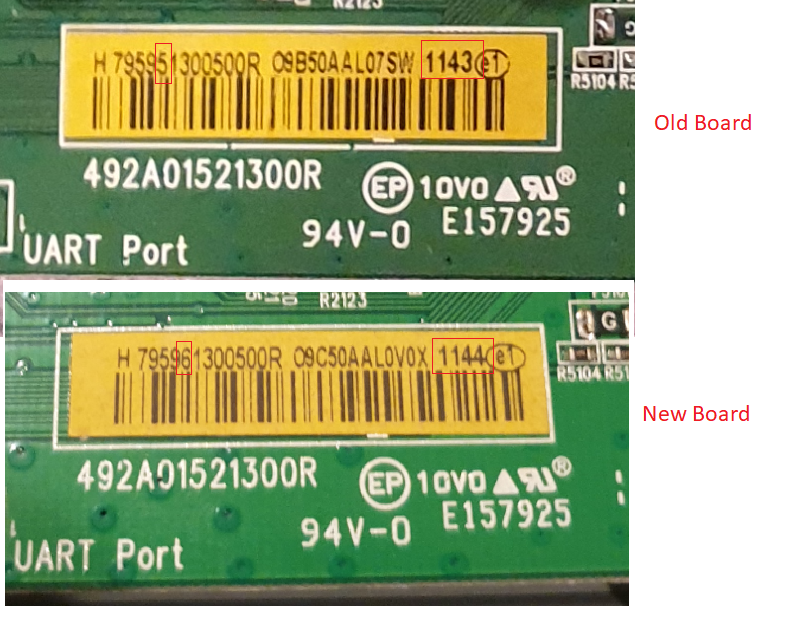

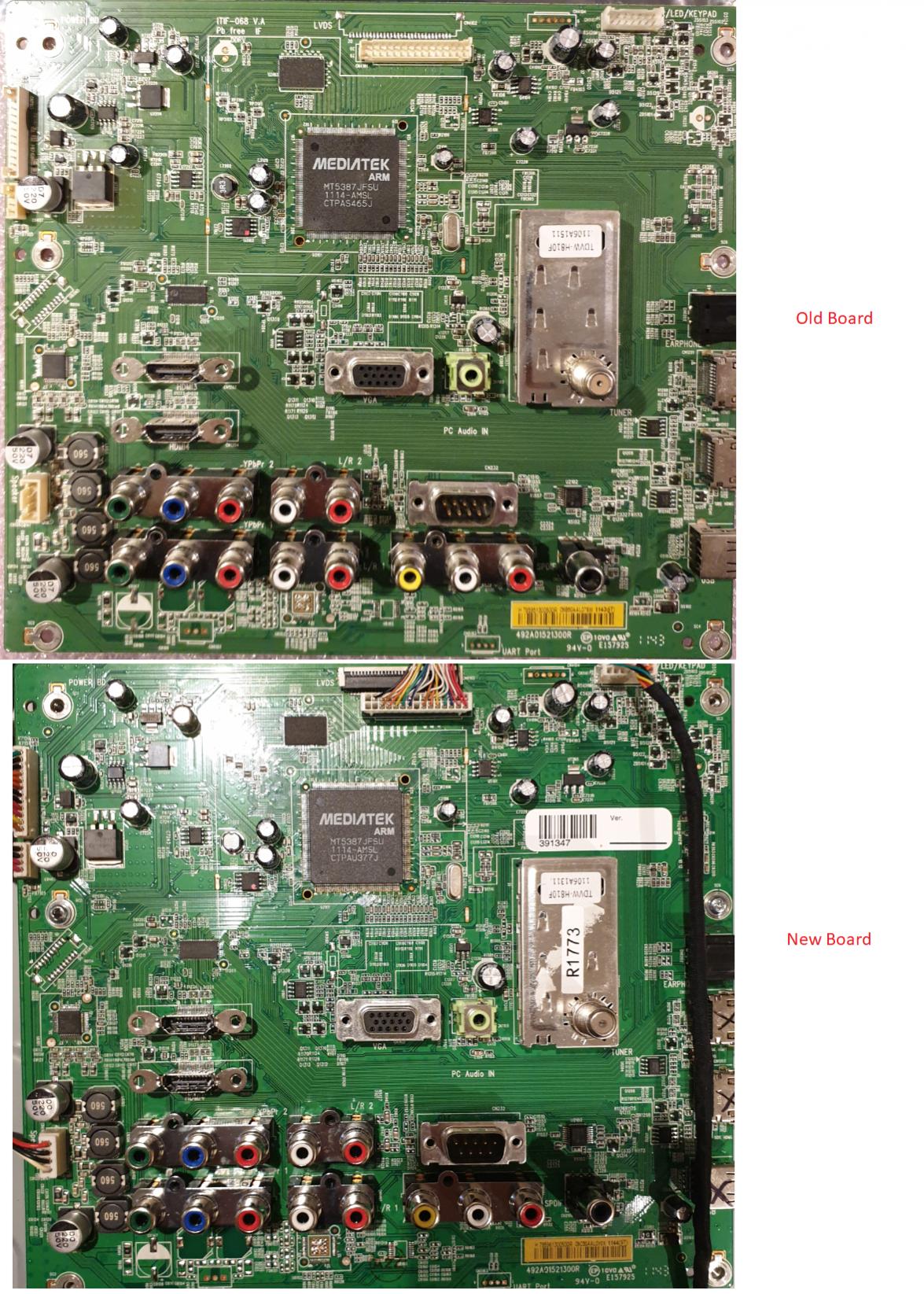

    • Replaced main board. Local supplier only had a variant board in stock. As far as I can tell, this board is used for the TV's smaller cousin (LC-32D59U). It has the same printed part number, but different sticker numbers.

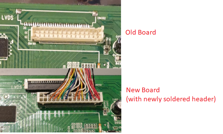

    • I had to buy a new pin header, and solder to the new board to connect the display signal cable.

    • Perhaps this main board is incompatible with my TV? I am playing loose with the part numbers.
    • Perhaps I botched the desoldering/resoldering job? I checked pin continuity and there doesn't appear to be any shorts (with exception of 3 pins that are clearly sharing a plane).
    • Interesting note: I disconnected the signal cable, and the TV responds identically (red light standby on plug in, power button turns on backlight, no signal, no other light indicators).

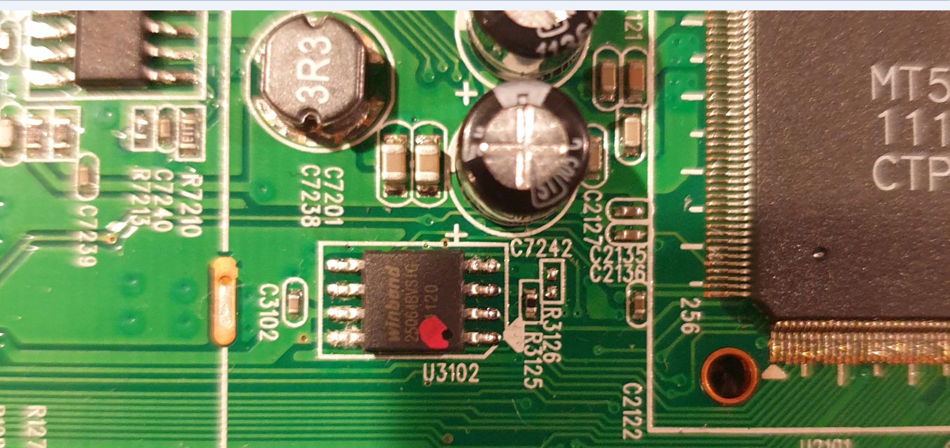

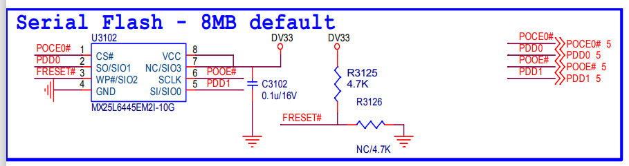

        Depending on what was wrong with the original mainboard, meaning if the eeprom U3102 is ok then maybe you can transfer that chip from old to new board, not exactly sure. Maybe see what Diah has to say, he knows his firmware.

          i think yours MB layout are sandwich boards. not easy to add sockets and no guarantee yours work 100% correct.

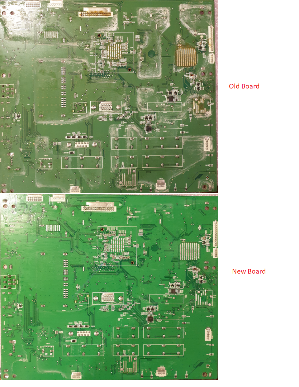

          as suggested by nomoresonys start trouble shooting yours original MB its much easy as you have now the cousin boards for references & Parts.

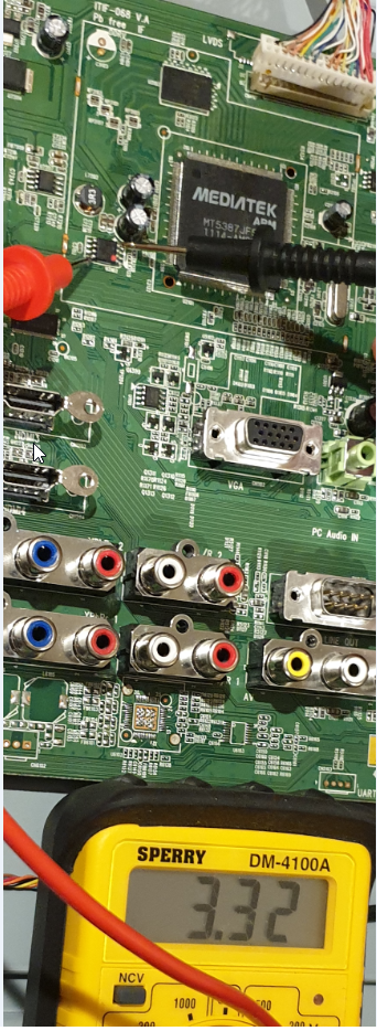

          start with upload photo on the back side of the boards and measure voltage if you have 3.3V on the SPI flash.

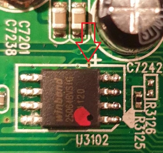

            I found the U3012 chip on the front of the board. Tested both boards and got the 3.3V.
            I'm tempted to simply trying swapping the U3012 chip from my original board to the new board (crossing my fingers the socket soldering is good). Any reason I should avoid this approach?
            Attached are the pics.

                  inspect the point remarked on yours photo.. i guess this is the original boards ... right?
                  some spark near SPI Flash. if this correct, take the Flash and dump it first. you can use the other boards IC to flash it with yours original dump.

                    Diah, the board in that photo is actually the new board. I inspected both boards, and it looks to me like the mark is on both. But it's covered by silkscreen on the original board. It's probably a via.

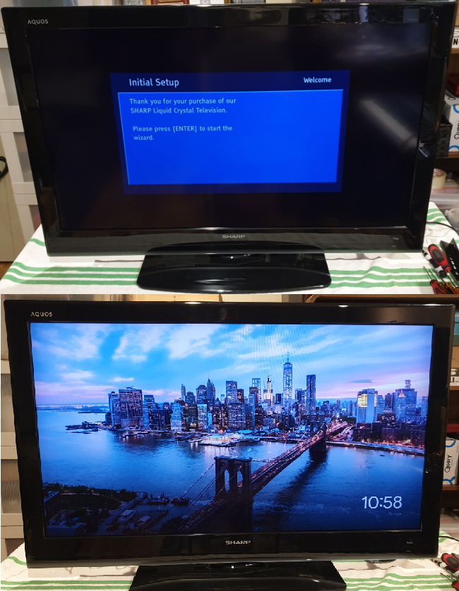

                    Good news gentlemen. Removing the flash chip from the original board soldering onto the new board did the trick. We're back up and running.
                    Many thanks for your support and guidance
