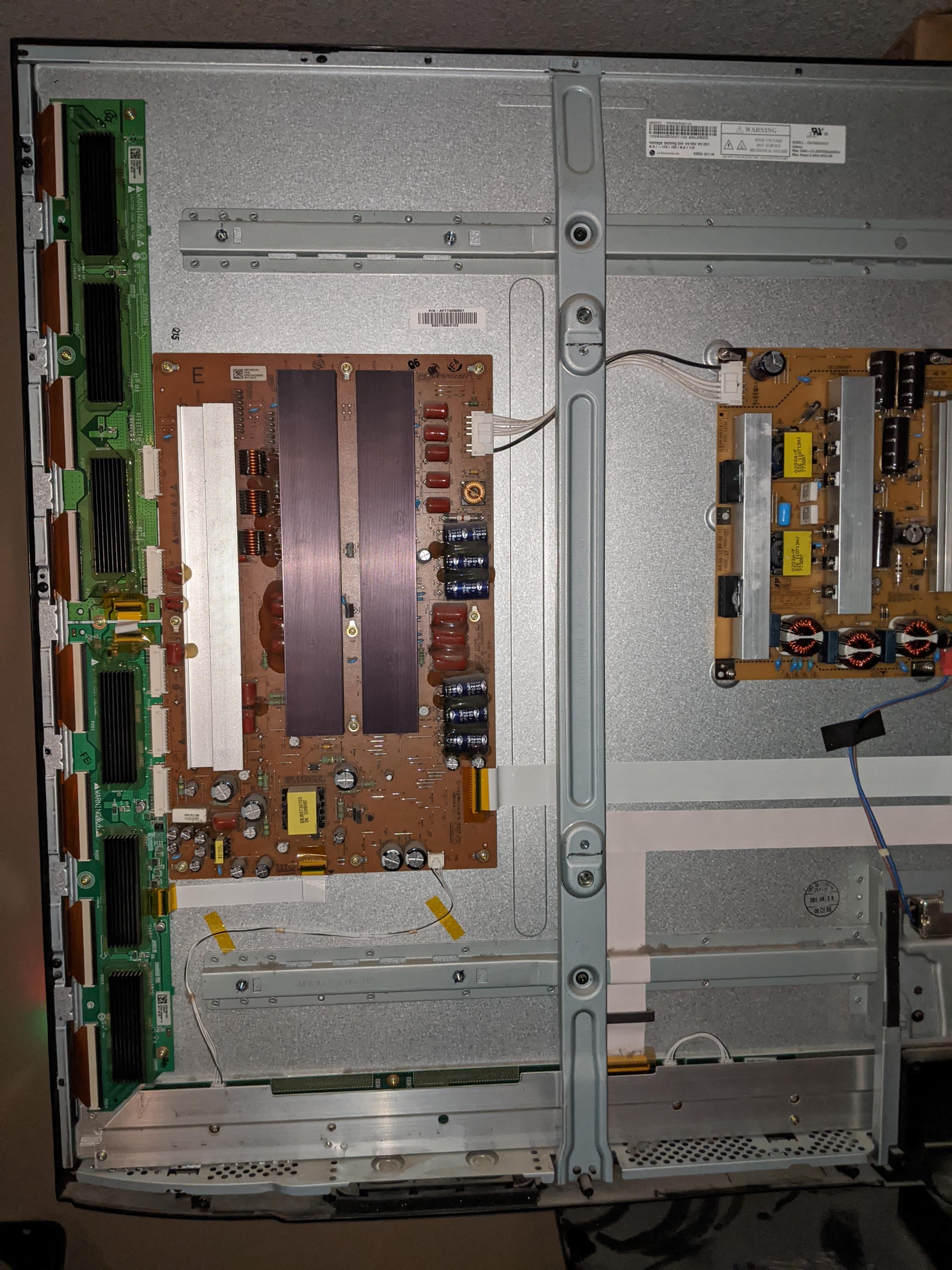

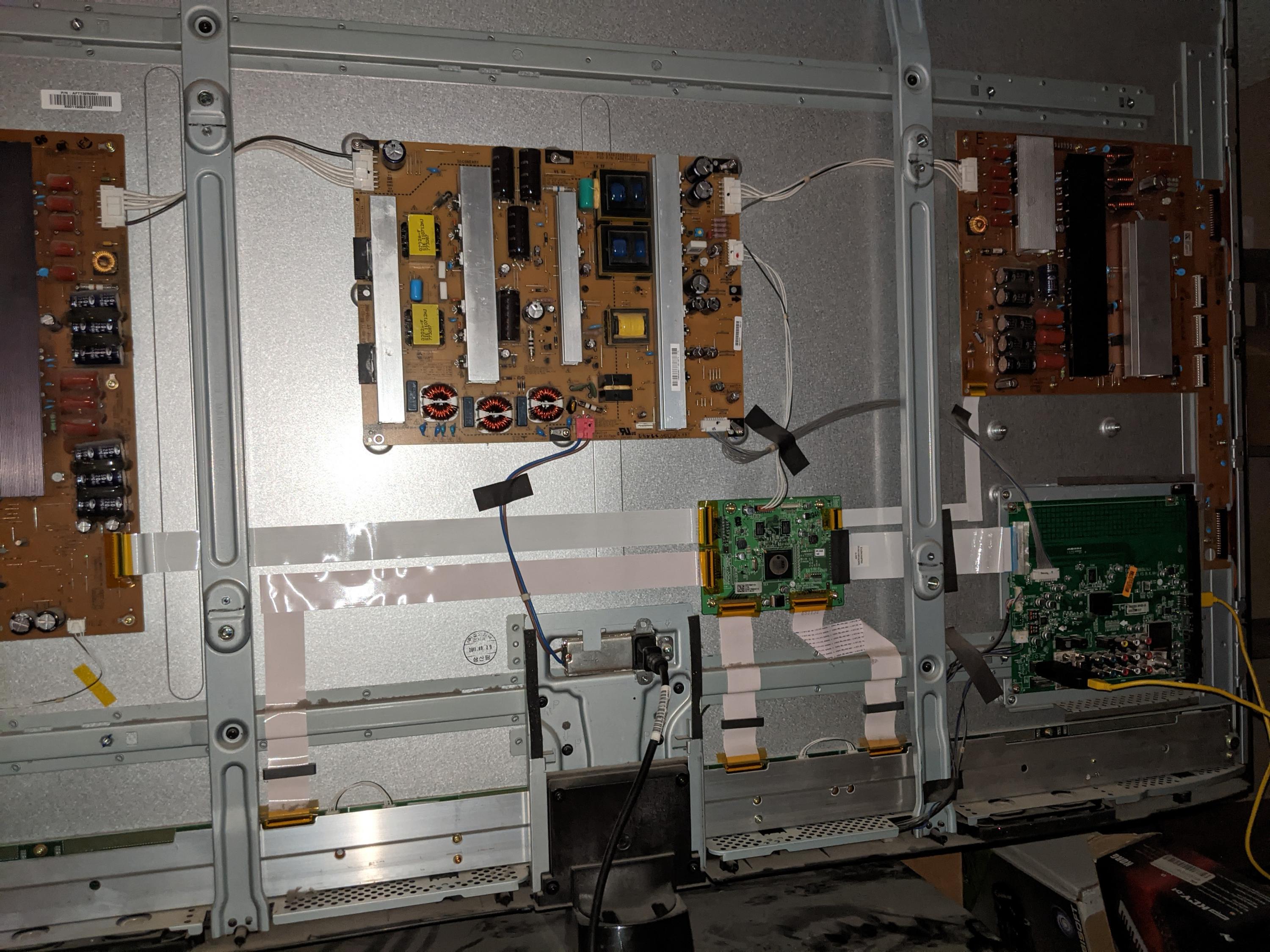

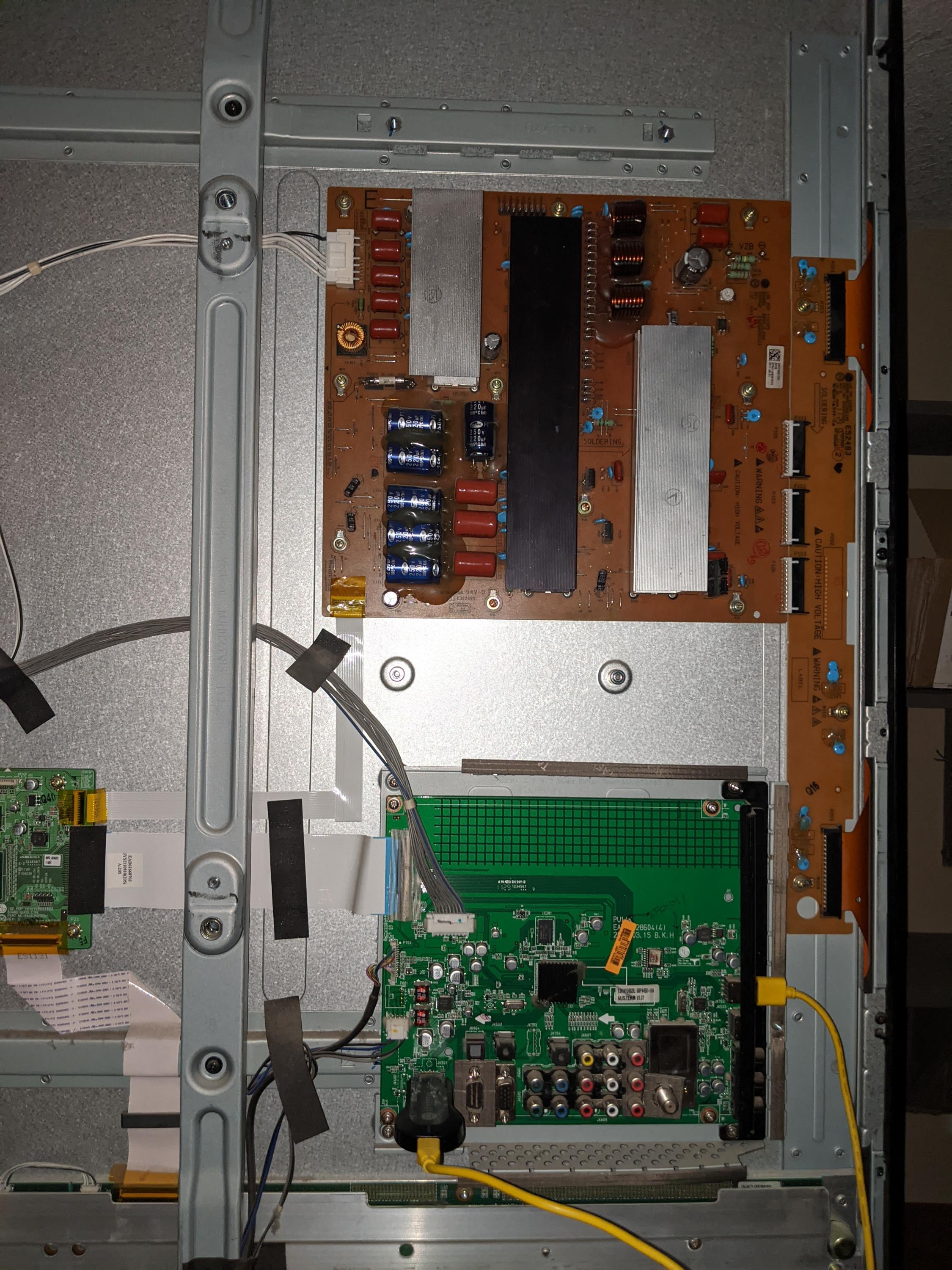

    Hi There,

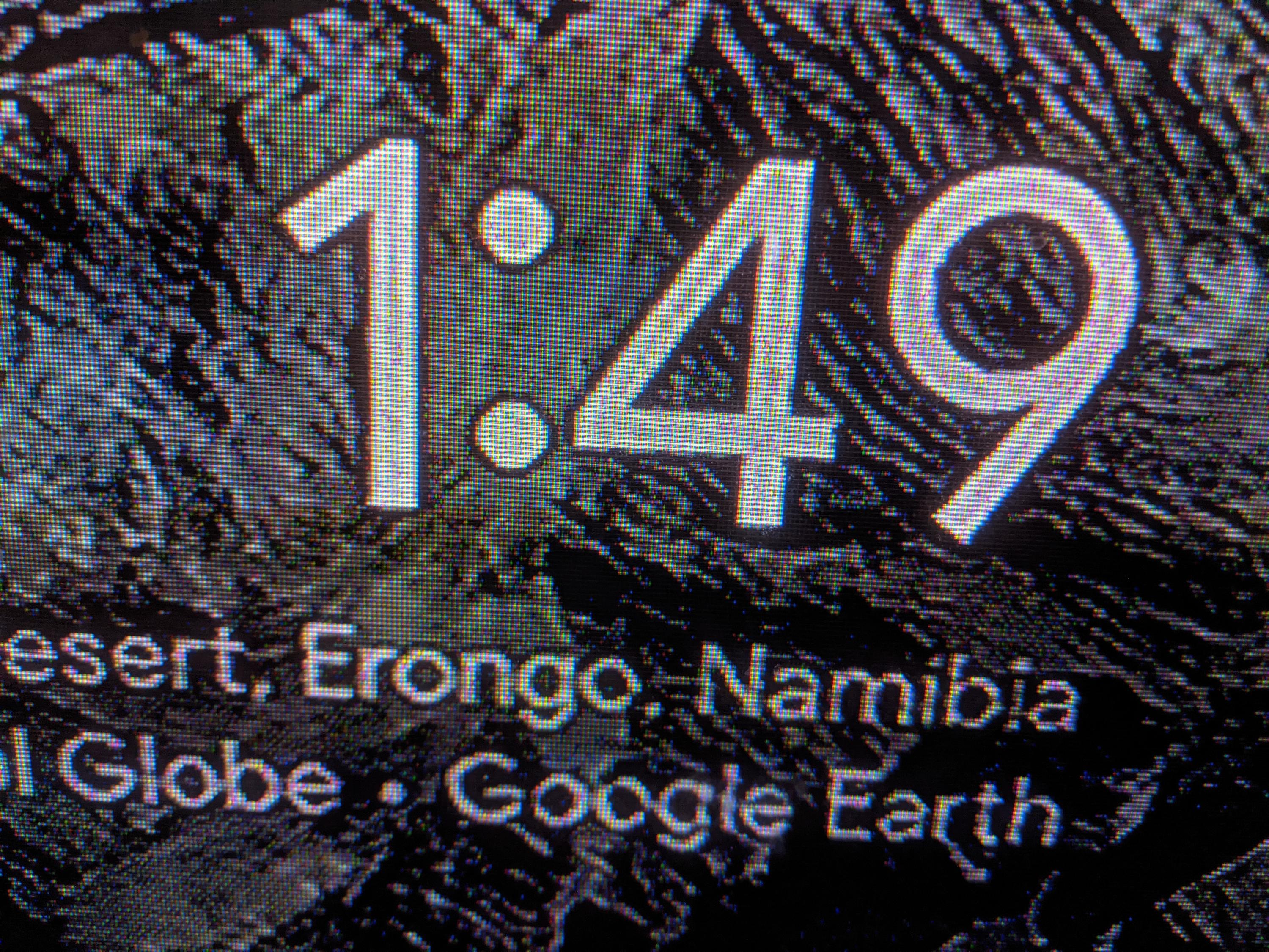

    If memory serves me right this set was totally dead when I acquired it. Replacing the z-sus brought it back to life but with some purple haziness across the whole panel.
    Vs and Va are within tolerance.
    By making some slight adjustments on the Y and Z boards I was able to make it better but still noticeable
    What are my steps to isolate/solve the problem.

    Eek! Looks like it's got '00s-style glue!
    (the dreaded brown stuff that's often seen on 2003 and 2004 equipment)

      What about the VSC voltage? what is it and does it match the panel sticker. Try adjusting the set_up & set_dn controls, Mark there positions with a felt marker before adjusting them.

        Check the solder under the coils of the y and z sus boards. They crack over time and need to be re-soldered with lead solder.
