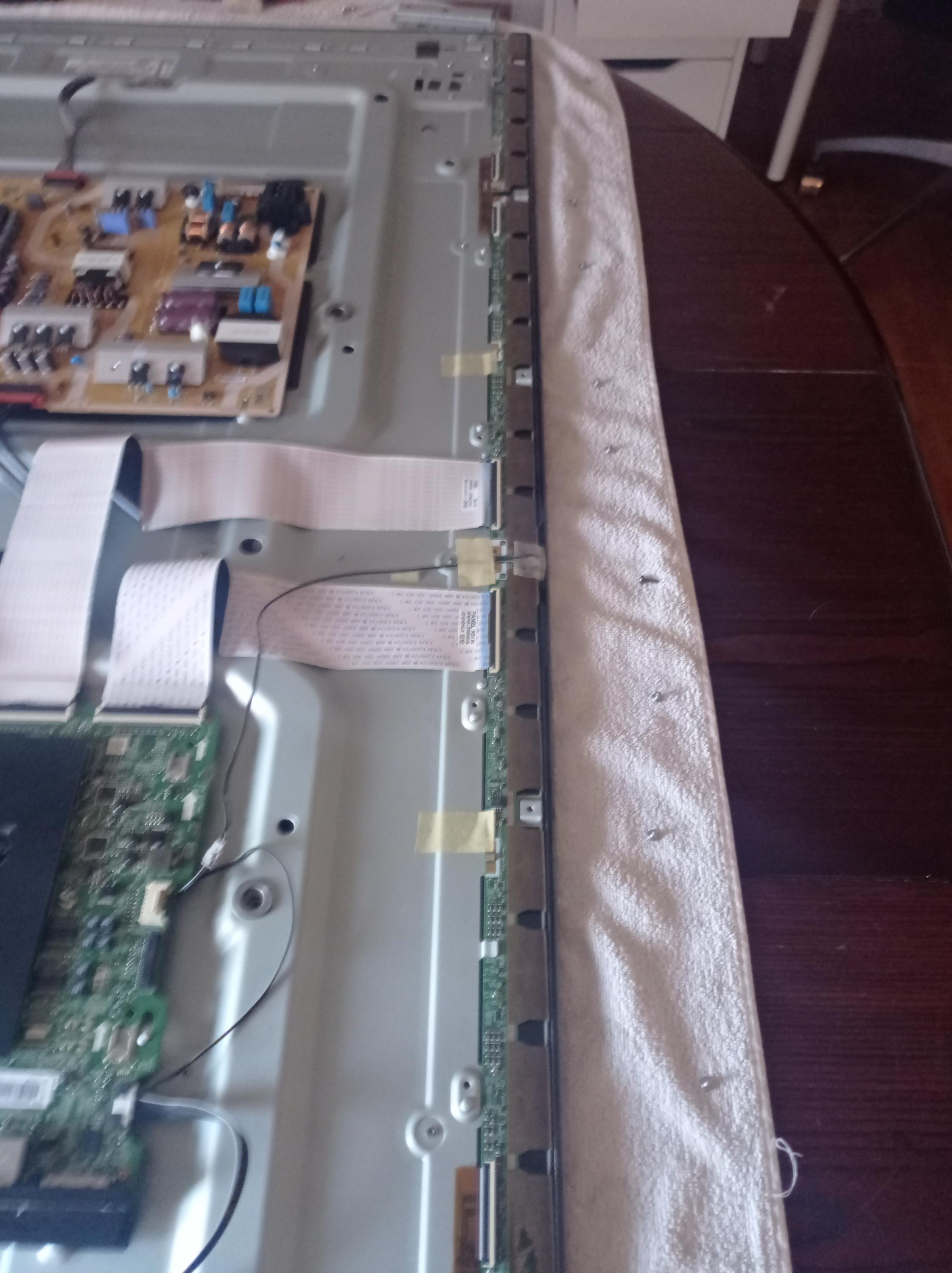

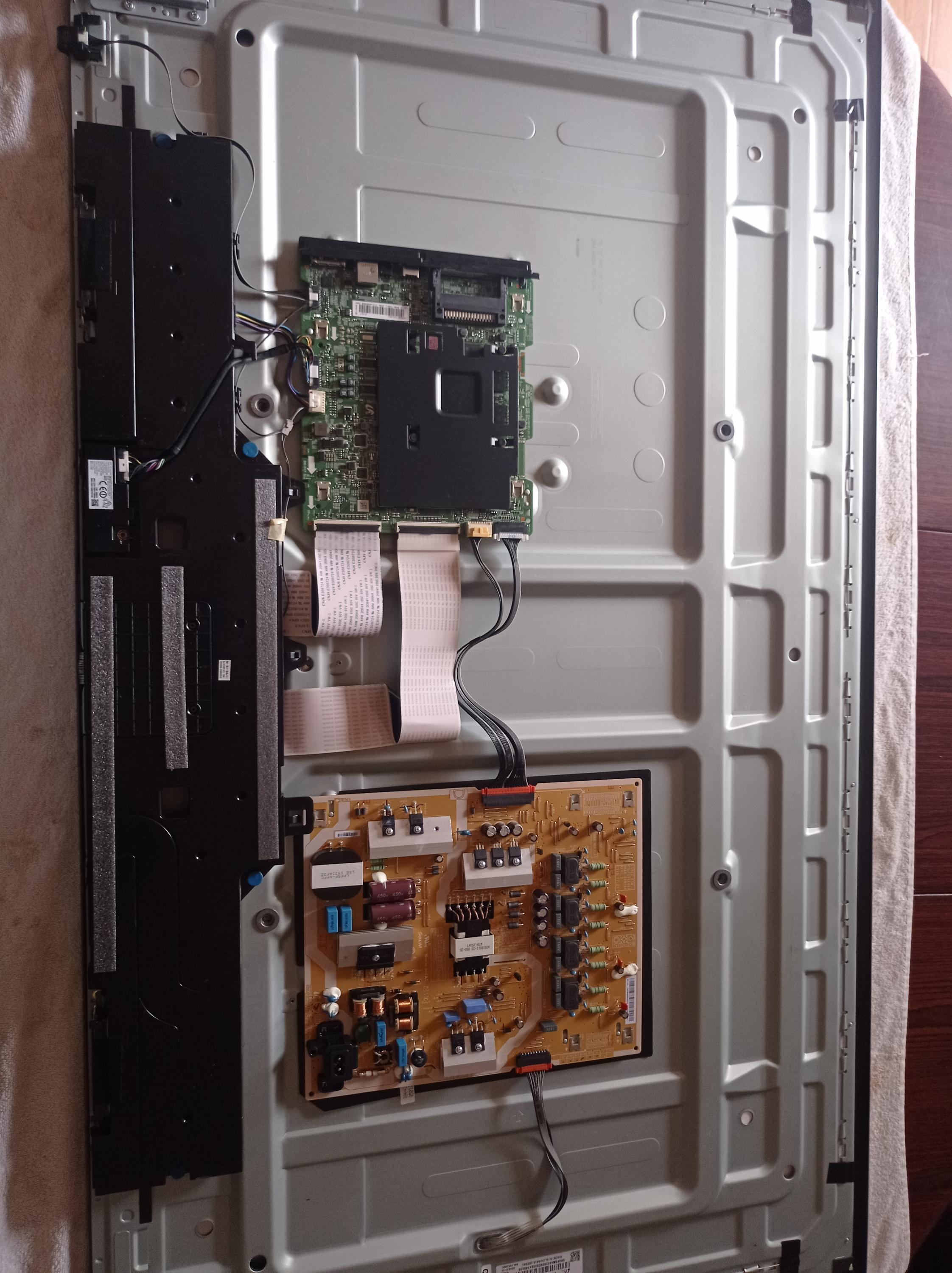

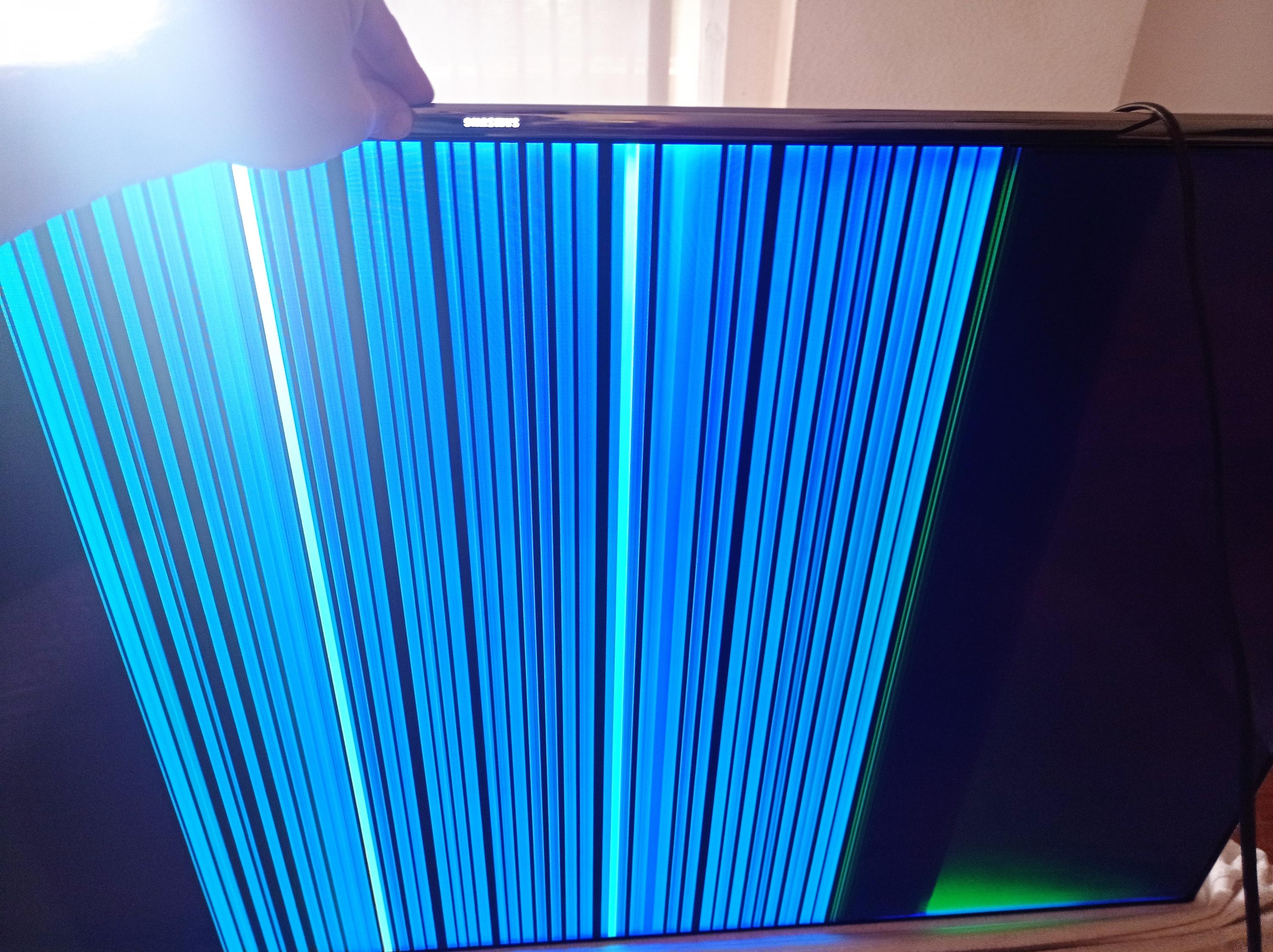

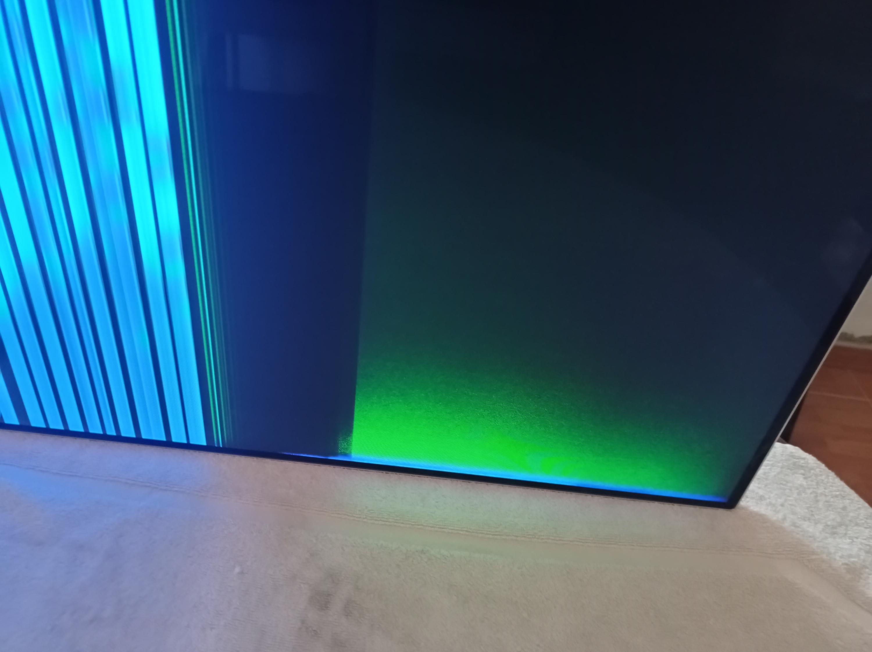

    hello.

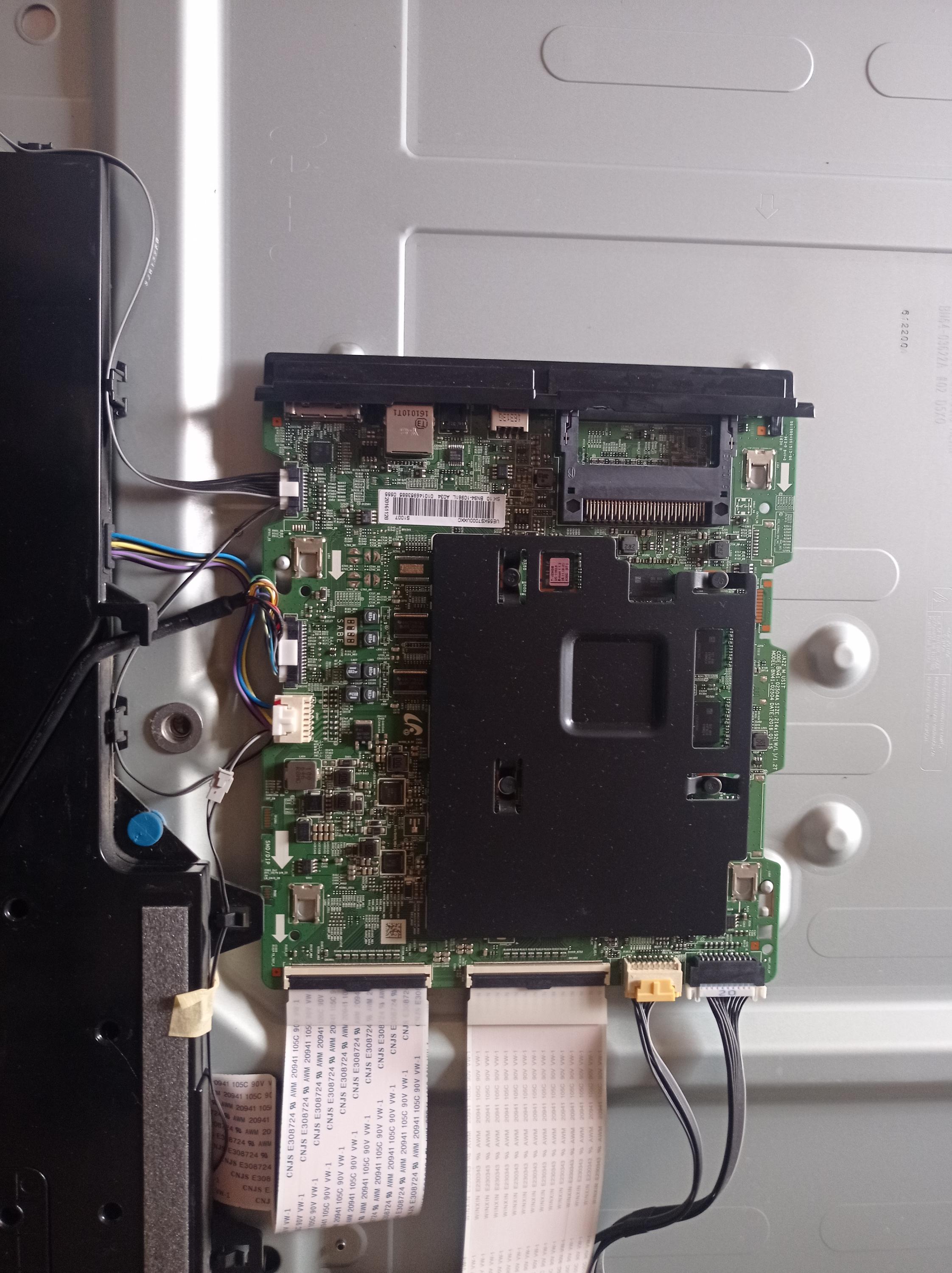

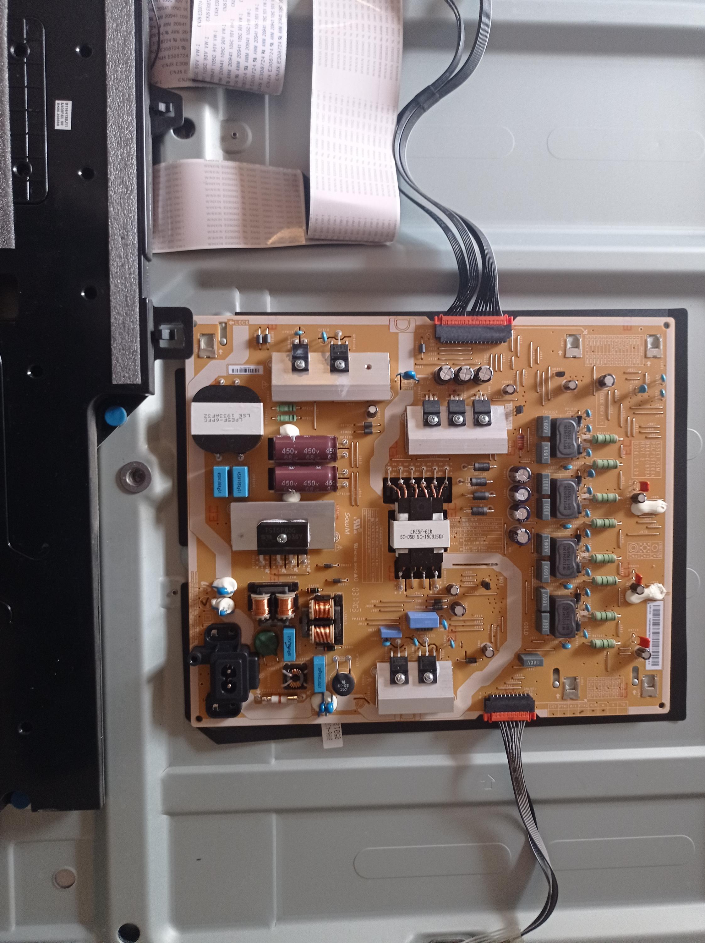

    thinking about panel or tcon, i open and foud that theres no tcon board,
    surprised, closed again, so fault must be in panel right?
    all botom flex that goes to screen seem ok but there is no difference on screen when i touch/press them.
    you have some pictures here
    there is no magic tape-cut fix for this one or something similar?

    You can still unhook one ribbon cable at a time going from mainboard to the panel driver board, plug tv in turn it on see what you have on display then do the other one.

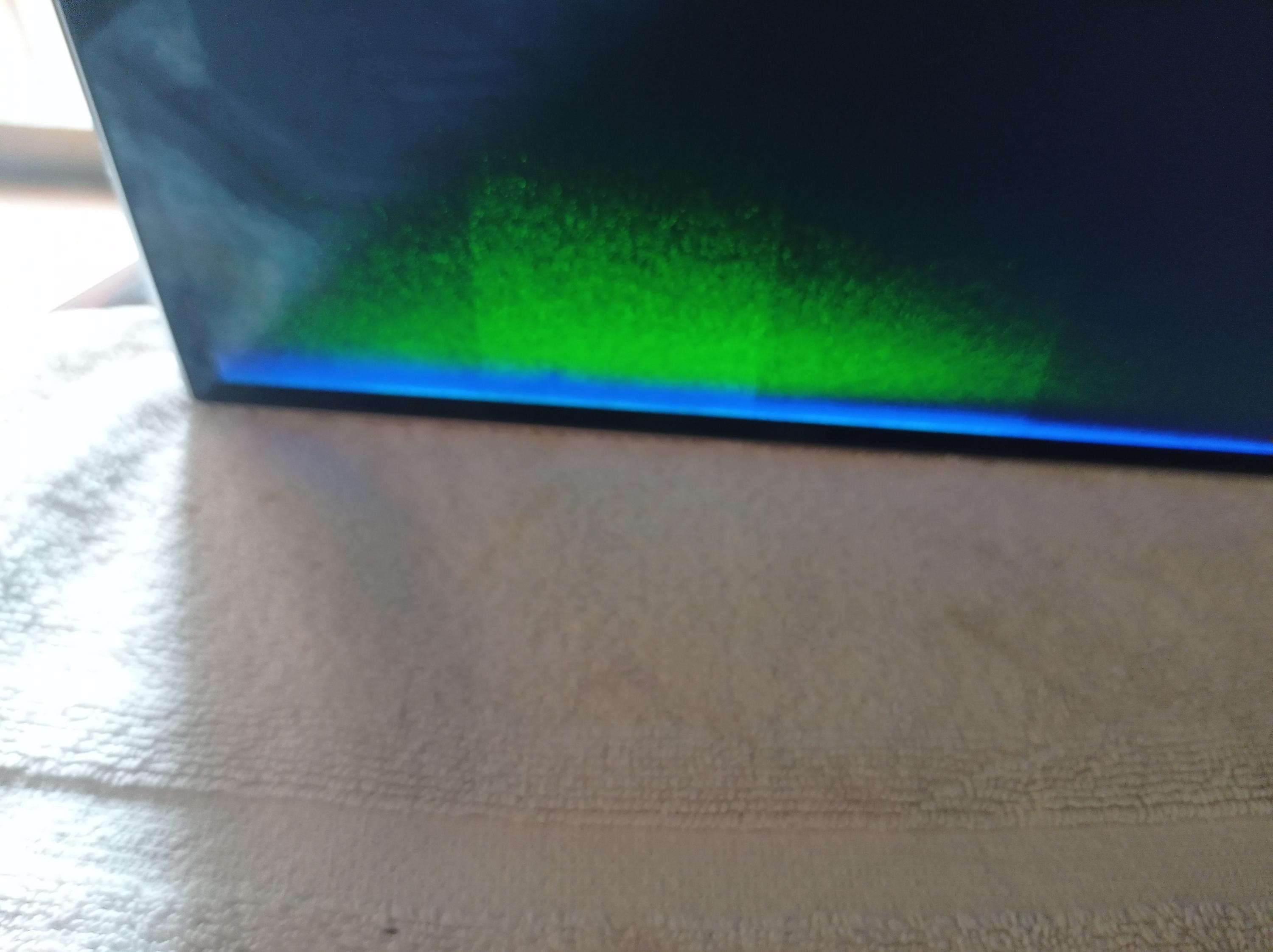

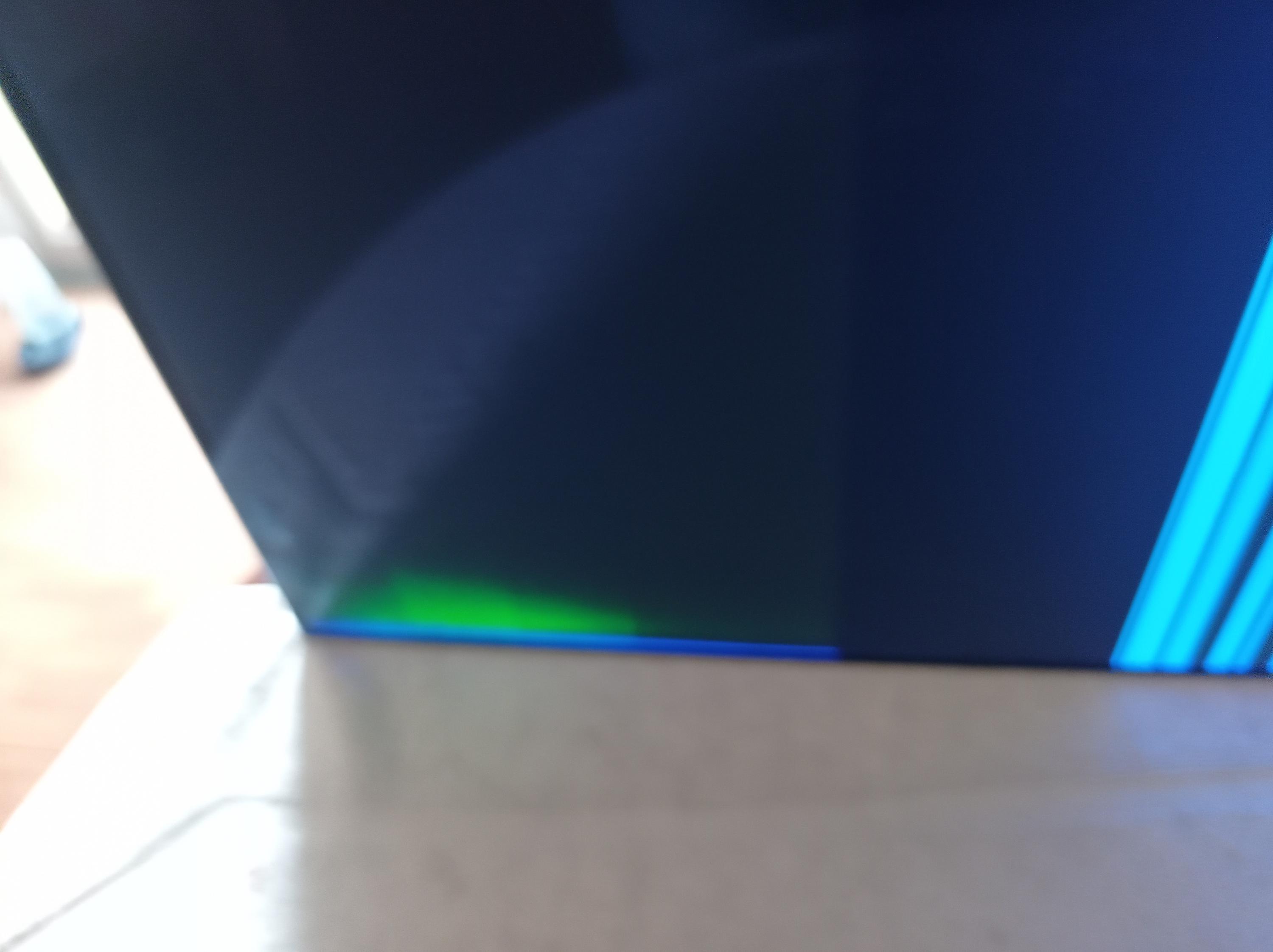

      probably cracked corner..
        i did with the flex at the top and backligth was like triying to light but not working properly...
        then unplugged and tv did not started anymore pluging but did presing start phisical key.
          but i can not see anything broken

            Re: samsung ue55ks7000u vertical lines
            A repair man have told me yesterday the same until he have posted a photo of a corner and i have seen clearly the broken piece..
