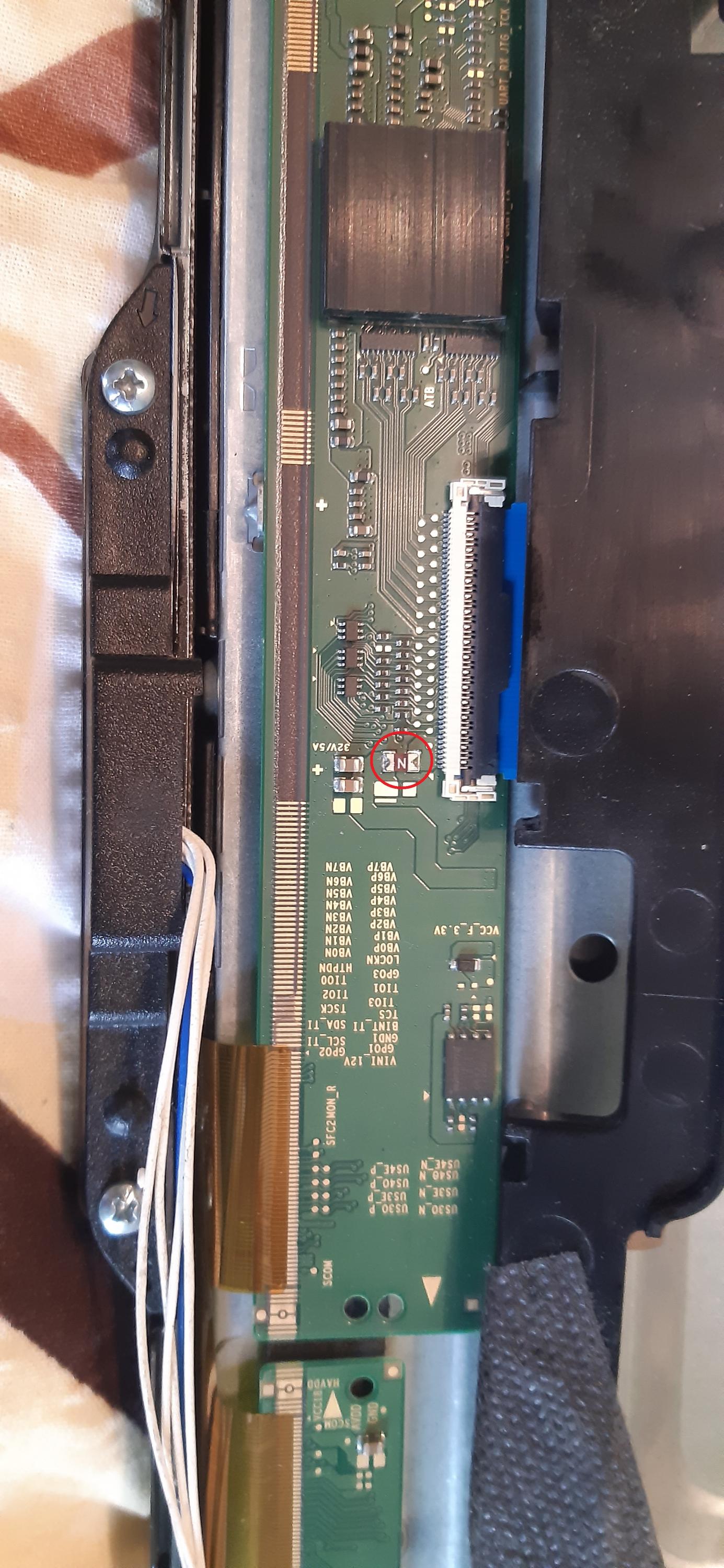

    On t-con I have spi winbond 25q16dvig
    On mainboard I have spi 25L1606E and NAND MT 29F4G08ABAEA
    CPU is ARM MSD95PMVW4-4-0036 ATPS618A
    Panel is VES490QNUS-2D-U01
    When I turn TV on - TV starts backlight is ON but no image no logo no picture on the screen. On motherboard optical socket is glowing red. TV rensponce on remote I can turn on and off via remote
    I have searched internet looking for dump those spi`s and nand but no luck.
    I searched official site for looking for any kind of firmware but no luck.
    Maybe someone have dumps and wanna share with me
    Here are some pictures
    images t-con

        Check what dc voltage you have at each side of the smd component marked N which is a fuse.
        • jamaj
          • Apr 2021
          • 6
          • Poland
          Re: hitachi 49HL15W69
          12v on each side
                I measured voltages on t-con and I have:
                VCC F 3.3V - I have 3.3V
                Fuse is OK and have 12v on both sides
                VCC B 1.8V - I have 1.78V
                HVIN 12V - 0v
                VCC A 1.8V - I have 1.8V
                VCC 3.3V - I have - 3.3V
                VCC 1.05V - I have 1.17V
                VINI_12V - I have 12V
                AVDD - I have 0v
                HAVDD - I have 0v
