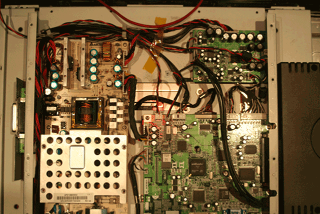

    Okay I picked this set up for 15.00 thought it would be a good set to practice on. I have limited knowledge when it comes to this type of thing but, I am a very willing student when it comes to learning.
    (the acer logo appears for a second then to black screen for all the below tests)
    I get this Acer AT3201W home and I plug it in do the usual hook up different audio/video to the various inputs. Same result audio is fine no video.
    No obvious caps bulging,nothing looks burnt or shorted so I focus in on the inverter board. I measure all primary and secondary on the transformers. I
    find that one of the s2 has a reading of 0 so I have removed this transformer and waiting on the replacement to come in.
    Question
    Should I be checking anything else while I wait ?

    Here are a couple pics of the Acer 3201W

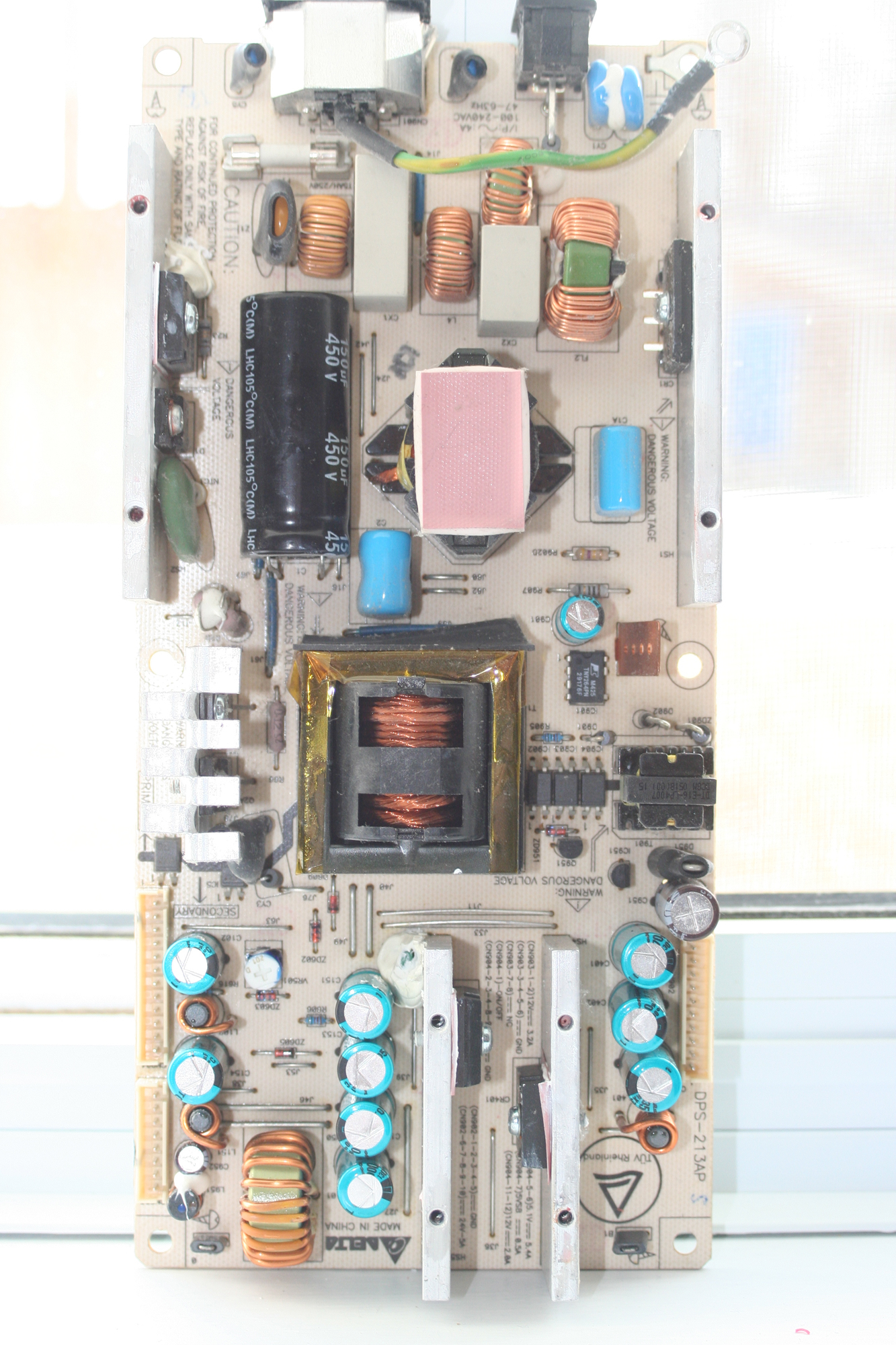

      Here is a photo of the power supply

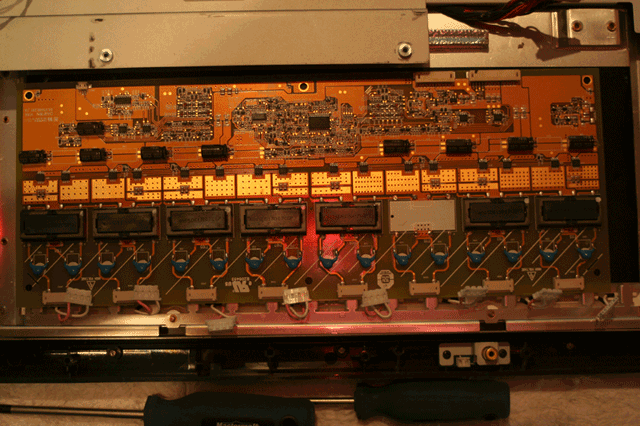

        What resistance range did you use to measure the secondaries? By the picture I notice that one transformer appears to be missing. Did you check the suspect out of circuit?
        There's not much else to test. Transformers in inverters fail all the time, so there is no point in going beyond this to find a cause.

          Thanks for the reply PlainBill .
          yes I did test out of circuit with the same result of 0 .
          inverter transformers (results)
          1 s1 881 s2 878
          2 872 869
          3 871 867
          4 882 878
          5 892 887
          6 886 0
          7 919 917
          8 890 885

            Looks to me the only problem you are going to have with your $15 'practice TV' is you aren't going to be getting a lot of practice. Good work!

              looks like a darfon v144.
              you nailed the bad transformer.common failure.

                  Well the transformer came in today and I eagerly soldered it in place .
                  Everything is working fine now for the last couple hours.
                  Thanks again to all that helped !.
