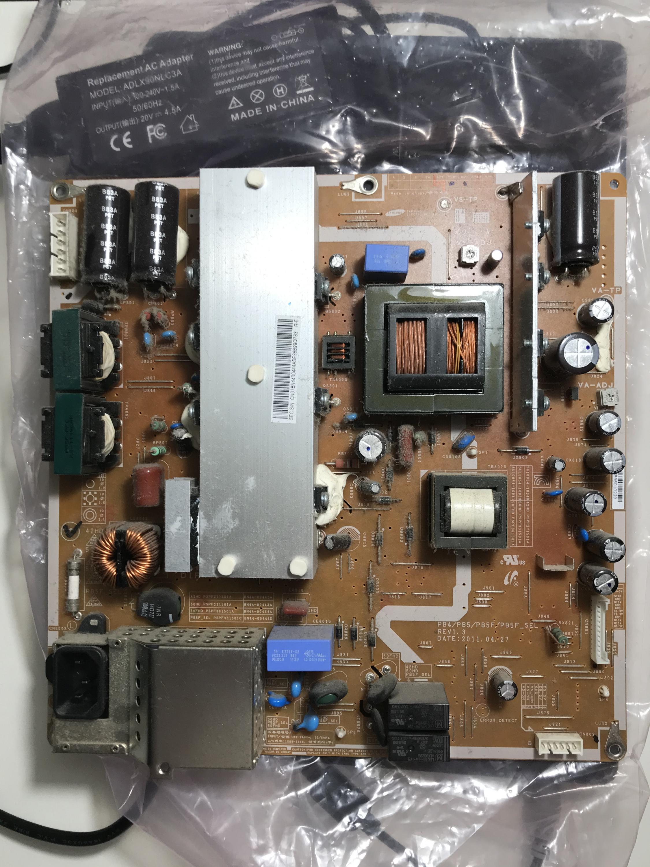

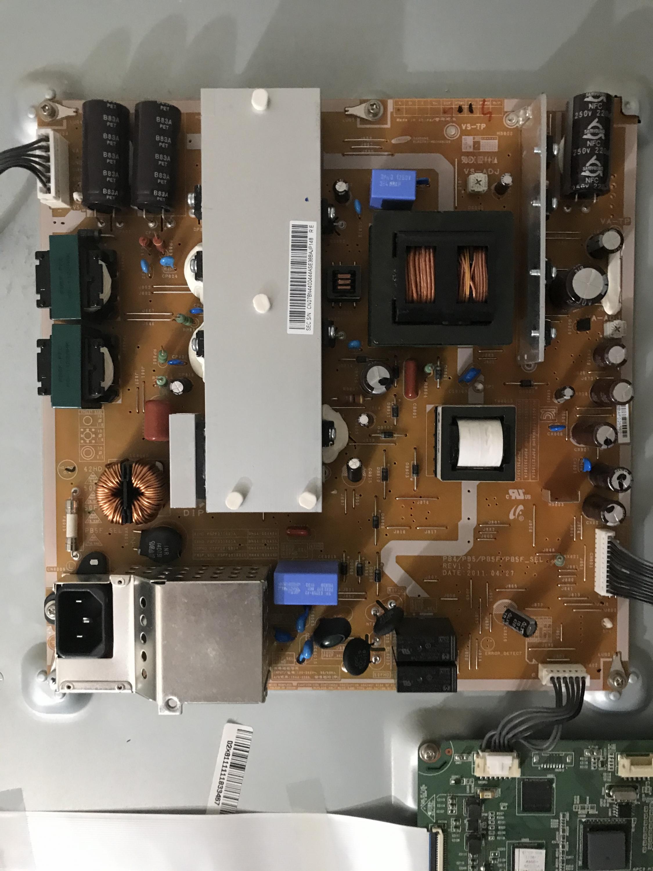

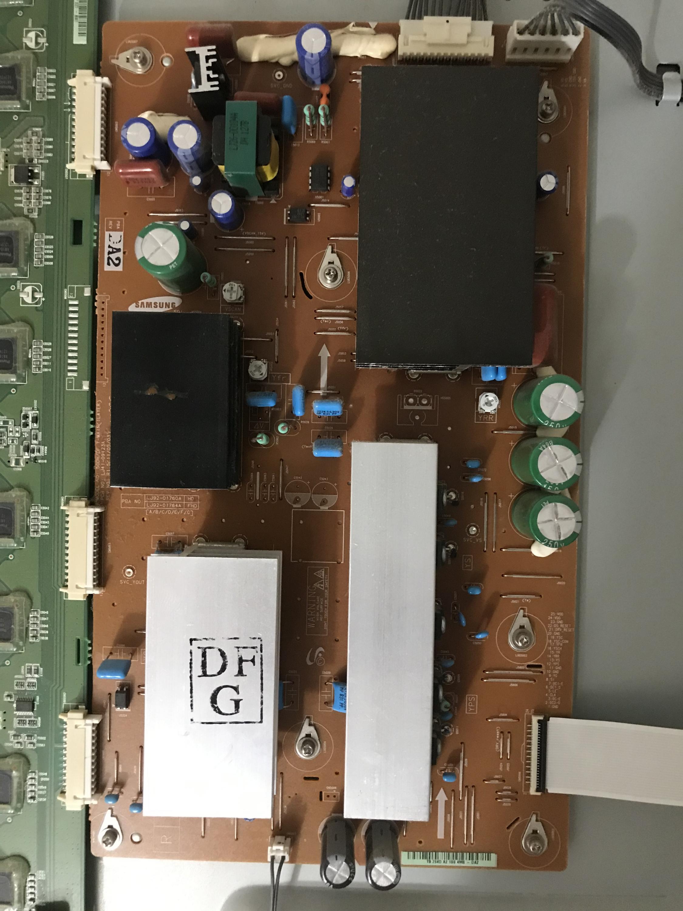

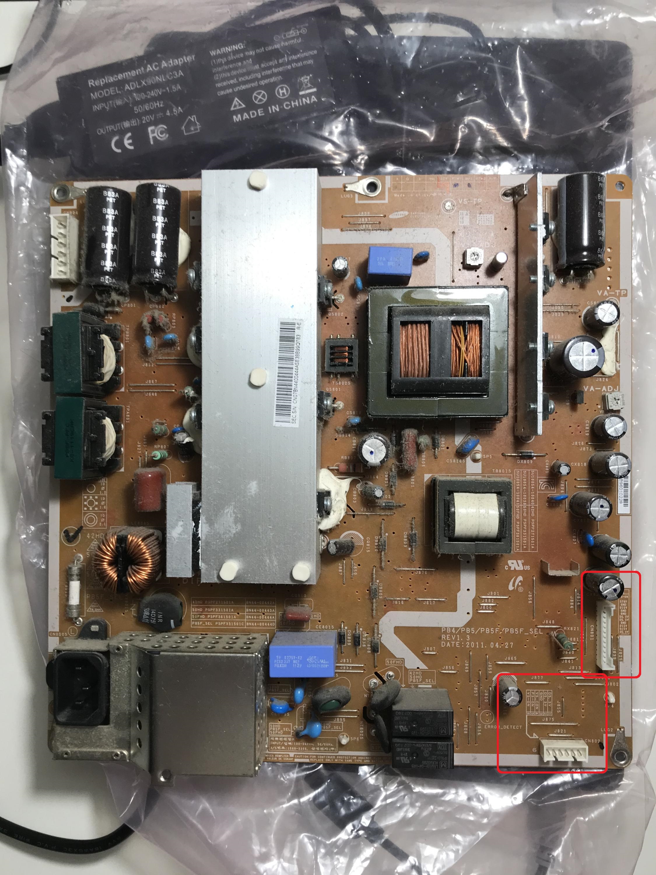

    - I bought a replacement power supply board (model BN44-00444A) from TV Parts Today. I swapped out the board, but the symptoms did not change. It cost about $40-45 shipped. The last picture below is the old board I took out of the TV. Pic 3 is the new board.

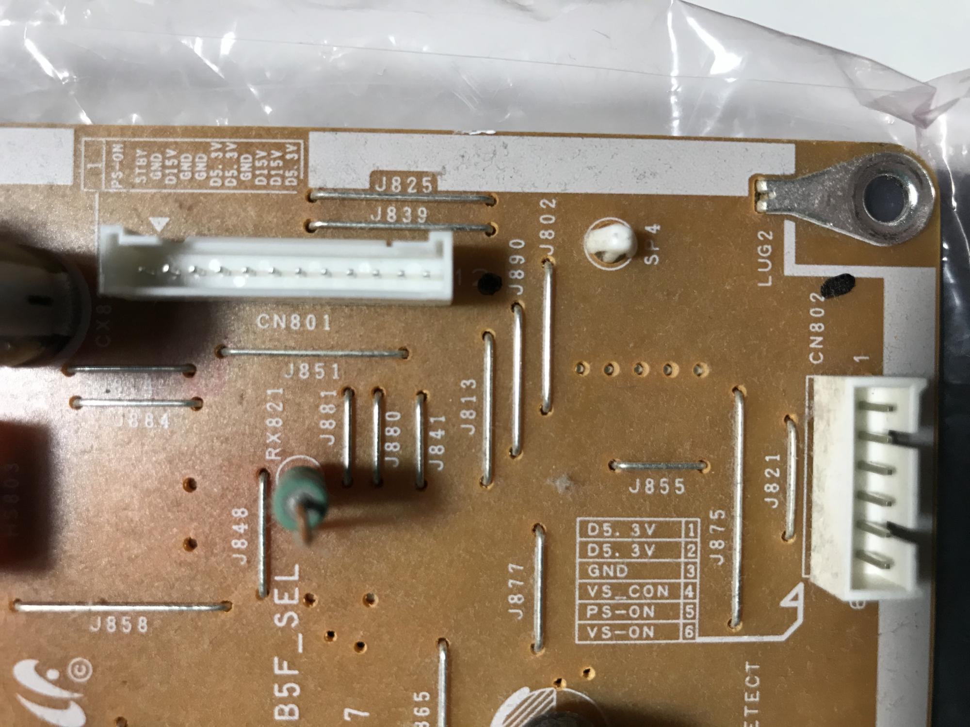

    A good starting point is to give the voltages within the two red boxes.
    If you can give the :-
    1. Connector name
    2. Pin Number, Legend Name, Voltage
    etc for all the pins
      Thank you for responding. What do you mean by "red boxes" please?

        Re: Samsung PN51D550 Five double blinks
        It would have helped you if I had remembered to include the picture. Ooops
          Here is a close-up of that corner of the power board. I'm not sure it's the power board though, because replacing it resulted in the same symptoms as before? That said, I will absolutely perform any troubleshooting steps anyone gives me to the best of my ability.
            Check the resistance from VA and VS to chassis and see if there's a short circuit. If there is try and idenrtify which board. They go off to Xmain and Ymain boards. Unlikely to be the power supply if changed.

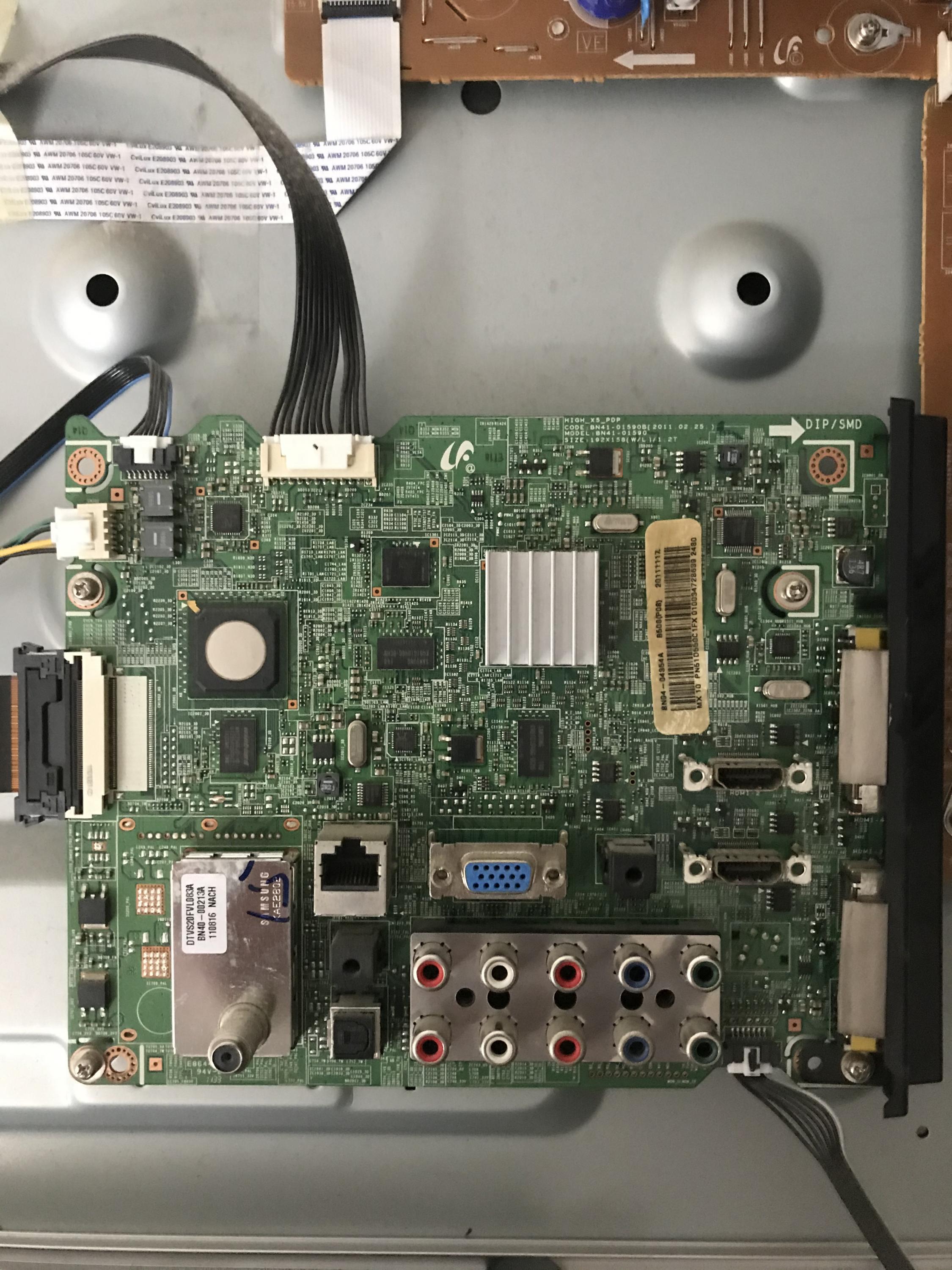

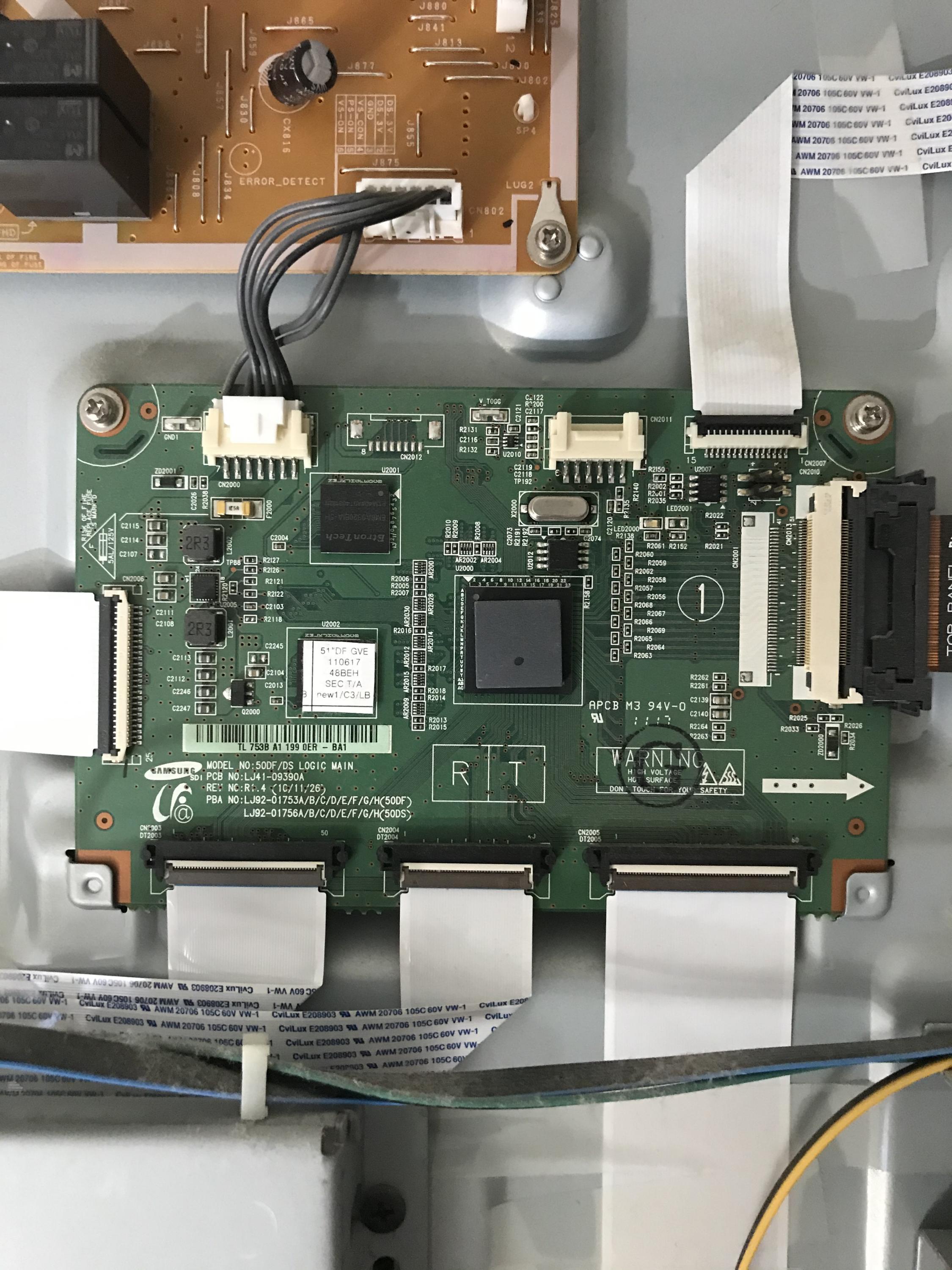

              I am very sorry to disappear for so long. Real life stuff hit me. I was able to successfully test all of the pins going from the power board to the X and Y boards (although I could not tell you which one is the X board and which one is the Y board). All of the voltages are correct on both ends of the connectors. Of course, as it turns on and off 4 to 5 times, I am only able to get the reading for a split second before the TV shuts back off.
              Can anybody PLEASE advise the next step to troubleshoot?

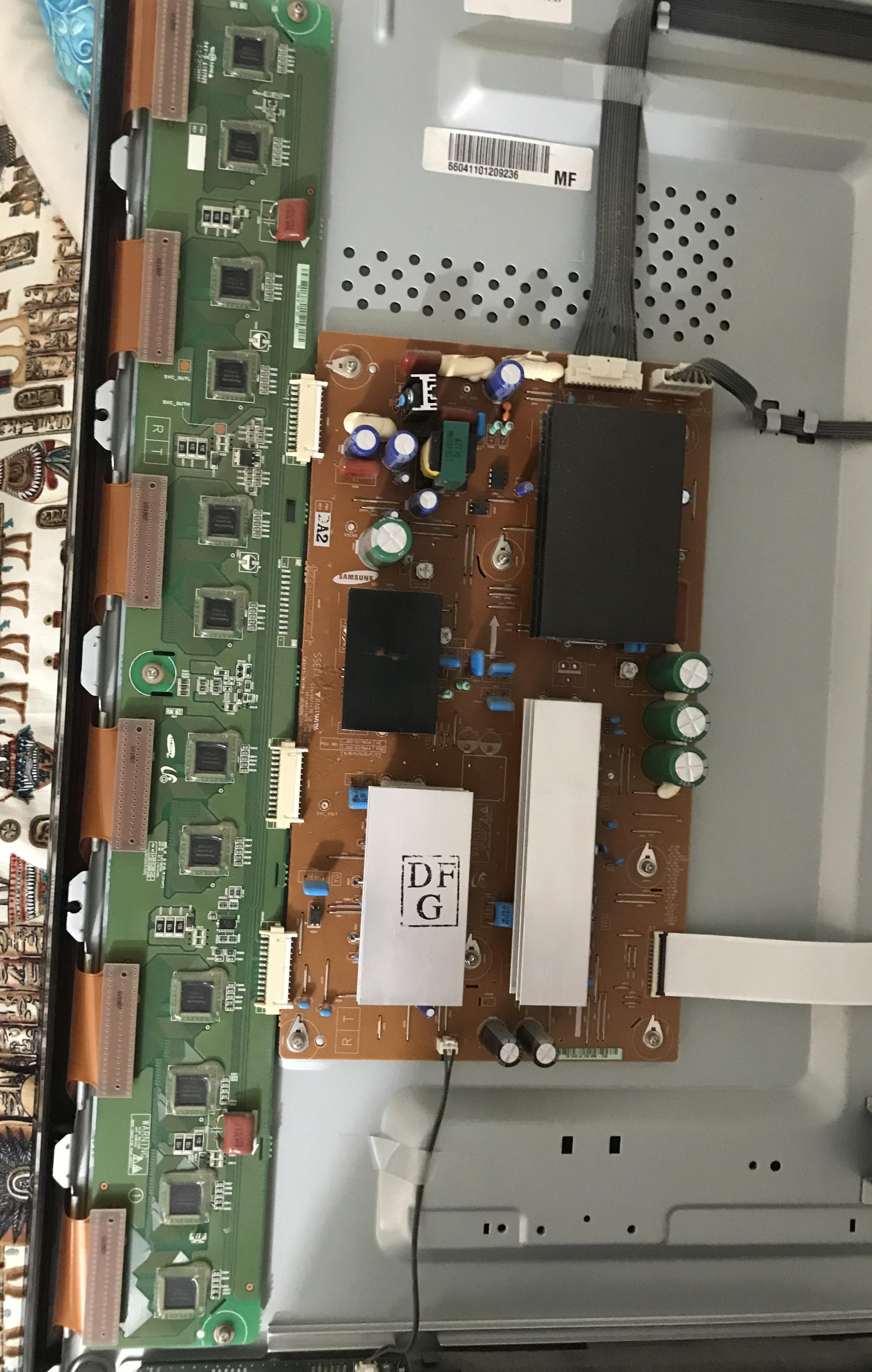

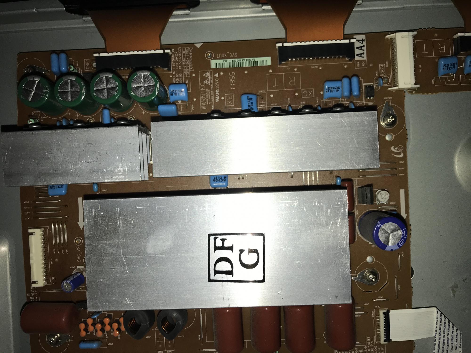

                Okay, what I tested were the logic boards, not the X and Y boards.

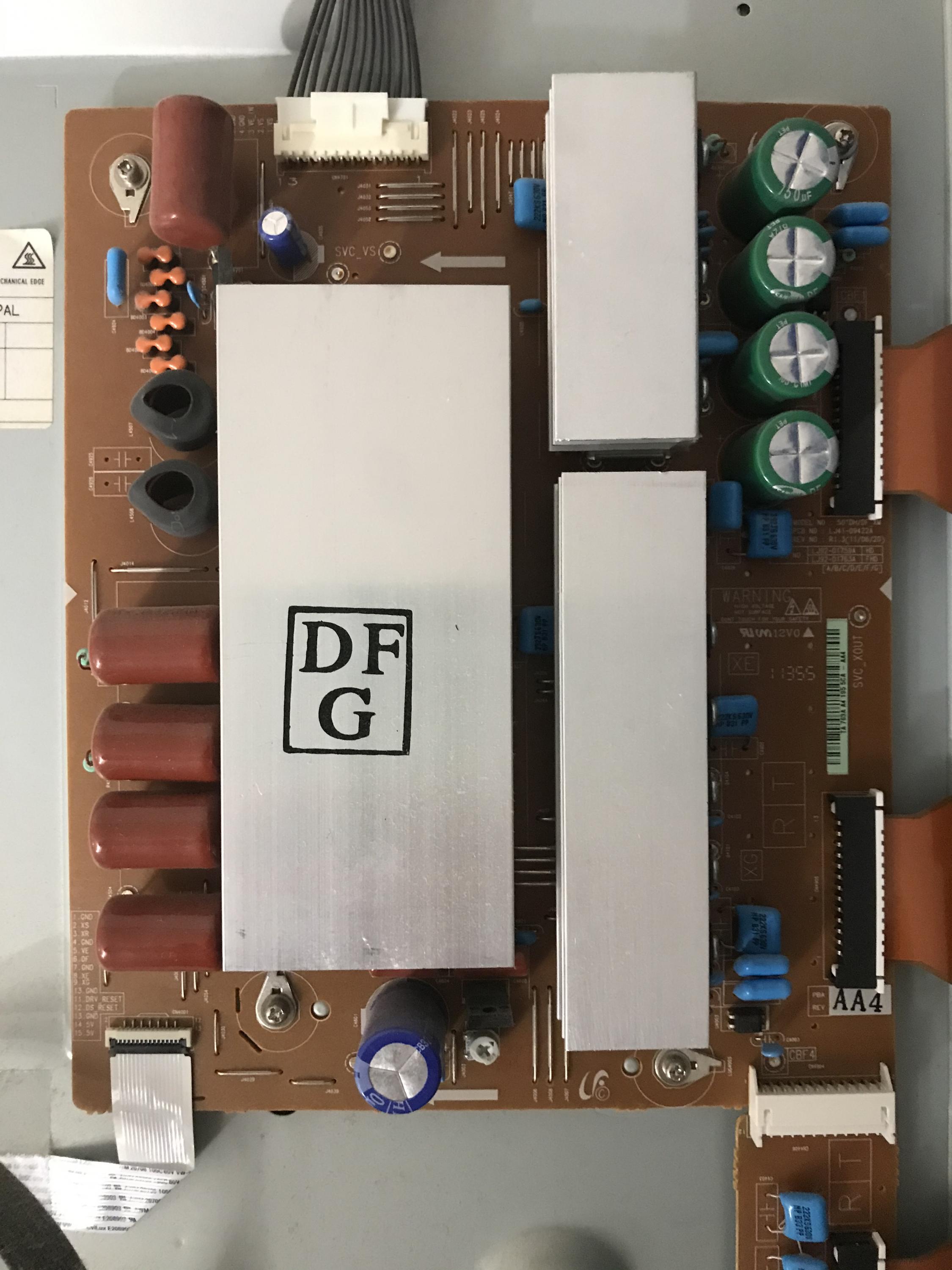

                So, I followed this guy's video, and determined the X board is bad.
                Does anyone know where I can find the same X board?
                It looks like the part number is LJ41-09422A. The one in my TV is R1.3. I found this eBay listing but it was R1.2. I also found this vendor, but it doesn't specify what revision the PCB is.
                How critical is it that the replacement board is R1.3?
                  Replacing the X board fixed it!
