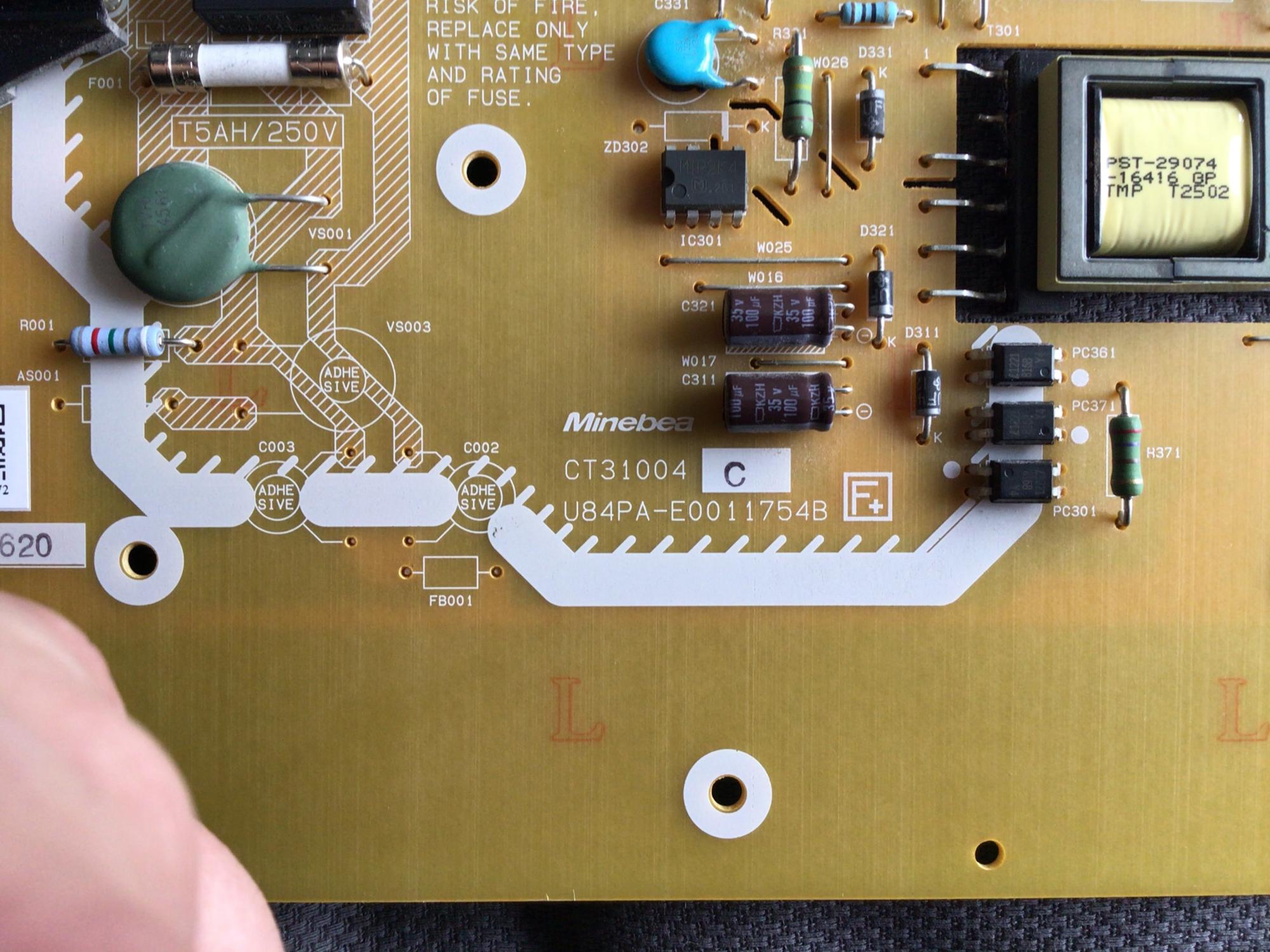

    Tx-l55wt50b I have looked for a schematic of the power supply and couldn’t find one even the service manuals only cover everything else but the psu.

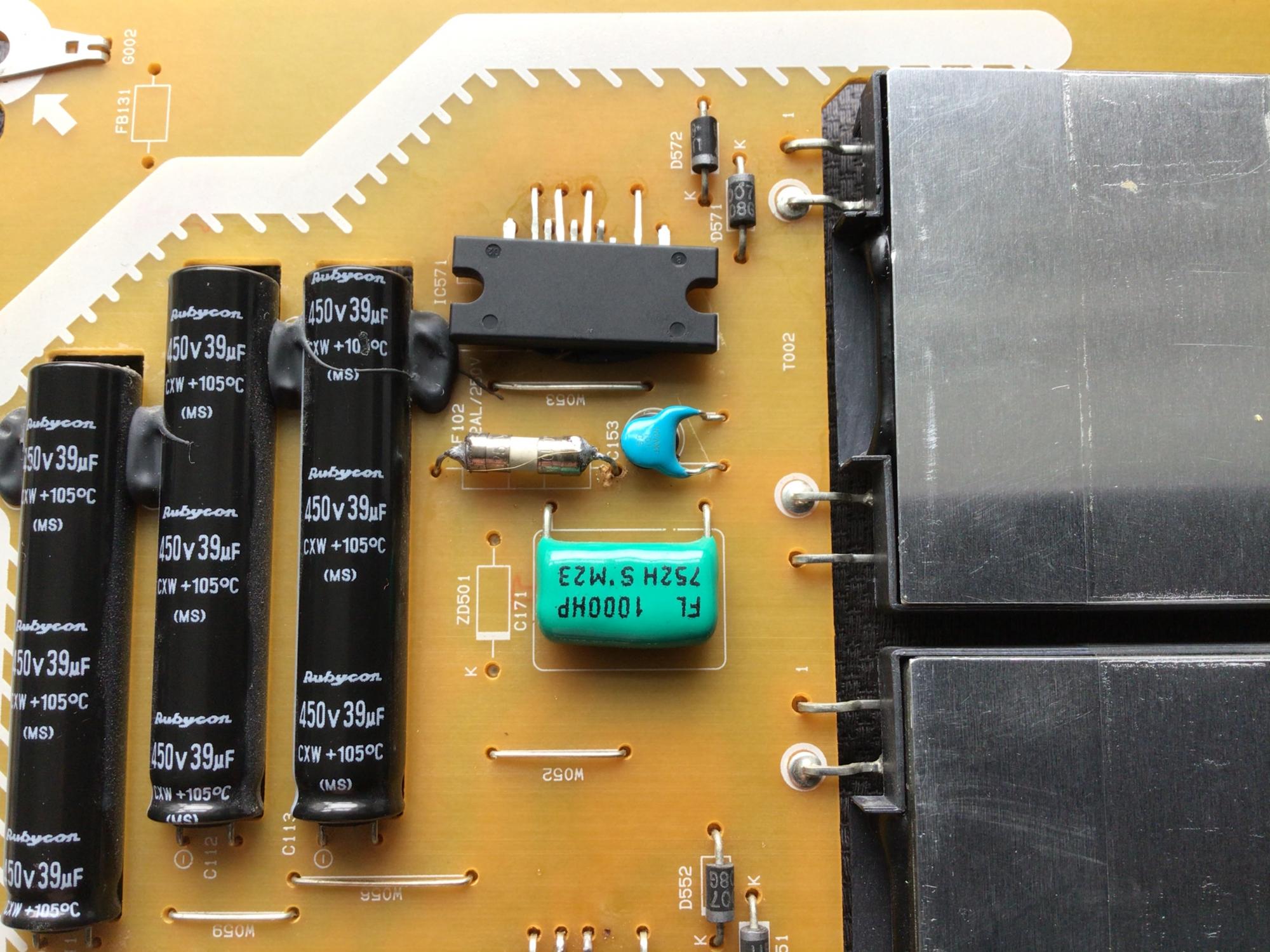

    Anyway I got the tv and it was making a loud buzzing noise from the back opened it up and found that IC571 / 2A fuse / a couple of zeners on the back had blown
    Power supply CT31004 U84PA-E0011754B
    Replaced IC571
    Replaced fuse with a temp 2A wire

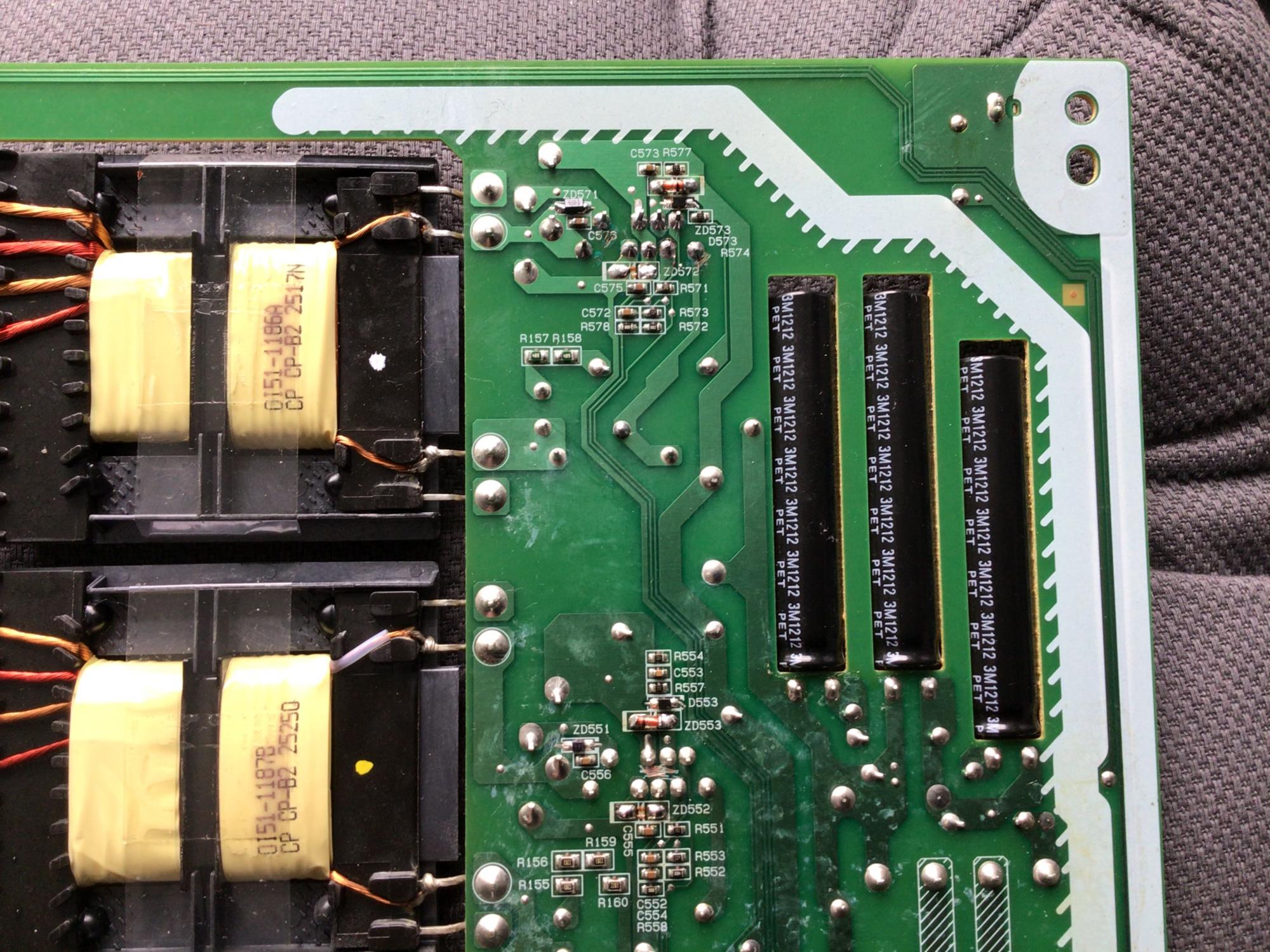

    I had zeners in place but probably wrong as when I plugged it in all that happens is the red light flashes 3 times pause 3 times pause and so on.....
    Position ZD571 was a G5 zener I think I found an equivalent?
    Position ZD572 Empty had a zener there that was short
    Position ZD552 Found to be shorted too
    Can anyone point me in the right direction of the values/ Equivalent or a manual for the power supply

    Here are some photos

            f you upload a complete photo of yours PSU from both side. and remark the area you have short on it will be more essential, because from my know early Panasonic TV PSU used same main diagram to build any further versions. so any early Panasonic psu boards will give the answer on any missing mysteriously parts.

              I'm not sure if this will help, but this Samsung power supply uses the same ic. The BN44-00498A uses it as well.
              The ZD572 seems to be between Lvcc and ground, so I suspect it is just for over voltage protection. IC lvcc max is 25v so it could be a 18~20v zener
              ZD573 is on the CS, current sense line to ground, this pin sees a very low negative voltage so I would guess a zener of around 4.7v or maybe less?

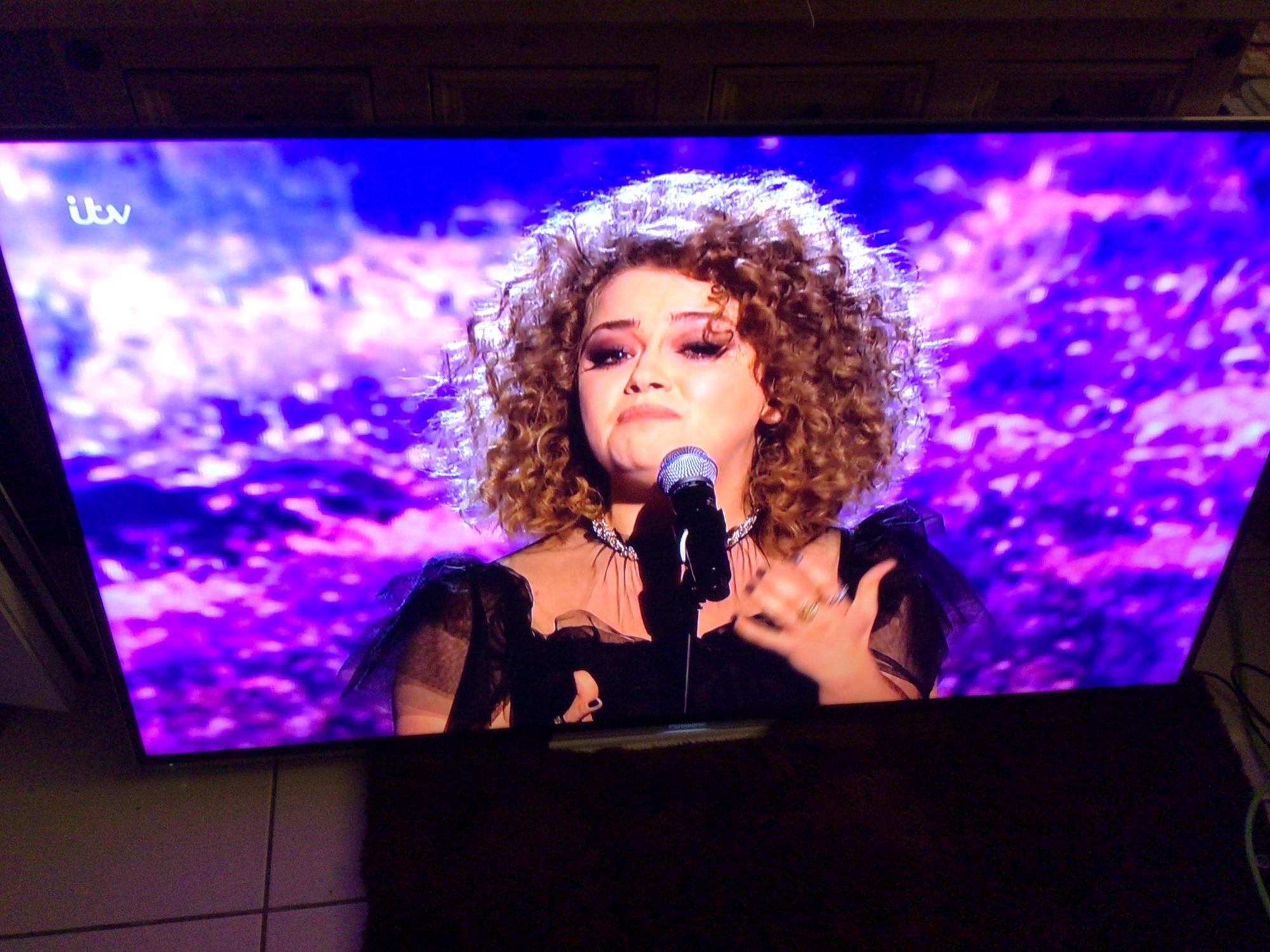

                Hi guys I fixed it
                I replaced the faulty zener diodes with what work out to be 4.5v ish and it's working now all there was 3.2volt and 5 volt that was all
                Now all voltages are up
                Crikey wow what a picture on it I'm going to run it for a couple of days
