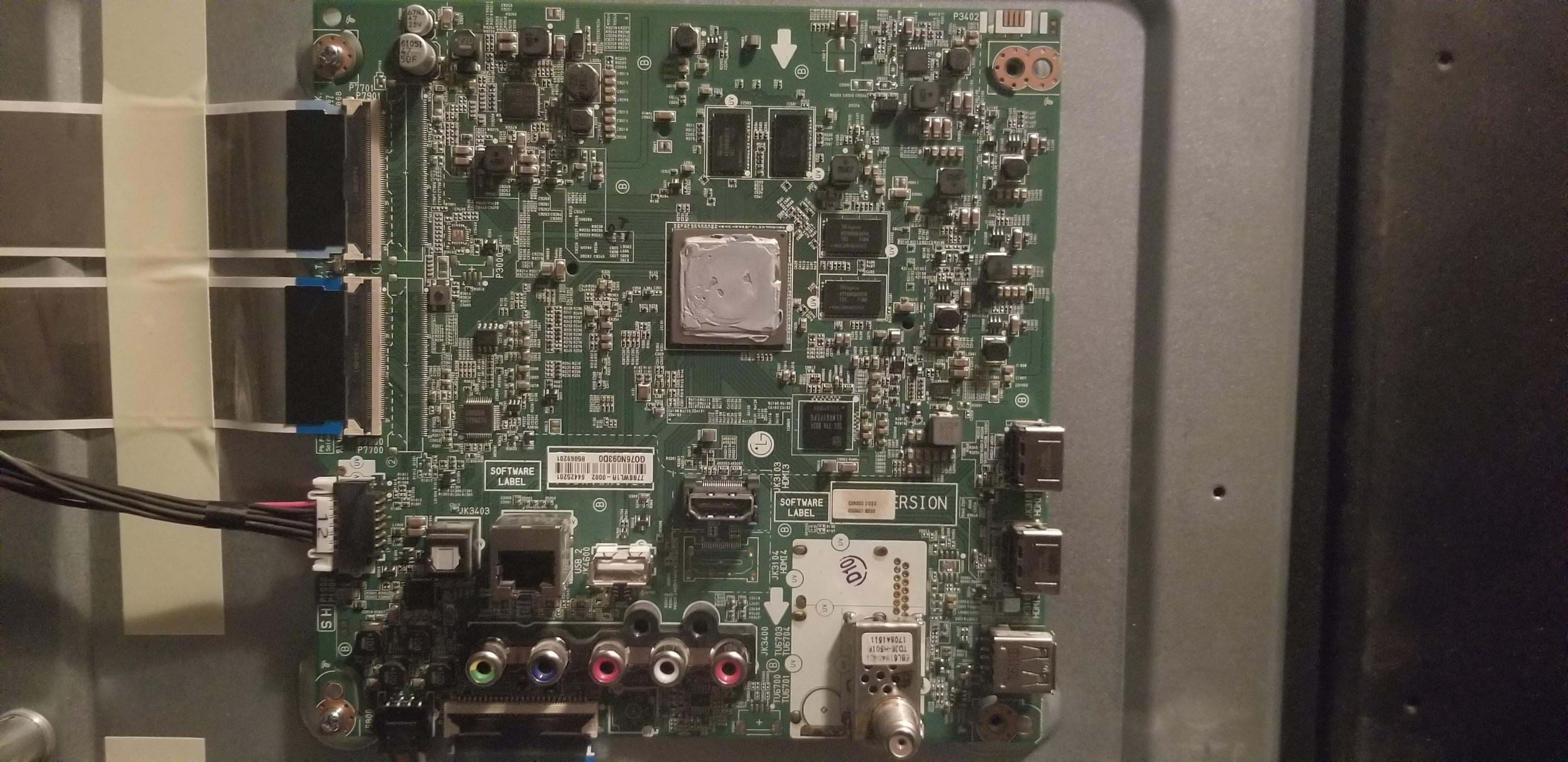

    I have lg 55uj6200, when plugged in its in standby to turn on you have press power button multiple time then it flashes 3 times and turns on but no video(flash light test) no backlights no sound.
    Powers supply
    Stby pwr on
    13.5v 12.5v 13.2v
    Pwr on 3.5v 3.5v
    Pdim .47v .47v
    Inv on 0v 0.05v
    If i force power supply turn inverter on backlights work no video.
    Is it possible trbl shoot backlight inv on circuit on main board or is this case bad bga chip or mainboard?

    Re: LG 55uj6200 wont turn on
    Best bet is probably a replacement mainboard.
      PWR ON and INV ON are mainboard signals sent back to the power supply. It looks like the mainboard has problems

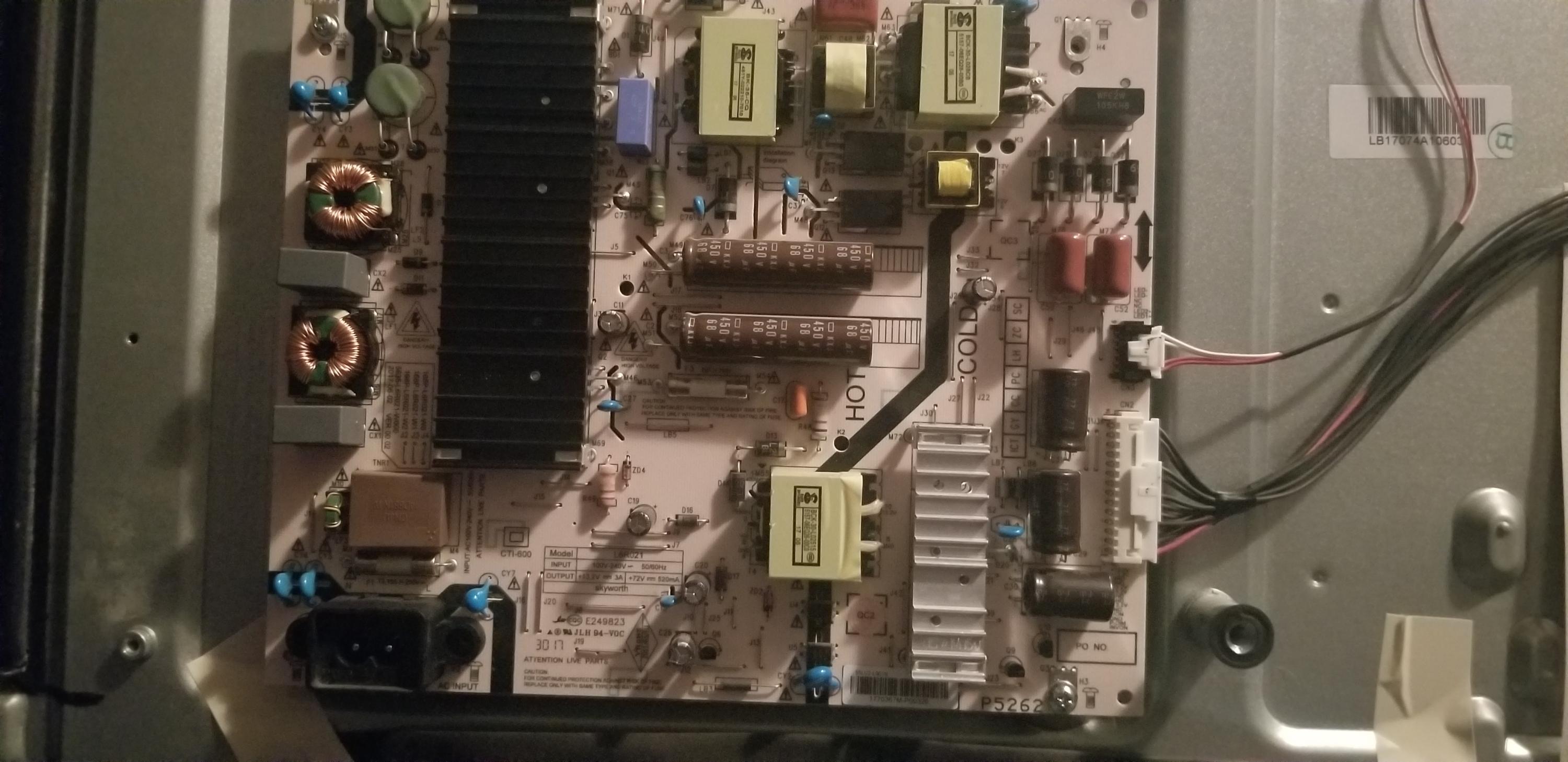

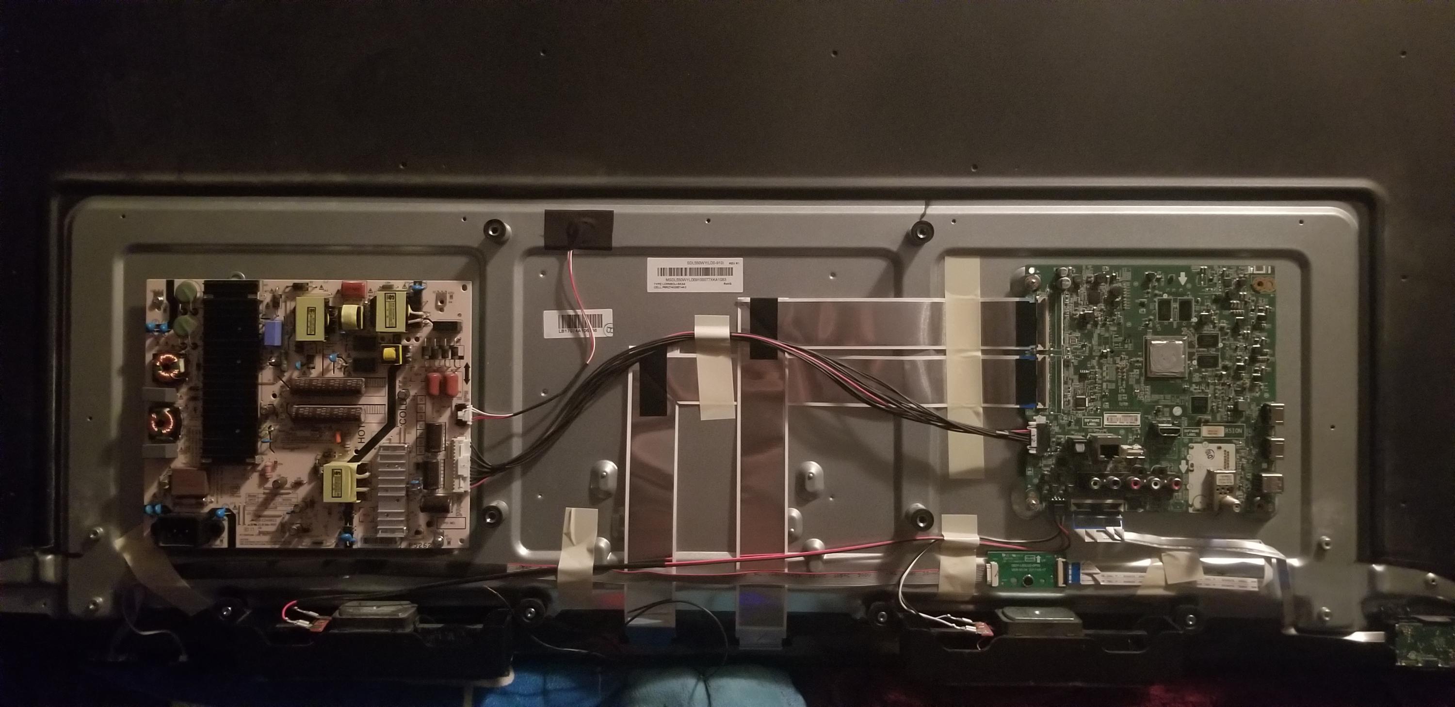

        Hi guys. I have similar issue as microvibe, no picture but hear sound. I tested the led strips and found one bed led. I replaced the led strip. When i powered on the tv backlights still didnt come on. But when i swithed it off half the strips flash once. The other led circuit doesnt respond at all.
        I checked the voltages. I got 13.2 volts going to the mainboard but no voltage measured in connection to leds.
        I purchased a new powerboard. When i power it on without leds or main board connected i still dont measure any voltage to the led connection. Same result when i connect those two. No when switching tv on or off leds dont flash at all.
        Is there something im doing wrong or i got a new faulty power supply board?
        Also i checked fuses. Problem is i see only two fuses. F1 and F3. Where is F2? LOL
            You are checking led voltage right at turn on? Compare old and new power board for voltage. What is inv_on voltage in standby and power on.
                              Need some clear pictures of front and back of power board.
