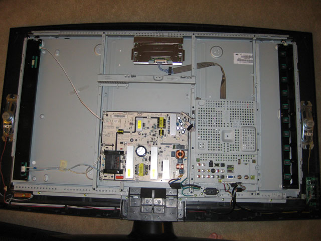

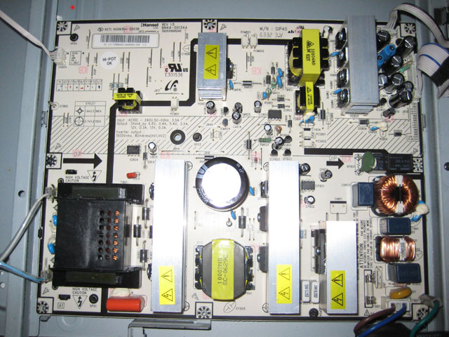

            After leaving the TV on for several hours, without warning, the backlights went off. Although audio is ok, the image can only be seen by using a flash light.
            I attached two pictures: 1) the circuit board where the power supply is (a total of 12 caps have been replaced) and 2) the back of the TV with all other components.
            Could you tell me which one is the transformer of the inverter? Is it the one behind the black plastic cover in the bottom left?
            Thanks!

              Re: Samsung LN-S4041D Repaired... Not Quite
              Thanks!
              I'm not sure about the design, but the area under the black cover on the lower left of the first picture is a high voltage transformer. There appear to be long black covers on the left and right sides. The leads from the transformer go under the lower corner of the one on the left, and there is also a ribbon cable running back to the power supply from the upper corner of that one.
                            So my Samsung LNS5051 with a BN44-00134A power supply developed an intermittent back light issue. I have had this set for a while and had replaced some of the secondary filter caps several years ago for slow to come on. Now I find two more puffed and replace them. Worked for a week then intermittent back light out again.
                            On closer inspection I found two mounting grounding pins on the heat-sink for Q801 & Q802 with cold solder joints. One of the heat-sink pins is providing a ground signal to some of the circuit.
                            Touched up the solder joints and it is too soon to tell but I have back light back and can turn on and off.
