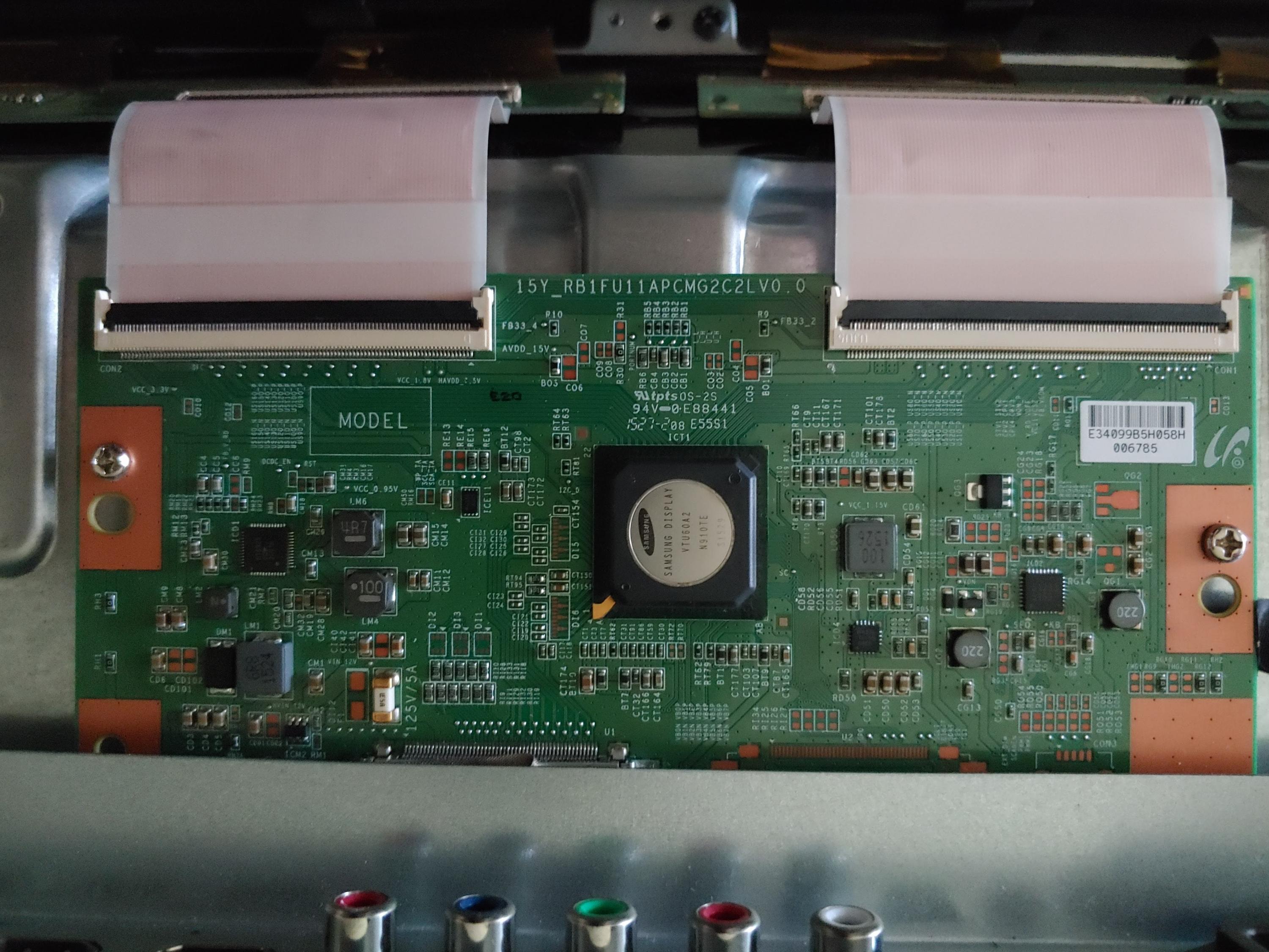

    Hi there, I have a rather interesting looking set of boards in this Wasabi Mango U400UHD TV (korean OEM), not much information available online.
    The components inside appear to be a mismatch of OEMs - the power board comes up as an RCA part? The TCON has Samsung logos on it, and there are no real identifiers on the mainboard, which I think is a generic part?

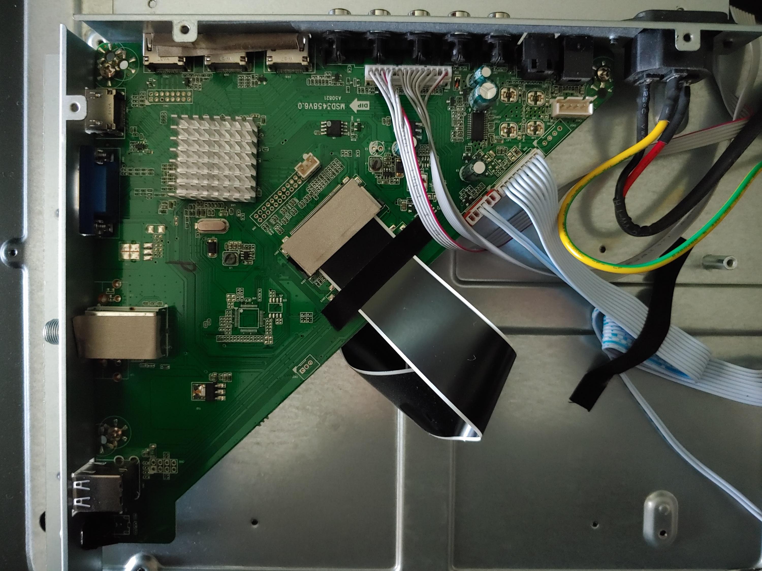

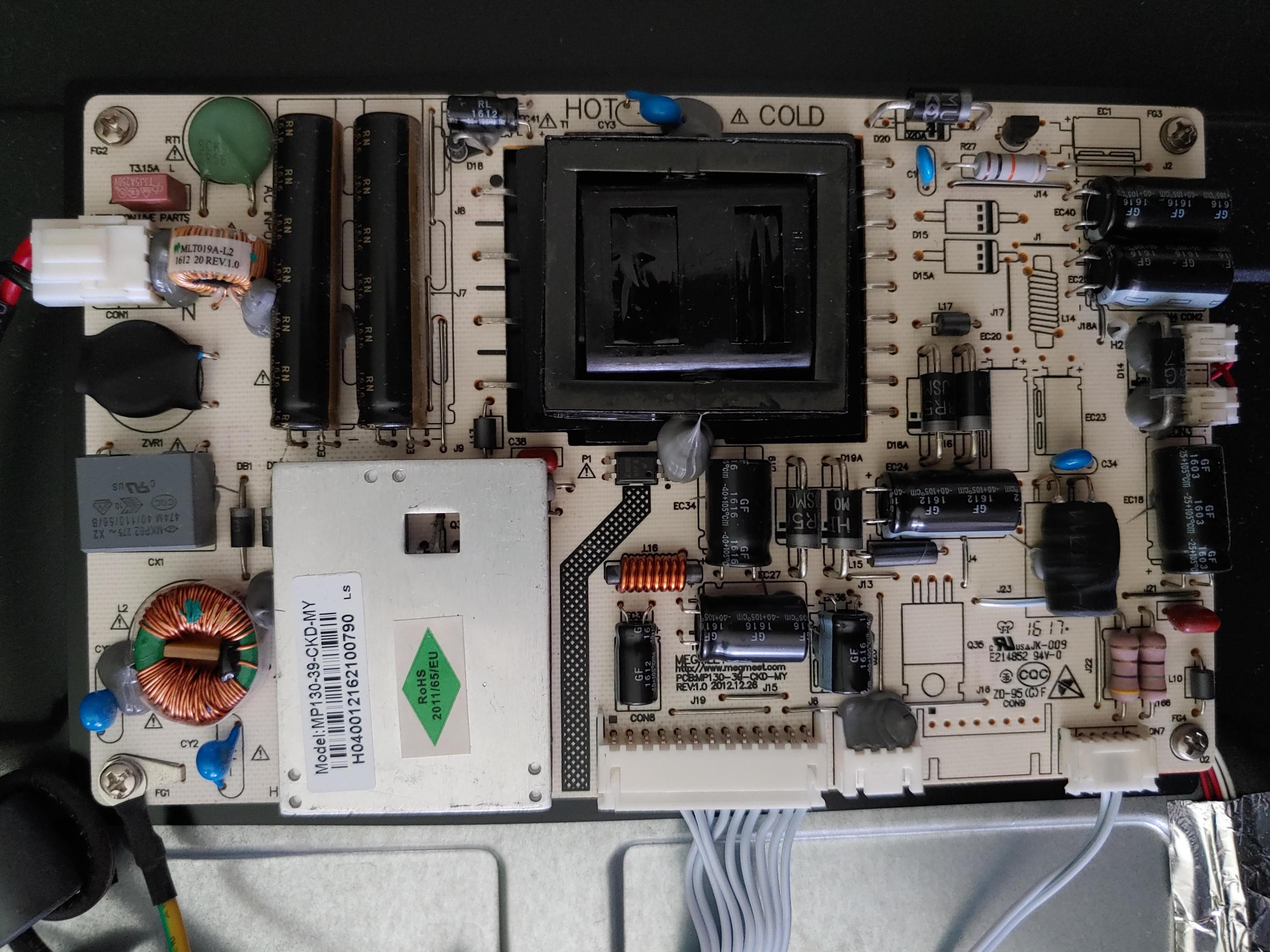

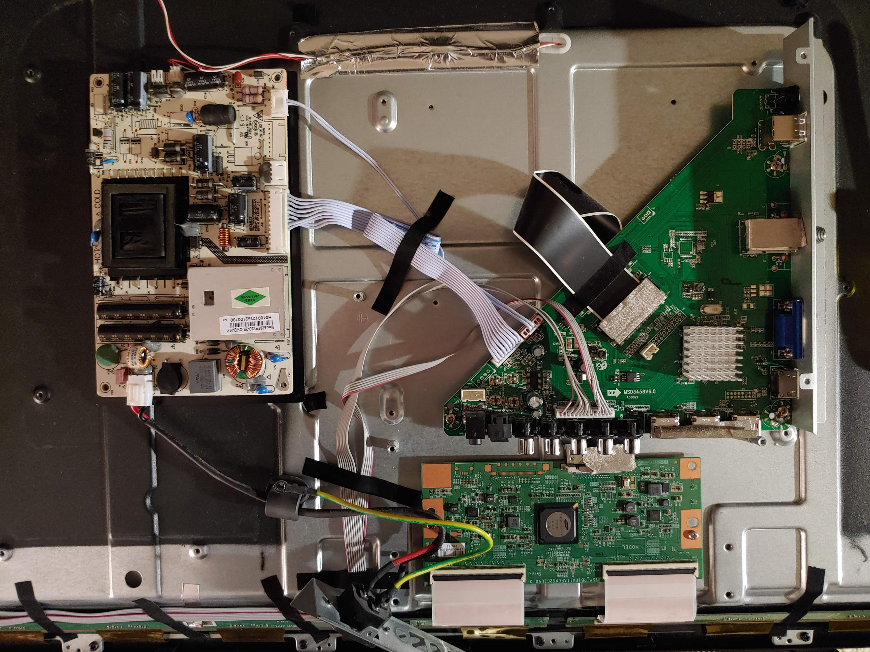

    Re: Help diagnosing no backlight and no picture - Wasabi Mango
    1) Can you show us the whole back side of the TV showing all the boards so we can see how they are connected together?
    2) Remove the power supply board and see if there are pin labels for the connectors printed on the bottom side of the board.

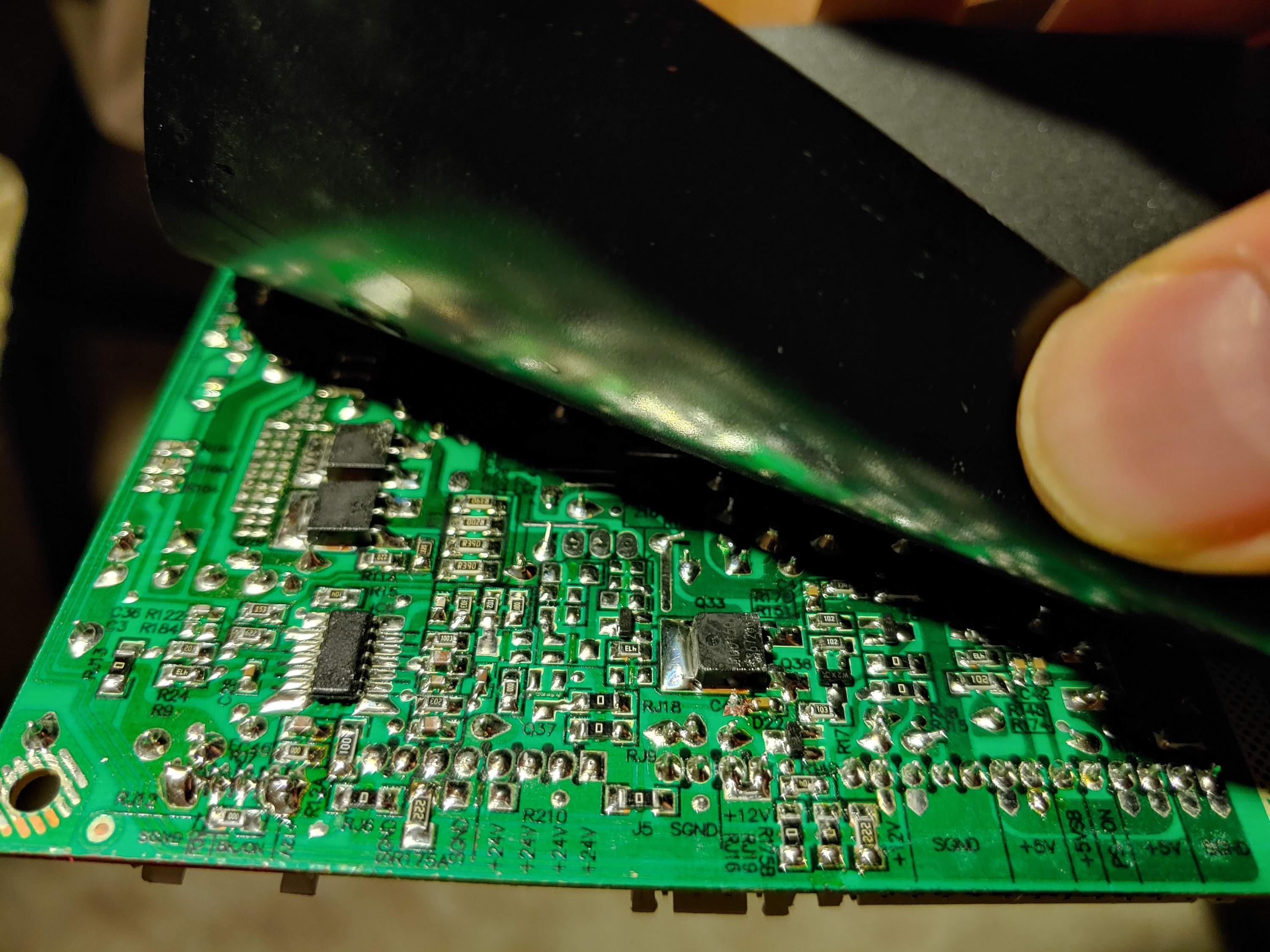

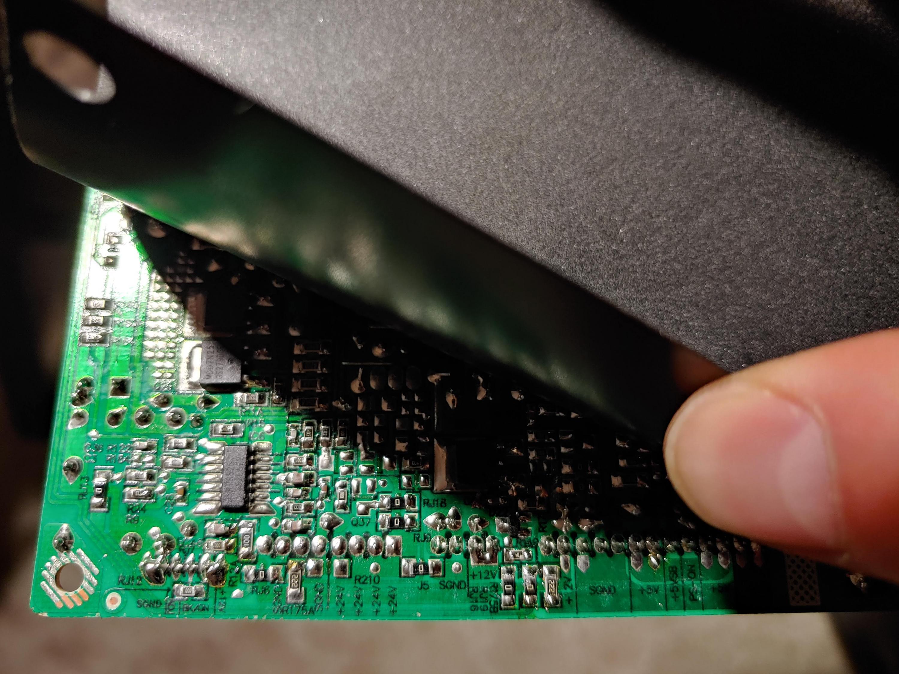

      Photos attached below. Thanks for the pointer to look behind the board. I'm guessing my next step will be to test the 5V and 24V outs to see if they're high when the power is on?
      There's unfortunately this plastic backing piece which is attached with pins that's rather hard to remove from the power board.
        Just took some measurements on the PSU - 5VSB line was about 5V with tv off, and measured 12.97V on the +12V line and 5.5V on the +5V line both on the bottom section and top section cables when powered up. Doesn't look like 24V pins are hooked up.
          There's also two other signal lines which look like PON and BK/ON for which the voltages have not been given
              What's happened to the solder joint of the component above D22 as in your photo 2 - 2 in post #3
                      Can you post a clear picture of the label you mention on the back of the powerboard?
                        There is no "label" per se, just a plastic shield behind the components on the back and where it's mounted against the metal back of the panel.
                        I've attached another angle of the back of the board, where it's more visible and the top pin outs are clearer. Is there anything else I should look out for?
