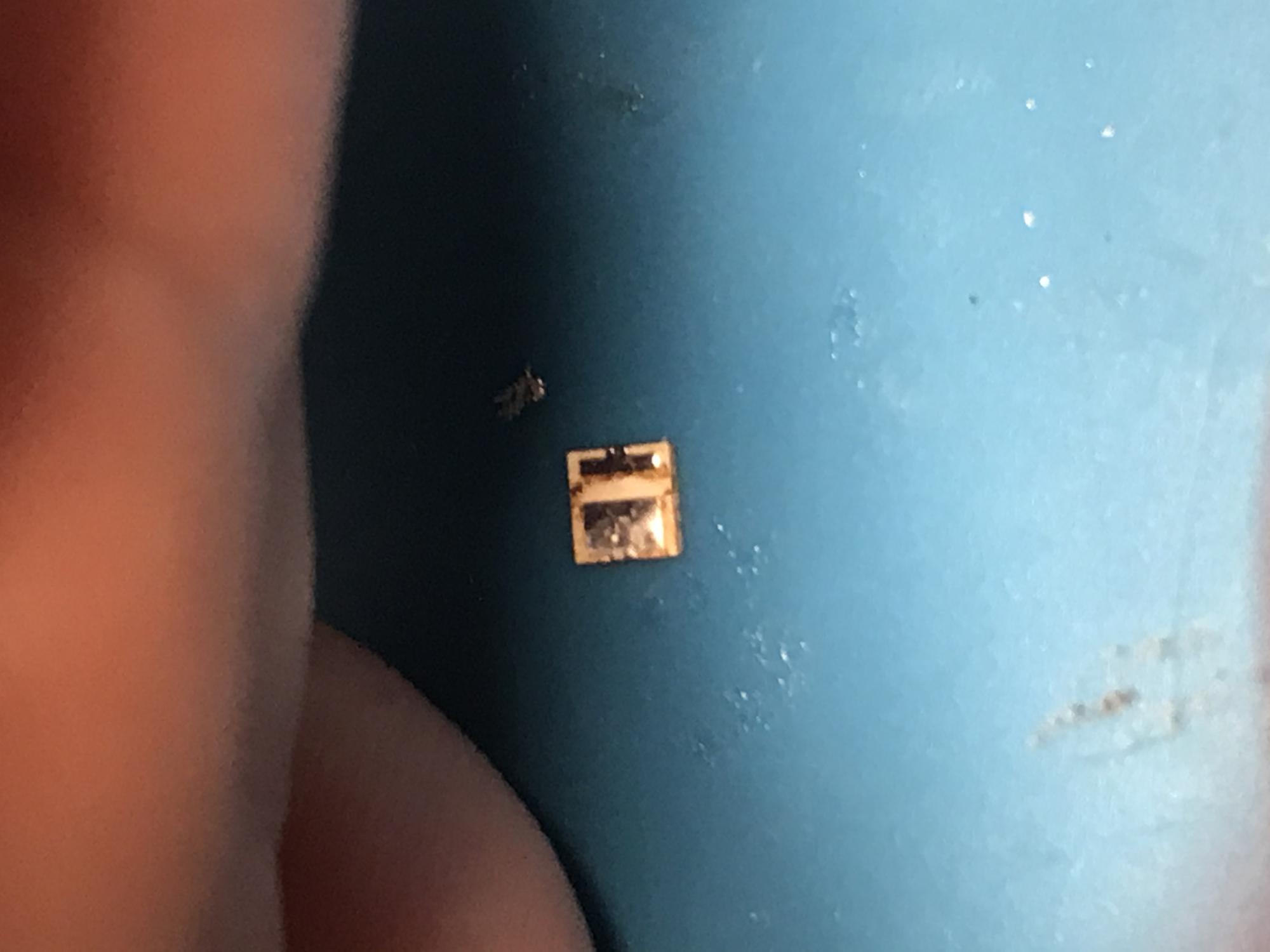

    These are the led's I ordered. The picture attached is a original led.
    https://www.digikey.ca/en/products/d...5AIoHAEIAugL5A
    My question is what should the correct led's be and is this what is causing the flicker?

    Re: Toshiba 58L1350UC LED Flicker
    Originally posted by Choons2091
    When using diode mode all the led's faintly turn on but when my leads are reversed THE ONES THAT HAVE BEEN REPLACED SHOW OL while old ones give .75
    the one you replaced could be normal LED with out ziner diode ( not for TV BL ) or its had but the ziner diode Open ( defect )

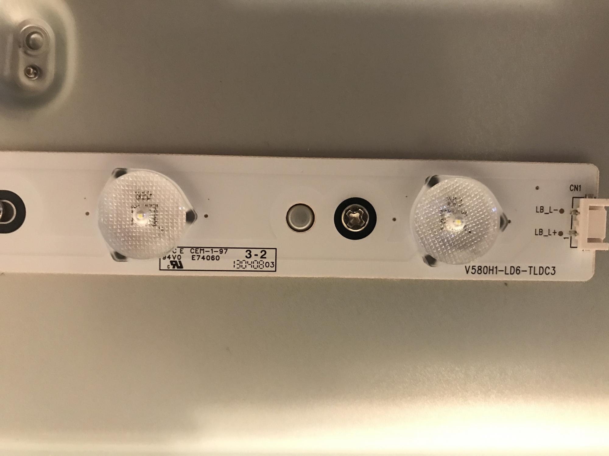

          Alrighty thanks for the tip. One more thing, how do you know what the correct led is to order? I now know to get it with a diode and using a power supply i determined it is in the 6V range but how about watts?

            how do you know its 6V LED?
            on the strings of led there are label show us here,,, and show us one of the old / original ( defect) one which you need to measure its size in mm (Millimeter) so you know the type / size) for example LED Type 3030 its 30mm x 30mm , and you need to see the downside of the LED ( the chassis figure ) to pass on yours strings chassis.

              Uploaded request! I used a power source to test a good led and achieved a good brightness at 6V. I know this is not a very accurate way to do it.... Open to suggestions.
              Size is .118 X .118"" or 3mm X 3mm
              Height: 0.020"" (0.52mm)

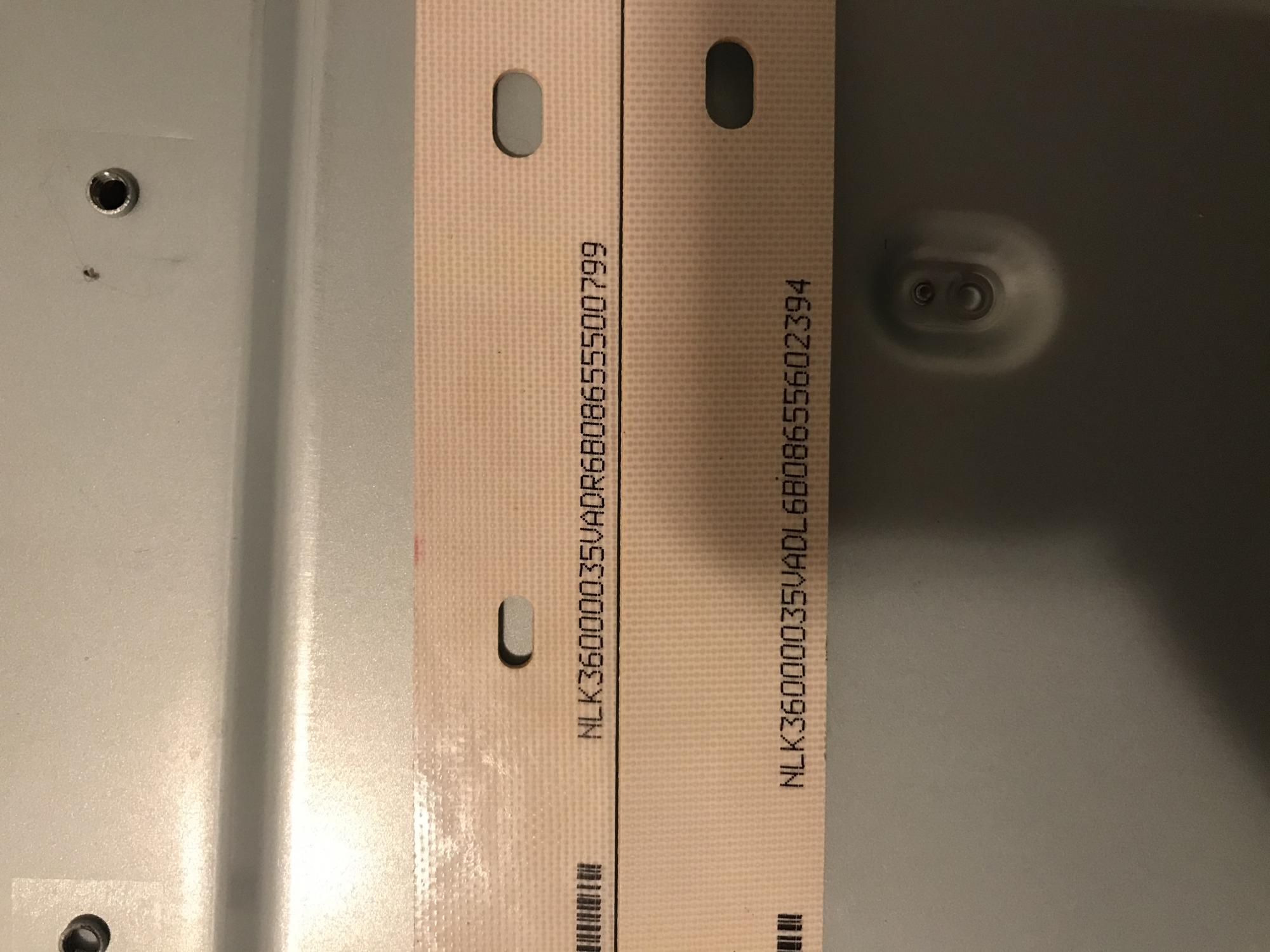

                look if you have another label on the string. but i can say they are 3030 6V 1W
                normally if you have found as you wrote couples failed led on one strings row. mean you have open soldering joints at the strings socket need to rework them

                  I attached the only other label which was on the back of the string. Sounds good Diah i will rework them. What makes you think they are 1 watt instead of 2?

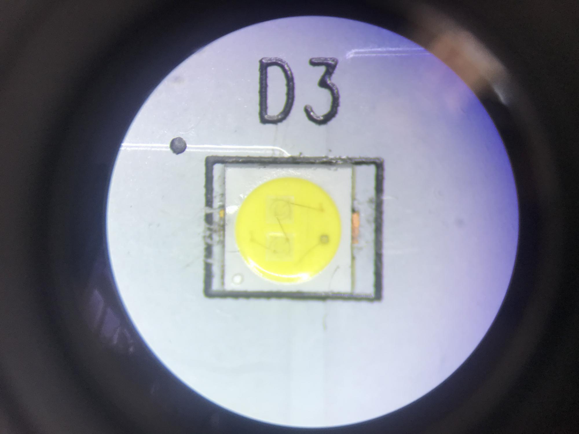

                          OK so i just checked and it is very difficult to make out. It's either one large square led but I think its 2 small rectangles. On my original post I attached a picture of the led under a microscope.

                            I now have welders flash but am confident it is 2 leds lol
                              https://www.badcaps.net/forum/attach...8&d=1612741555
                              The two squares you see in the picture of your LED are the LED dies and they are connected in series with bonding wires as you can see in your picture.
