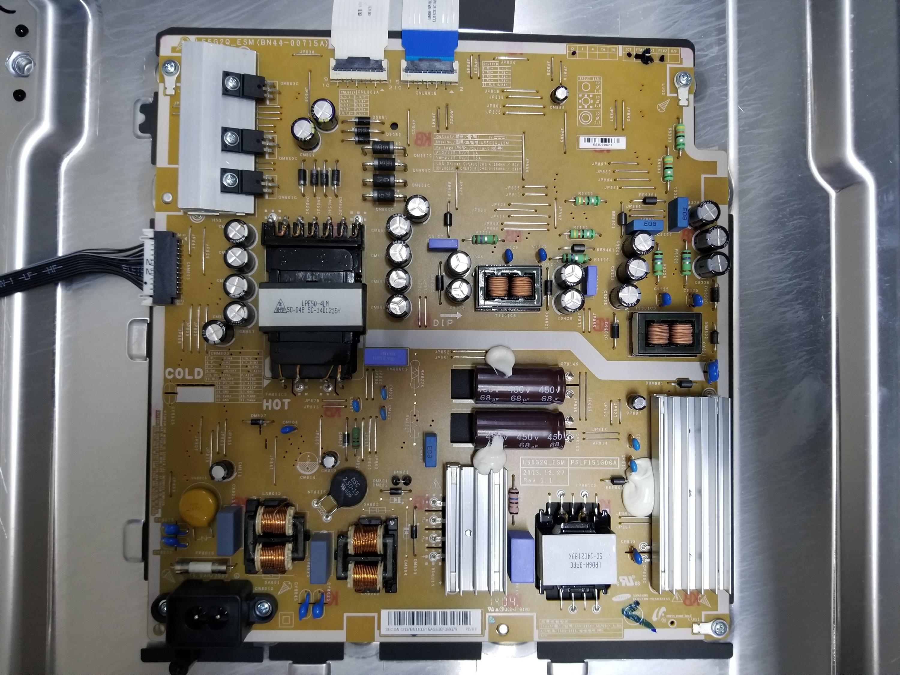

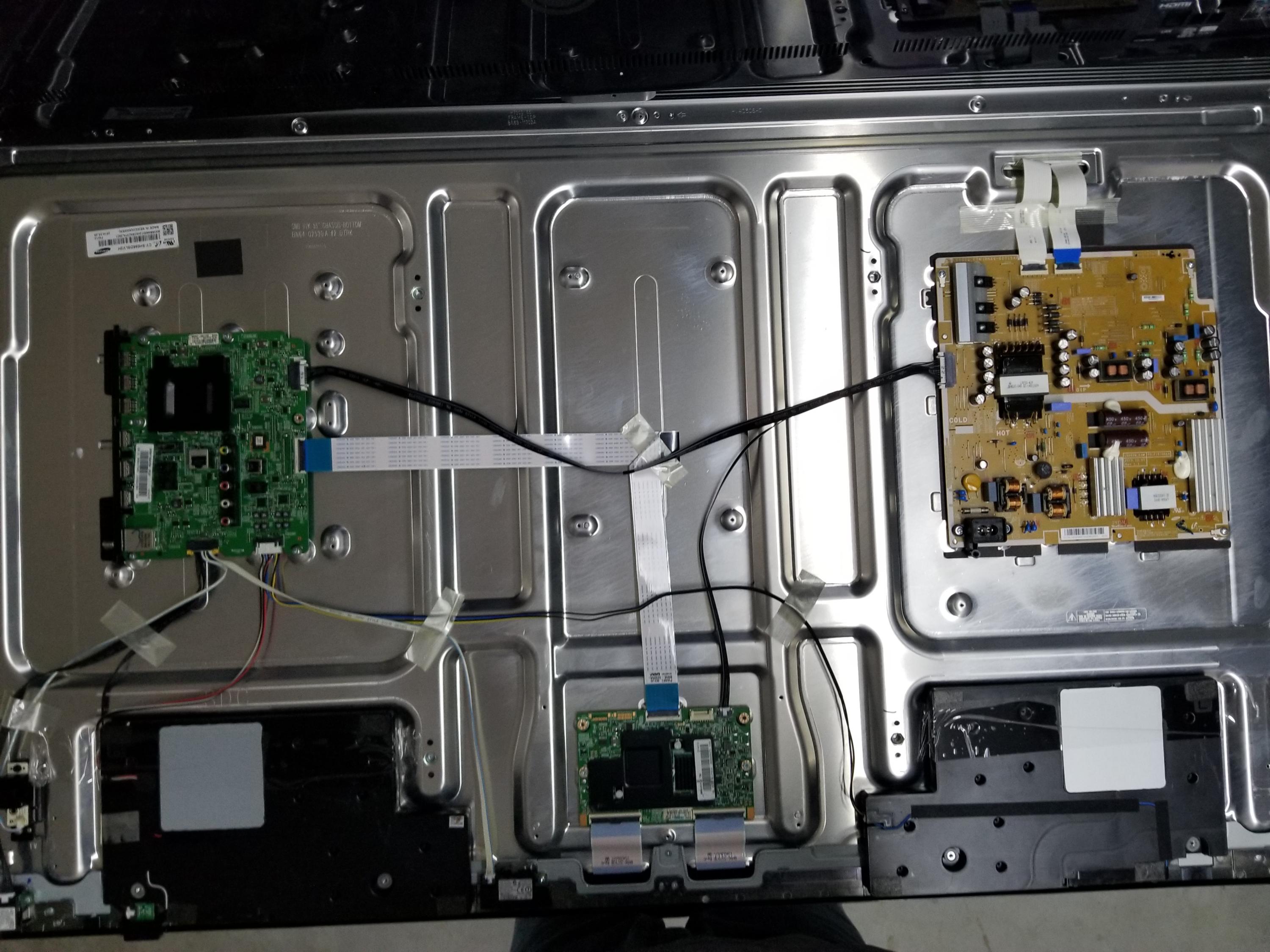

    I'm looking at a Samsung Model # UN55H7150AF. When I plug in TV, without using the remote, the TV comes on to the splash screen and it stays on for 2 sec. goes to app screen for 15 secs then goes black for 2 secs then back to the splash screen. It continues to repeat this process.
    I used "mute+1+8+2+power" sequence to get into option screen. I got in the Option menu and it stayed on for about 12 secs then went back to the loop. I couldn't move around in option menu at all. Any ideas with TV doing as I describe?
    Attached are photos.

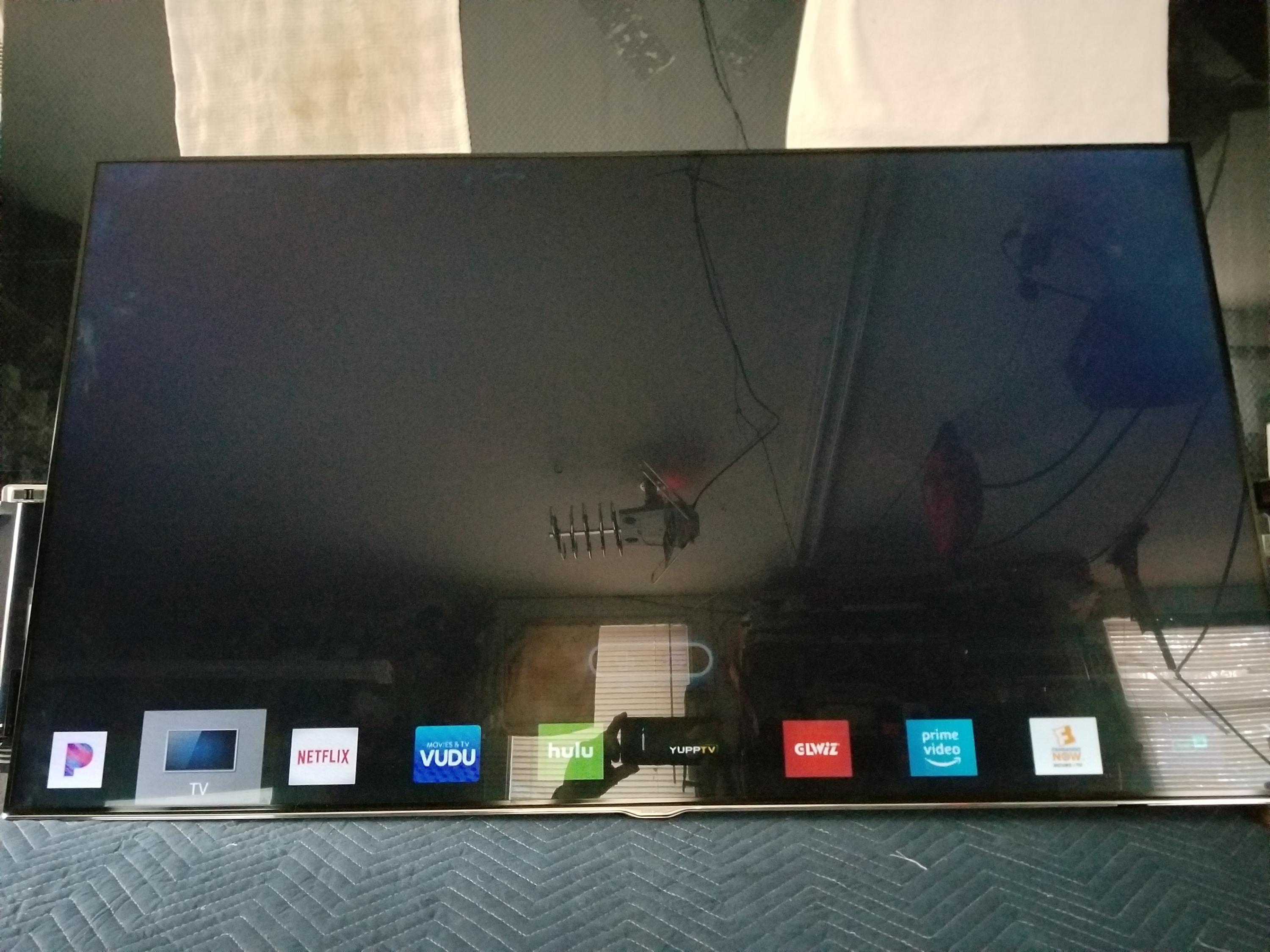

            before you was able to use the remote when you interred service menu??
            can you show me the page of app it started with before rebooting?

                Re: Samsung Model # UN55H7150AF in startup loop
                Yes.. the remote will get me into the option screen but won't work once I'm in it, nor will it operate anything while TV is in the loop process. Attached it a photo while TV is in the 15 sec. app screen.
                  its normal start tv as it show the portal on down line..its chip corrupted.. you need to do reset first via service menu to see if it correct the chip
                    your photos it show the set are on TV source...
                    if the TV tuner got defect or shorted of any reason the issue will be same as you have..
                    plug the TV with internet LAN cable. and as soon the the screen show you as the photo very fast move on RC with right arrow to the app next to TV and press OK..

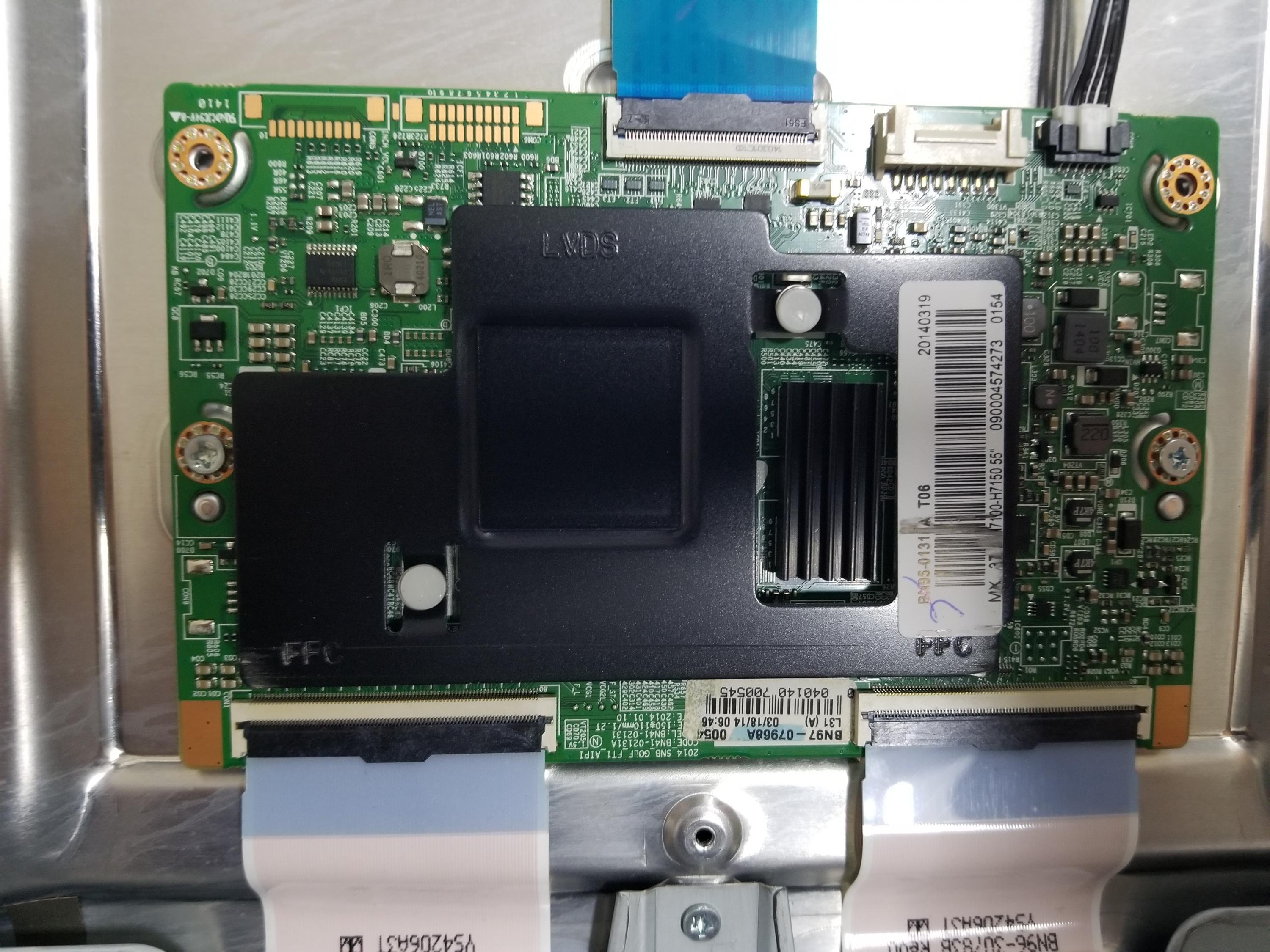

                              last check ... unplug one ribbon cable between t-con and panel and test if it same issue remain...
                              • rplewis
                                • Sep 2015
                                • 82
                                No good...

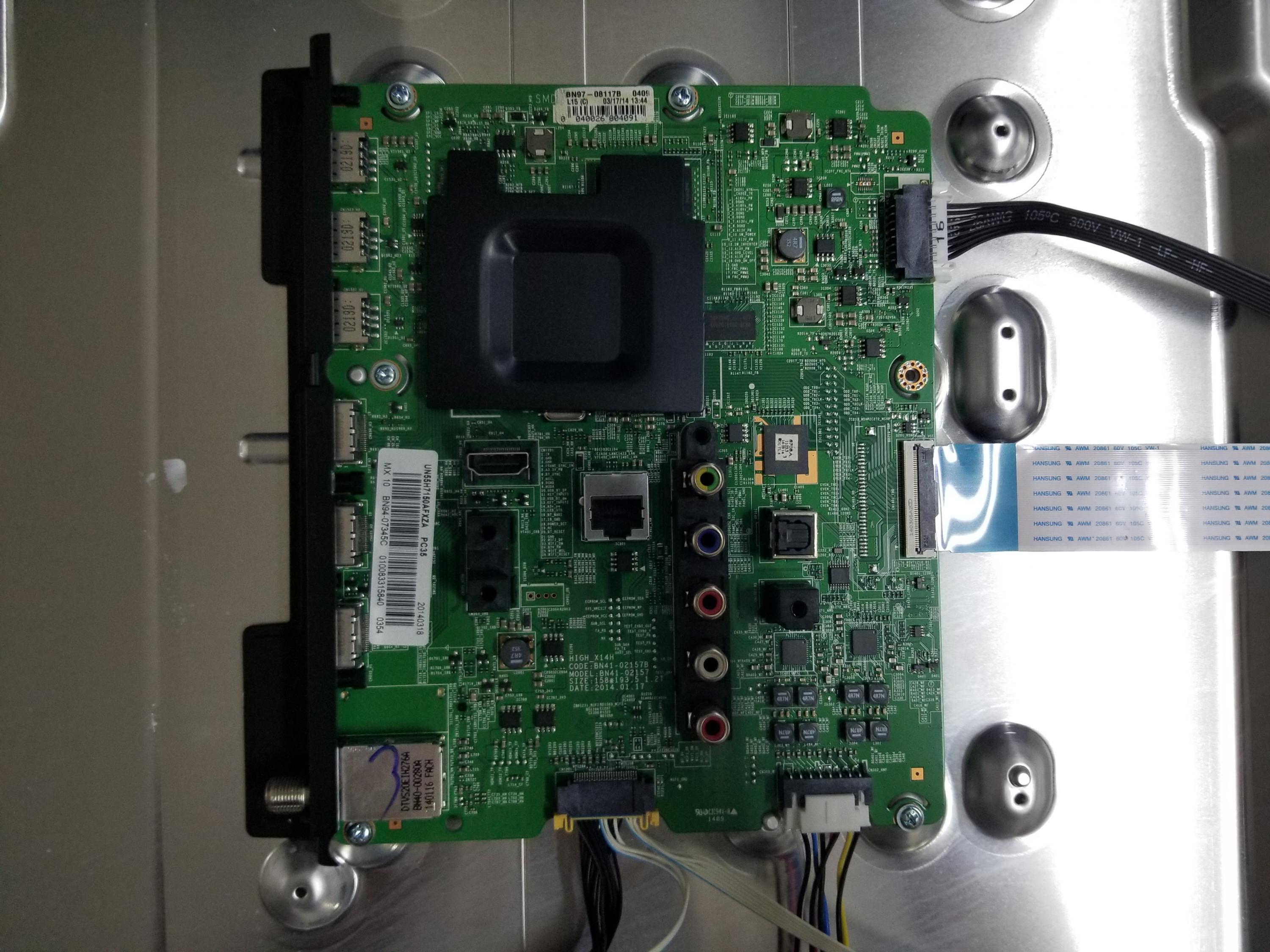

                                  LOL.. disconnect any things connected to main boards leave only the LVDS and the socket with PSU... if no good... time to replace MB or use heat instate feeze to the chips i told you
                                  • rplewis
                                    • Sep 2015
                                    • 82
                                    No luck.... Been looking for main board.... everyone is out of stock or not cost effective.
