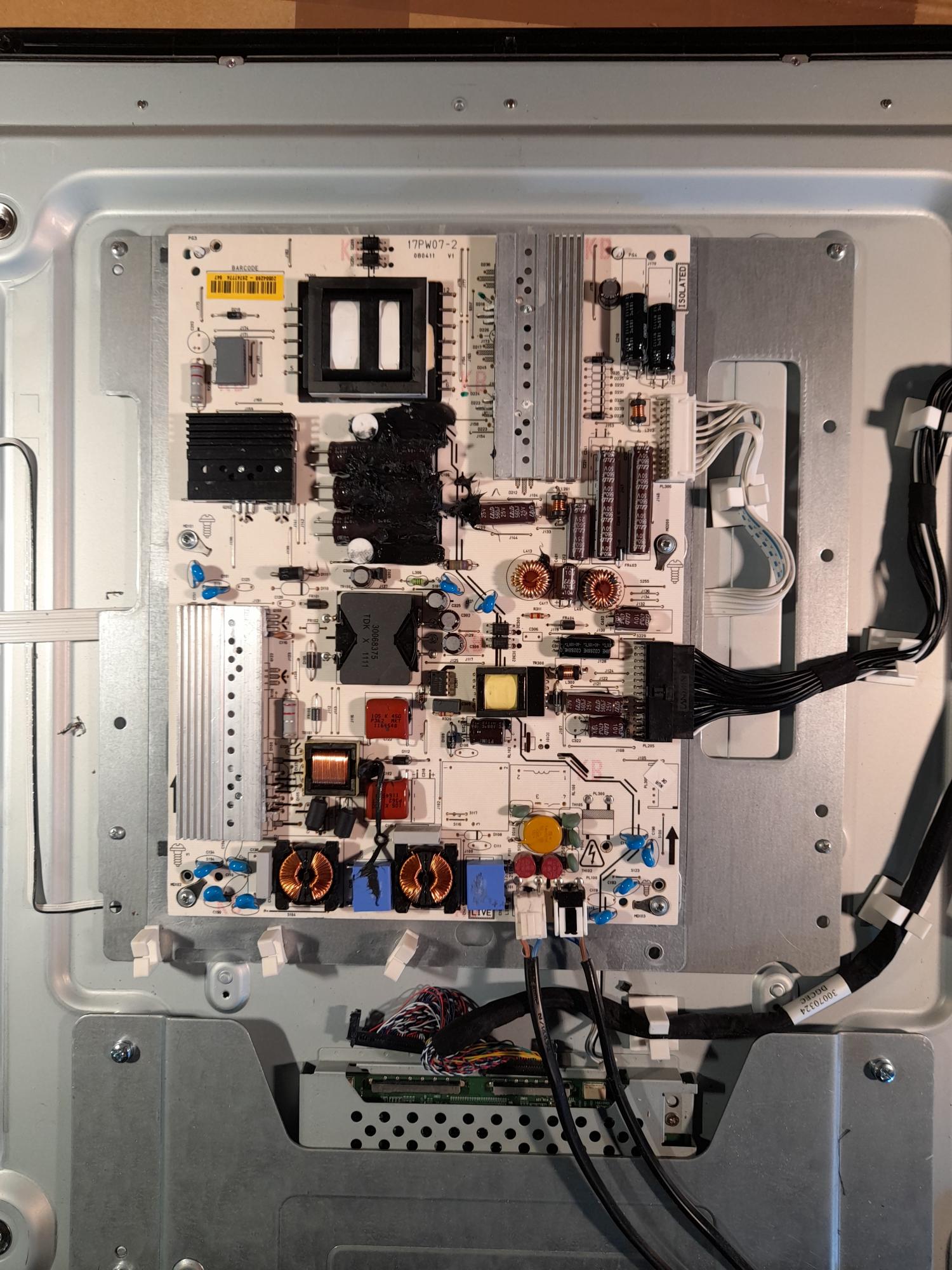

    With regard to the U3 Mosfet the readings with reference to ground on the 220uF/35V cap:
    (this in powered on mode with the front LED pulsing Red/Green)
    Drain 0.035V
    Gate 24.15v
    Source 24.19

      I remeasured everything on CN3 with the LED strings connected in standby and ON modes.
      Standby
      Pin-1 VCC
      Pin-2 V between P1 & P2 1.672v
      Pin-3 V between P1 & P3 1.187v
      Pin-4 No Connection
      Pin-5 VCC
      Pin-6 V between P5 & P6 1.745v
      Pin-7 V between P5 & P7 1.685v
      ON
      Pin-1 VCC
      Pin-2 V between P1 & P2 10.52v
      Pin-3 V between P1 & P3 10.36v
      Pin-4 No Connection
      Pin-5 VCC
      Pin-6 V between P5 & P6 10.32v
      Pin-7 V between P5 & P7 10.48v

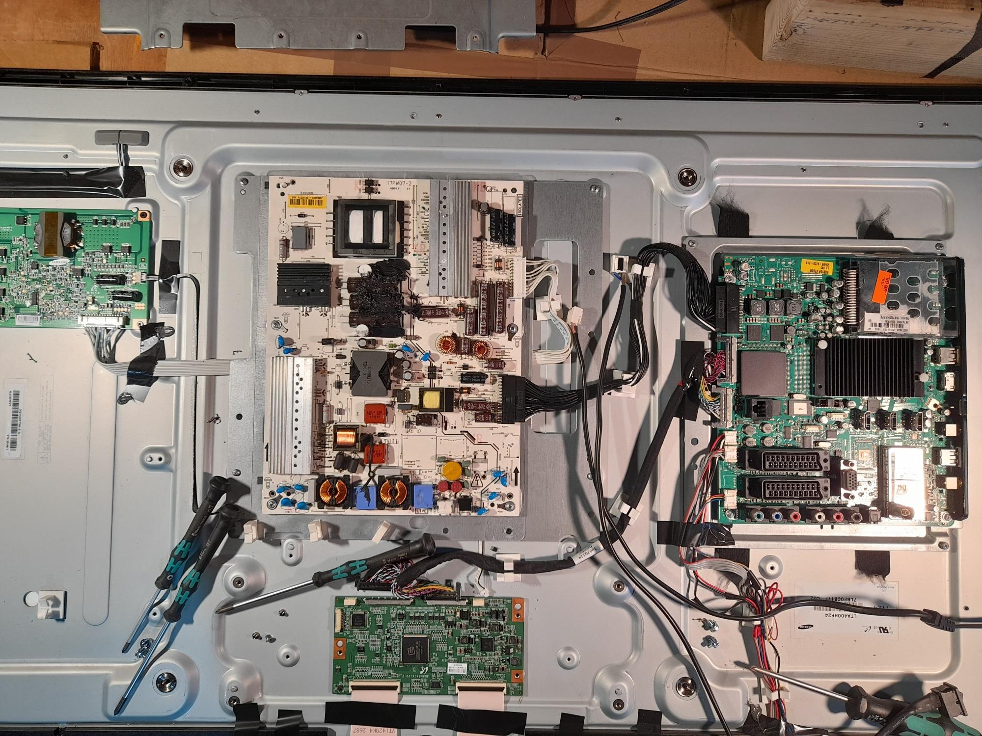

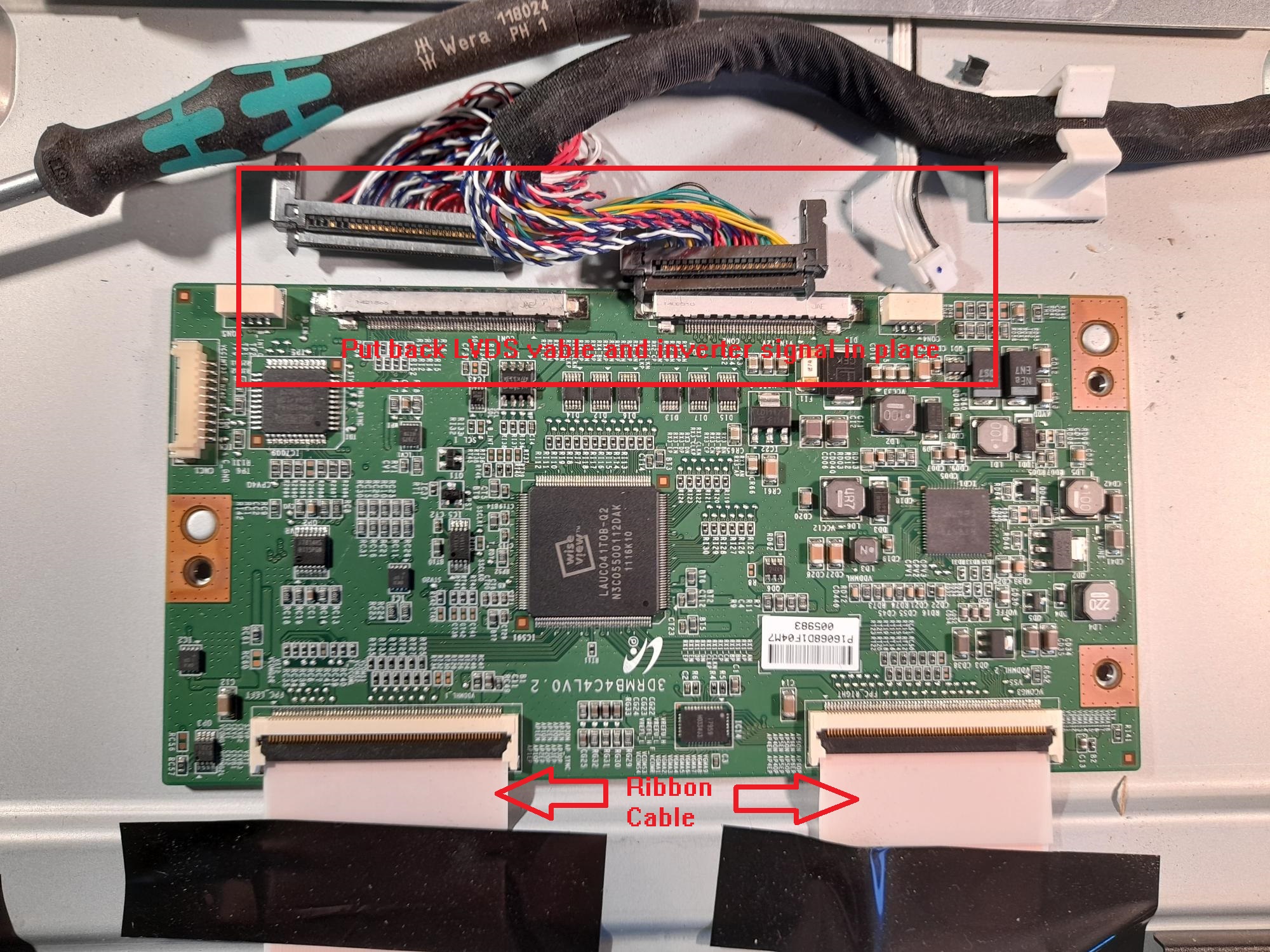

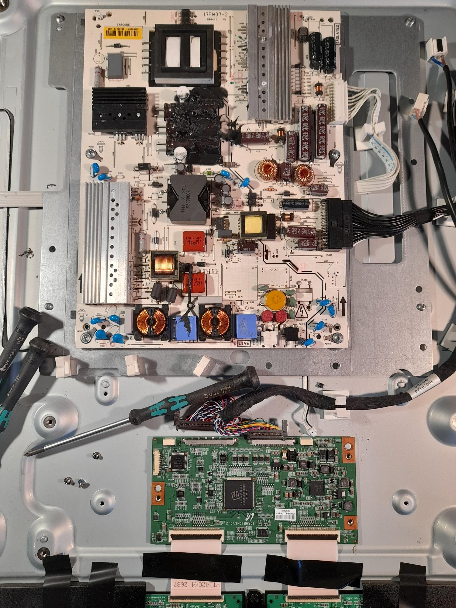

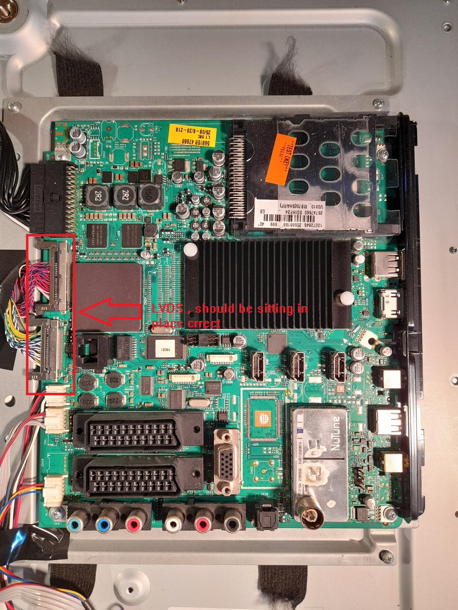

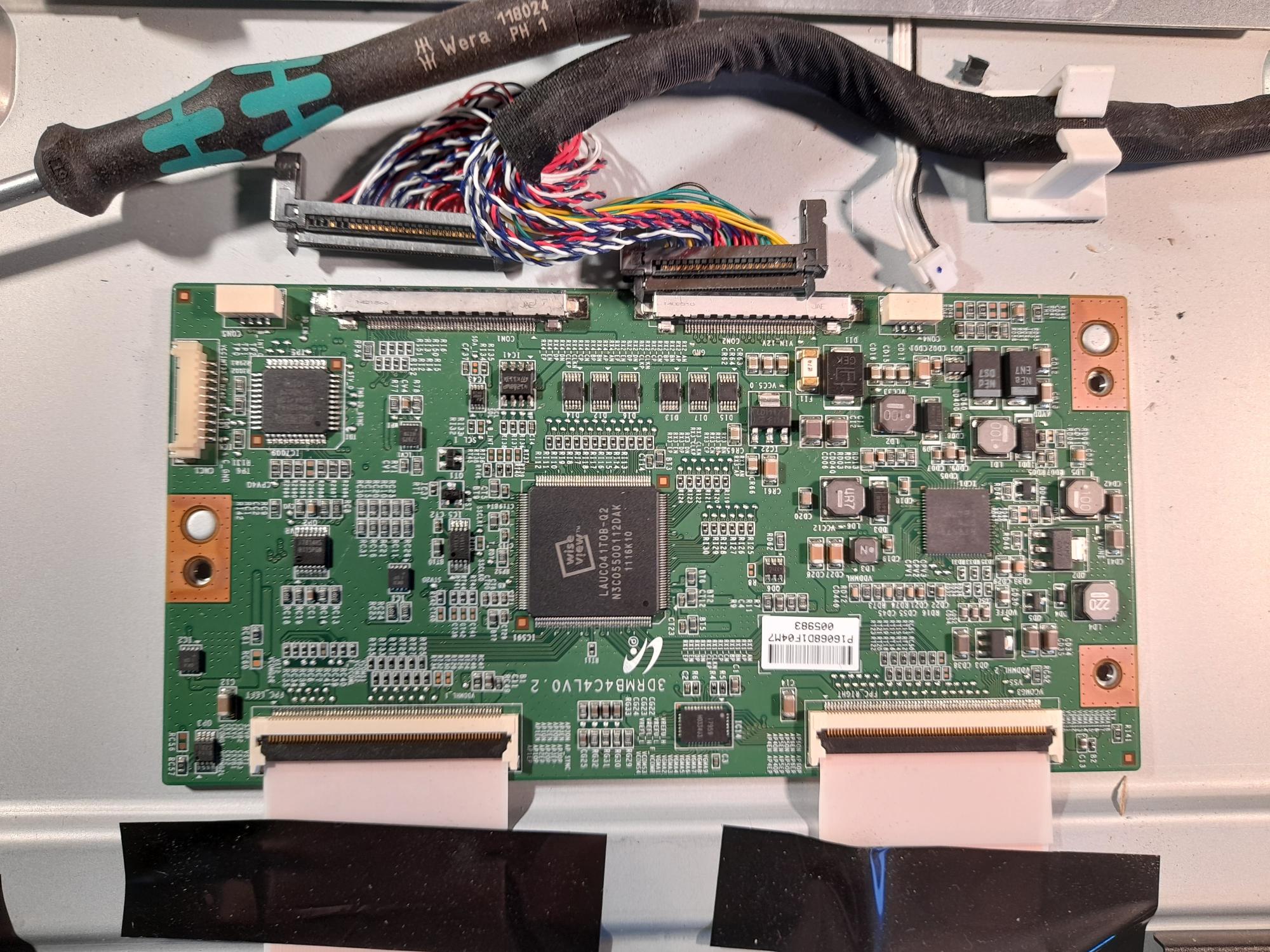

        try to disconnect the screen totally from the T-CON ( disconnect the ribbon cable from t_CON side ) and see did the set come on or the BL turn on ?

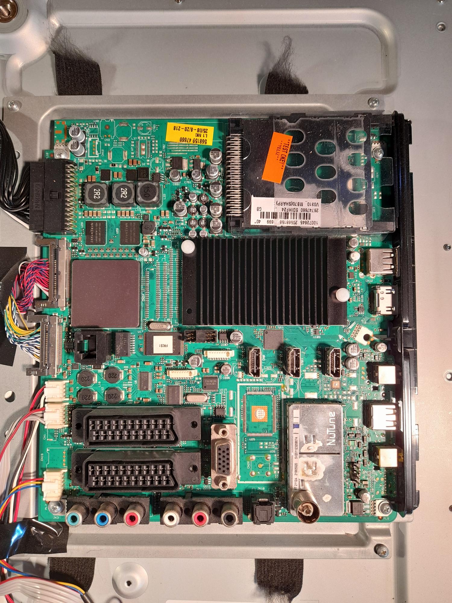

        show me please photo on yours Main boards and T-CON

          Re: Sharp LC40LE531E Red/Green flashing LED
          I disconnected the T-Con board and power on but there was no change. The LED arrays did not light (they remained at approx 10.5V)

            Man--- i wrote at my post #23 to disconnect the screen ( panel ) from T-CON ( ribbon cable are the 2 flat one connected between T-CON and panel )... also the T-CON should be stay in place and it connected to the LED inverter and to the main boards via 2 LVDS cable
            BTW. the LVDS cable are not plugged good at the main boards... you should let them in place.
              Please forgive my ignorance.
              When you said to disconnect the T-Con board, I assumed that was disconnecting it from the digital and inverter boards.
              Do you want me to reconnect these connectors and disconnect the lower ribbon cables?
              EDIT: I have reseated the T-Con connectors on the logic board.
              I disconnected the ribbon cables from the bottom of the TCon board.
              No change going from standby to On
                did you saw the photo of the main boards i made remark on it ?????

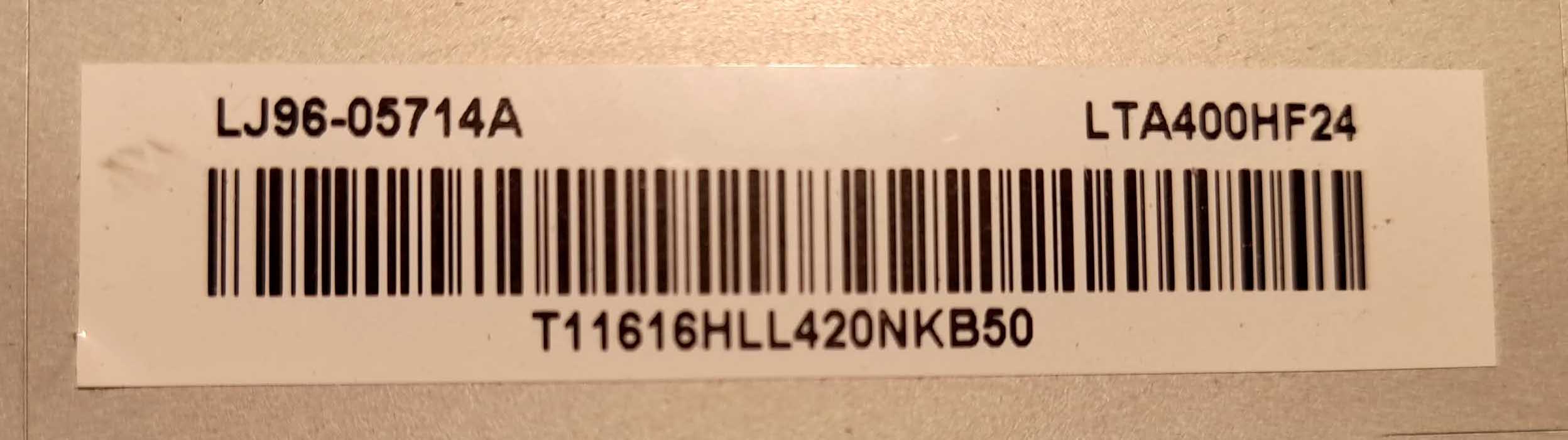

                  i think your issue fault at firmware bootloader section.. as your main boards Vestel 17Mb70.
                  you need to know which type of panel you have ... in case its LG panel.. then use this file.. extract the zip and put all 3 file

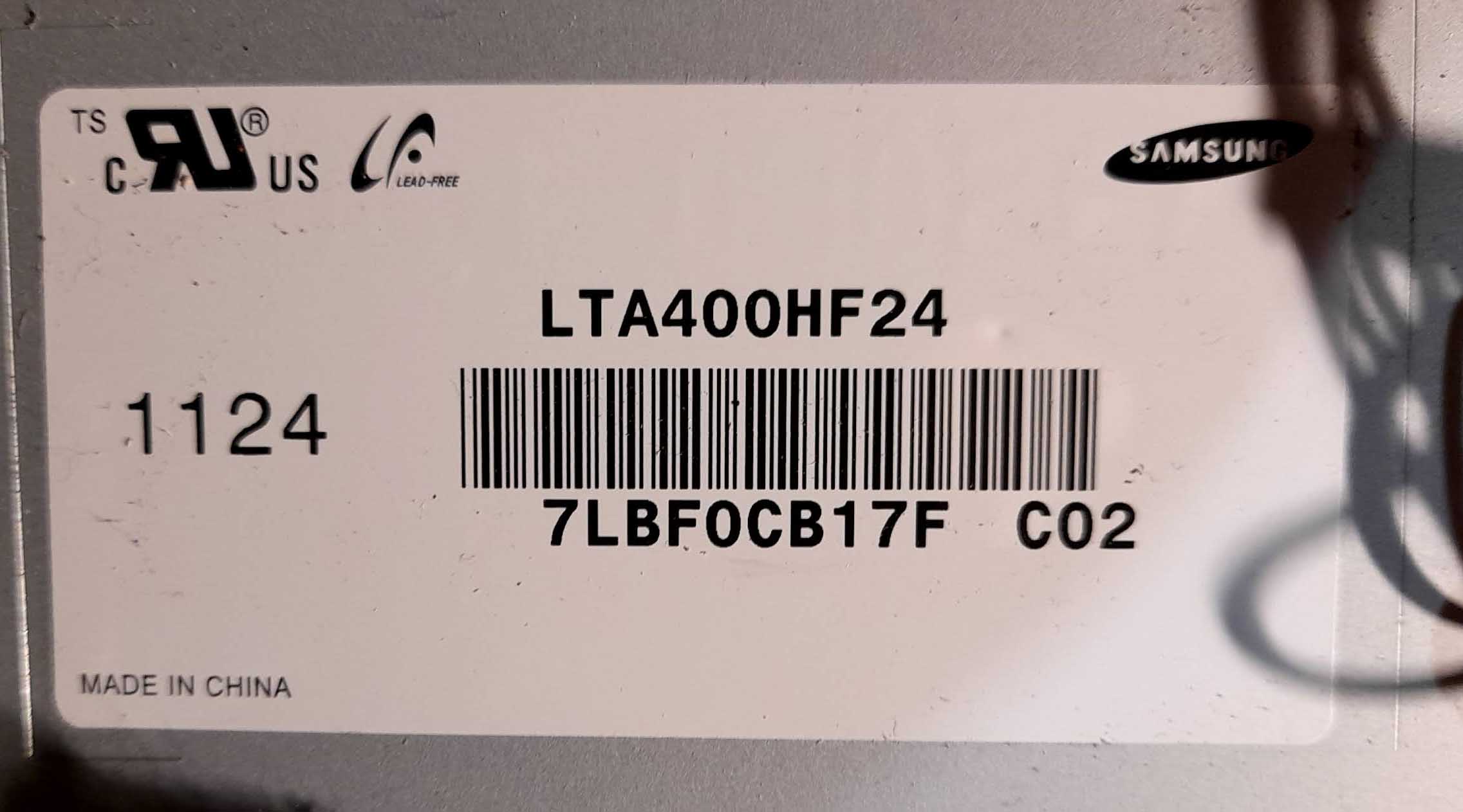

                    It's an Samsung screen I think:
                    https://www.badcaps.net/forum/attach...1&d=1610654324

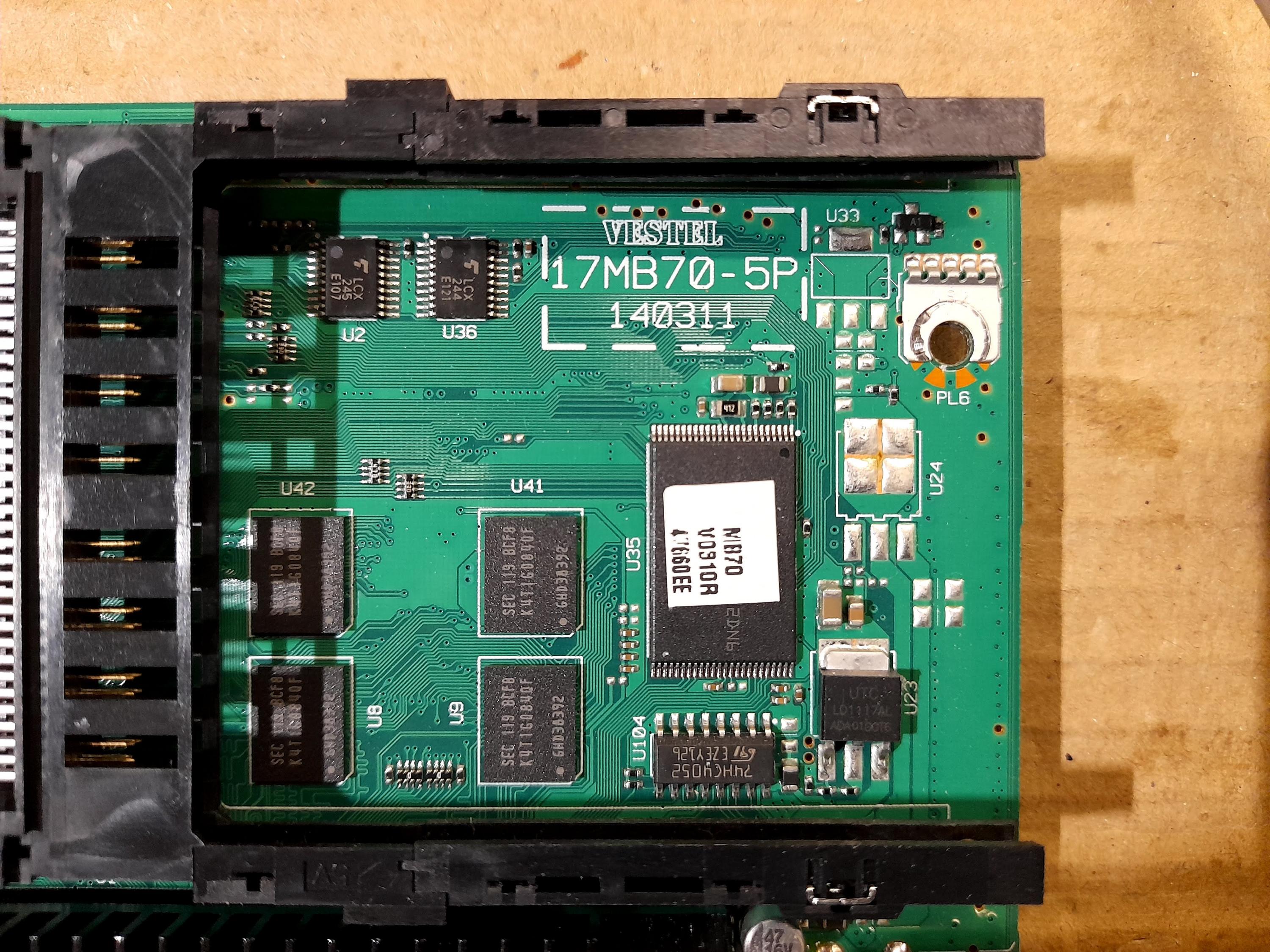

                      on the mainboard under the cover CI decoder socket ( where there yellow label TEST OKAY ) if you remove the cover you will have the boards label printed .. upload photo of it. )
                      • Nevillet
                        This the right ID label?
                          okay thanks... forget my bootloader file... yours set bootloader 100% okay...
                          you have BGA issue
                          take the mainboards out side and heat it very well with hot air gun specially under side where the black heatsink covered cpu and other 2 chips. leave it cool down and then put it in place
                          EDIT:
                          it could be main firmware too... i have many with LG panel driver ( medion sets) either modified firmware too and autorun.sh
                          at end here are documentation service manual and schematic to this boards.

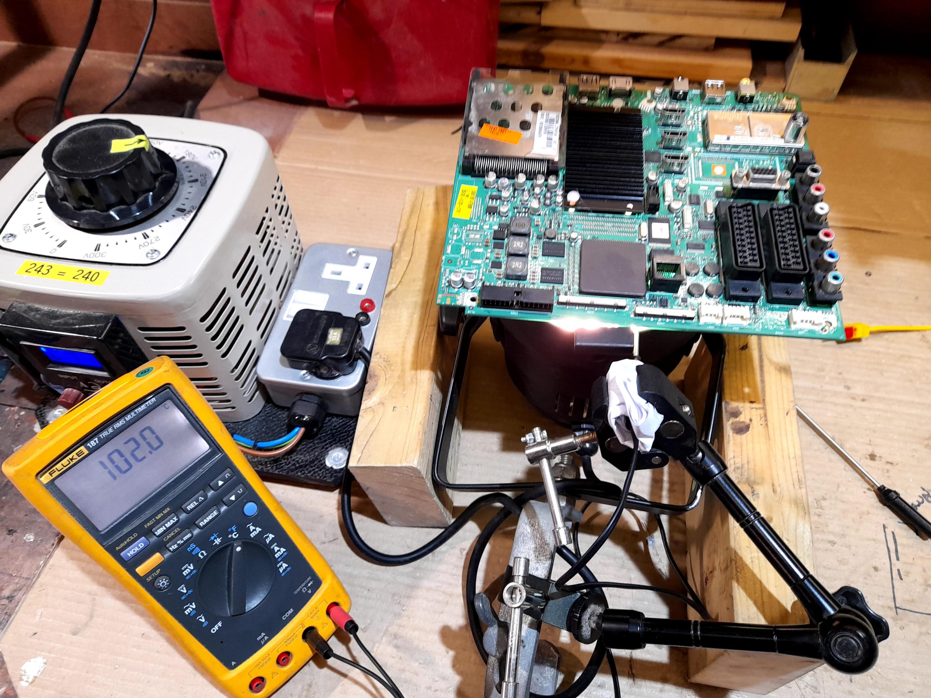

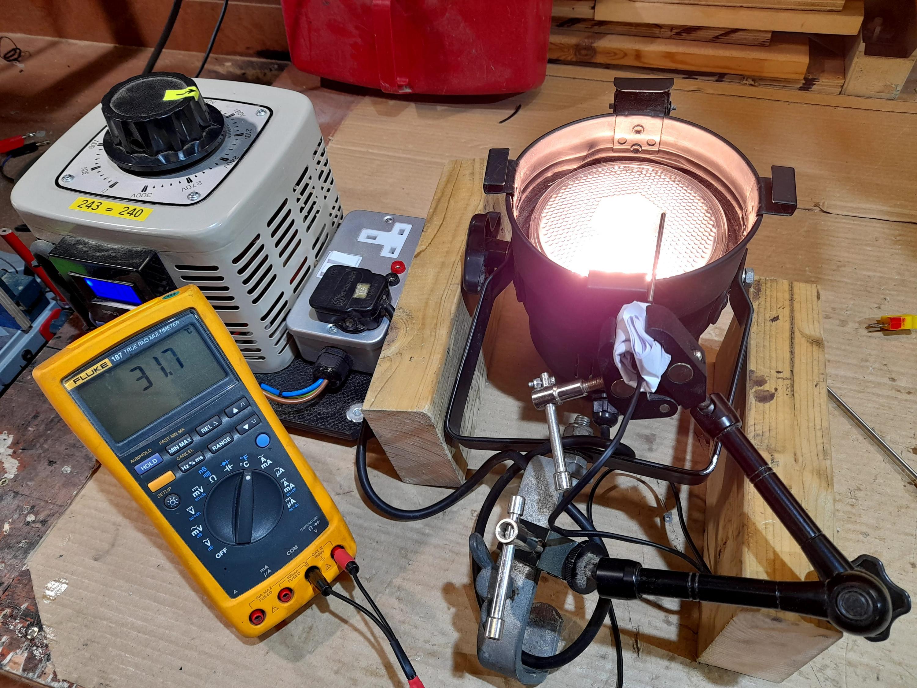

                                I removed the main digital board and heated the large BGA chips for a few minutes - then let them cool and reassembled.
                                I now only have the red standby and it will not turn on as it did before...
                                Have I fully broken it now?

                                  no you didnt... the BGA still there.. do it again and search for firmware for yours mainboards 17MB70-5P with samsung panel driver..

                                      what are you doing LOL ... bad idea.. because if there SMT parts at bottom side of the boards all will fill down... !!!!!!

                                        ...this TV has driven me crazy!!!
                                        Anyhow after my (bad) light bulb trick it it now as it was before.
                                        So solid red with power, then red/green flash on front panel button press...
