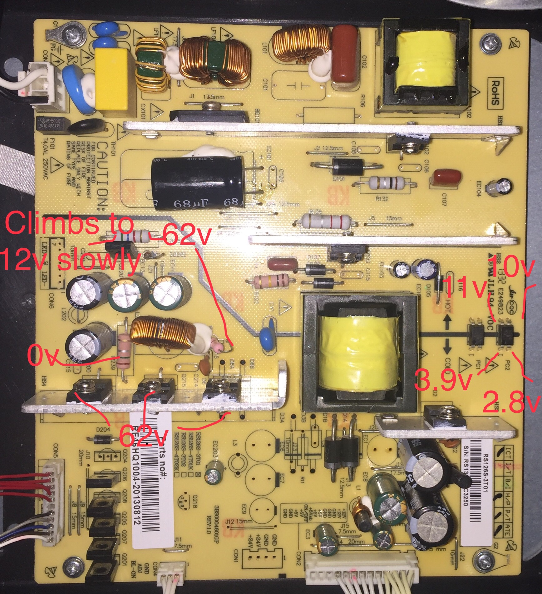

              Re: Sound and picture but no backlight
              While I was at it, I saw 0v at the leg closest to the backlight header, gnd in center and .5v at the other leg on all q201,207,205,208 and 206. Both stdby and on. R255 had 67 on one side and climbs very slow to 12 on the other, R239 had 0v on both sides. I made a messy picture of a few measurements. D1a and D1b had -0v on anode and 5 on cathode side when powered on. D204 has 0v at all times.

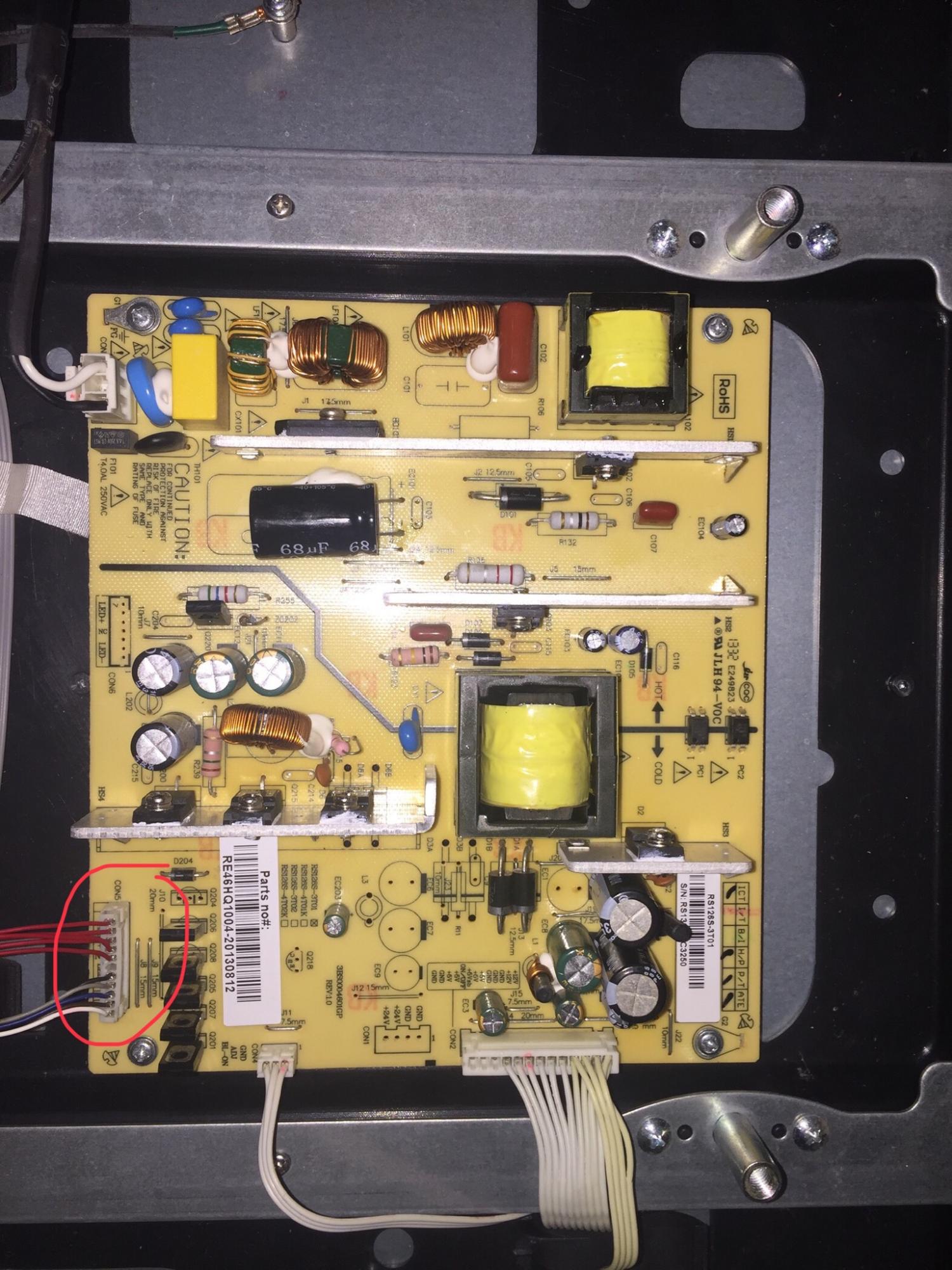

                i think yours measurements points not as the points other suggested.. you need the measurements on the LED SOCKETS
                  Those were taken at the led sockets, plugged and unplugged same results.
                            Can you measure the voltage on the pins of U200. It may give some insight into what the problem could be.

                                        #39
                                        11.2 on leg 1
                                        4.6 on leg 8
                                        1.7 on leg 7
                                        6 on leg 6
                                        2,3,4,5 0v
                                        All cables connected
