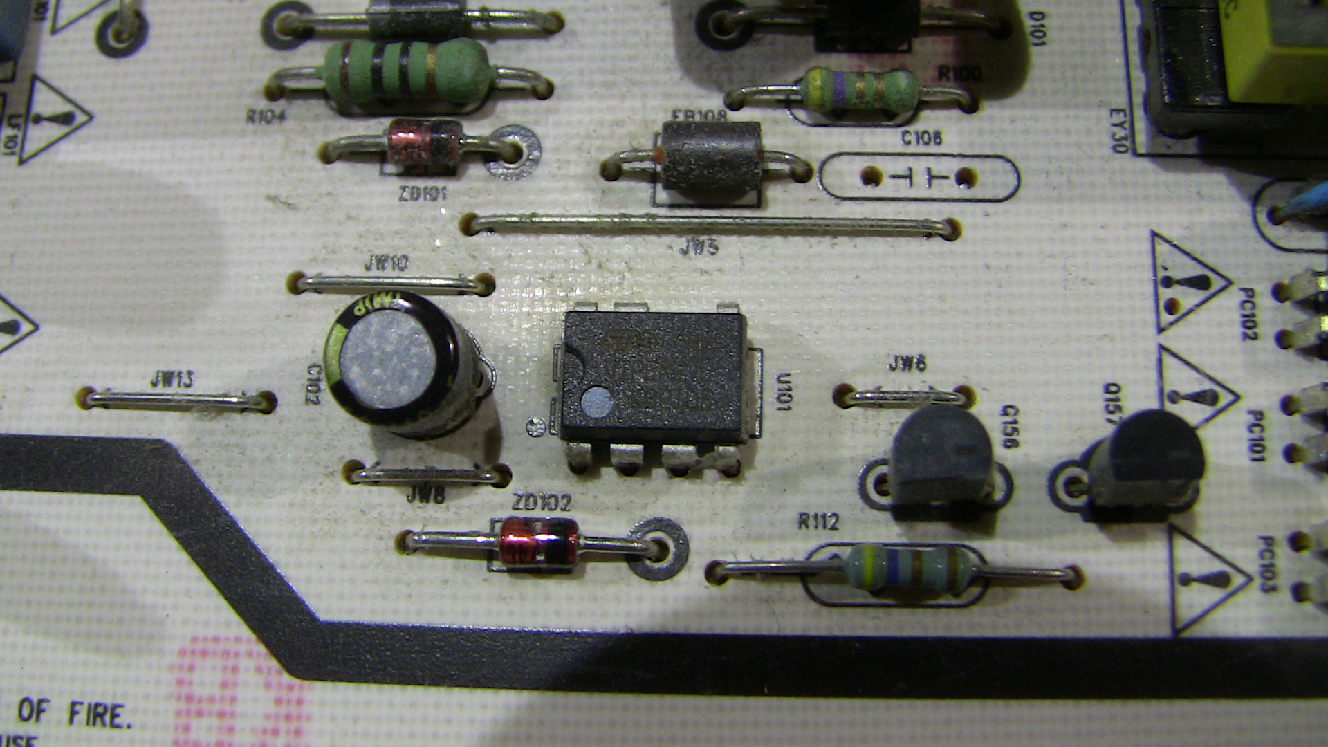

              Right now my problem is I don't know what to check next.
              • R_J
                • Jun 2012
                • 9588
                Re: E470VA with a PLHH-Y009A - no power
                It is very likely that the standby ic, U101 is the problem, check the resistance between pins 7or8 and pin 1. For testing you can leave ic501 out of the board, and you could also remove one end of both jumper wires JW59 & JW78, these feed the main DC to the backlight mosfets. With the ic & the jumpers removed you should have 5.2V standby voltage, If the fuse still blows it is likely U101 is bad.
                I would also use a 60~100watt incandescent lamp in series with the main ac line, this will help in finding the short.

                  For testing the U101 resistances on the pins, which pins are those (having trouble finding pin numbers) and do you want it tested while the item is still soldered into the power board? See image attached. I assume that's the one you want tested.
                    Pin 1 is marked with the dot. pin 6 is not used (missing)

                      Did I number them right (see attached)?
                      While soldered to board?

                        Between the pin next to the dot and the one across from it (8 I assume) the resistance is 2.7 Ohms, so I guess it's fried? This is with the item still on the board, though.

                          Yes the numbers are correct, they have Datasheets on these ic's If you search for the ic number and look at the datasheet you will see there is an internal mosfet, and 2.7Ω indicates it is shorted. There could be something else shorted but it is likely the ic, remove the ic and check the pins again to be sure.

                            Will do. I assume it will be bad, but will desolder and check just in case before ordering.
                            Do you know any electronics that contain this or a good place to get it cheap? It's $2.69 from China, but it takes a month

                              Looks like mouser & digikey carries them, (if it is a VIPER27LN) but they are also 5 month lead time. So China might be quicker, get a few just in case, China delivery can be fast at times.
                              I would also replace C102, it might be ok but it could be weak. I think it is a 10µf/50v
                              The VIPER27LN is for 60kHz operation (I believe this is the one on your board)
                              The VIPER27HN is for 115kHz operation

                                I just tested it with the piece off and there is no continuity between 1 and 7/8. The continuity was on the board itself.

                                  Then there is something shorted on the line that is connected to pins 7/8, It should not be too hard to find.
                                  Lift JW59 & JW78, still a short? Then lift FB101, Lifting these jumpers will isolate where the short is.

                                    These can literally be lifted or do they need to be resoldered?

                                      These parts are SOLDERED to the board, they can't just be lifted. Just unsolder one end, that way you can eliminate certain parts of the circuit, otherwise you would need to remove every component on that line to find the shorted part.

                                        I lifted JW59: still a short between 1 and 7/8.
                                        I lifted JW78 (without putting back JW59): no short between 1 and 7/8.
                                        I did not do anything with or even look for or identify FB101 since I assume it's not necessary at this point?

                                          I should add that that behavior (short, no short, as described in the previous post) is with the fuse I mentioned before effectively off the board because it shorted the last time I tested something, but I assume you knew this since I mentioned it.
                                          Anyway, let me know what those symptoms mean to you - what piece you think is broken.
