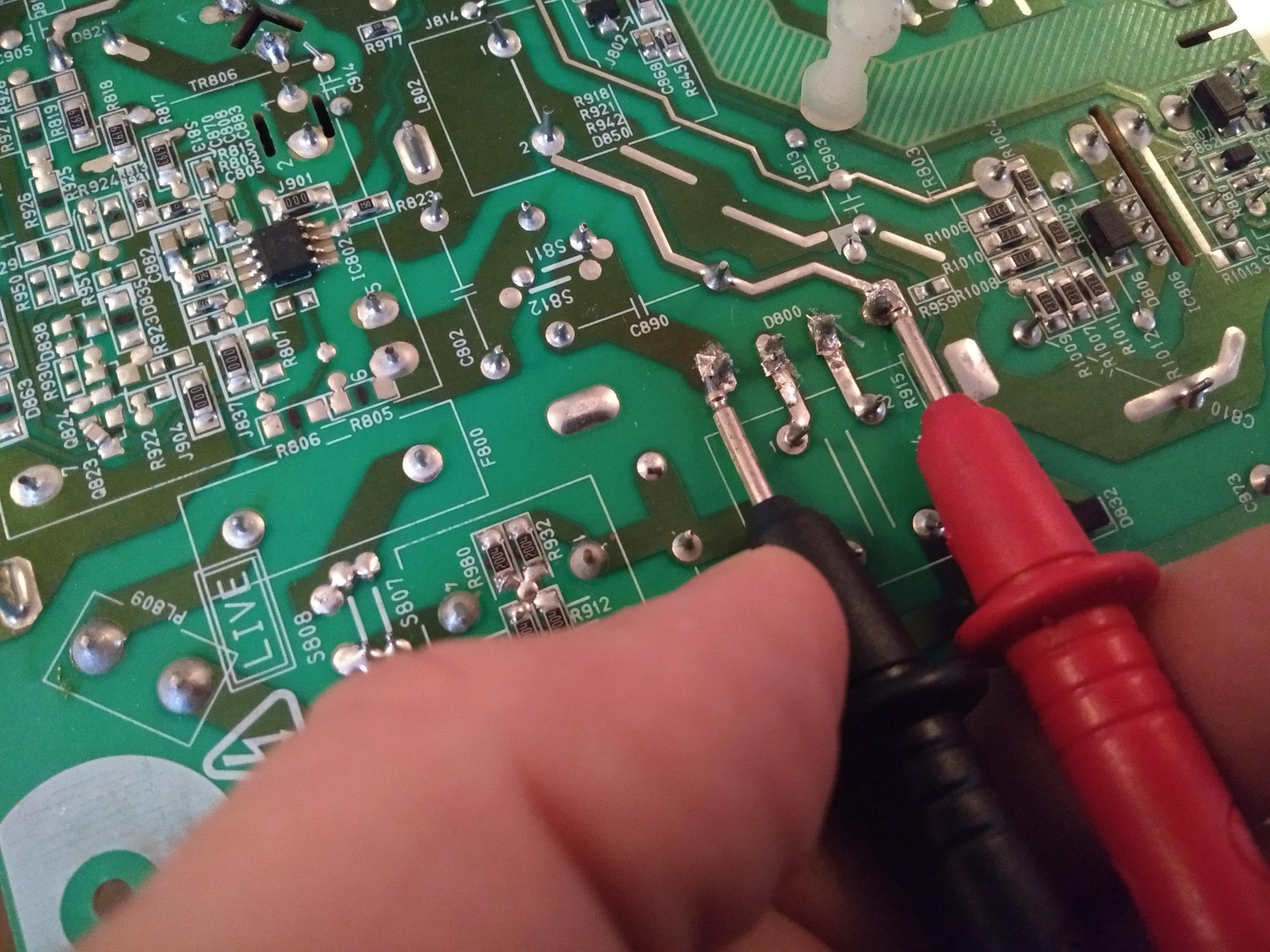

    So are you saying the reading from the fuse to hot ground of the capacitor was 0.733K ohms = 733 ohms. You need to check the bridge rectifier. Plenty of youtube video's online to show how.

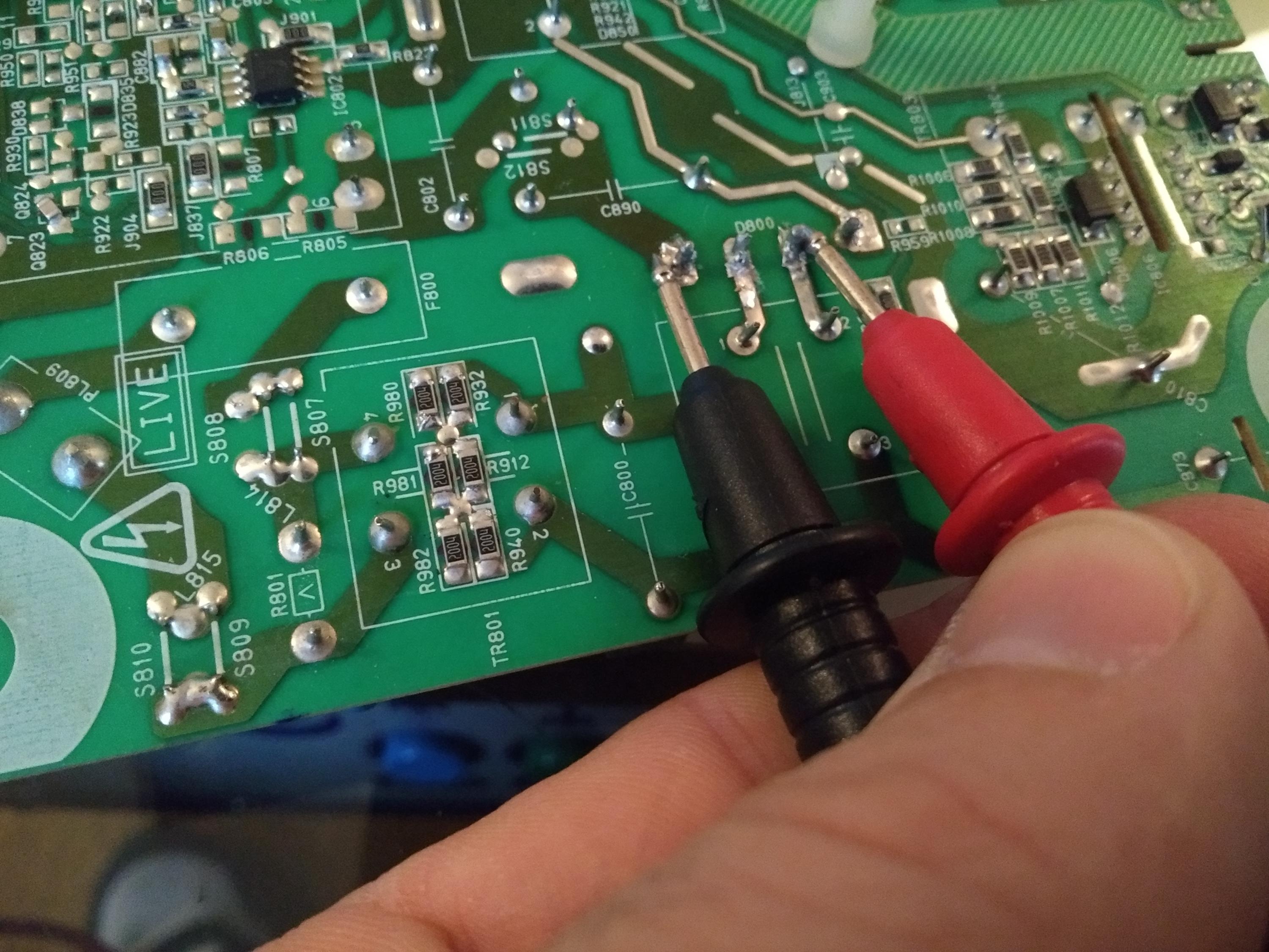

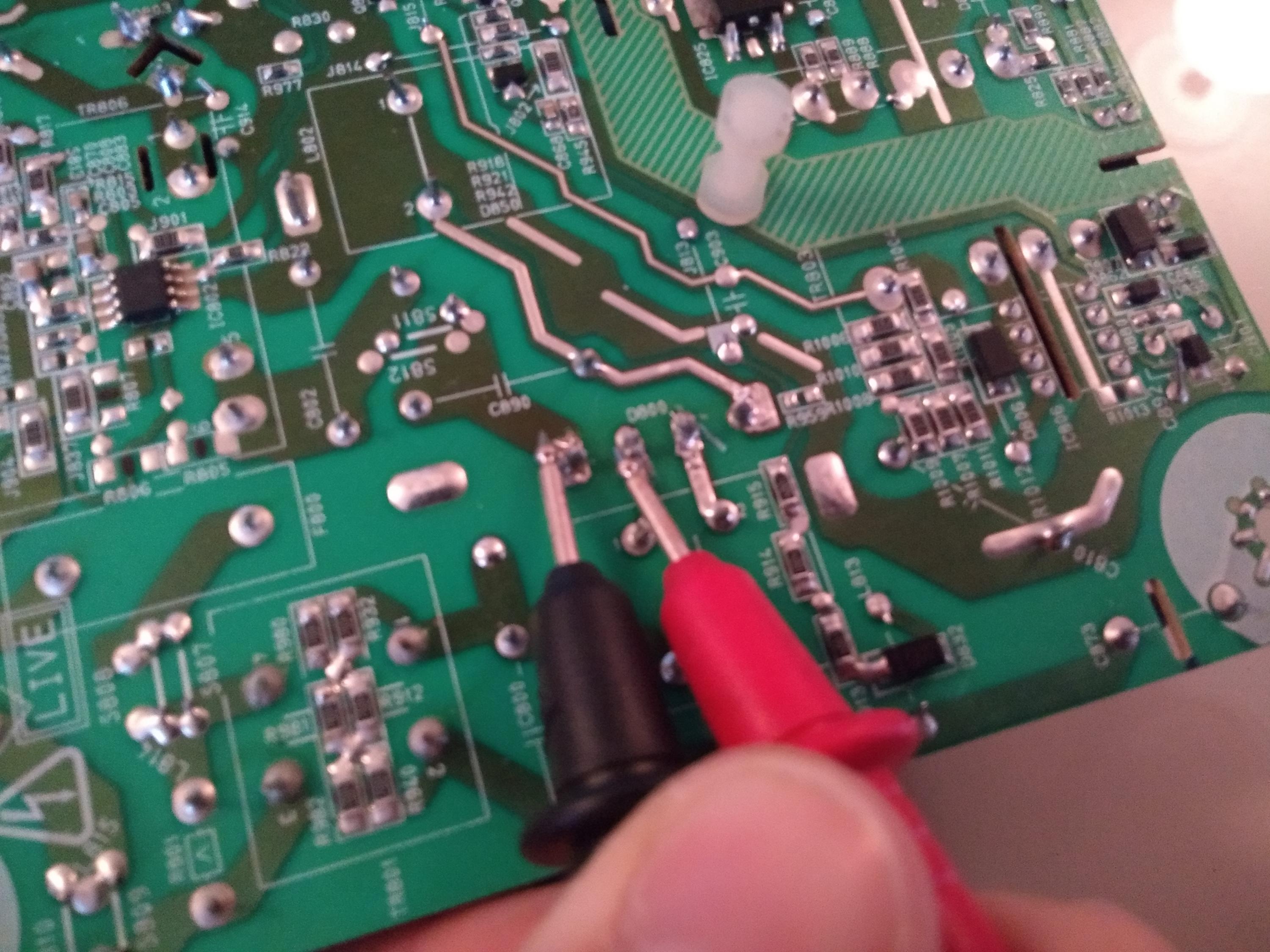

            Re: 17PW20.1 blows fuse right away
            Alright.
            So I tested the BR according to techniques seen on Youtube...
            So, between + and AC, I get 532
            Between + and 2nd AC, I get 540
            But then... between + and -, I should get the double, right?
            And I only get 522.
            Does that mean it's faulty?
            Do you think I should unsolder it from the board to be sure to check it correctly ?

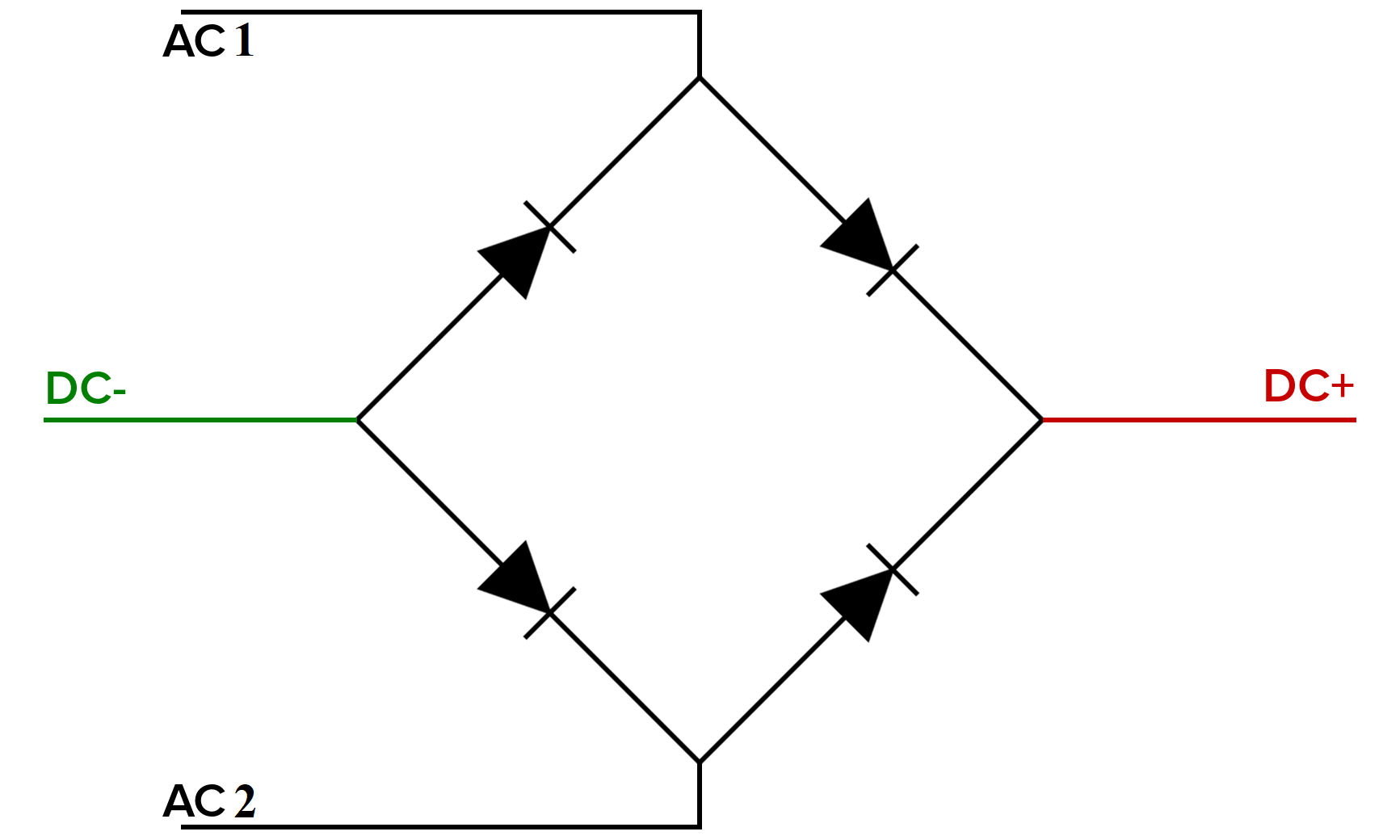

            • dick_barton
              • Aug 2015
              • 6643
              • Wales
              Test as if single diodes
              AC1 to DC+
              AC1 to DC -
              AC2 to DC+
              AC2 to DC-
              • wylcot
                • Dec 2020
                • 29
                • France
                Well then I get between 420 and 460...
                four times.
                • dick_barton
                  • Aug 2015
                  • 6643
                  • Wales
                  That sounds OK
