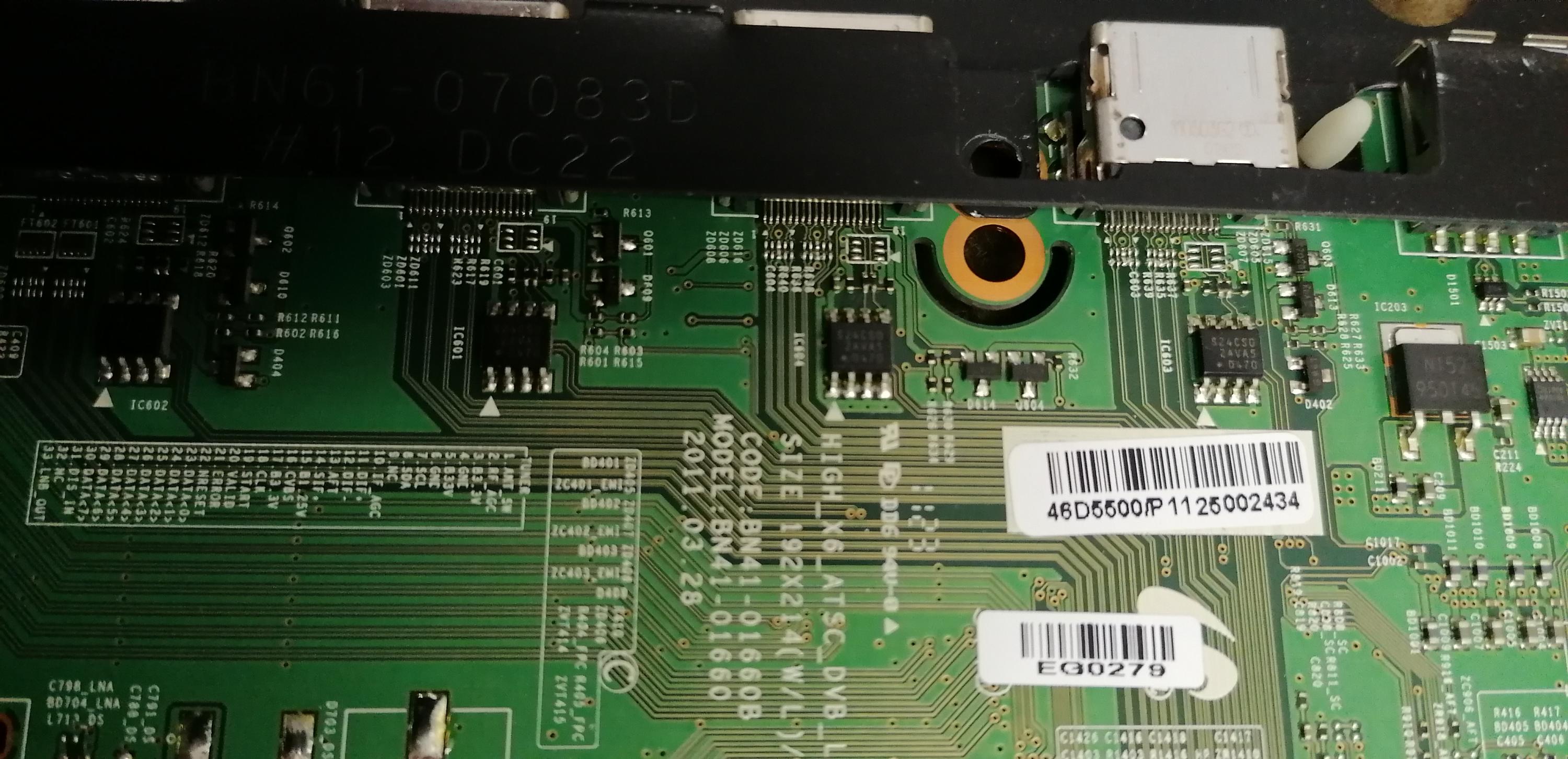

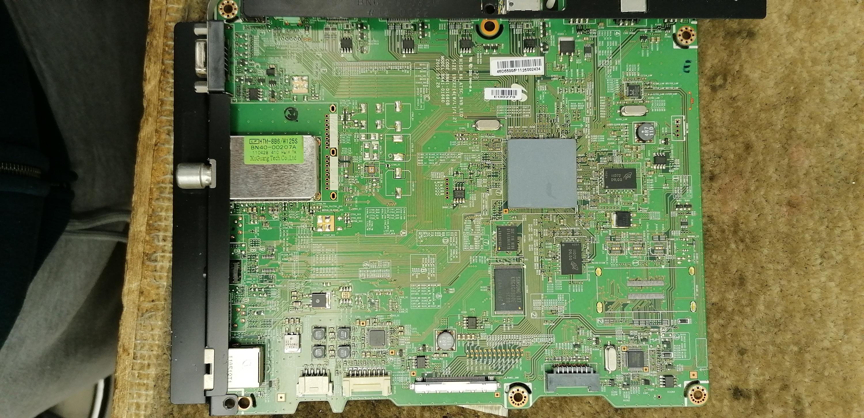

          Re: Samsung LED TV Model UA46D5500RR stuck on HDMI4
          Here is a picture of the main board and a close up of HDMI4. Perhaps you can explain to me about the SPI chip here.
                i would remove 24CS02 chip of HDMI4 to terminated this input from the main cpu .. see what will happen.
                  I suspect CPU soldering problem..
