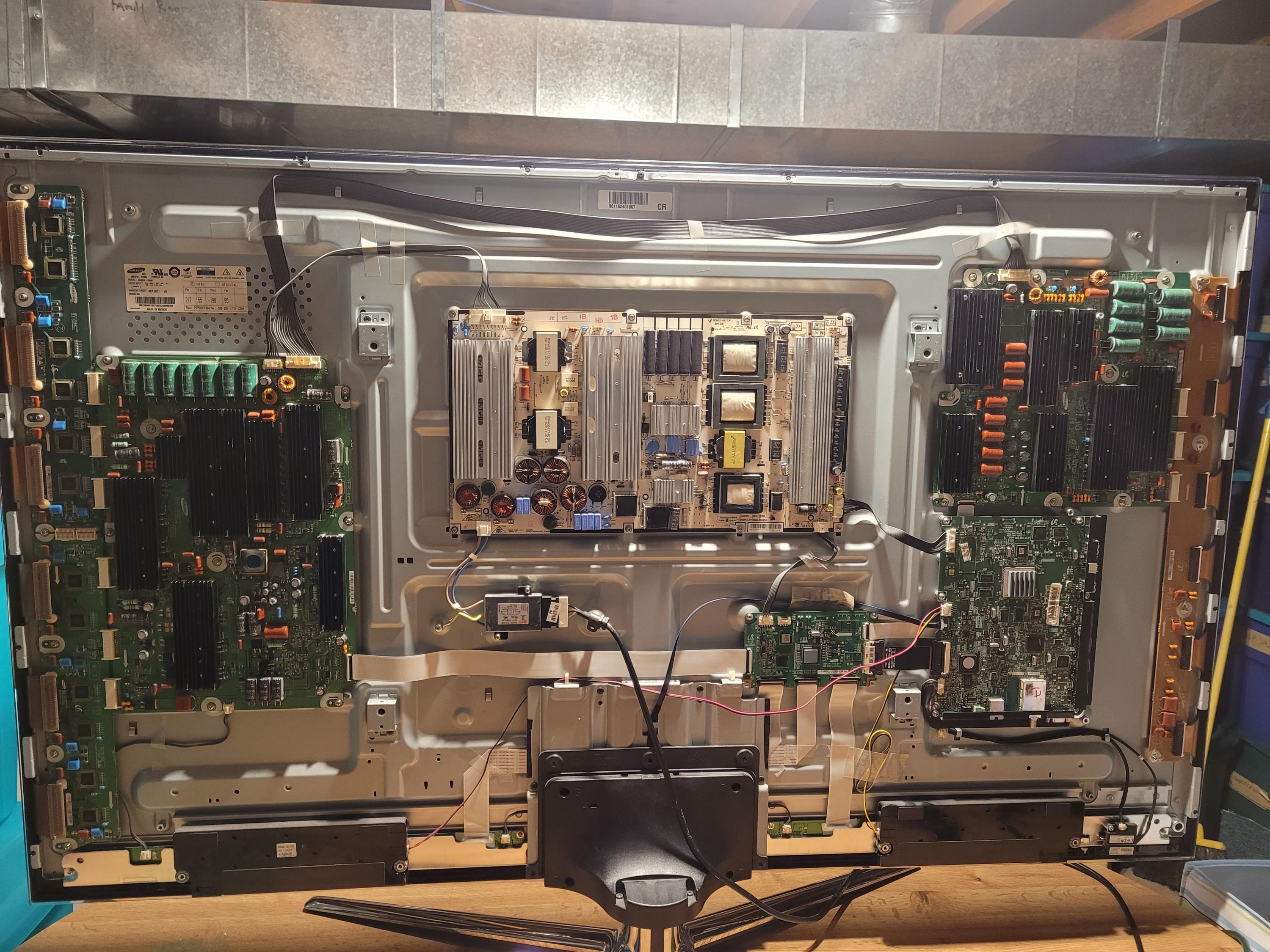

    Hello Folks, thanks in advance for any guidance you may be able to provide.
    Moved 59" Samsung plasma that was working flawlessly to basement to make way for new TV. Didn't turn on for several days but when did got nothing. Standby LED was on and did react to On signal but no sound or picture. Here's what we got when doing some minor readings:
    Nothing of any concern noticeable on any boards or capacitors.
    Standby ~5.3V
    PS_ON ~3.3V
    PowerON ~3.3V and goes down to ~.2V
    VS_ON 0V up to 3.3V but then quickly goes back down to 0V
    Green LED on logic board light blinks roughly once every 5 seconds (versus norm of once every second or so)
    VS ~5.8V (panel sticker indicates should be ~217V)
    VA ~.04V (panel sticker indicates should be ~55V)
    Disconnecting power connector to Y and X boards no change in VA and VS
    VSCAN test point on Y main voltage not present
    Ve on X board (Vb in my boards case) ~4.6V
    Looked at various threads, Samsung PDP Test Video and Samsung Fast Track Troubleshooting Manual but nothing definitive so not sure what to do next before just ordering and replacing parts. Thinking since this TV is nearly 10 years old perhaps others may have come across this issue and had an idea what is at fault. Any thoughts? Thanks once again in advance.

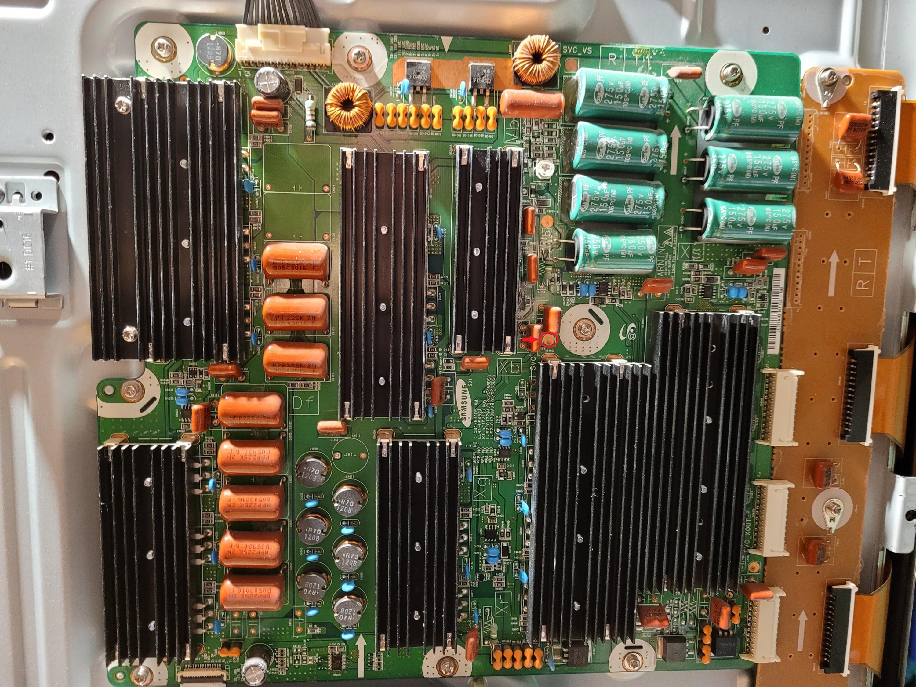

                        So had the SMPS power, as well as Y-board and X-board power connectors disconnected and checked resistance at all the test points on the various boards.
                        All points registered various amounts of resistance except for one point on the X-board which was .6 Ohms (multimeter was set to 200 and display read 00.6. Any multimeter higher Ohms setting displayed 0.00). Not sure if this indicates something potentially wrong with the X-board or is .6 Ohms ok?

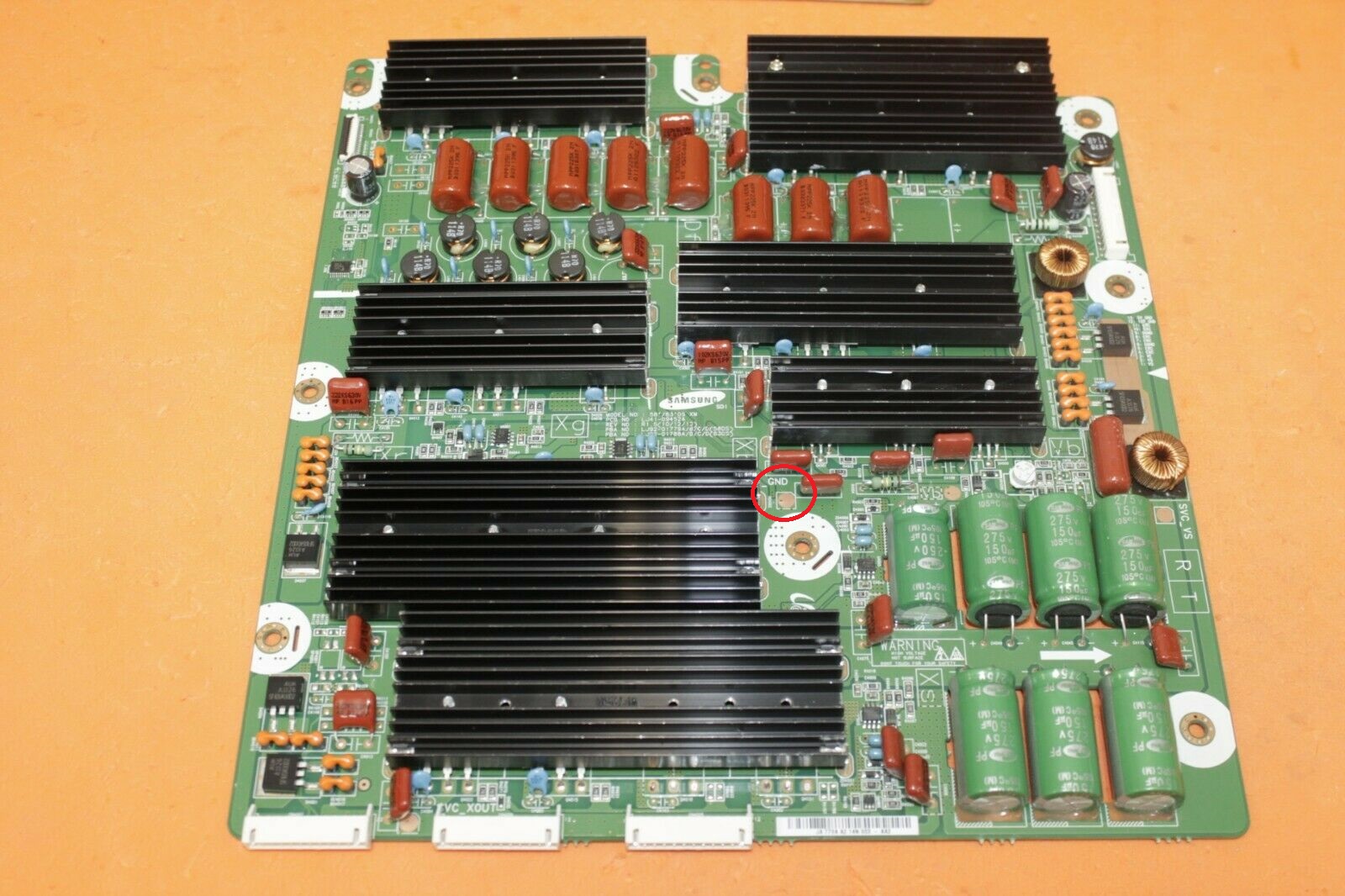

                          Without knowing what point the readings were low, it's not really possible to say if it's an issue.
                          Can you post some photo's?

                            I posted the pic of the TV back and the X-board marked with red arrow/circle indicating the one test point with only .6 Ohms resistance with power disconnected. Can post additional pictures as needed. Thanks once again for any potential insights.

                              Re: Samsung PN59D8000 Nothing After Move to Basement
                              I'm not sure what the reistance at that point should be. There should be a label on the back of the plasma panel with voltages given.
                              Maybe this pdf can help you.
                              • dick_barton
                                • Aug 2015
                                • 6643
                                • Wales
                                Looking at another Xsus board the red circle appears to show a ground point so zero or near zero ohms would be correct.

                                        from the first photo it tell at which condition the Power boards, sockets got yellowish / dry then how about its soldering. i would suggest take out boards one after one and clean sockets / cable end to end and inspect the soldering .. i dont believe set will got defect if you moved it from work condition to basement unless the environment at the basement caused am issue.
