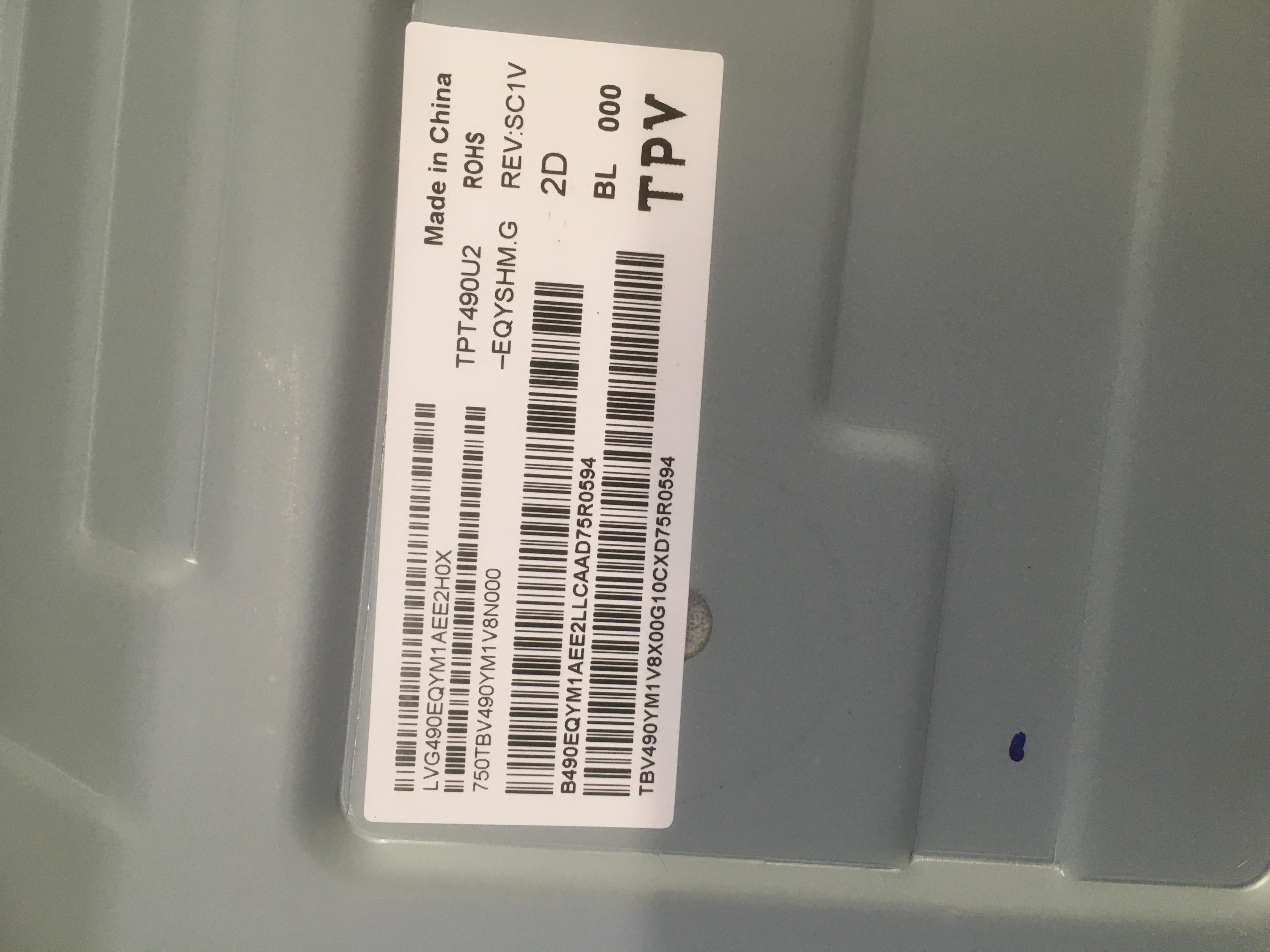

            could you write down the panel Type No usually start with TPT ?

              Re: 49pus6162/12
              Tpt490u2-eqyshm.g rev:sc1v

                Re: 49pus6162/12
                yes under this Code the panel option 005 and 004 too.
                when you are inter SAM go down on first page Option. then on the right side go to Display,, you could find flip the screen. post photo of the pages if you are not sure

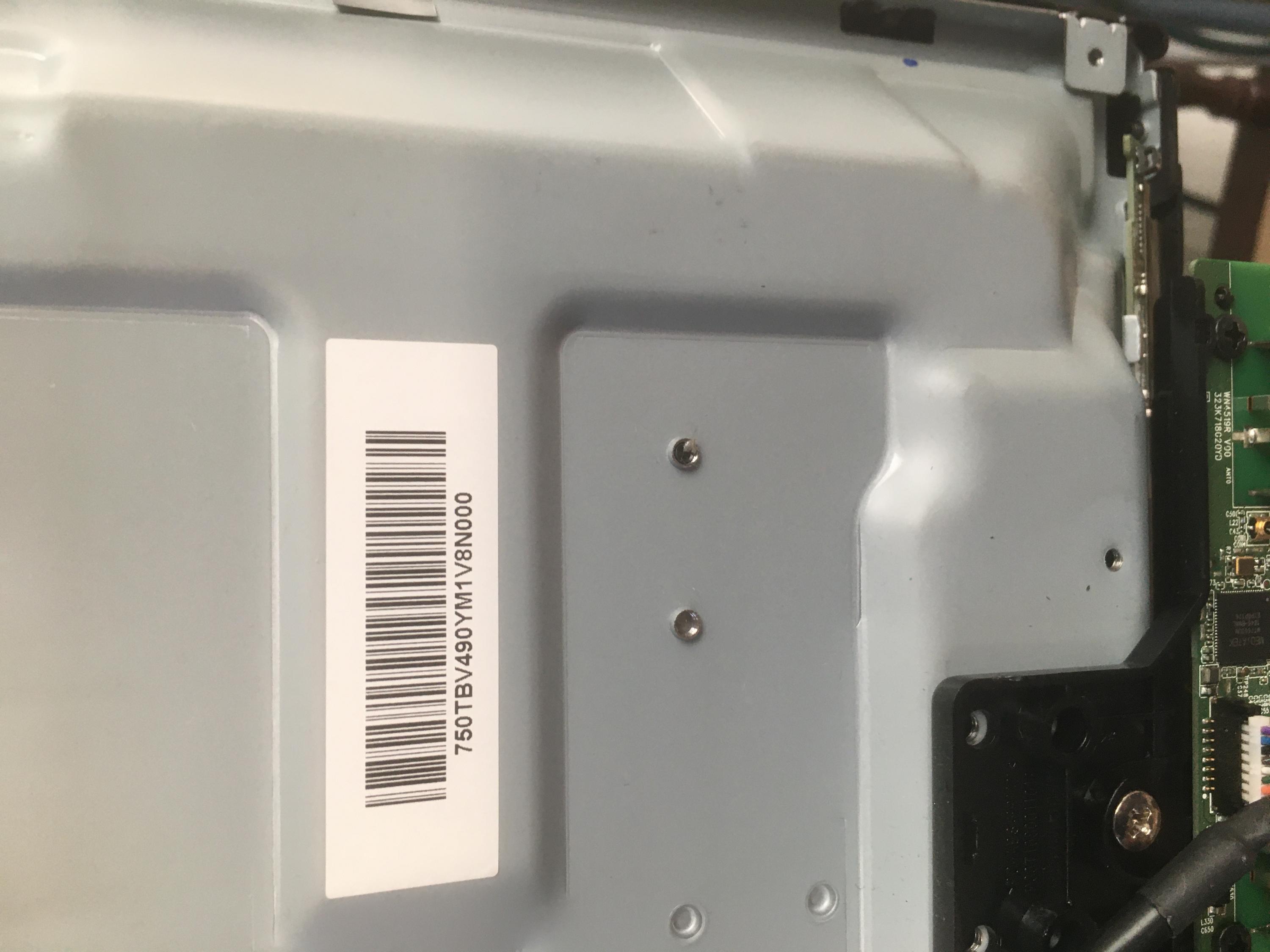

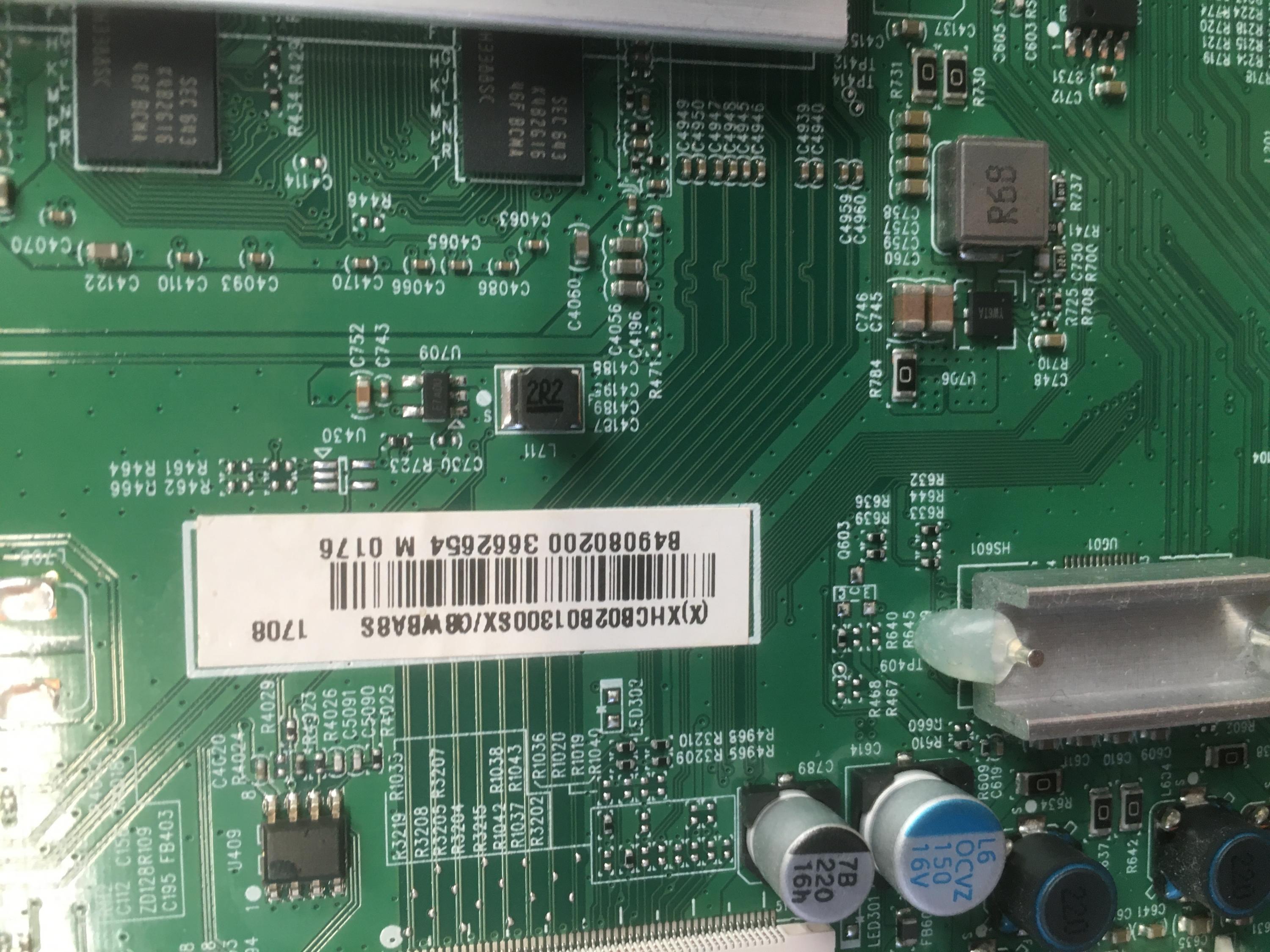

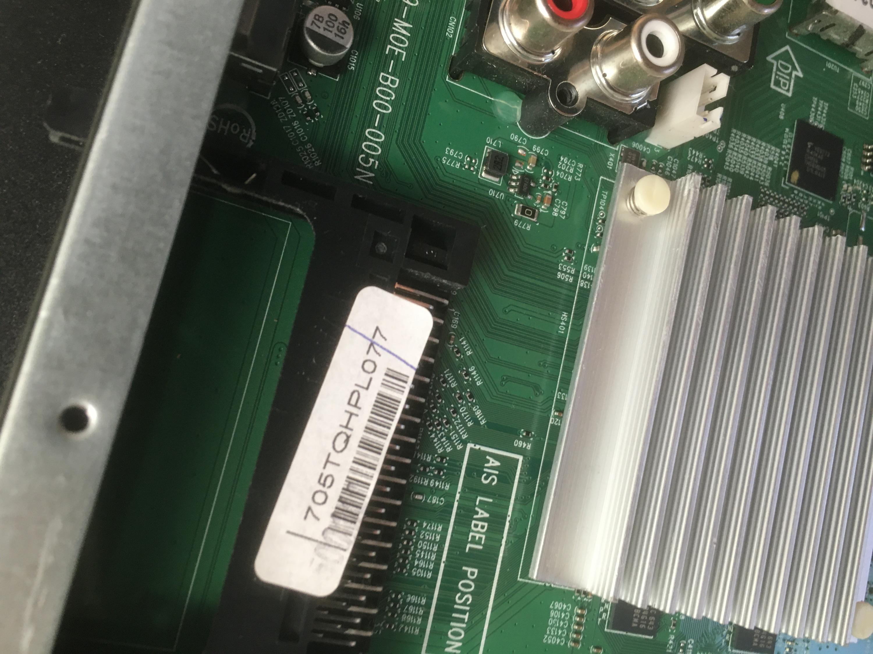

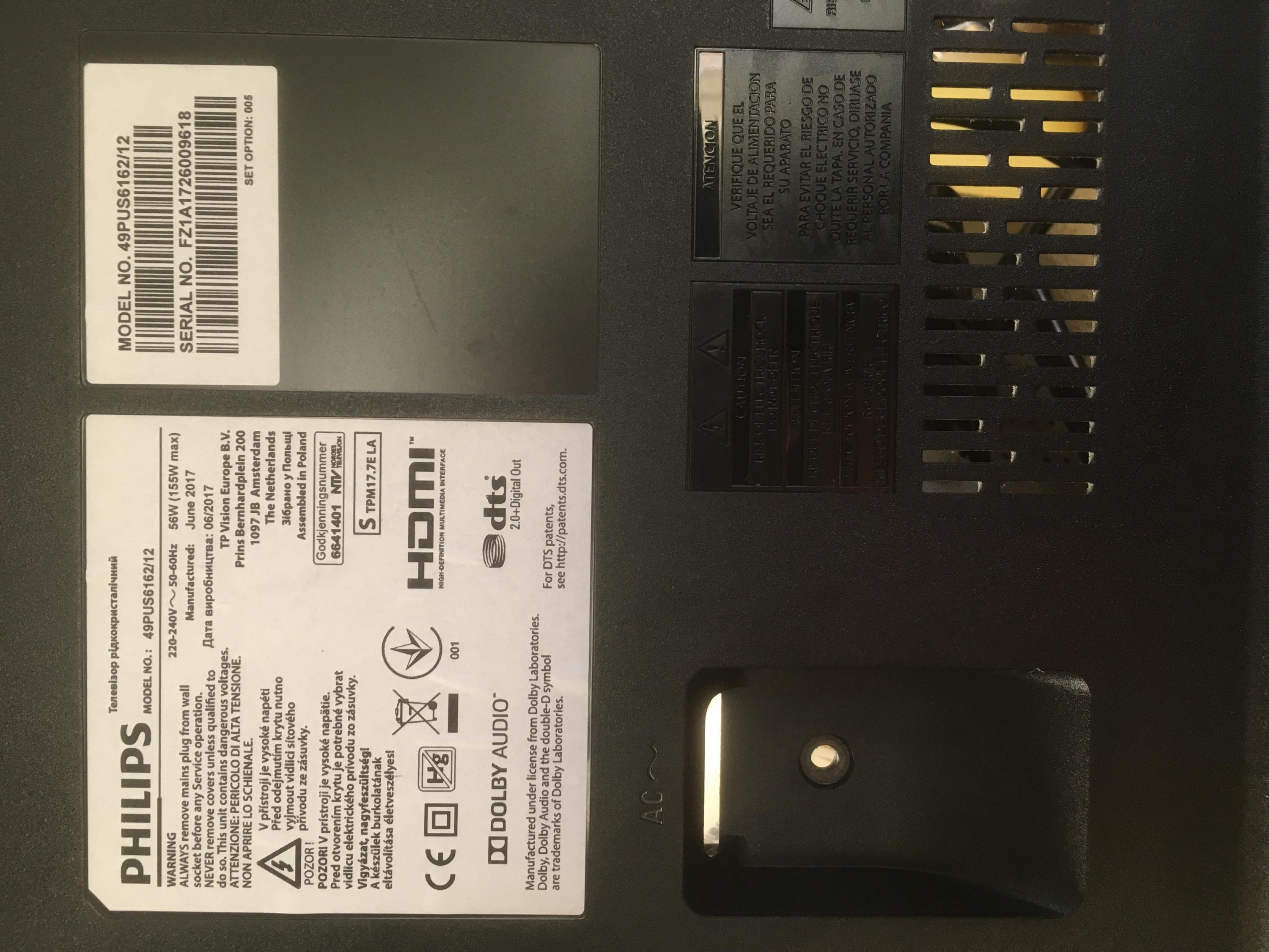

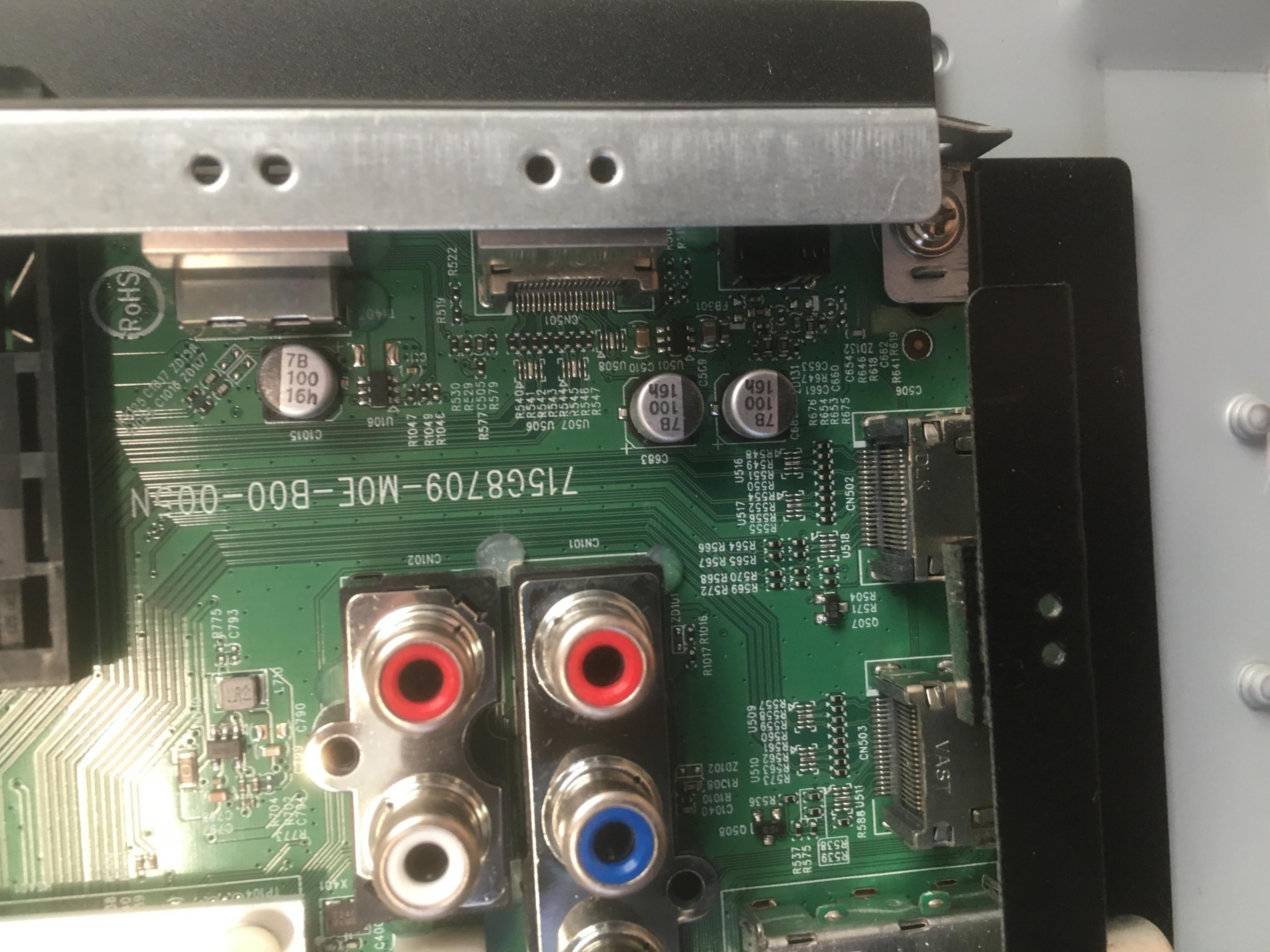

                        No problem... .. don't forget please to upload photo on the back cover label and all label you have on the tv chassis.

                          OK Diah I am attaching pictures of all labels on back and inside TV.
