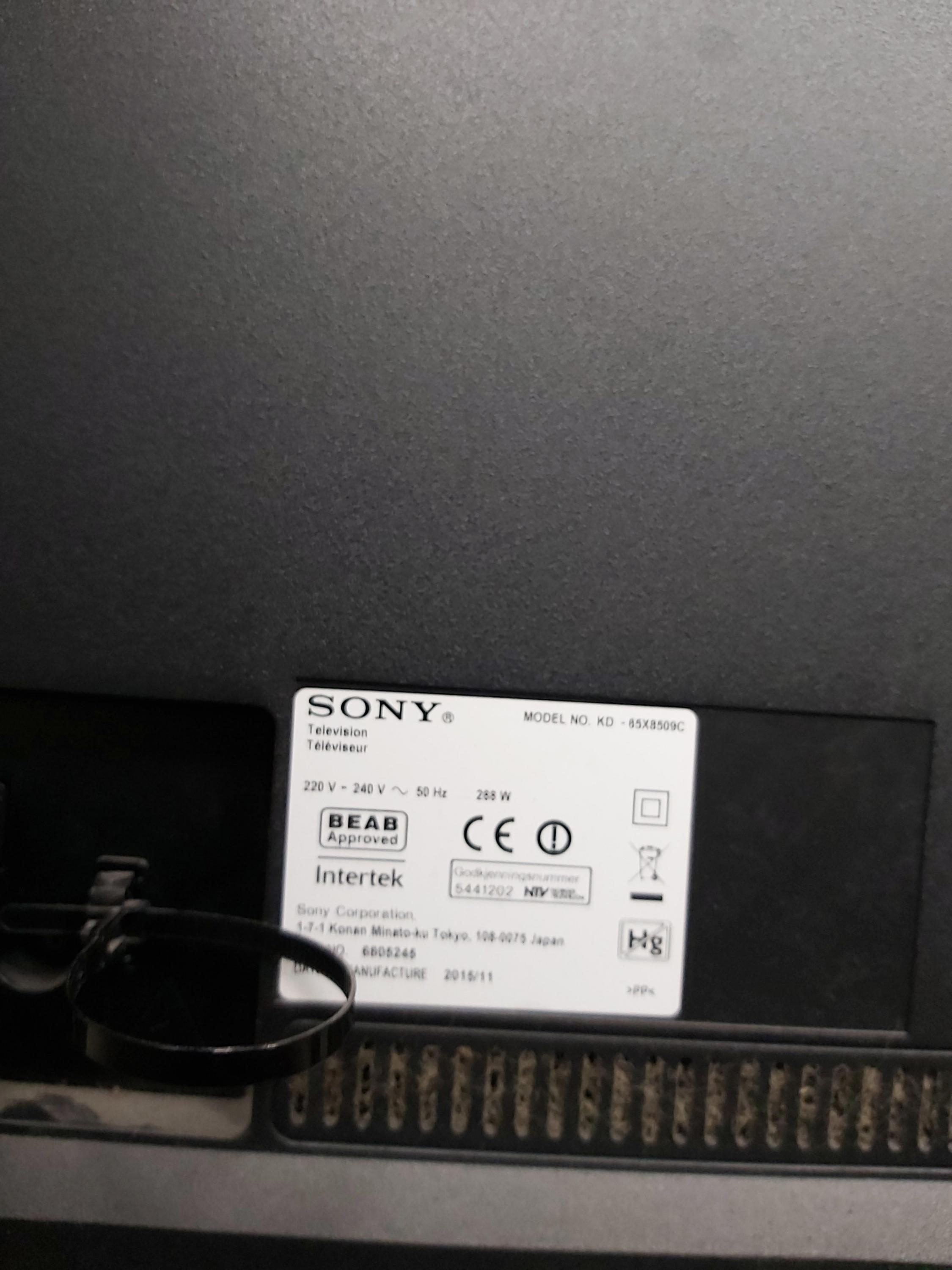

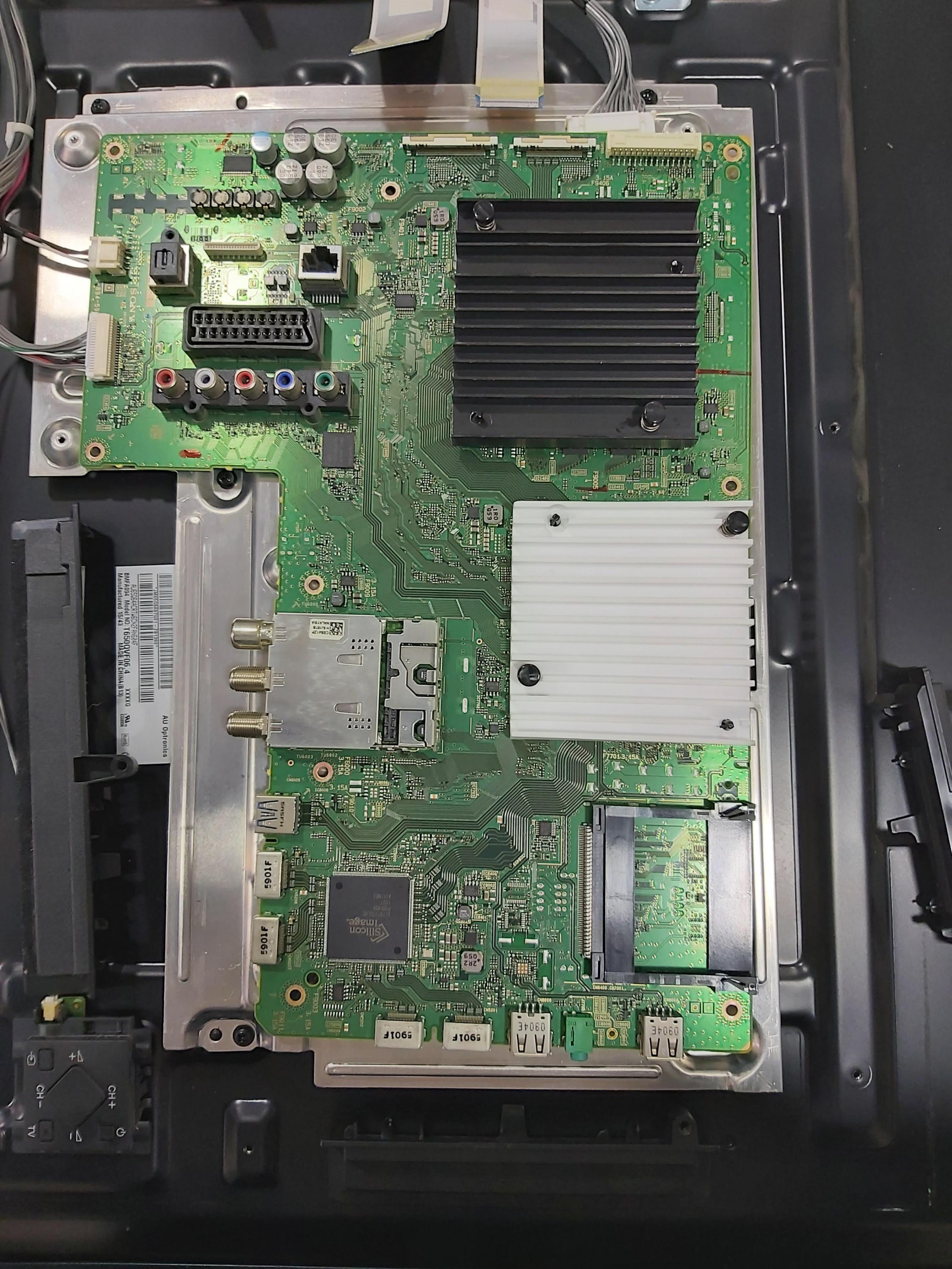

    Hi All
    I have a Sony 65" Android TV stuck in a boot loop. I have seen other threads where people have been talking about this problem on other models. This TV won't boot past the android circles before rebooting. It is running 433 software. I have tried the Vol - and Power forced reset enough times to to know that its not working.
    On ebay there are several guys offering a chip replacement service but has anyone managed to identify which chip it is on the board?

    Emmc faulty. Try ringing +44 1204 385050
    He is a guy I know in Bolton. He has been mentioned few times in this forum as well.

      I have found the Emmc SK hynix h26m52103fmr .
      Seems to be a common fault.
      This guy sells a pre programmed Emmc
      https://www.ebay.fr/itm/SONY-GN1T-XF-/274224449467
      Thanks for the info :-)

          leave them deal and make money.. its not the issue 100% to replace EMMC. and who will program it and why ??? so a jock on this forum. in short words its BGA if hard reset didn't help

              Android TV has often software blocks, i guess it s not an hardware problem, only a data loss, Android devices have no possibility to self repair these things due to the lack of a keyboard and root level user access.. so it's needed a special interfacing by a technician and a PC..
