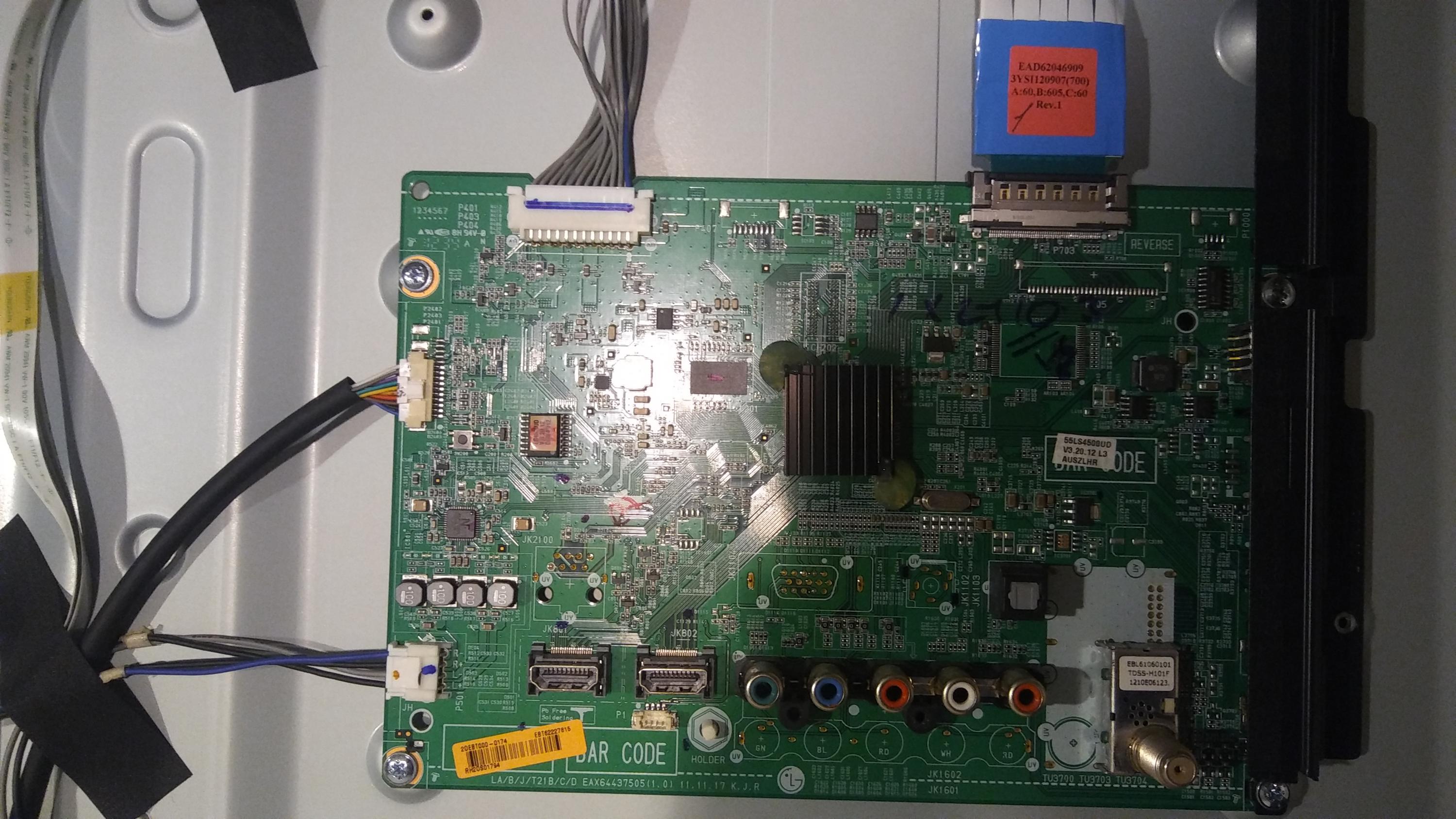

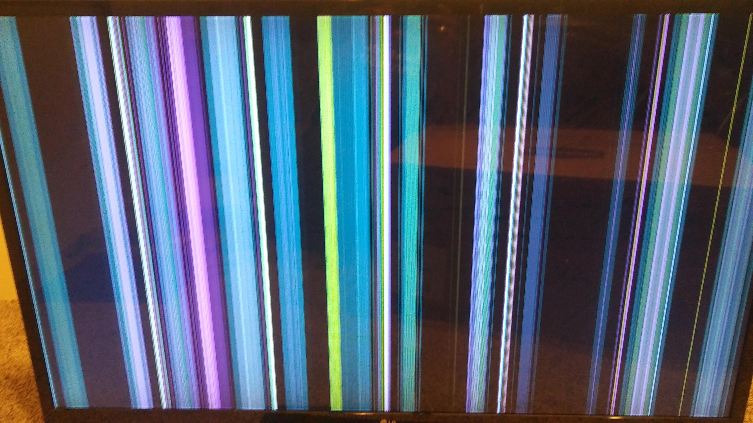

    I need help to resolve this issue.
    TV : 55LS4500
    Issue : Vertical lines end to end.

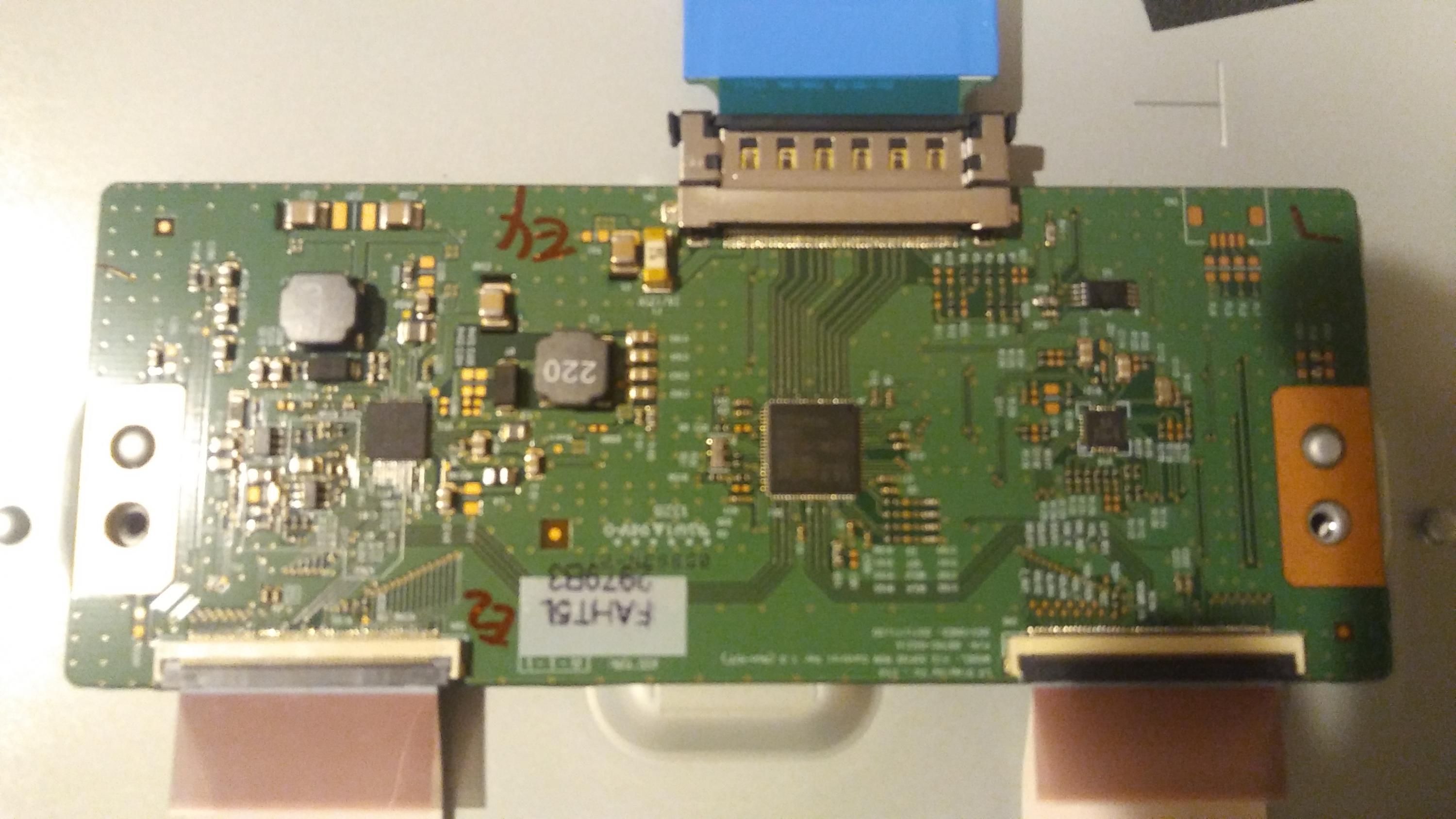

    When i switch on, power LED (RED) blinks 3 times and the vertical lines show up and stays. I replaced the t-con board today but still having issues. No sound.

        So you get the same display and no sound with both tcons?
        • letmefixit
          • Sep 2020
          • 10
          • usa
          Re: LG - 55LS4500 - Vertical Lines
          Yes. Same vertical lines pattern.

            Update (9/29/2020) : I connected a different HDMI cable to the dvd player and now I can hear the sound. The vertical lines still remain.

              remove one by one flexs the right flex from tcon to the screen and check if the left half of the screen is good and the same way with the left side.then check vgh and vgl voltages.good luck.

                With the DVD playing,
                1) Both ribbon cables attached to t-con : multi colored vertical lines on the screen
                2) If I remove the right ribbon cable alone from t-con, then the right half screen becomes white and left still has stripes.
                30 If I remove the left ribbon cable alone from the t-con, the left half screen becomes white and the right still has the stripes.
                I didn't check the voltage yet. I will do that tomorrow.

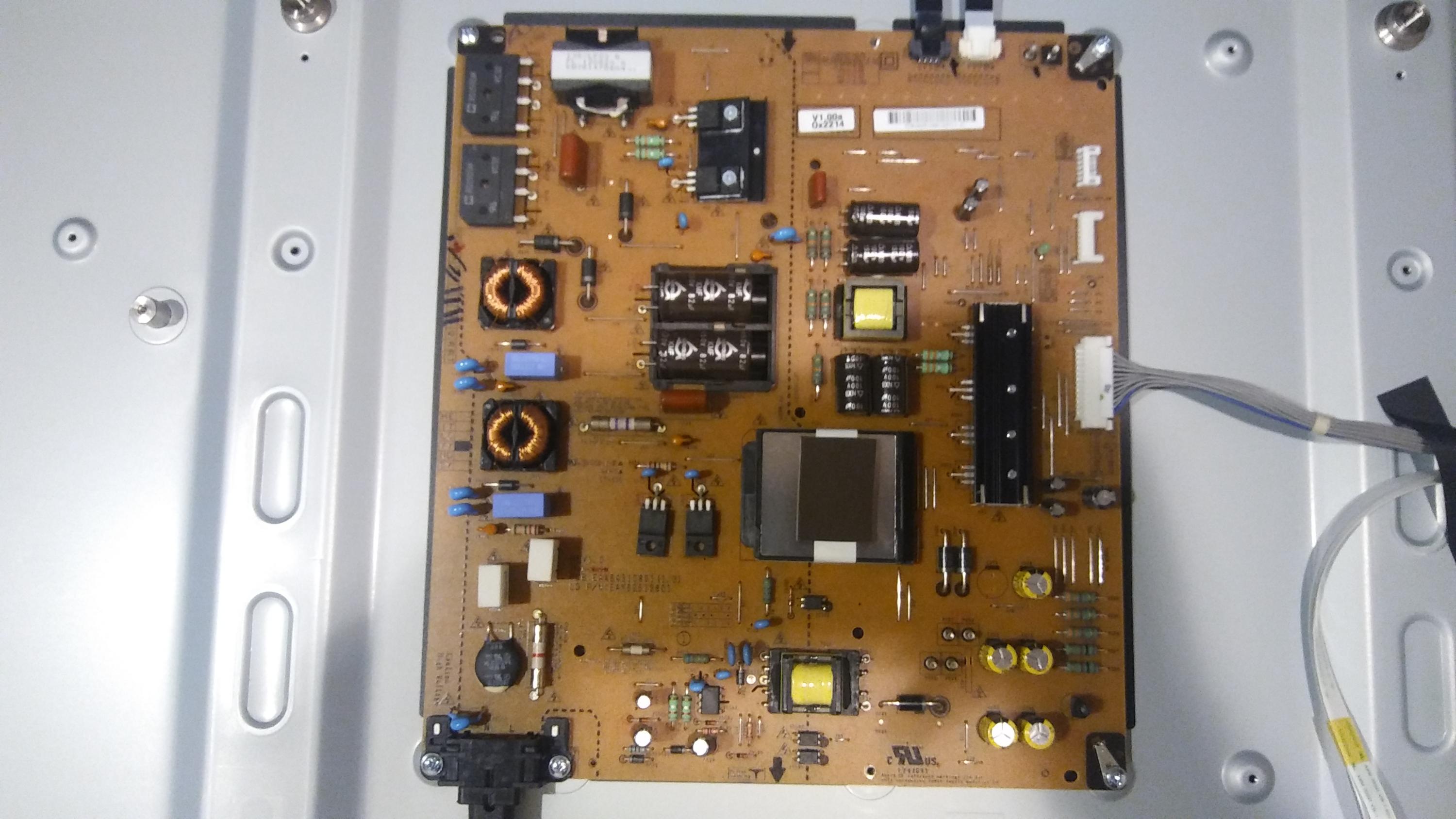

                    Checked the voltage.
                    fuse : 12v
                    VDD : 16.9v
                    VGH : 26.7v
                    VGL : -6.9v
                    VCOM : 7.9v
