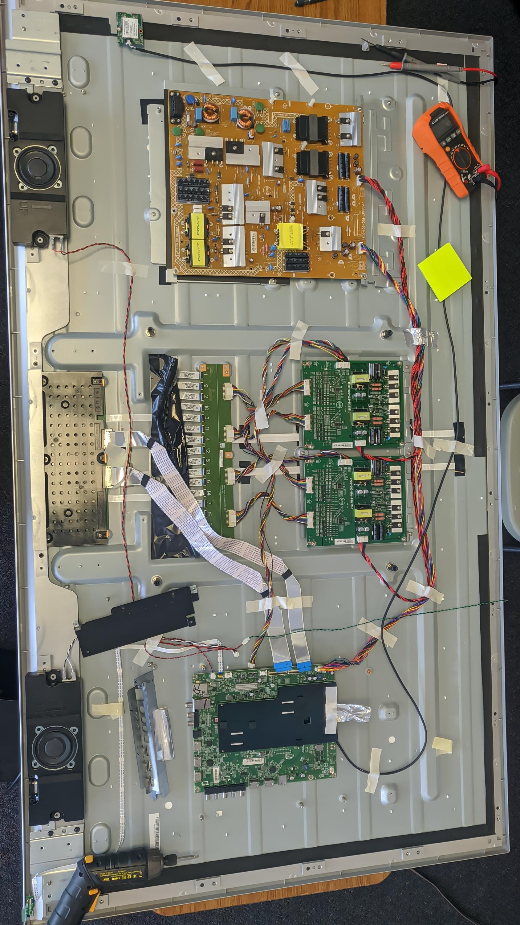

    Hey guys. I have a 65" Vizio M65-C1 UHD 4K TV that has no power. I've done a lot of research on this model and some common problems that other people seem to have is unfortunately not applicable to me and my TV as I have different symptoms. I've documented all of my measurements and behavior I've noticed as follows:
    Symptoms:
    1. TV does not power on.
    2. Power light in bottom right corner (if facing display) briefly lights for a moment upon plugging in power and fades to black. No response from power button or remote control.
    3. Purple/Red LED located on the main board does nothing at any point. (I understand it's supposed to flash and then remain solid if working properly. Mine does nothing at all.)
    Below are the measurements I have taken. The first set is connected but powered OFF and the second set of measurements is while powered ON:

    Something else I can add based on what I saw was asked in other threads based on this model is that the 3 large caps (C9804, C9805, and C9823) read 390.4V
    I did come across this YouTube video where a guy had a problem with a resistor and a diode located on the power board and changing them fixed his problem.
    The video is based on the symptoms of the 19V line fluctuating/not steady and a flashing purple light on the main board. I don't share either of those symptoms, but I went ahead and checked the two components anyway.

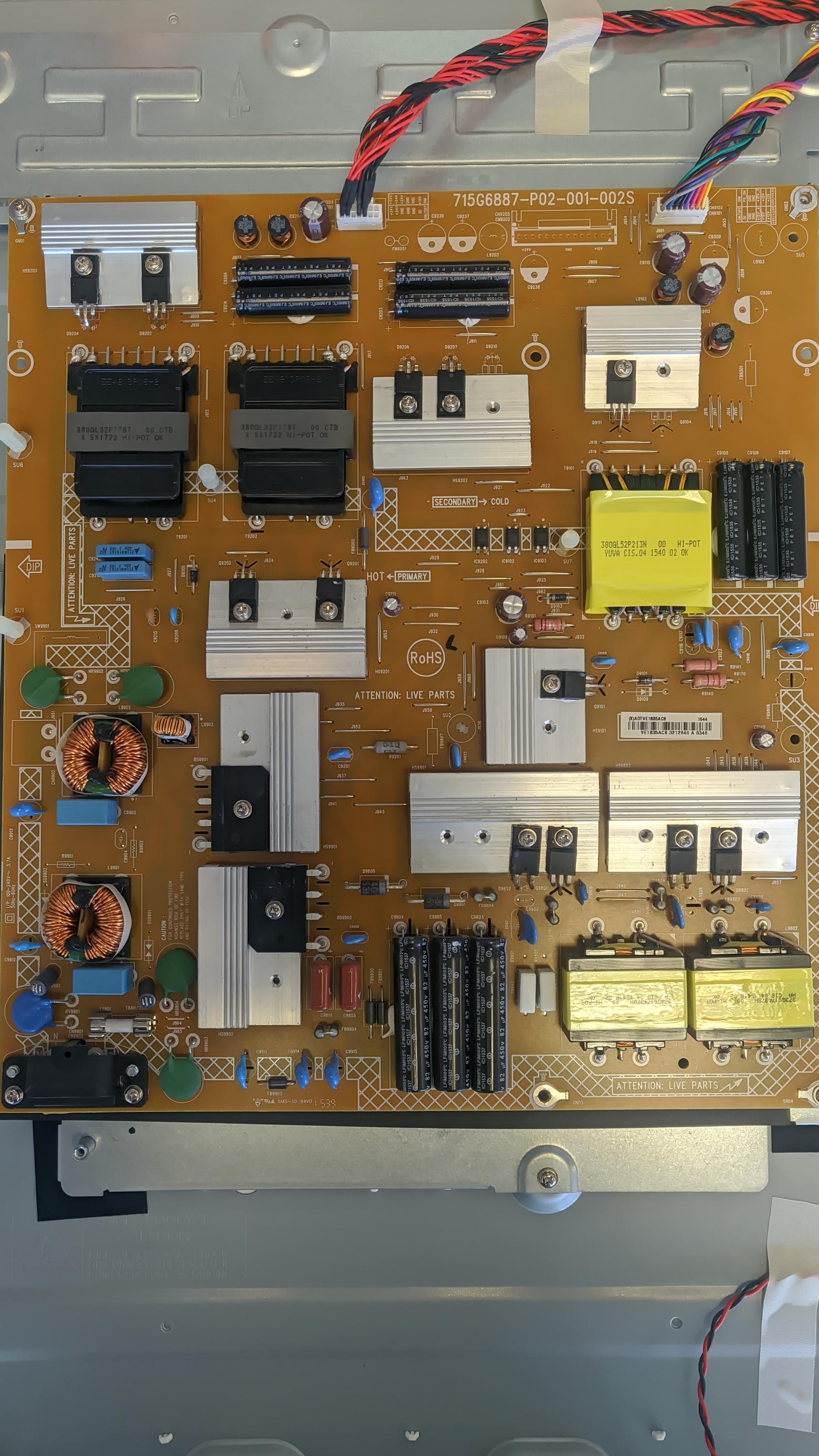

    The resistor on the bottom of my power board R9114 is reading in the ~1 mega ohms range just like his was in the video while the one above it R9135 is reading as his does about 8.9 kilo ohms. Should I change this resistor? R9114? It reads the same as the guy's does in the video and he changed it. Apparently R9114 is supposed to read about 8.9 kilo ohms like R9135 does.
    The diode marked D9103 checked out ok, passing voltage one way but not the other.
    That's really all that I can tell you about the TV. While I'm not a complete newb, I am still learning a lot about TV repair and with my limited knowledge I think it's a main board problem.
    I've already did some initial searching for the replacement board just to see if they are even available and it seems like there are a few on ebay, but if at all possible, I'd like to repair the component(s) that are at fault if it is indeed the main board. I haven't yet come across a thread/video where someone fixed a main board problem yet although I did see a thread that made a reference to reflowing the processor on the main board.
    Can someone take a look at what I've posted here and guide me on what I can do from here to repair this TV? I've attached pics, but let me know if you need more.

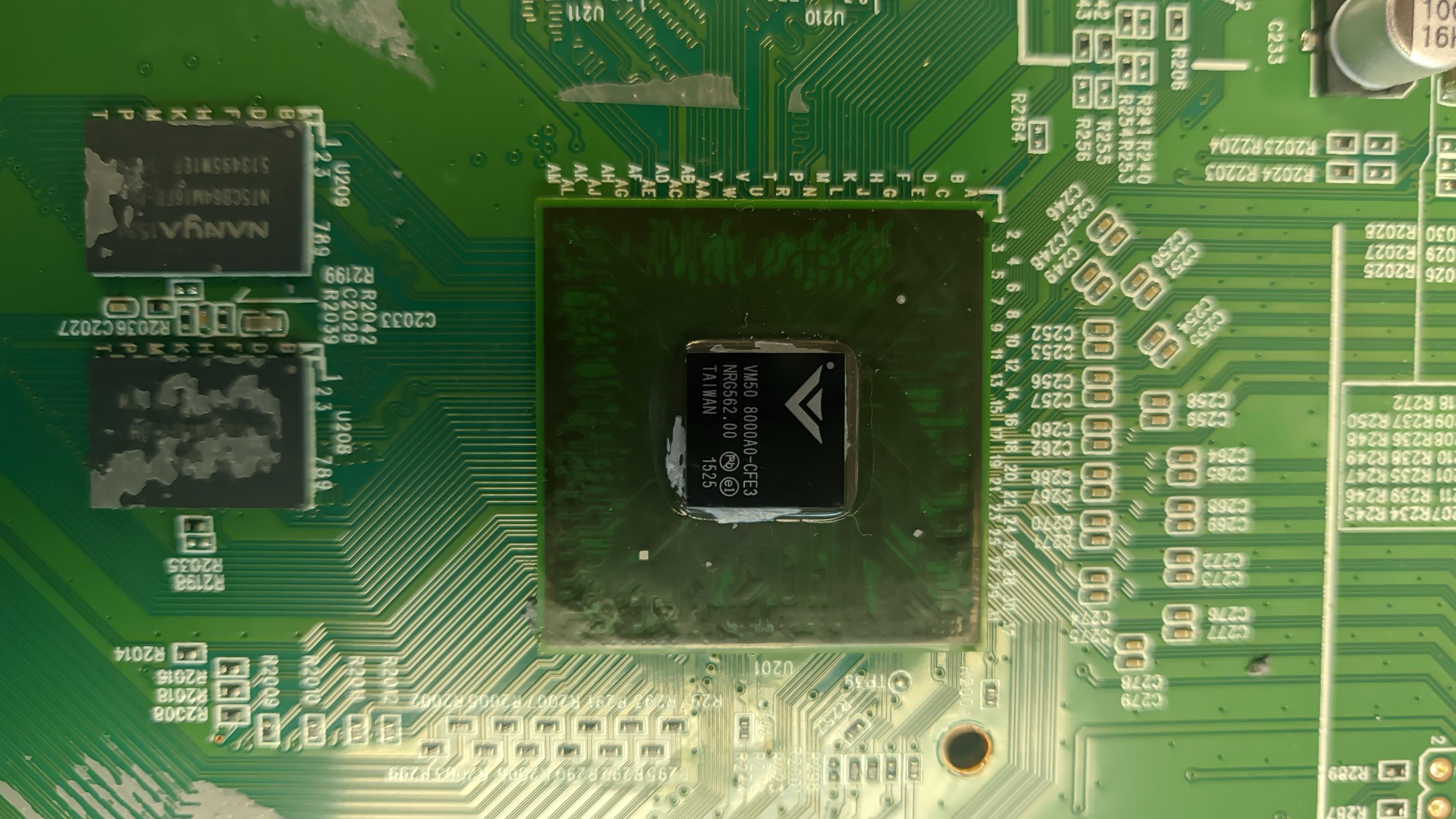

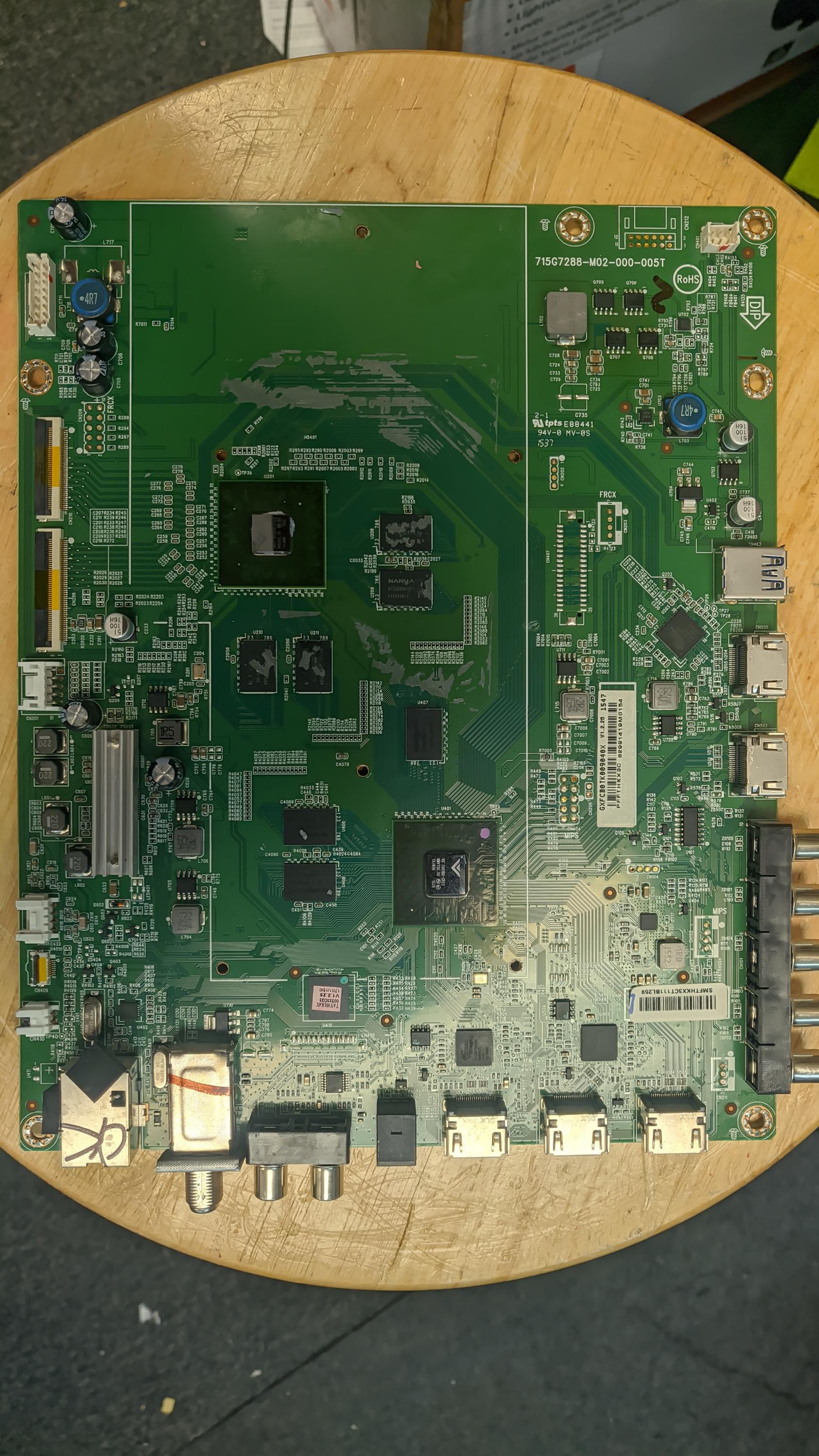

      I went ahead and got the heatsink off of the mainboard which was a real pain, but I got it off and cleaned up the dried up thermal paste put on at the factory on both the main board chips and the heatsink.
      I am used to doing reflows on MacBook Pros, laptops, and game consoles, but haven't done one on a TV main board yet. I'm going to assume the process is the same. I have a hot air reflow station with preheater that I typically use and lots of good BGA flux and experienced with the process and reflow profile.\

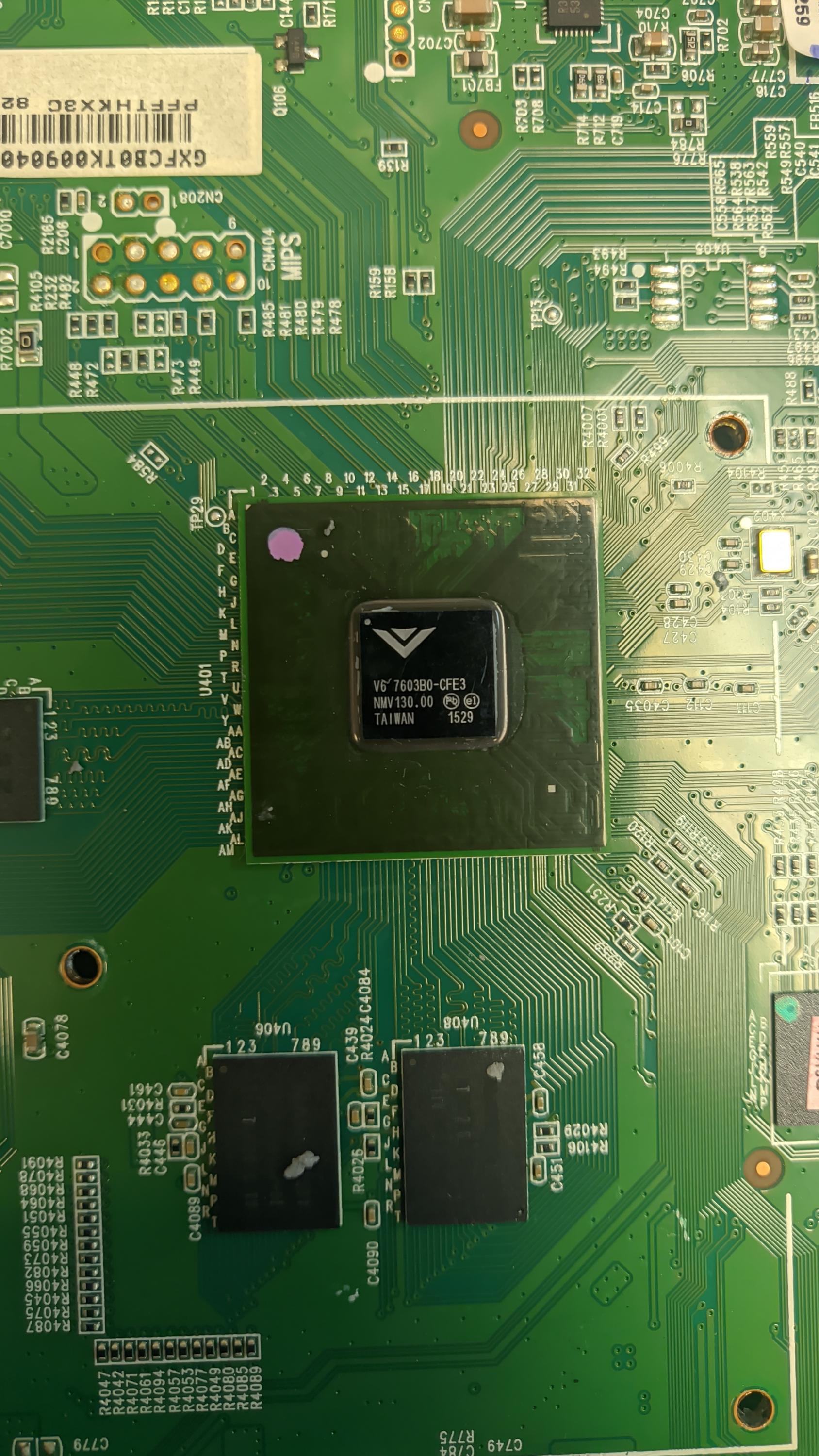

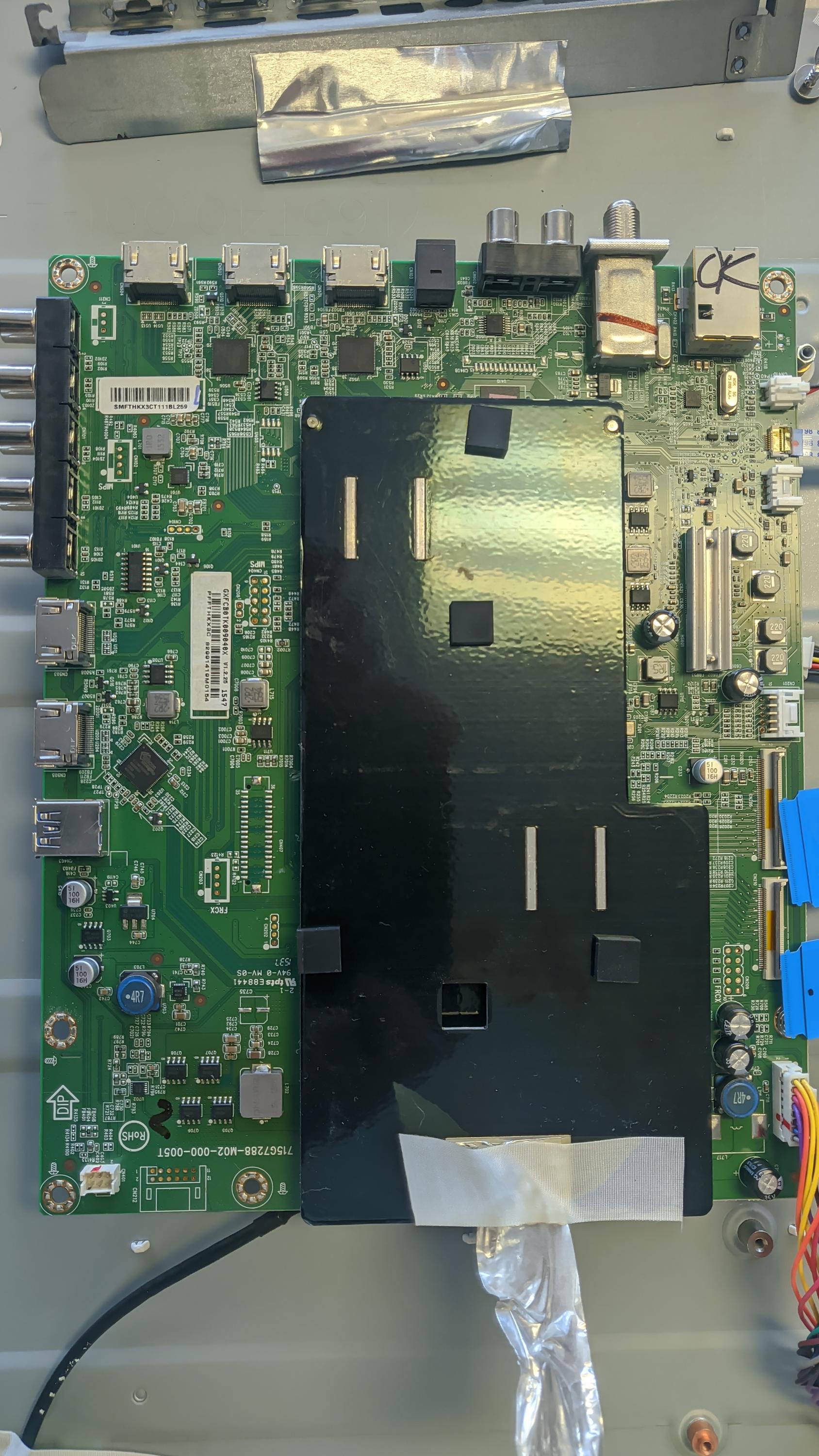

      However, what I am not sure of is which chip am I supposed to be reflowing? There are two under the heat sink that look basically identical.
      Any advice? I have a hot air nozzle that fits for many different size BGA chips but it can only do one at a time, so I should probably do the one that needs it.
      I'm assuming one is the main processor and the other is some kind of SoC that runs the firmware/software for the "smart" aspects, but that is a complete guess. I have no idea what chip does what to be honest.
      I attached some pics. Can you give me some insight?
      Thanks again.
      (EDIT: Oh, and nevermind the gray markings around one of the chips. There was some heat resistant tape placed by Vizio over those memory chips and its just the residue left behind)

        If none of the threads on here have that info, I'd pick one and give it some heat for around a minute (around 120°) and see if it turns on.

                Pic 2 of 3 is the "top chip" (the one that Vizio had thermal tape around the memory chips)
                Pic 3 of 3 is the bottom chip.
                The ebay listing I linked to is the bottom chip. I tried, briefly, to source the top chip but was only led down a rabbit hole of alleged Hong Kong suppliers and never actually found one to purchase

                      Update: So I reflowed the "top" chip (marked VM50 8000A0-CFE3 / NRG562.00 ) and now the TV powers on! Hooray! However, the screen is split down the middle vertically. One half is black, the other half has some garbled distortion of lines/colors.
                      I'm going to keep messing with it and see what I can figure out here

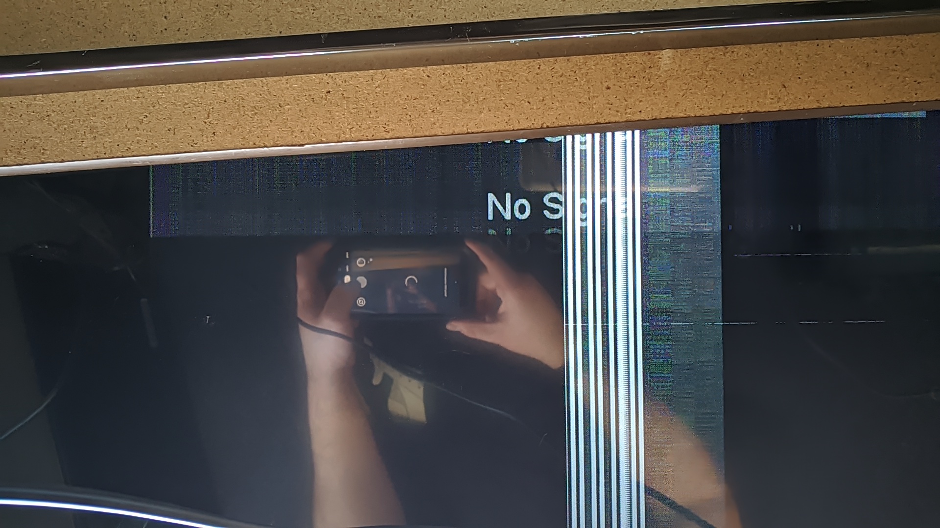

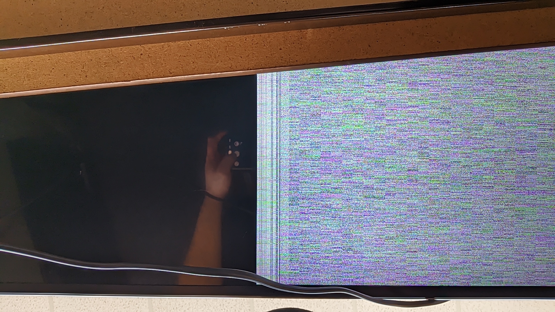

                        So messing around with it some more, if I disconnect either ribbon cable that is going down to the tcon? board, the entire screen remains black although I can see flashes of what I can only describe as "backlight flashing". Basically flashes of varying degrees of backlight, but all black screen. This happens if I remove either ribbon cable. Only when both are plugged in do I get a partial, although distorted, image on the screen.
                        I attached a pic to show it. I have the TV face down on a table, so this is the overhang and photo taken from below.
                        So I guess the question is, do I reflow the other chip or is this a TCON or even a panel problem?

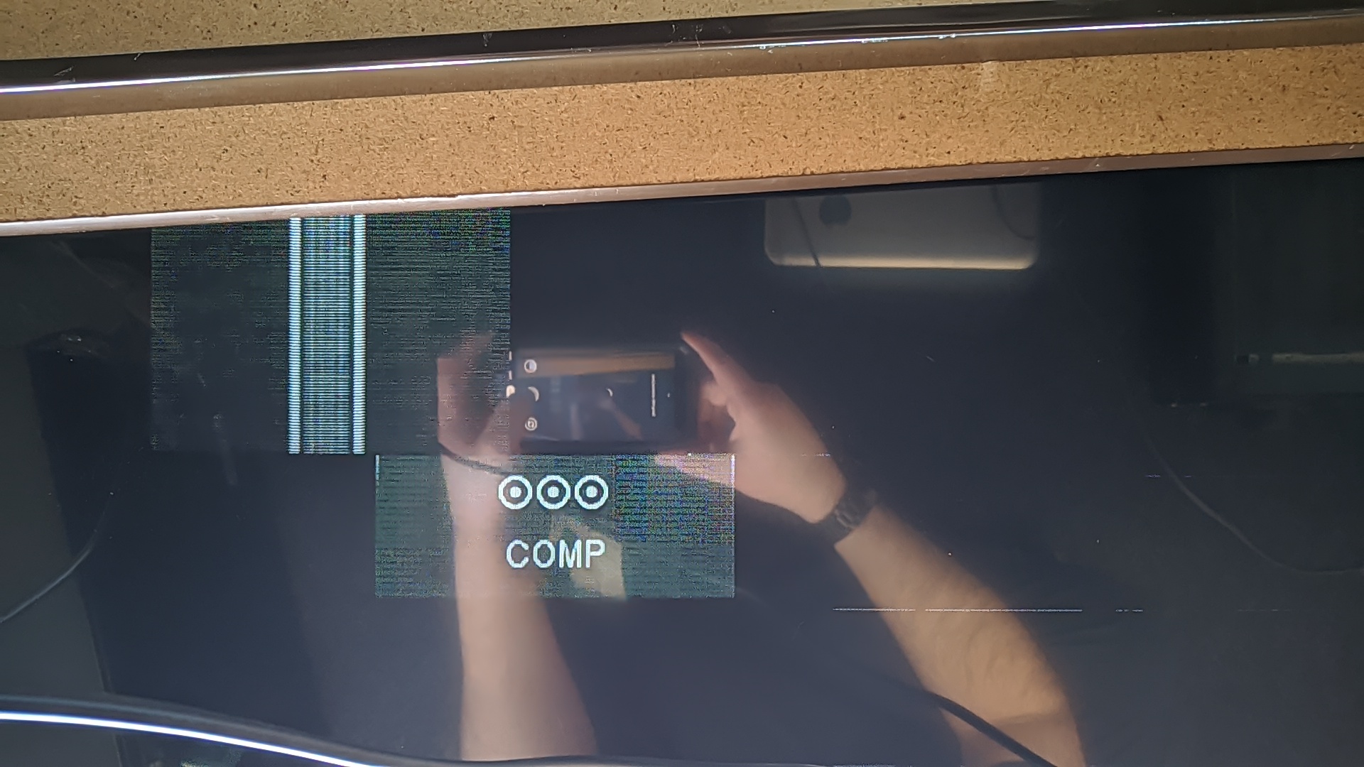

                          Another update. So in my last post, I showed how half the screen was black and the other half was distorted garbled mess.
                          So I took the TCON board out and checked it's fuse - it was OK. I checked some caps to see if any were short to ground. They weren't. I looked under the microscope to see if any resistors blew - they didn't appear to. So I decided to clean all of the connectors with some iso alcohol and then reinstalled the TCON.
                          Also, in my previous image, I didn't have the heatsink fully installed to the main board. I just had it loosely connected to test and see if it worked before going through the rather painful process of resoldering the heatsink on only to have to take it right back off.
                          Well, I went ahead and fully installed the heatsink including all thermal pads on the bottom, etc. Now, I don't get the line down the screen. I can see an image, but the images (such as the menu) is flashing around so rapidly, it's all over the place. It's not a steady image.
                          I took two pictures and a video to show what I mean. I converted the video to gif so I can post it here and not bother with YouTube. I had to make it small enough to be within requirements to post. Again, the images are taken from underneath, as I have the TV face down on a table. So what you are seeing is the edges of the TV hanging off the side of the table and taken from underneath. Attached are those images.
                          So I don't know if it was messing around with the TCON board or installing the heatsink that improved the image, so I am still where I was.
                          I don't know if I am dealing with a TCON problem or if it's still the mainboard causing the distortion I'm seeing. There is still that other chip that I haven't reflowed. Not sure if I should.
