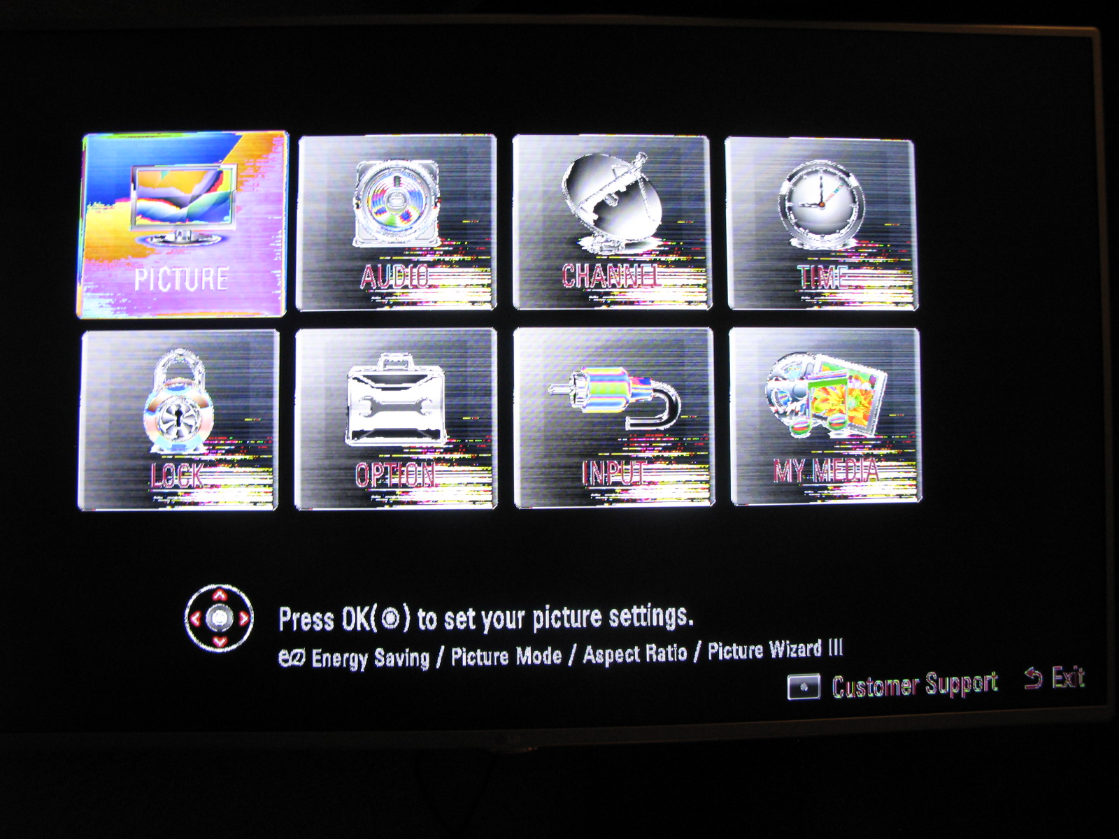

    LG 55LB5900-UV Smeary Image
    I've got the subject TV. When I got it, it only had the Power indicator light, but no activity when pushing the joystick style button.
    I replaced the main board, and it powers up, and looks to properly function, but the image isn't clear. It kinda looks like an old IBM CGA quality screen.
    Before putting more time and money into this, does anyone know if the initial indication for this problem points to a bad T-Con board, or something within the electronics of the panel? (or something else)

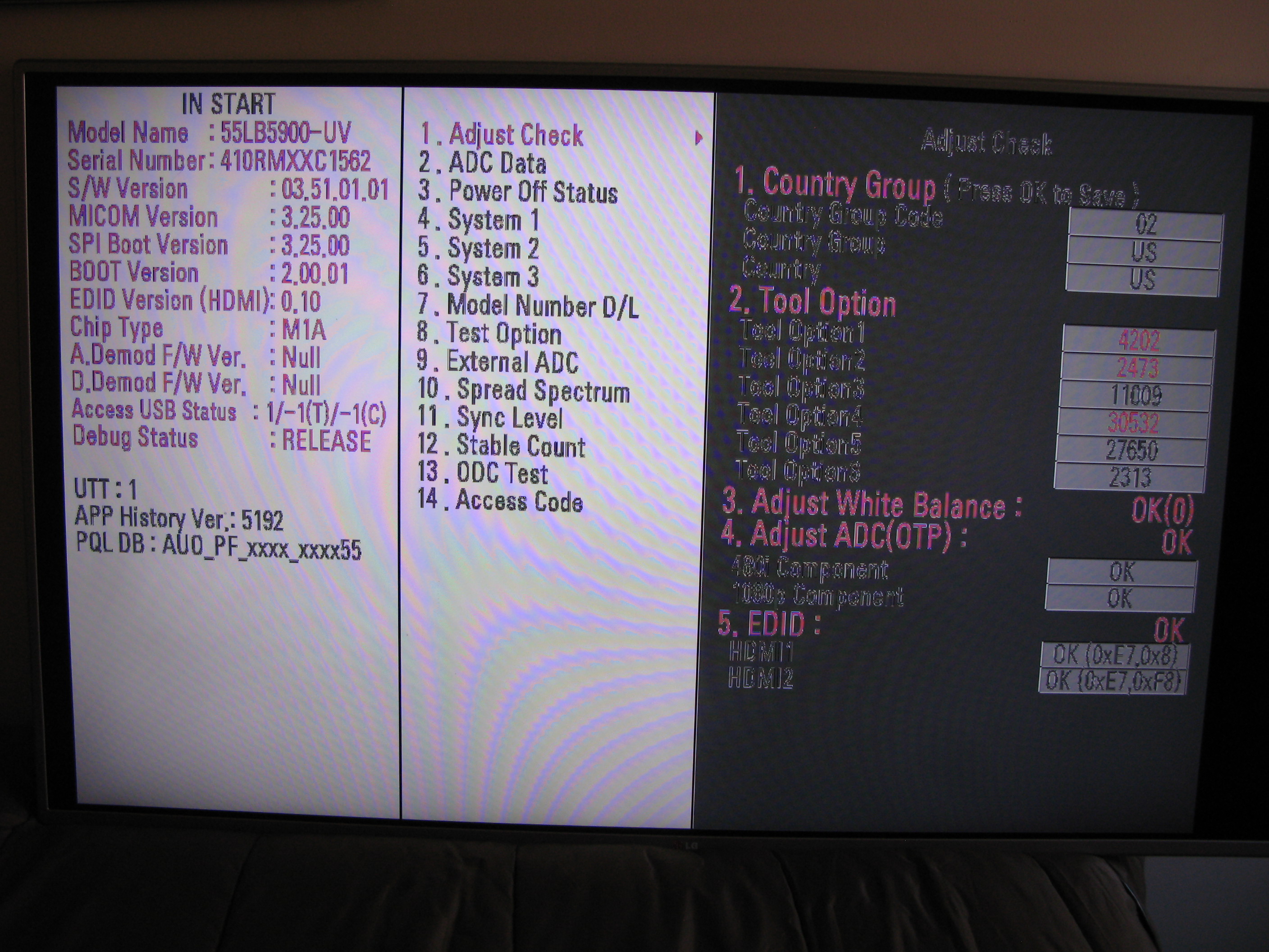

    after replacing MB need to inter "IN_START" service menu so you can discover if this replacement boards same label or screen size.. thought 49 55 65 all use same MB. but the setting at service menu different. you have different vlaue then with E_Z Adjust can change any things..
    BTW: "IN_STOP" will reset the MB to factory condition and will register yours T-CON wifi to the new MB.
    how to use IN_START IN_STOP. i posted over here many time android remote apk to use with any mobile build in IR sender.

      Re: LG 55LB5900-UV Smeary Image
      First let me give you a very belated Thank You for pointing me in the right direction.
      Too many projects put this TV on the back burner. (Actually way back.)
      I also had difficulty getting the software together on my old Galaxy S4 phone. Looking through other instructions, I saw that I could use a Logitech Harmony remote. I had one that was already set for a LG television, so I'm able to get into the EZ-Adjust, In-Start and In-Stop menus and change things.
      I have the panel set to 55", set the serial number (if that makes any difference), I also updated the firmware, and did the In-Stop.
      There's no change to the image though.
      I was looking at the EZ-Adjust panel settings. Right now it's set to:
      Tool Option 1 4202
      Inch 55
      Tool LB59
      Maker AUO
      LVDS_BTS 8BIT
      My service code ends in BUSCLJR
      I see the B is the suppler of electronics for the TV
      US is the country of manufacture
      CLJR is the the type of matrix screen manufacturer, as well as information from other manufacturers of components for the TV.
      That seems to be the information the main board needs to be set to. (Correct?)
      However, I don't know how to translate that into settings on that Tool Option 1 page.
      Edit:
      Actually scrolling through all the options, it seems changing the LVDS_BTS to 10 Bit only makes the image worse (That's the only other choice.)
      I went through the Maker choices Sharp, IPS, CPT, BOE, CSOT, LGD, INX. IPS and CPT shifted the image some, but that was all.
      Scrolling through Tool, the choices are LB56, LB55, LB60, LB62, LB565, LB53. There's no change to the display on any of them.
      I'm not sure if any settings change in real time besides the Maker and Bits options though.
      So maybe that's not the right menu to be working with.

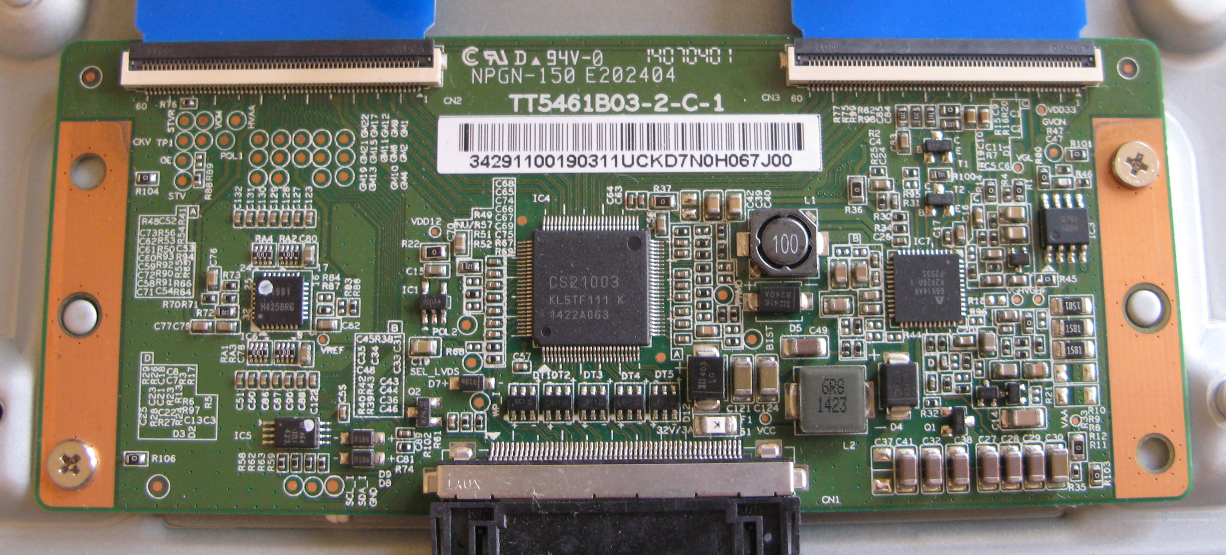

        Try having one ribbon cable at a time from tcon to panel plugged in, turn on tv, check display then do the same to the other side(make all connect and disconnects with tv unplugged from power)

          post clear focused photo for yours T-CON if any build separated with out metal shield. and all label you have on the chassis.
          also photo on the first screen of IN_START

            One things more.. if the main firmware at mainboards didn't match the early T-CON part firmware.. will cause problem too so the last firmware 03.51.01 try to update or downgrade then update...

              swap or copy the system settings eprom from original board to replacement one..

                Thank you again for the help.

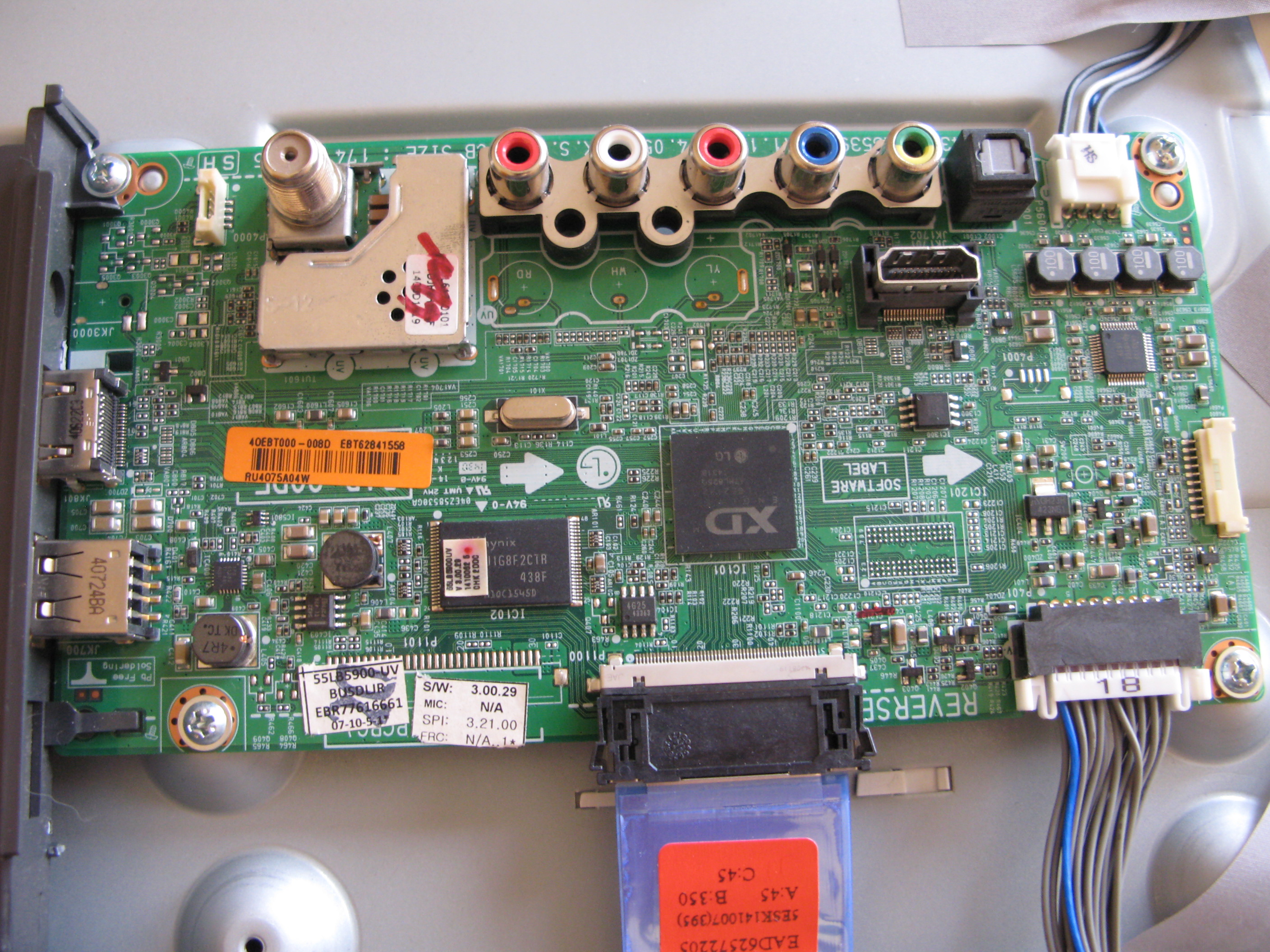

                Here are the photos you asked for. The board on the white background is the original.
                I've read some of these boards may have the old Ball Grid Array solder problem. Do you think it would be worthwhile to do the ol' toaster oven procedure on it?
                  Thanks for the reply.
                  When I removed each side of the T-Con to panel cable, the panel showed on side disconnected as solid grey. The side that was still connected still had the bad image.

                    did you changed any value at service M.? why the photo of IN_START show the right side not straight on screen displayed ?
                    google after Apache HTTP server for downgrade firmware... i think you need to try downgrade first then update or force it to flash the last firmware.. so micom version will matched main firmware.
                      I changed the items in Tool Option 1 as I said in my message of March 14, but I put them back the way I started. I also changed the serial number, but I don't think that affects anything.
                      The right side of the screen is straight. I think it was just the angle I was holding my camera.
                      I'm having trouble finding old firmware. The LG support site only has the current version, and other pages that I've found for firmware downgrades so far are for WebOS and network connected televisions. This one has no data connectivity.

                        repair yours original mainboards, swap or dump and flash the SPI from replacement to original, or in opposite way from original to replacement... keep always the dump in hand

                          pauldow, i see you are not reading my suggestion, as i can know downgrading firmware is not only unuseful but is an operation not supported by maker and is available maybe sometimes from the work of some tech geeks and are not validated works so at your risk. The only eprom to swap/copy is the 24c type eprom usually around 64>512kb that contains sys settings, if there is, if not sometimes settings are in a 25q type or togheter in the main flash.

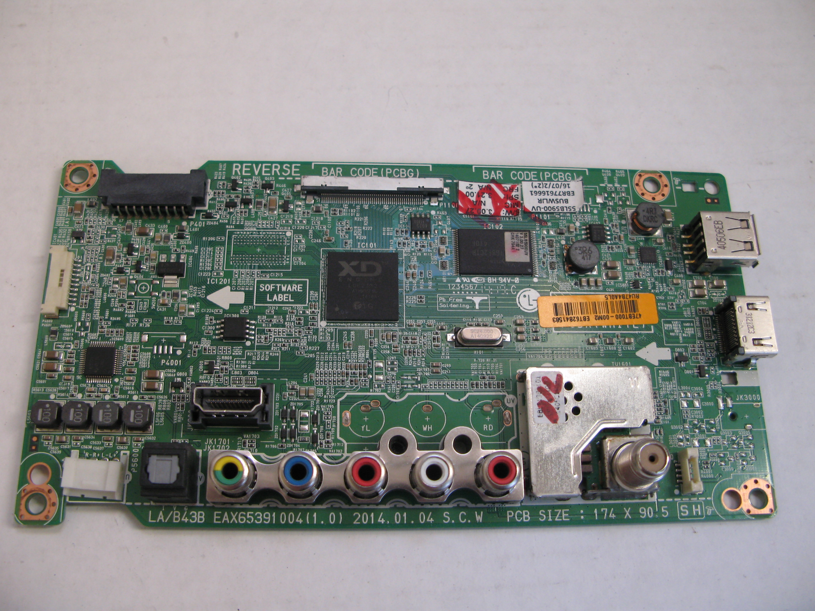

                            OK. I misunderstood what you were recommending I do with the EEPROM.
                            I put the original EEPROM on my replacement board, and the TV wouldn't turn on. I took a closer look, and while the soldering looks good around the integrated circuit, unfortunately I pulled off a couple of very small SMD components nearby. I did find them, but I don't know if I'll be able to get them back in place since they are so small.
                            I'll be back to let you know what happens.
                              I got a tiny resistor back in place, but I wasn't able to put a capacitor back. It just wouldn't stay in place, and it doesn't look good after all the time it spent with the tip of my soldering iron.
                              I think I'm going to have to give up on this one.
                              Thank you Diah and Davi.P for all your help on this. I have two other LG televisions in my repair queue, so I think the lessons you passed on to me won't go to waste.
