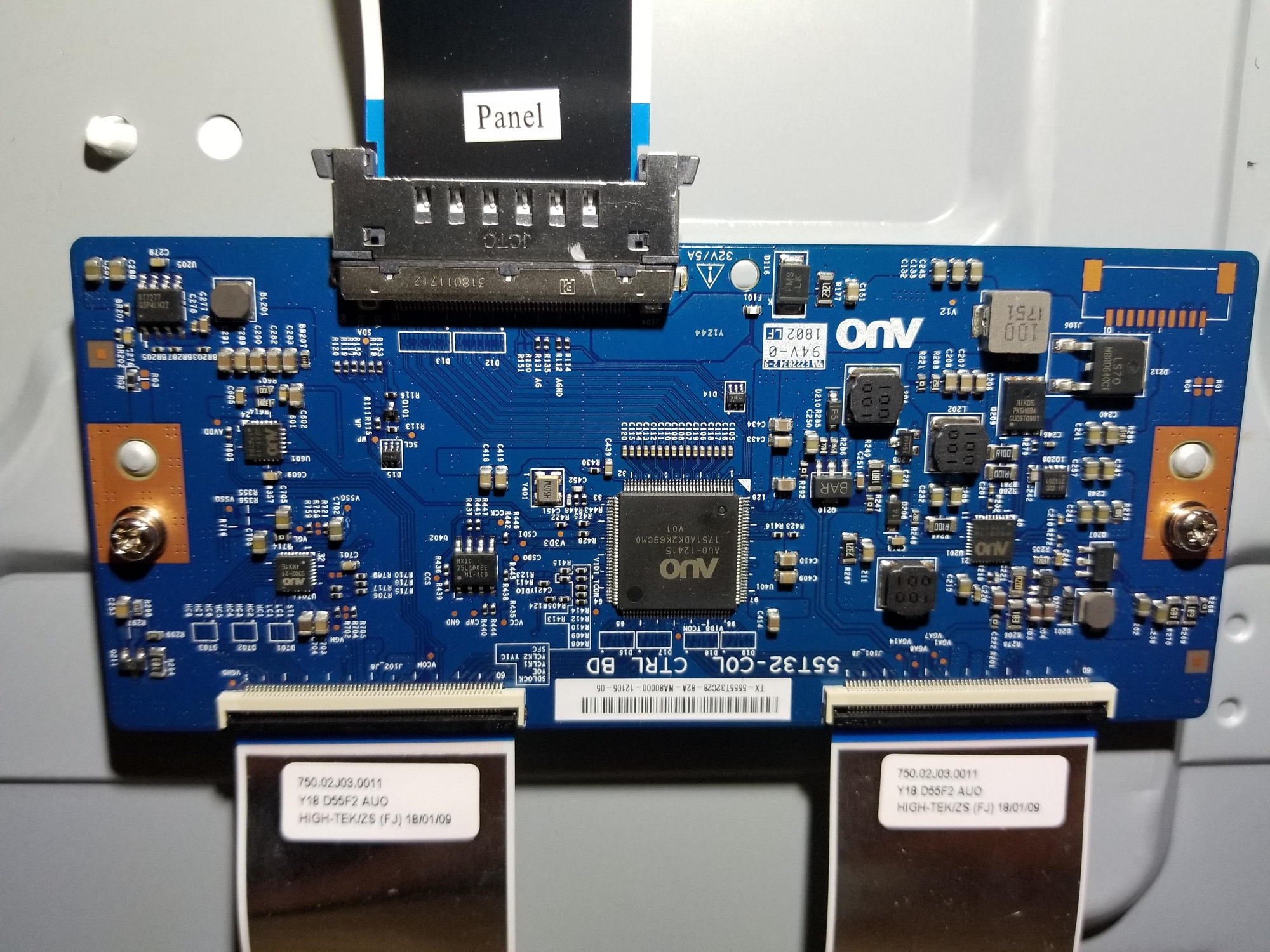

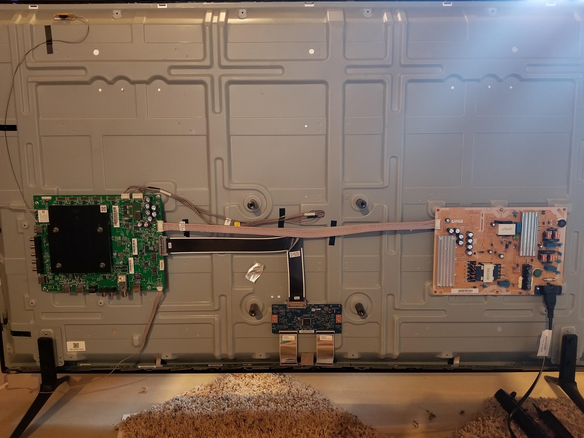

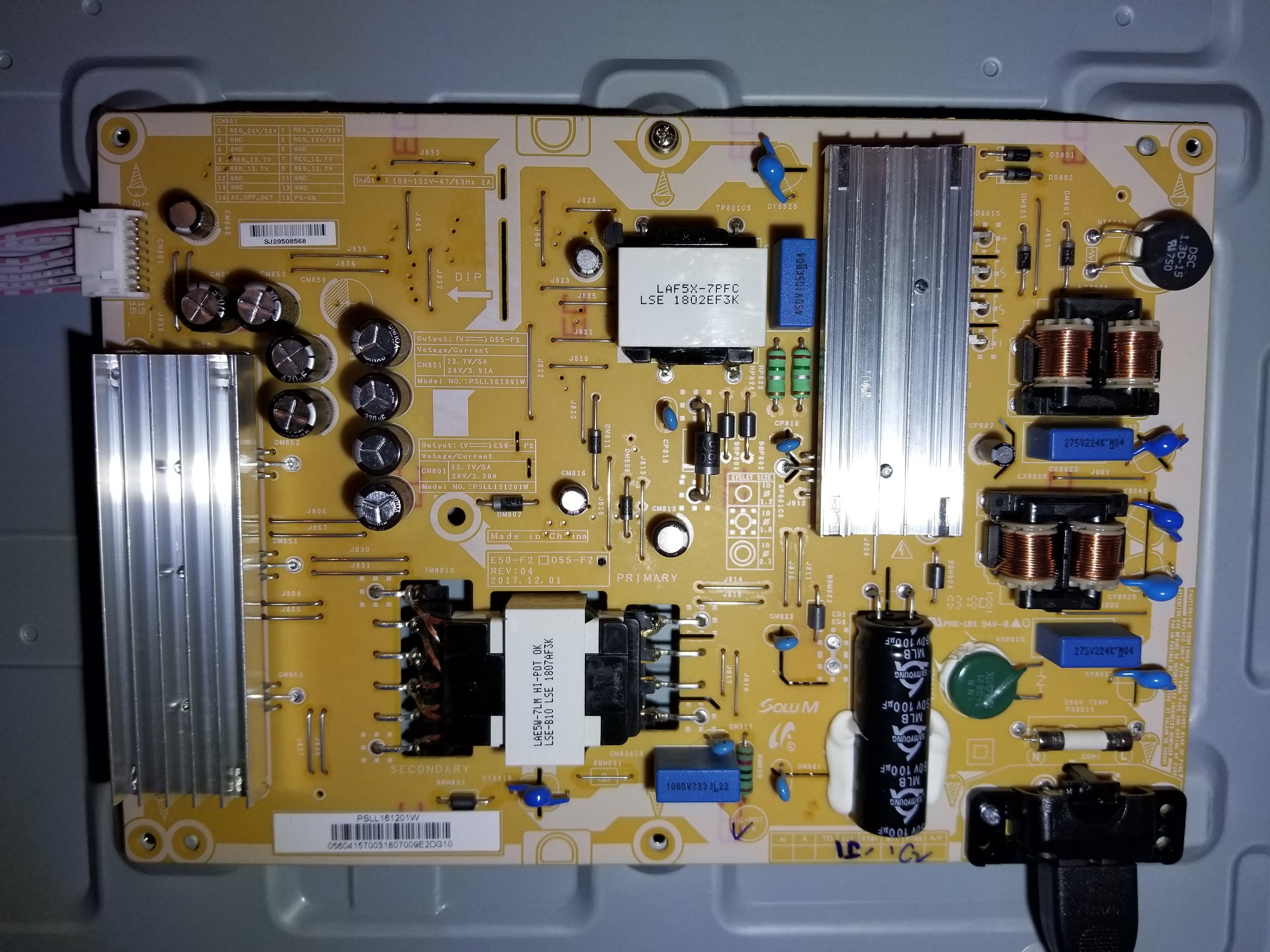

    Hello all! I'm looking for some help in trying to fix my parents-in-law's Vizio D55-F2 tv. The tv will power on, but the backlights won't turn on. I can see a picture using a flashlight and the tv responds to the remote. The audio also works. I have tested all the LED strips and all of the LED's illuminate on every strip when powered from a separate source. I used a multimeter to take voltages from connector CN801 on the power supply board and had the following readings:

    Pin7-10.06v
    Pin8-10.06v
    Pin9-10.06v
    Pin10-10.06v
    Pin11-0
    Pin12-0
    Pin13-0
    Pin14-0
    Pin15-0
    Pin16-0
    TV plugged in, powered on
    Pin1-26.55v
    Pin2-26.56v
    Pin3-26.55v
    Pin4-0
    Pin5-0
    Pin6-0
    Pin7-12.66v
    Pin8-12.64v
    Pin9-12.66v
    Pin10-12.64v
    Pin11-0
    Pin12-0
    Pin13-0
    Pin14-0
    Pin15-2.99v
    Pin16-3.36v
    Any suggestions on what to replace or test? I can handle probing points with a multimeter and some soldering/desoldering. Thank you in advance!

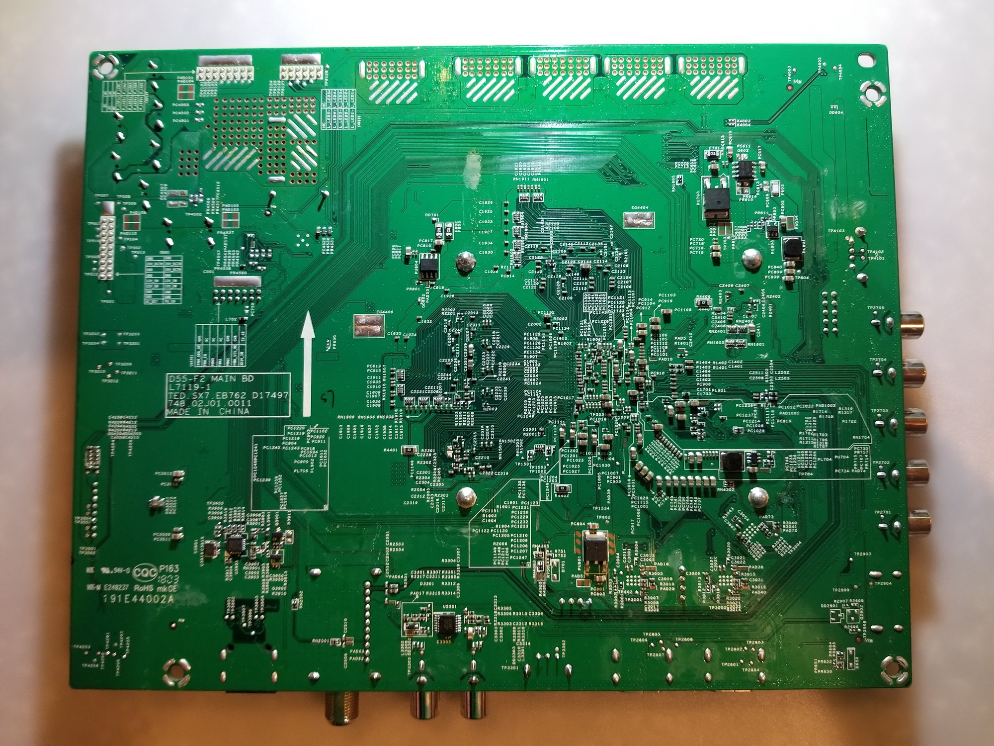

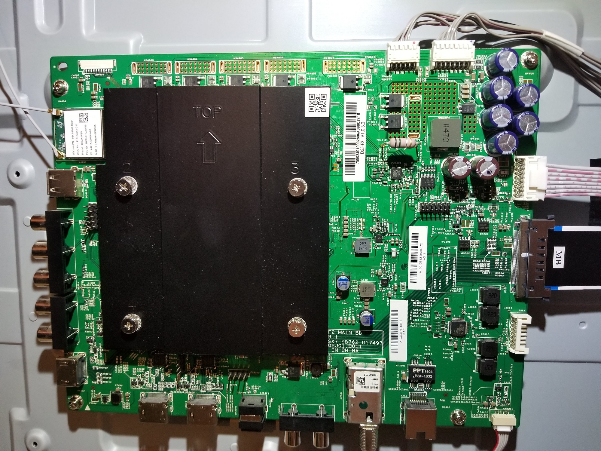

    Bit of a non standard configuration because the LED controller is on the main board and not the power supply. There should be a logic signal to turn on the backlight but it will be a trace on the main board and not a pin on the connector. If the backlight isn't coming on and the leds are good, then the main board is suspect if the supply voltages are also good.

      Thank you Neil for pointing me in the right direction. I had ordered a main board off of ebay, installed it and no luck. Not being convinced the ebay board was good, I ordered a different main board, installed it and have a working tv again! The in-laws are very happy to have their tv again.

        many vendors are confused on this main board. Have to go by the bar code as this is where the part # for the main board is. 75500w01b001 is for the 65" version - 75500w01c001 is the 55" version. The 75500W01C001 will not work in the 65" version as 4 of the 16 led strips will not be lit.
