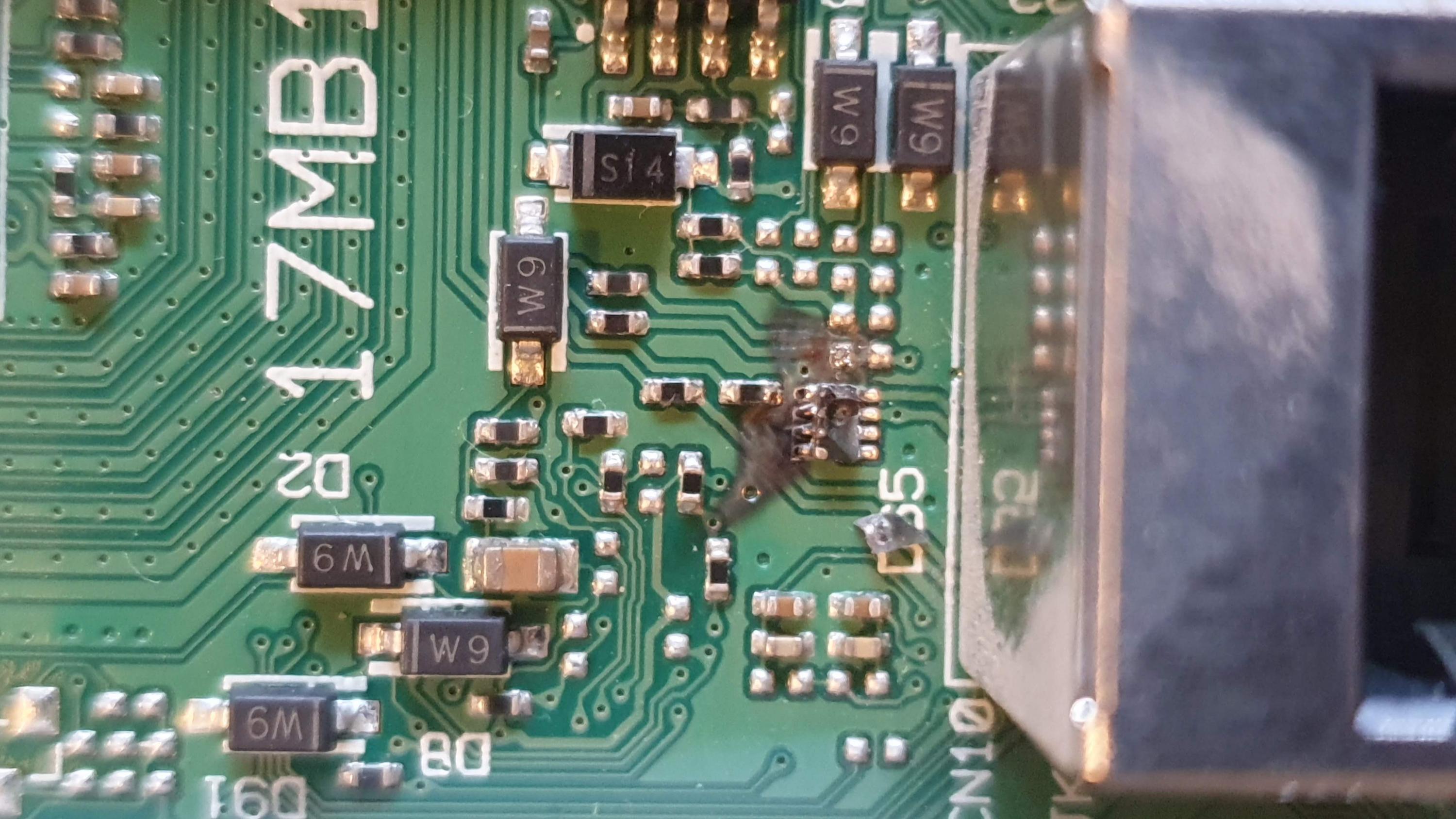

    on pin 7 iam getting 2,8V pin 5 and pin 3 is 0V when not connected to M/B
    When connected its all 0V
    EDit i found this on the mainboard ?!
      Re: Hitachi 43HB6T62 No Power
      You found the problem.
        Hello
        I ordered an new mainboard.. today it arrived only problem is it has the wrong firmware it is an Toshiba,
        So i tried te swap the flash ic, No result.
        I swapped back the ic again. What i did next is replace the defective part from the good board into the bad board, Result still no difference
        So ive been thinking since the board whas struck by lightning the 12V on the mainboard most be bad ?
