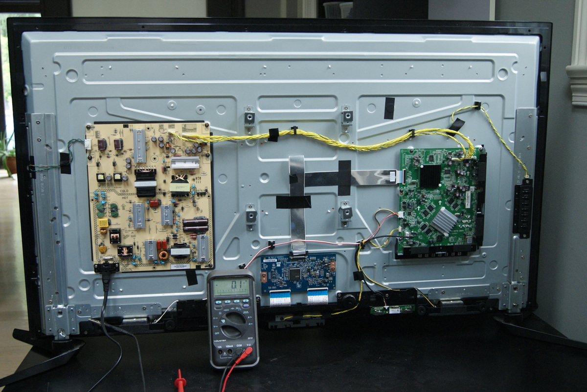

Sharp LC-50UB30U. Completely dead, no power indicator.
  • HAHOMETP
    • Nov 2012
    • 155
    Hello, folks.
    The TV in question just died on its own. When plugged in with the rear panel off I can hear momentary hissing from the PSU. The LED indicator is off. No response to the POWER button.

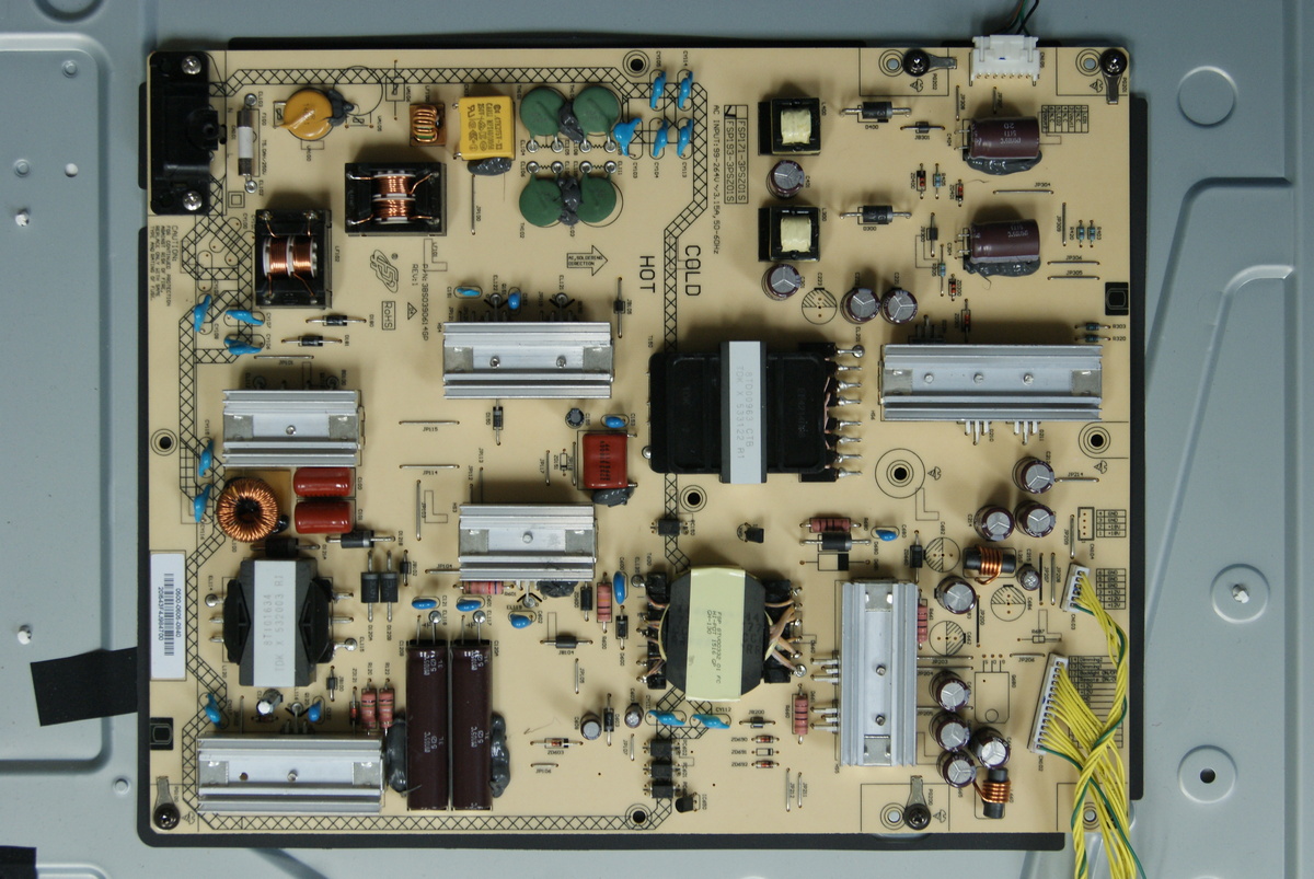

    PSU:
    The fuse is good.
    Varistors are good.
    No bulging capacitors, nothing out of the ordinary.

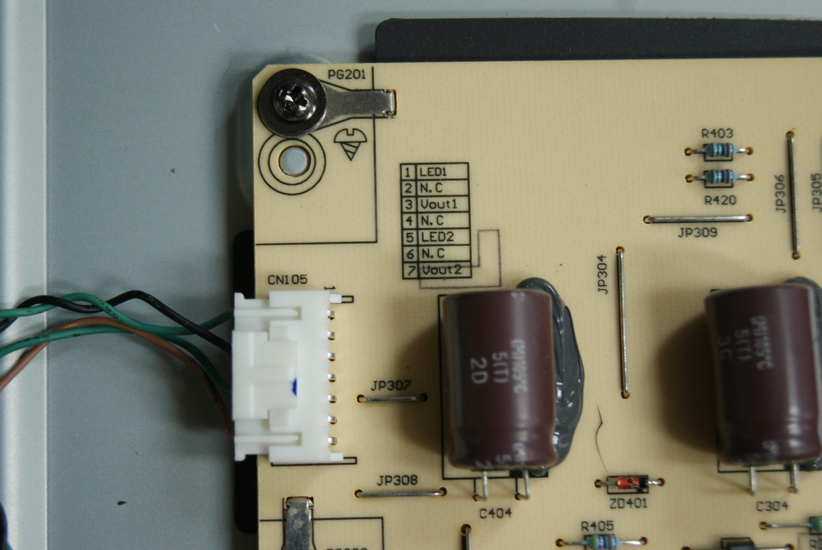

    CN102
    Pins 1,2,3 (Standby) = 5v
    No other voltages are present anywhere on the board.

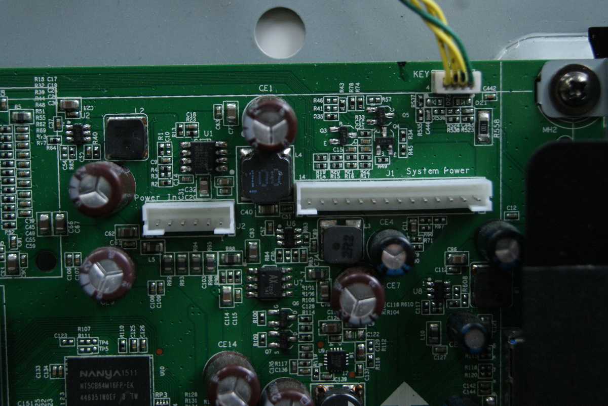

    My guess the MB is dead. Is there a safe way to connect CN102 Pin 1(+5Vsb) to either CN102 Pin 11 (Remote ON/OFF) or CN102 Pin 12 (Backlight ON/OFF) to verify my diagnosis?
    Thx!

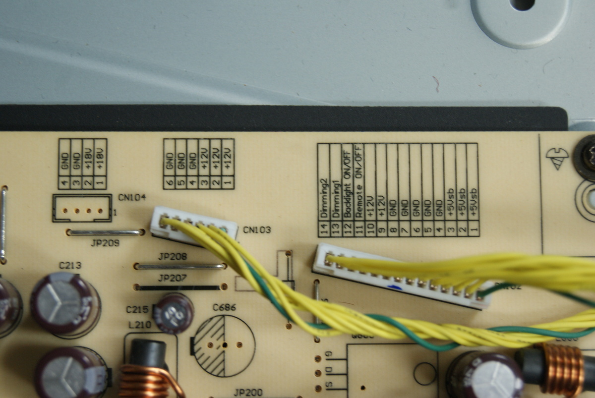

    If you want to test the power supply board, you must remove the cables to the main board first.
    You will then check the Voltage of the PD Remote on/off pin, BL_ON/OFF pin, Dim pins to see if they have built-in pull up-resistors or not, if they do then you should see >2V on those pins, if not you will need to connect the pull-up resistors.
    You will use resistors (1K, for safety in case you jump the wrong pin) between 5VSTB and the REMOTE ON/OFF, BL-ON/OFF; you may need another resistors on the Dim pins if the backlights do not come on.

      Thank you for the reply.
      Both cables from PSU to MB removed.
      If REMOTE ON/OFF pulled up to 5v via a 1k resistor:
      CN102 +12v jumps to +11v and slowly falls down, 5 seconds later the process repeats.
      CN103 +12v jumps to +11v and slowly falls down, 5 seconds later the process repeats.
      CN105 LED1 jumps to +2.7v and slowly falls down, 5 seconds later the process repeats.
      CN105 Vout1 jumps to +57v and slowly falls down, 5 seconds later the process repeats.
      CN105 LED2 jumps to +3.1v and slowly falls down, 5 seconds later the process repeats.
      CN105 Vout2 jumps to +57v and slowly falls down, 5 seconds later the process repeats.
      If BL-ON/OFF also pulled up to 5v via a 1k resistor:
      same as above.
      If Dimming1 and Dimmng2 also pulled up to 5v via 1k resistors:
      CN102 +12v jumps to +10v and slowly falls down, 5 seconds later the process repeats.
      CN103 +12v jumps to +10v and slowly falls down, 5 seconds later the process repeats.
      CN105 LED1 jumps to +20v and slowly falls down, 5 seconds later the process repeats.
      CN105 Vout1 jumps to +82v and slowly falls down, 5 seconds later the process repeats.
      CN105 LED2 jumps to +20v and slowly falls down, 5 seconds later the process repeats.
      CN105 Vout2 jumps to +82v and slowly falls down, 5 seconds later the process repeats.
      During each of these 5 second pulses the backlight flashes several time like a stroboscope with a frequency of several hertz, and this frequency decreases during the pulse cycle.
      To measure the above I had to break out my trusty 1958 analogue multimeter since the digital multimeter was going all over the scale during the pulse giving uncertain readings.

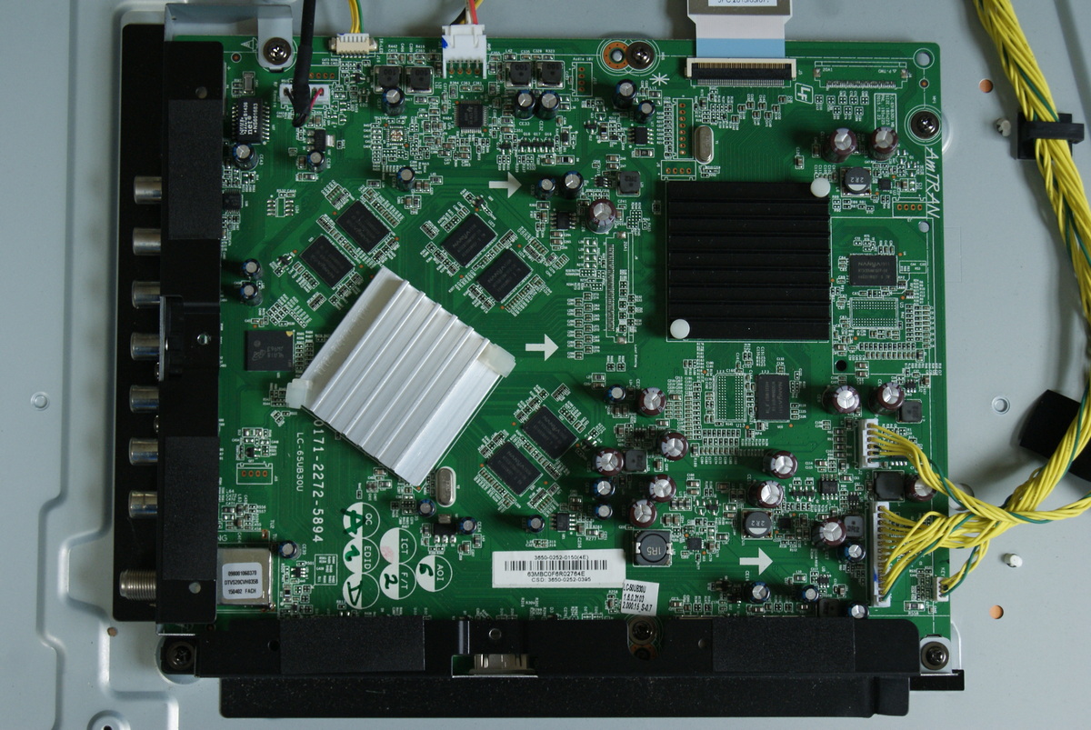

          So it's not the MB... Will be pulling the PSU off the chassis tomorrow and checking every p-n junction on the board.

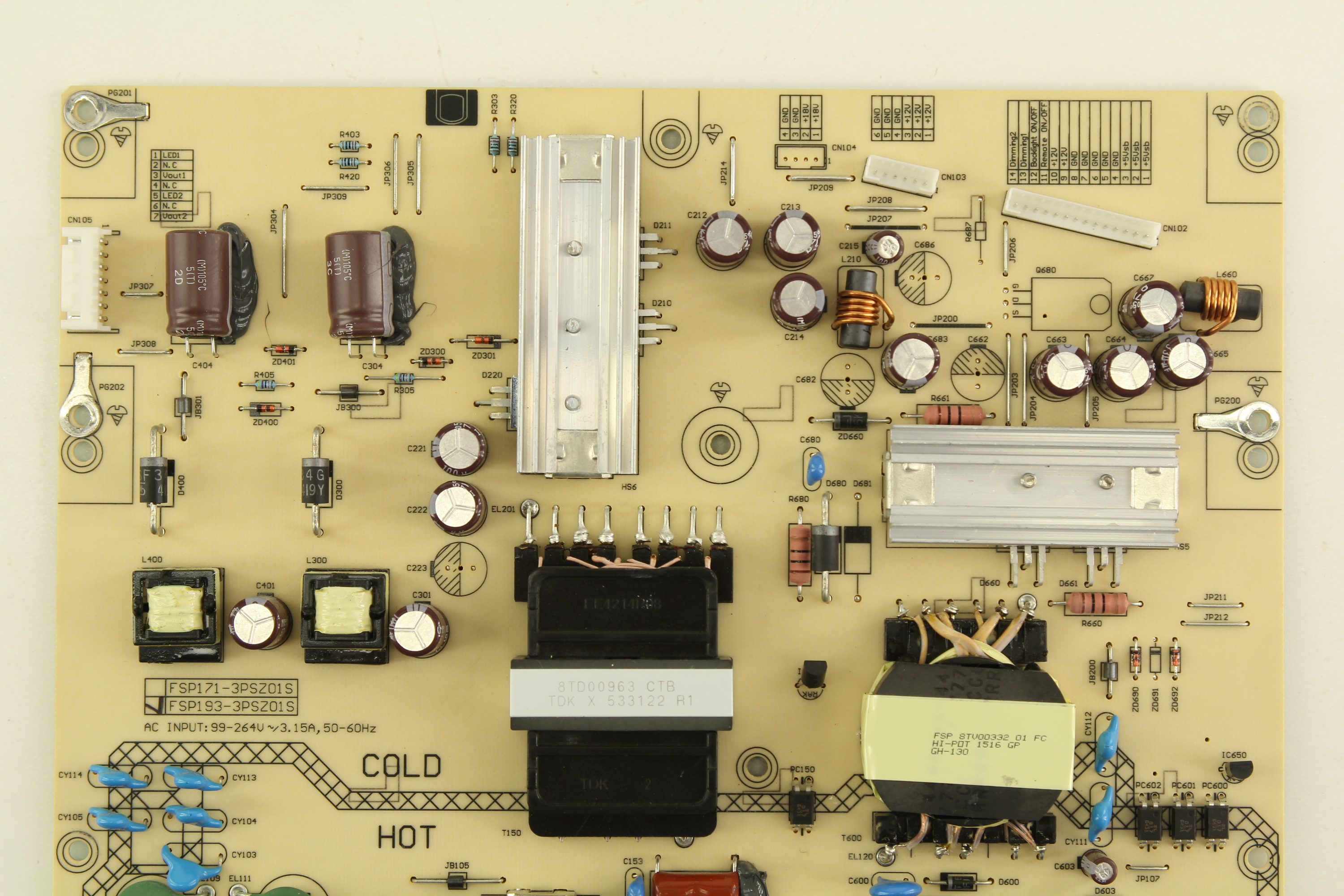

            Quickly tested near every semiconductor in situ (except a few SMD chips on the track side) - no shorts, all show the expected voltage drop in the forward direction.
            Could it be that the backlight strips have a few burnt LEDs that trigger the shutdown like the old fluorescent tube monitors did when one tube was out?
            OTOH the standby LED on the front never comes on when the TV is plugged in. So if the +12v part of the PSU is out then the MB never gets powered up thus the MB never tells the standby LED to come on. This probably indicates a defective PSU.

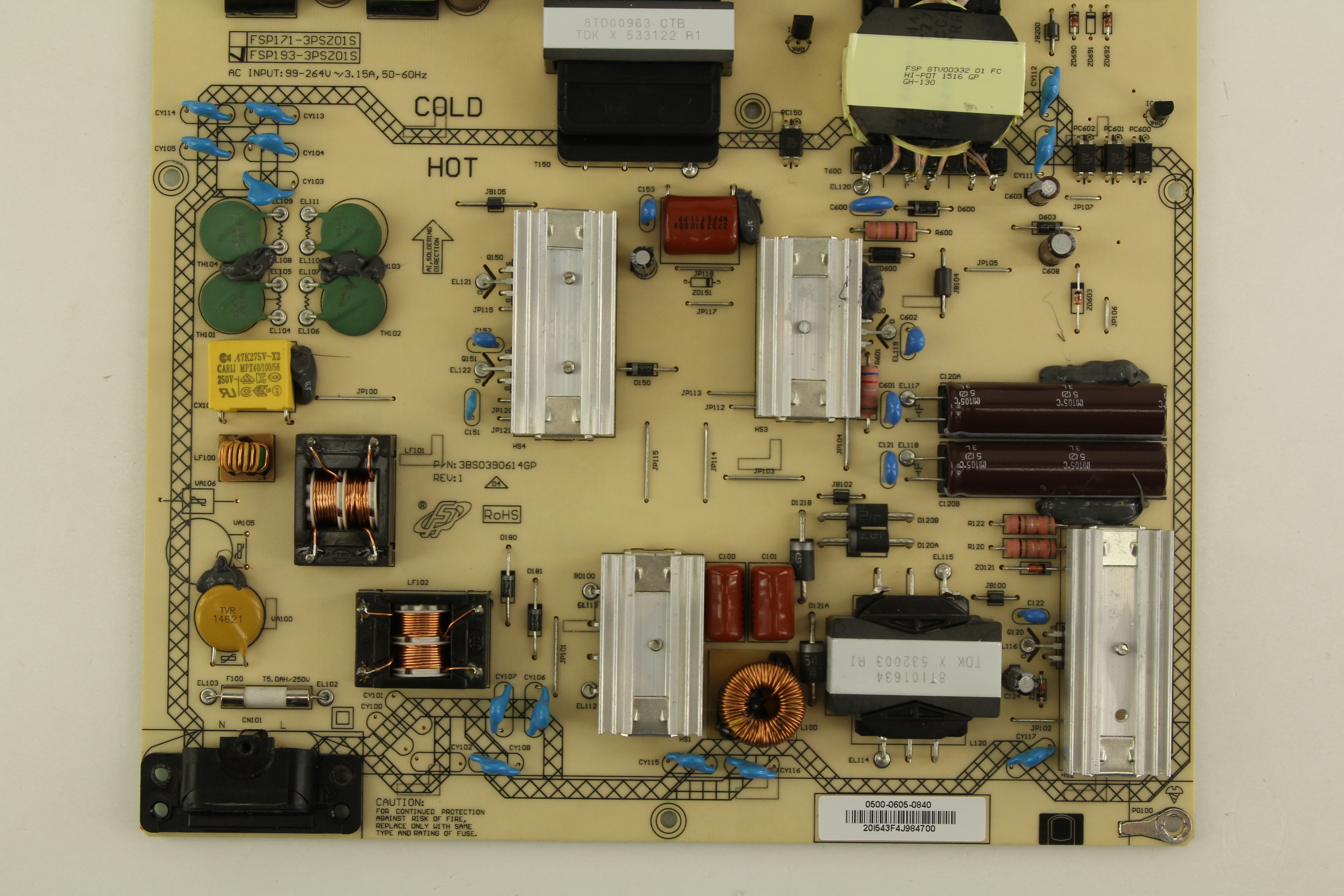

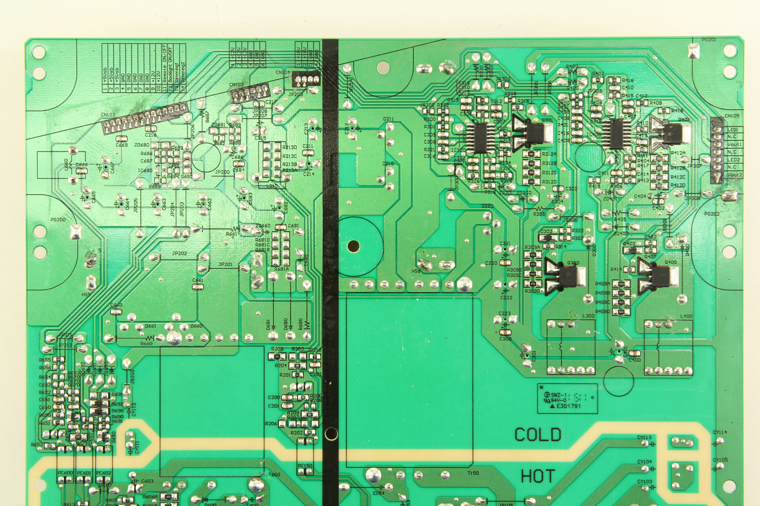

                BTW, I need good clear high res straight shots of the whole bottom side of the power supply board so I can do circuits tracing.
                I also think you may have problem with the main board since the standby power supply is OK, but right now we want to make sure the power supply board is OK.
                  Will do so in a lightbox with an SLR camera when get back home from work later today.

                      With the backlight disconnected the +12v pins still jump to +9.8v and slowly drop to +6.4v in about 15 seconds. Attached are the pictures of both sides of the board, top and bottom.
                      I am beginning to suspect a cracked transformer Ferrite core.
                        Re: Sharp LC-50UB30U. Completely dead, no power indicator.
                        I really have to trace out the circuit where Transformer T150 is to see what is driving it, etc. so it may take me awhile to figure out what is going on, I am really busy right now with so many threads.
                        I download all your pictures so I will have look through them.

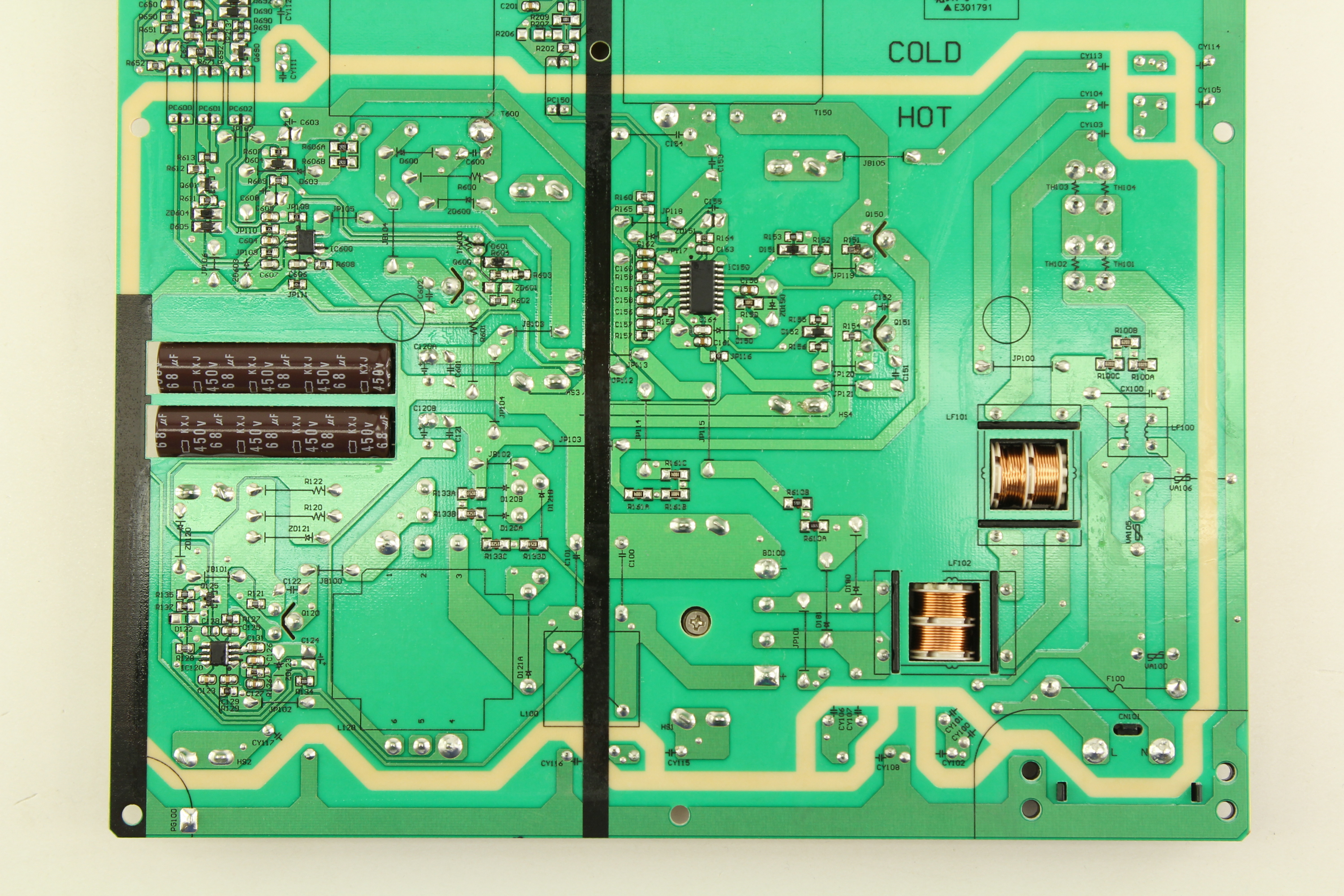

                            Can you provide the number for IC150? Also what is the voltage across C120a or C120b, This voltage should be around 160vdc in standby and increase to around 380vdc when turned on, (this is the pfc voltage) If it is not coming up or changing it might be a simple as a bad C155
                            • HAHOMETP
                              • Nov 2012
                              • 155
                              IC150: SSC9522S
                              C120a and C120b:
                              STANDBY: +164v
                              REMOTE ON: jumps to +340v, then drops down to +220v in about 13 seconds, then jumps to +340v and so on.
                              C155: 10uF x 50v, 105°C, Rubycon, 9.3uF actual as measured out of the board.
                              Replaced anyway just in case with a 10uF x 50v, 125°C, GXE, 11.1uF actual as measured out of the board.
                              No difference.

                                  Have you tried disconnecting CN103 to see if the 12 volts stays up?
                                  The pfc voltage does seem low, it is usually around 385vdc, when it is turned on it should stay steady, It looks like the pfc ic is ic120 (post its number also) C124 is be the vcc supply filter for the ic so it could be low causing the ic to shut down and restart. The VCC supply for the pfc and main ic150 comes from the standby circuit (C603) and is switched by a small transistor, likely by Q601 which is both a switch and a regulator, ZD604 and D605 should be connected to Q601 base and they set the VCC voltage on the transistors emitter, usually around 15~16 volts. It looks like PC601 is the optocoupler that turns on Q601.
                                  C603 should have around 18~20v and connects to Q601 collector. R613 connects to one pin of pc601 and the other pin connects to Q601 base. So check that C603 voltage is good and steady, then check Q601 base and emitter voltages

                                      Remember ALL voltages on the primary or HOT side use hot ground not chassis ground.
                                      Those voltages seem low, the ncp1608b startup threshold is 11 volts, this supply would come from Q601 emitter.
                                      It could be that C603 is weak, Can you make out the markings on ZD604?
                                      Even the startup VCC for the main ic ssc9522s is 11.8 so the voltages are just enough to start but likely not enough to maintain operation. IE if the vcc drops to 9.8v the ic will shut down, this voltage can drop and your meter would not pick that up.

                                        You may also want to check that D121A, D121B, D120A & D120B are ok and not shorted. Sometimes if one of the diodes short the pfc will not operate to full boosted voltage, this is not likely the issue but worth checking.
                                        ZD604 marking would help as that will confirm the vcc operating voltage.
