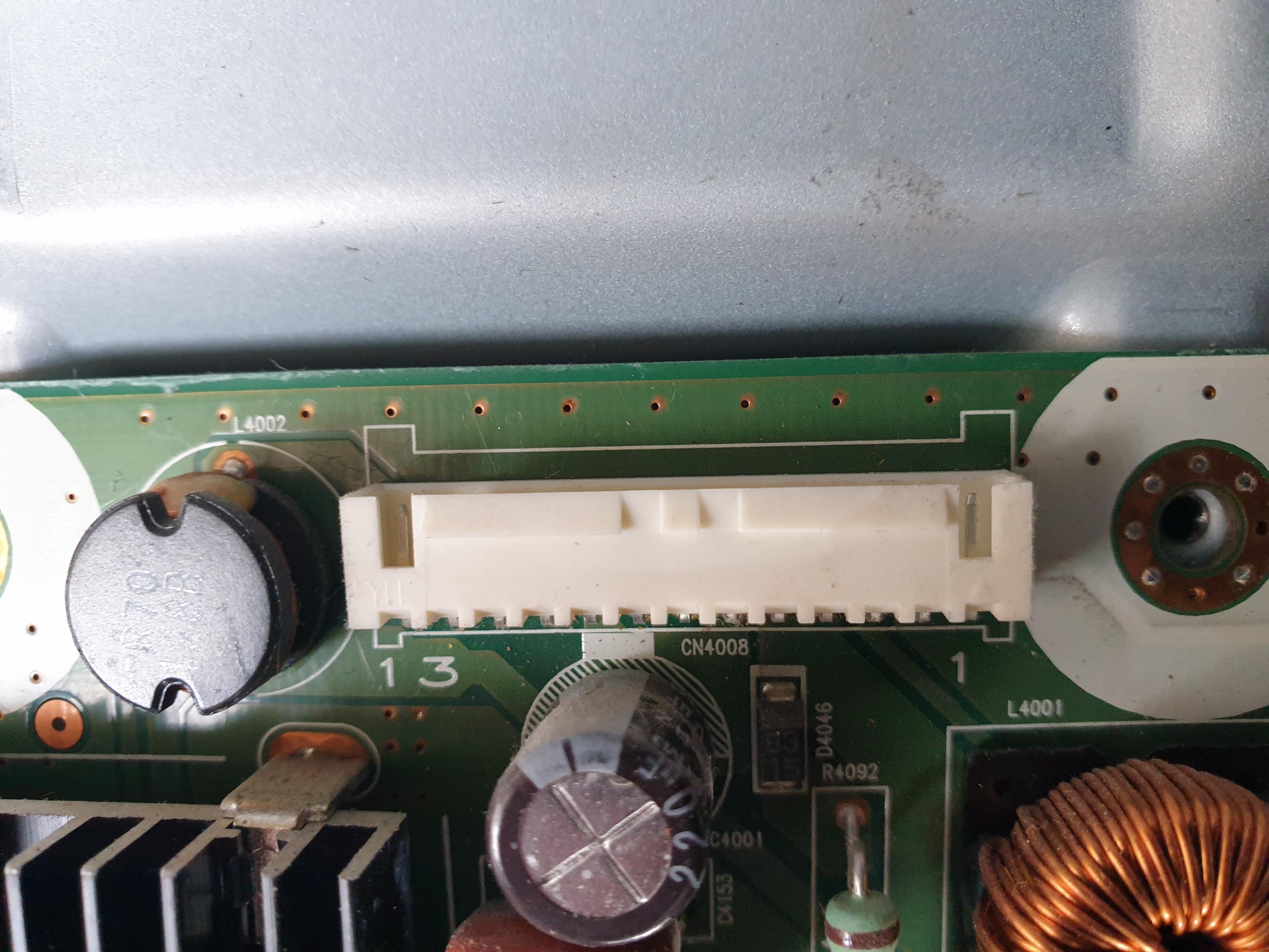

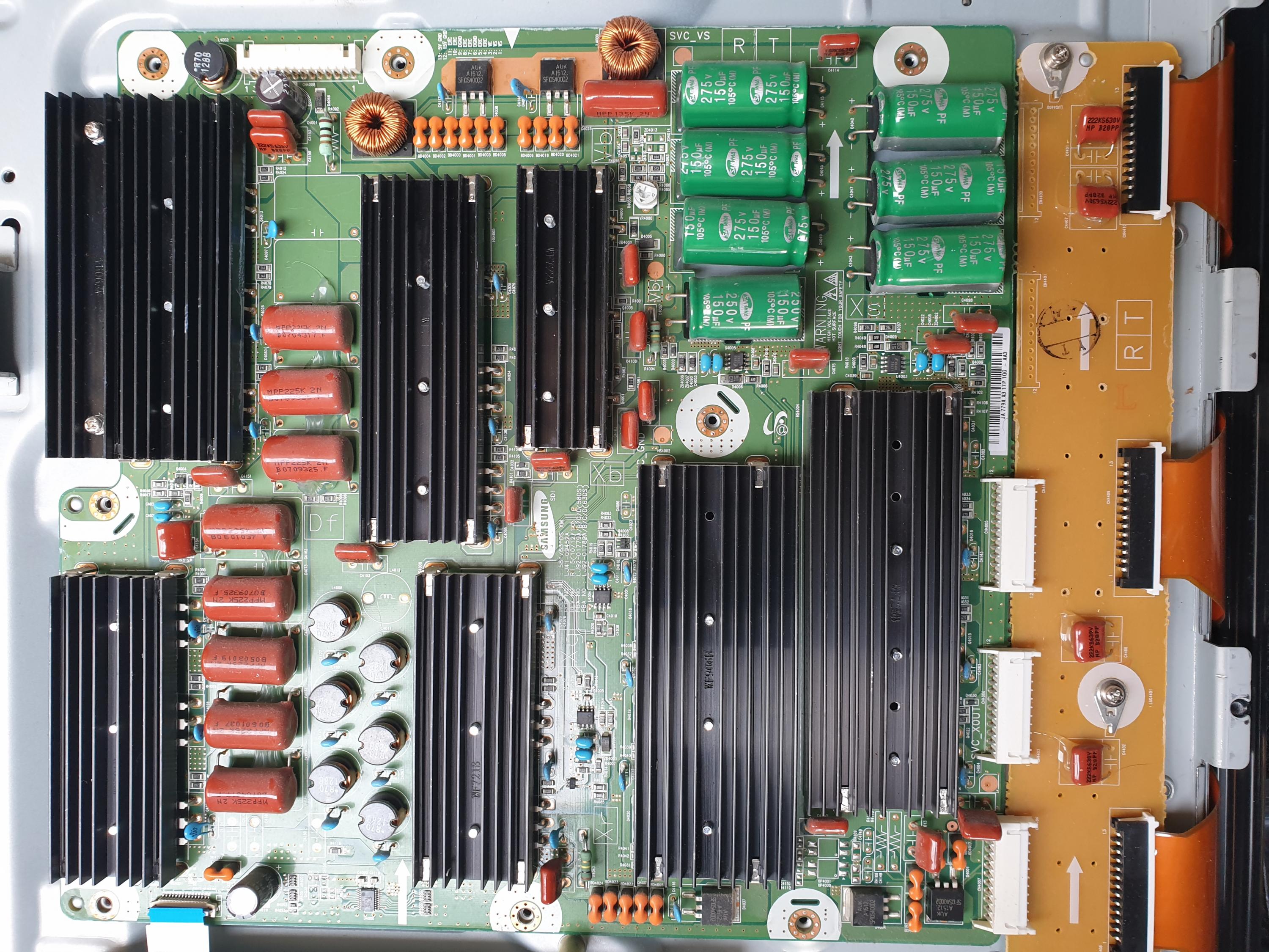

    I have a problem with the SWMP shutting down into protection due to a short detection on the VS -ON
    A Big thankyou to BUDM for his intuity and help finding it
    I unplugged every board except the logic and SWMPS boards and using the test procedure in service manual forced on the power supply board which gave me my VS 217v & VE 54v so i know now my power supply board was ok to begin with and i didnt need to pay for a new one DOH!
    SO i have narrowed it down to the below condition
    Please refer to PICTURES
    I noticed on the X Main board the Cable that joins the X&Y boards
    @ pins 1 & 2 that go to pin 12 & 13 =VS on the Y Mainboard
    NOTE Y MAINBOARD IS UNPLUGGED
    i am seeing a short to gnd when resistance testing pins 1 & 2 atthe plug on X main board
    is this correct ? or have i just found why my PS is shutting down in Error protection
    Cheers
    Wayne

    Re: Samsung Model PS59D8000 X-main
    Pins 1 & 2 on the second photo appear to be connected to the same wide track.
