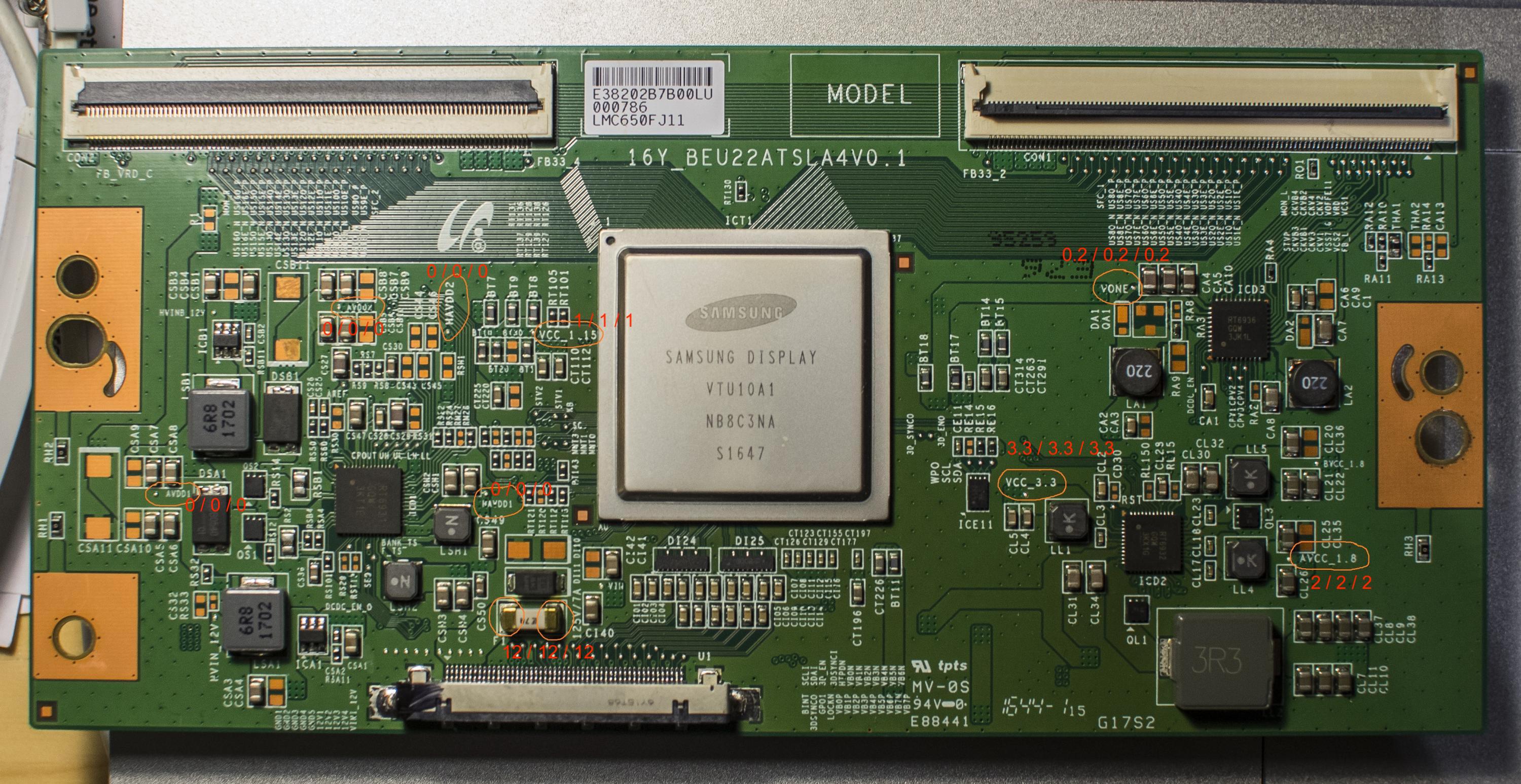

    Hi!
    A bit of a disclaimer right off the bat : I don't have much experience in electronic repair, but I'm more than willing to learn and spend time researching what has to be researched. However, I expect I'll have to ask for guidance on some of the advice you'll make me, as I might not exactly what you're asking for. As for equipment, I have a basic soldering iron, a multimeter and a very good electronic store nearby.
    My problem : I was given a broken TV, model Haier 65uf2505. From my initial analysis, I believe the t-con is defective. Here's what I noticed :
    - The TV turns on
    - Screen turns to a glowing gray
    - The backlight definitely works
    - I have sound coming through the TV
    Now, what I would like to do is try to repair the actual part that is defective (be it on the t-con or someplace else) rather than replace the whole board as I want to learn as much as possible and spend as little as possible. I don't need this tv to work, I would just like to give it a second life and prevent another usable electronic hiting the landfill.
    I'm removed the t-con board from the tv (pictures below) and upon close visual inspection (I don't have a microscope, I use an high res picture and I zoomed in), I don't see anything highly suspicious. However, my eye is not well trained. Same can be said for the power board and the other board (I forgot the name).
    My question is thus : where should I start? I recon from reading Budm basic troubleshooting guide that I should check if the t-con is getting proper power, is that correct? If so, I would need help to know what to measure exactly.
    Pictures :
    t-con board (removed from TV)
    back of tv (t-con board missing because removed)
    Thank you for your time and help.
    Re: haier 65uf2505 help with T-con problem diagnosis
    1) Check the resistance of the Fuse F1 (small white body with 7A printed on top), it should show the same resistance when you touch your two meter probes together, if it does, the put all the board back in place with all the mounting screws and cables all connected backup.
    2) Plug the TV in and turn it on then check the DC Voltage between each end of the fuse against chassis GND, it should be 12VDC.
          Some update :
          I screwed the t-con board back in place, plugged all the cables and turned on the tv.
          I checked the DC voltage of the Fuse F1 and it gives me the expected 12V on both sides.
          What should I test next?
            try this test and report back the result.
            1-the tv most have signal and you can hear the sound of the signal
            2 - remove one ribbon cable once at time ( ribbon cable you have 2 between the t-con and the panel ) and see if you half screen displayed ( do it for both left and right )
              3 - Measure the voltages at the points marked in red and see if there are any differences when connecting the ribbons. Especially the VONE voltage.
                Ok! After much effort, I did what you asked for :
                I turned on the tv and check DC voltage on the marked spot. I tried to double and triple check all results, but don't hesitate to ask me to measure another time some spots if something doesn't make sense.
                The results are written on the attached image itself (might need to zoom in a little to see) in red, in the following format :
                x / x / x -->*both ribbons / left ribbons / right ribbons
                Thank you for your help!
                    Check the resistance of those test points in the LEFT side of the board where IC01 is with ref to GND, same on VONE test points.
                    What is the P/N of that IC01 in that section?
                      Ok, here's what I understand from what you're asking me :
                      I think you want me to check the resistance to ground of the test points that are on the left side of the boards (the side where most of the DC results were 0), meaning I will place my multimeter on resistance mode, place the black prong on the chassis and the red on the different spots.
                      However, where exactly should I place the red prong? I'm currently trying to place it on the super small metal spot near the circles I was given, but should I also place it on the different parts beside, like the different resistors/transistors/diodes nearby? For instance, to the right of VONE there is a small metal dot and then three resistors, should I just touch the metal spot, or am I to measure the resistance to GND of the three resistors?
                      I can't find IC01 :/ .
                        Thank you for your help! I tried and got no partial image.
                        as this test nothing show on the screen and other test of VCC you have on T-CON, i would suggest you to make visual inspection to the screen before you go forward to spend money..
                        just take out the rand cover of the panel to have access visually to inspect the screen glass at the end ..specially the 2 corner left and right if there are any damage to the thin film which found downside the glass.
                          The same test points that you were testing the Voltages earlier, we are just repeating the same test points but set meter to Ohm mode instead.
                          I still need the P/N of the IC i request, it is black square IC to the right of RSB1. See picture.
                            I didn't have much success trying to get the resistance of the check points on the left side of the board. Every spot I tried to check didn't make the meter react, or if so, value would bounce around and go back to default ("1"). I tried cheching the resistance of some resistors by placing both probes on each end and it was showing "normal" values. So I'm not sure why I'm not getting anything on the other spots.
                            Tv was turned on, meter was set to Ohm, black probe on the chassis and red probe going around the different marked spots on the picture.
                            See the attached picture to see what my meter gives me as a result for each of the spots.
                            As for the P/N (which I assume stands for positive/negative) of the IC you requested, I don't know how to measure that, can you give me some pointers?Thank you for the picture, I located the proper part.
                              I am looking for abnormal low Ohms reading on those test points.
                              P/N = Part number as printed on top of the IC.
