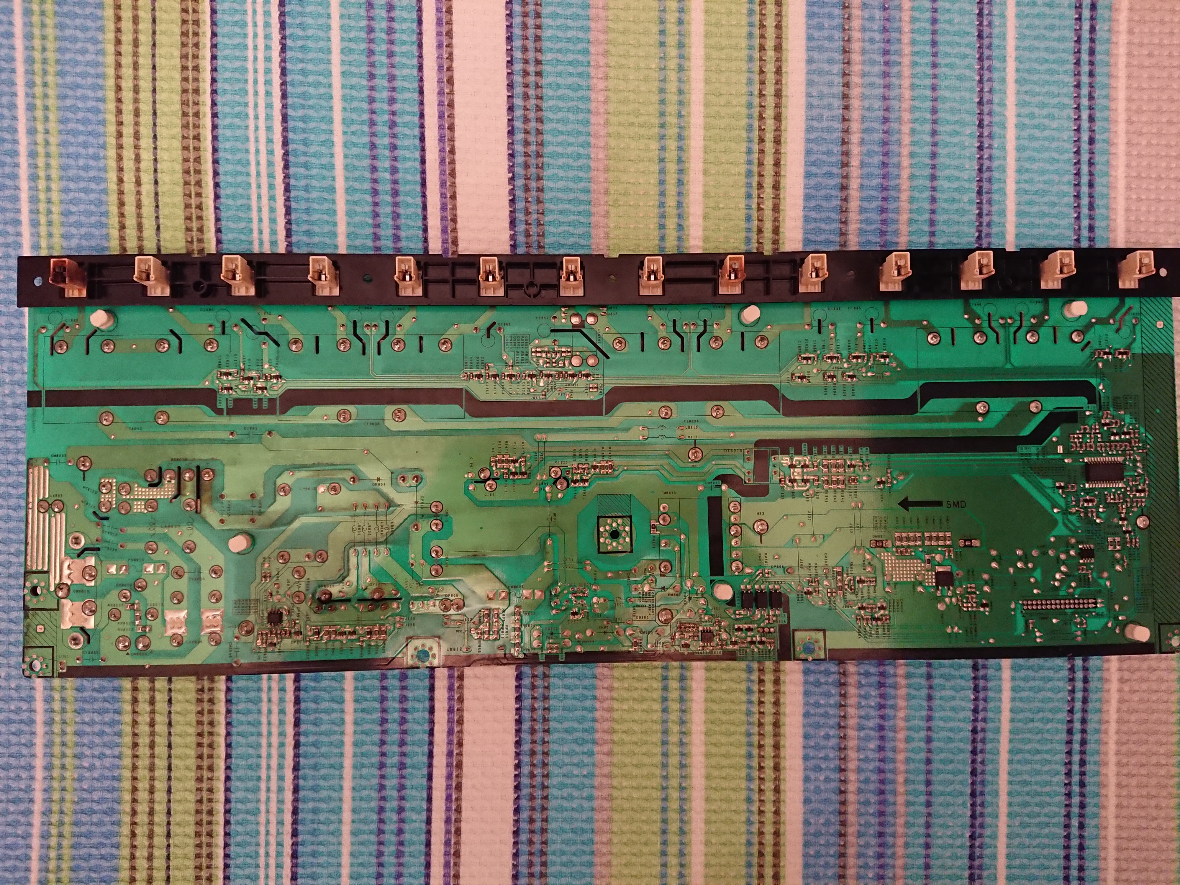

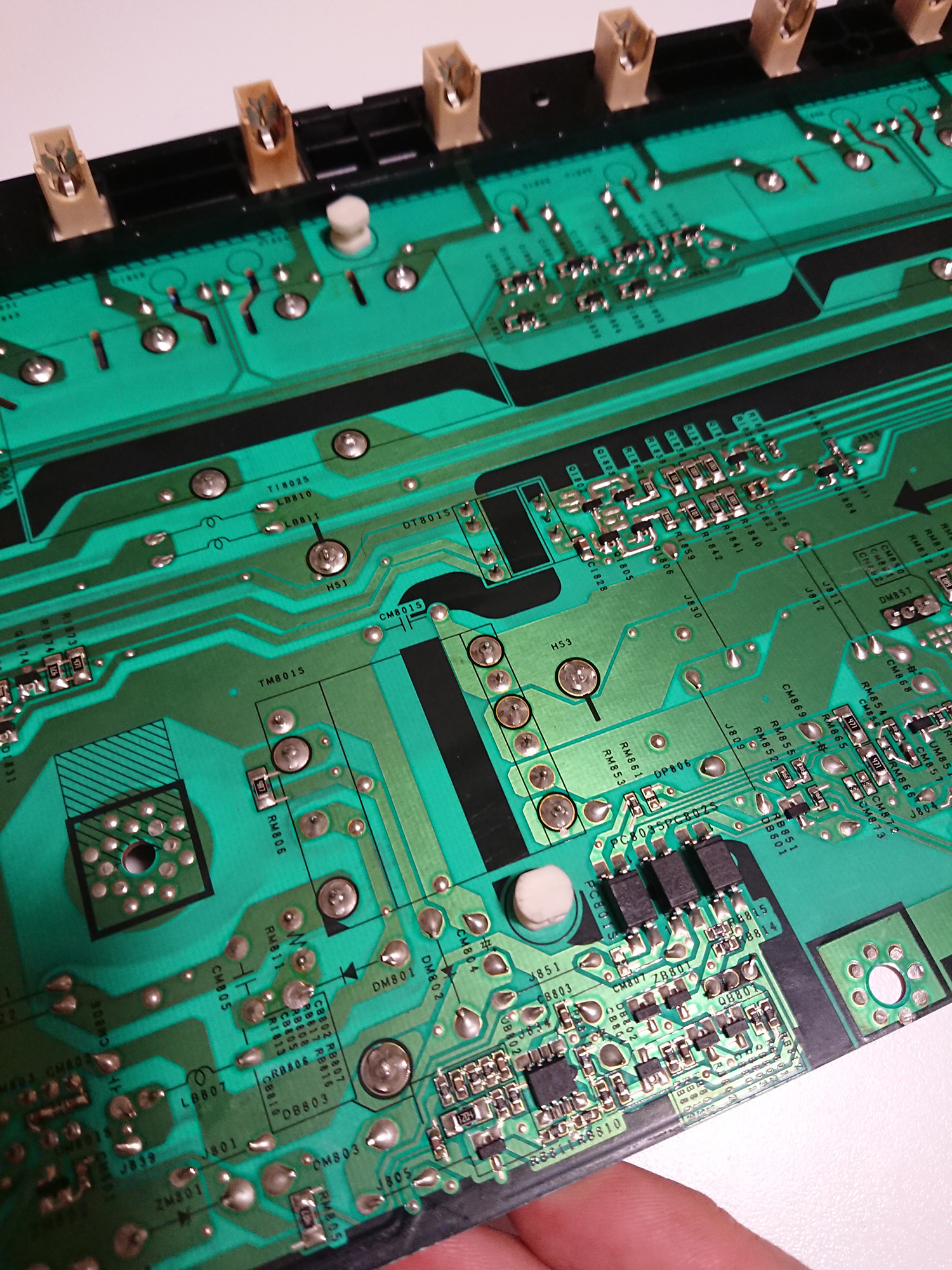

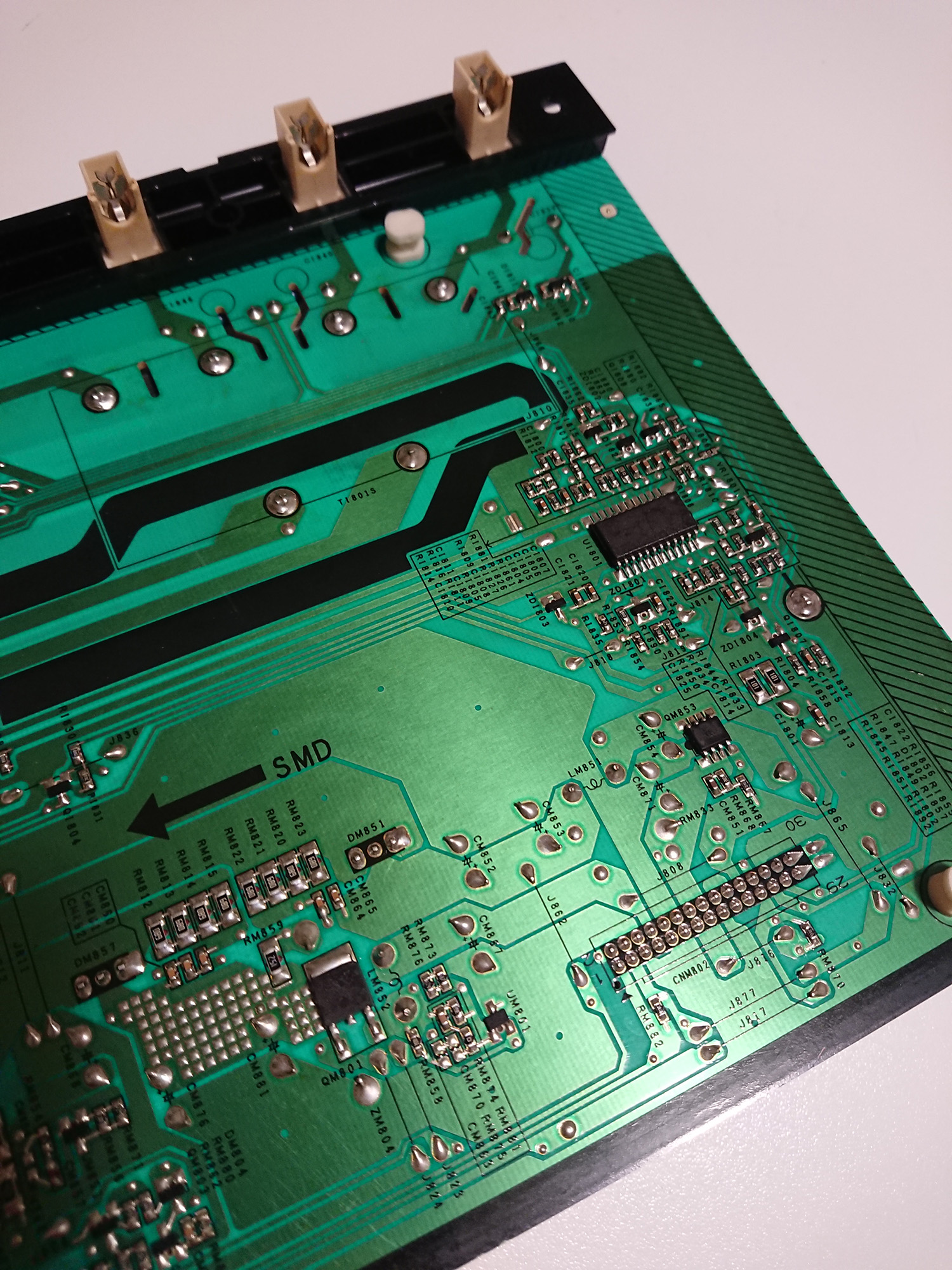

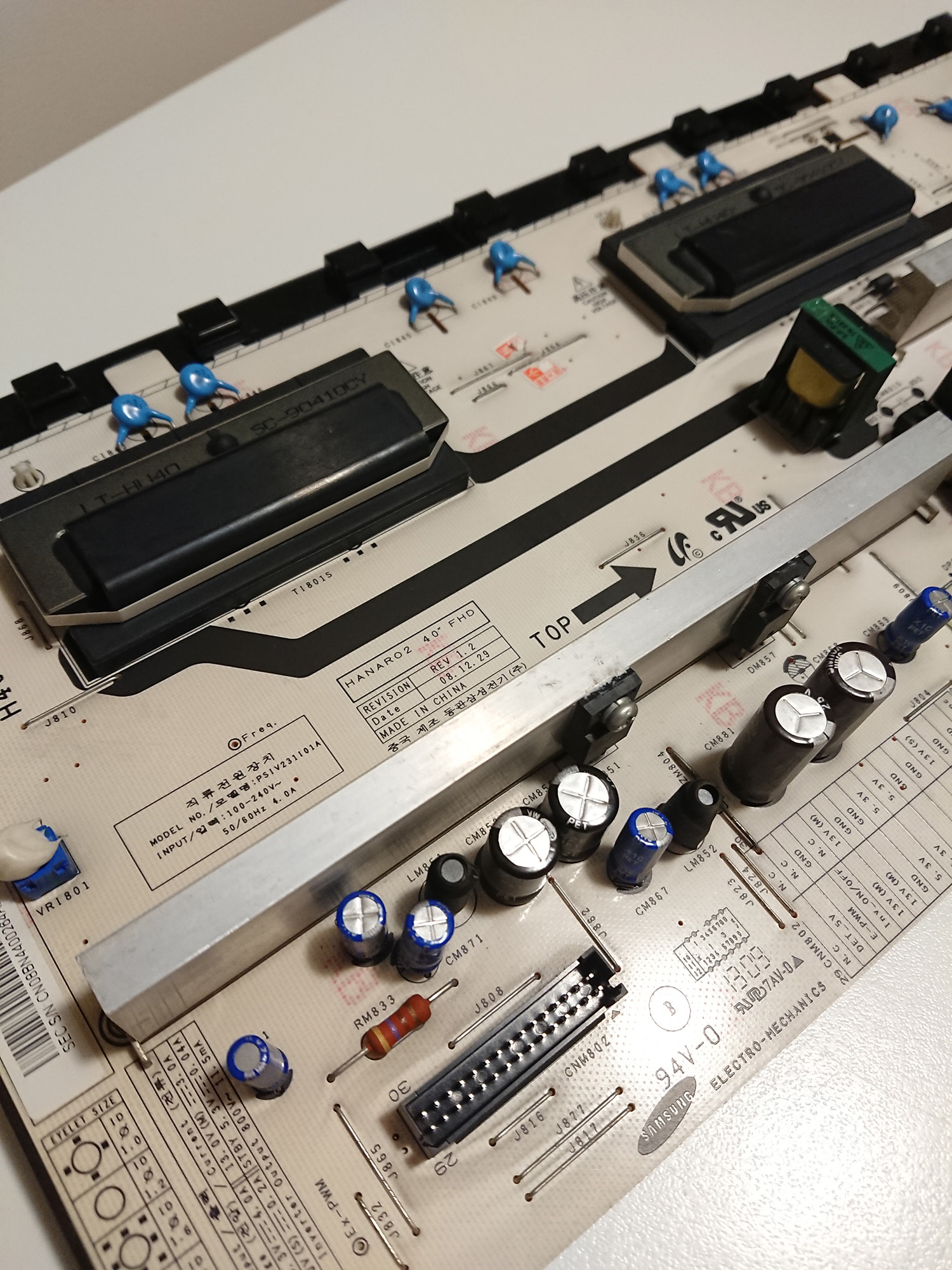

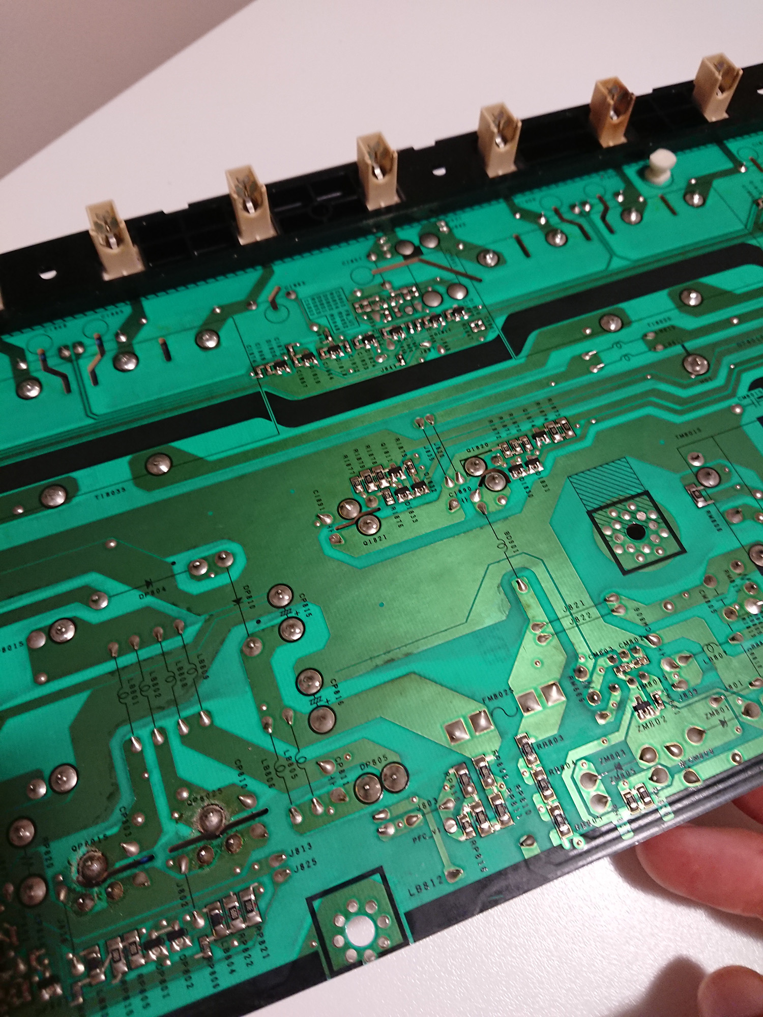

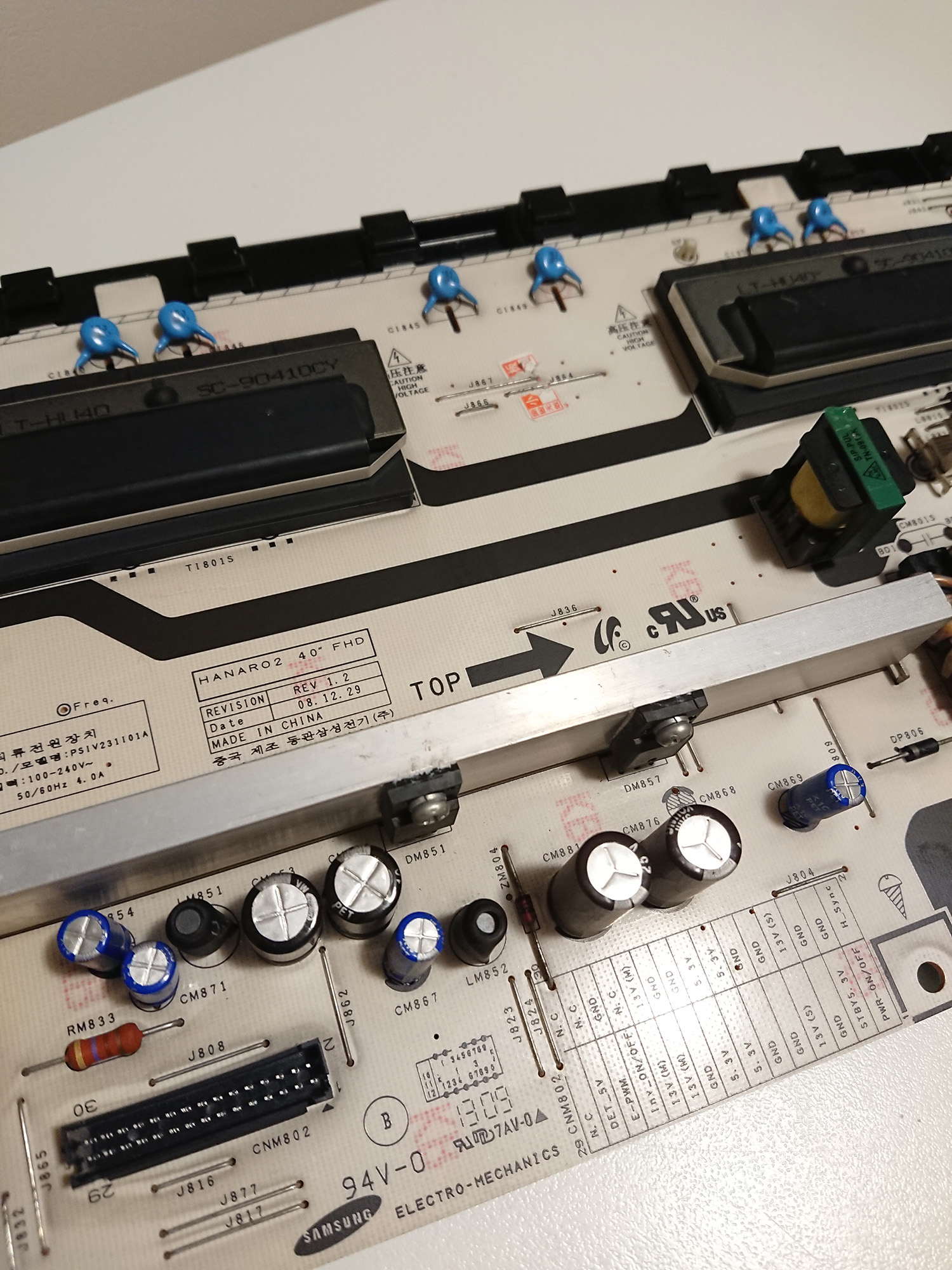

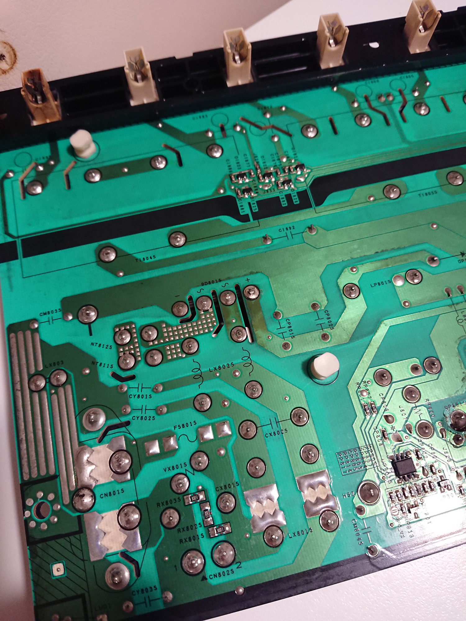

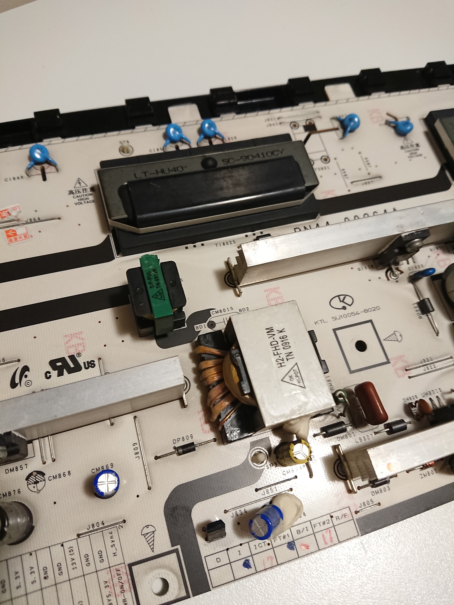

    Hello guys, I really appreciate your efforts in this community, as I often read the discussion and find good solutions here. It is my turn this time, so a question for you on this very common BN44-00264A power board by Samsung.
    My TV LE40B650 is not working anymore, no backlight and no standby led are present. I started to check some components, also reading past discussions about this board.
    - fuses are ok
    - CNM802 readings all 0 volts
    - no backlight appears when disconnecting logic and power board
    - QI820/21 not shorted, pretty high resistance on pins 1-2-3
    - capacitors not swallen, at least inspecting them while onboard
    - no burning signs but some rust on QP801S and 802S solder joints, I think they still make contact, maybe I can test them if you tell me what to measure (see the image).
    Any additional tests that I can do to solve my issue? Thank you!

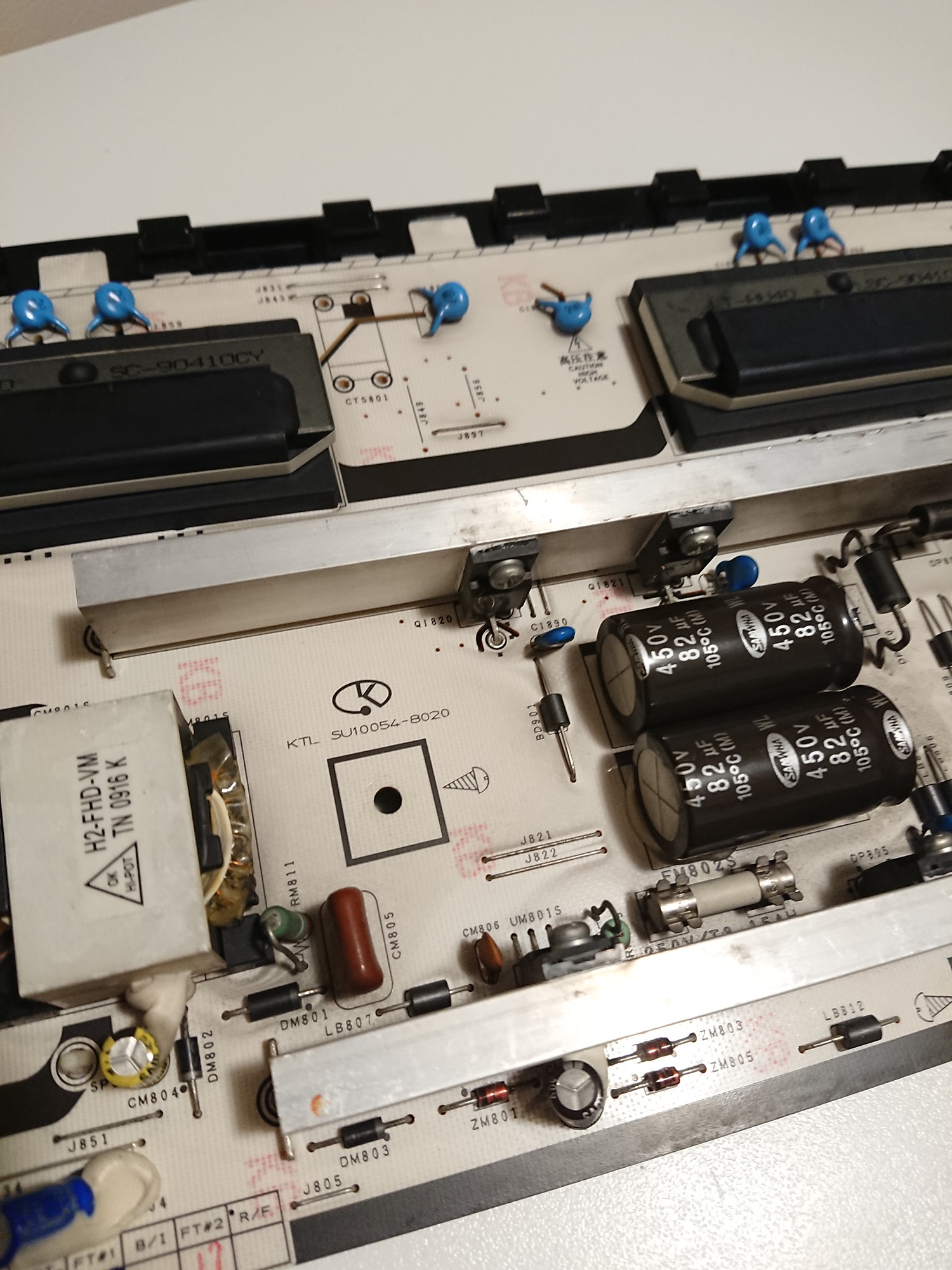

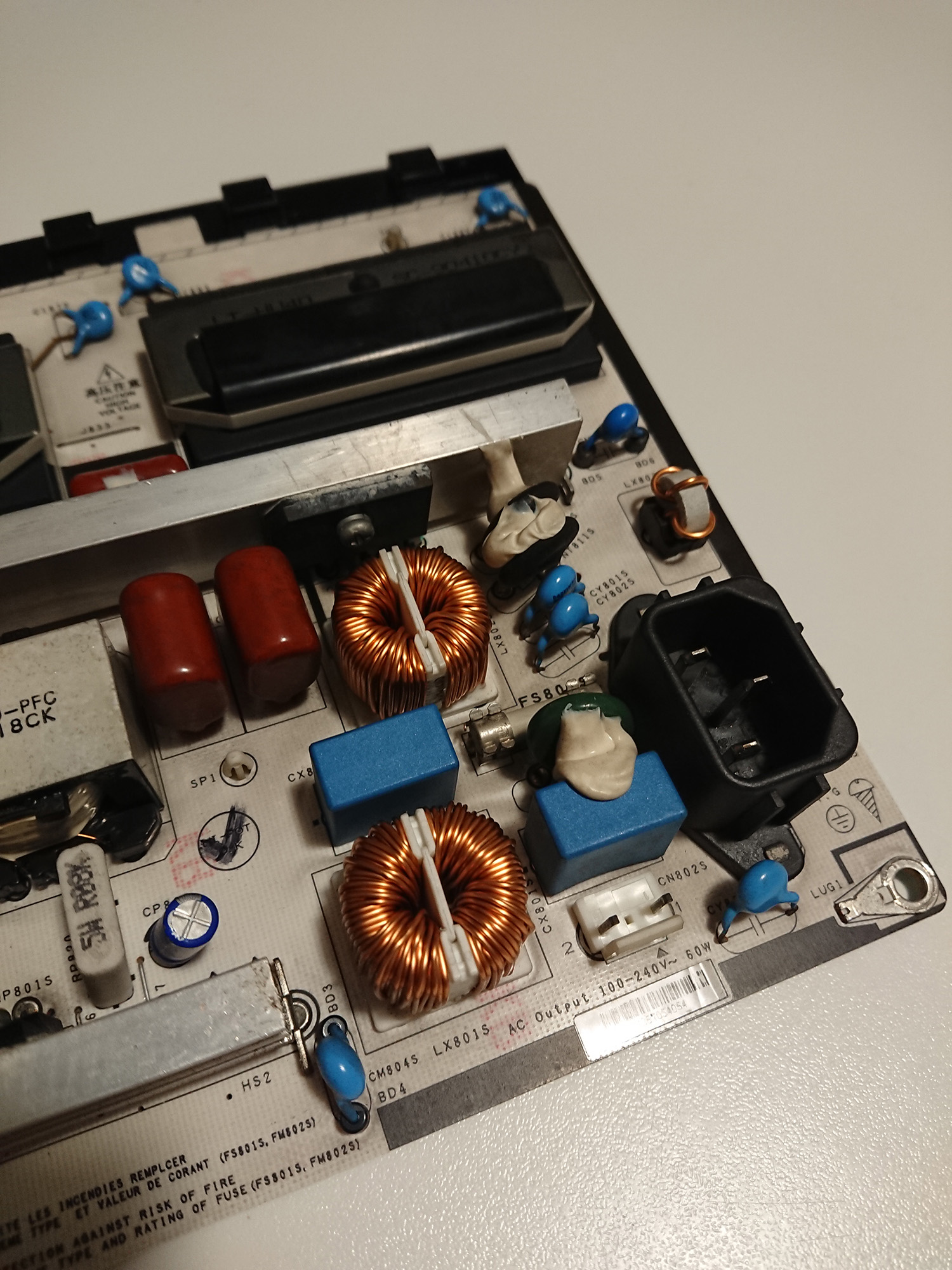

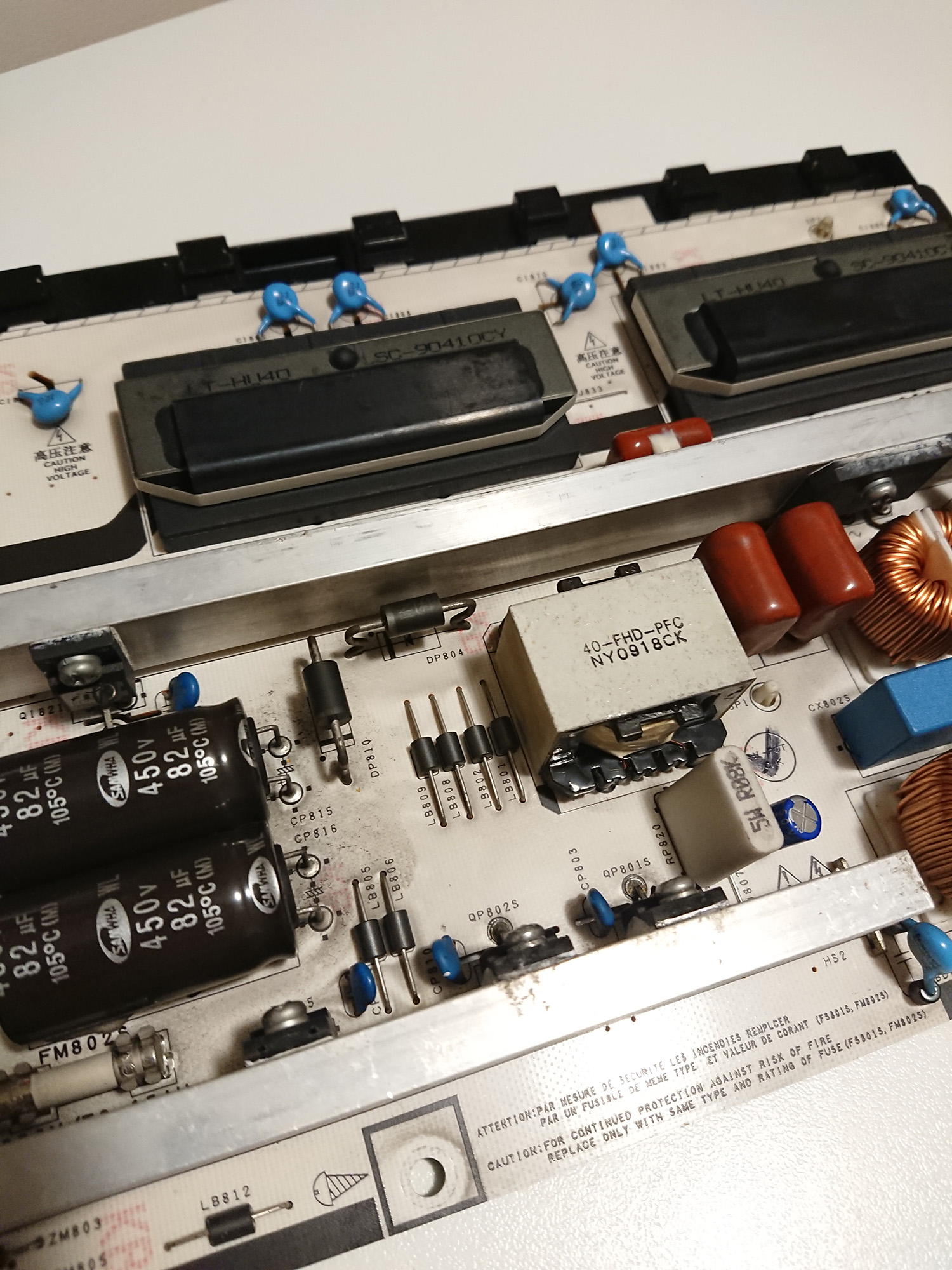

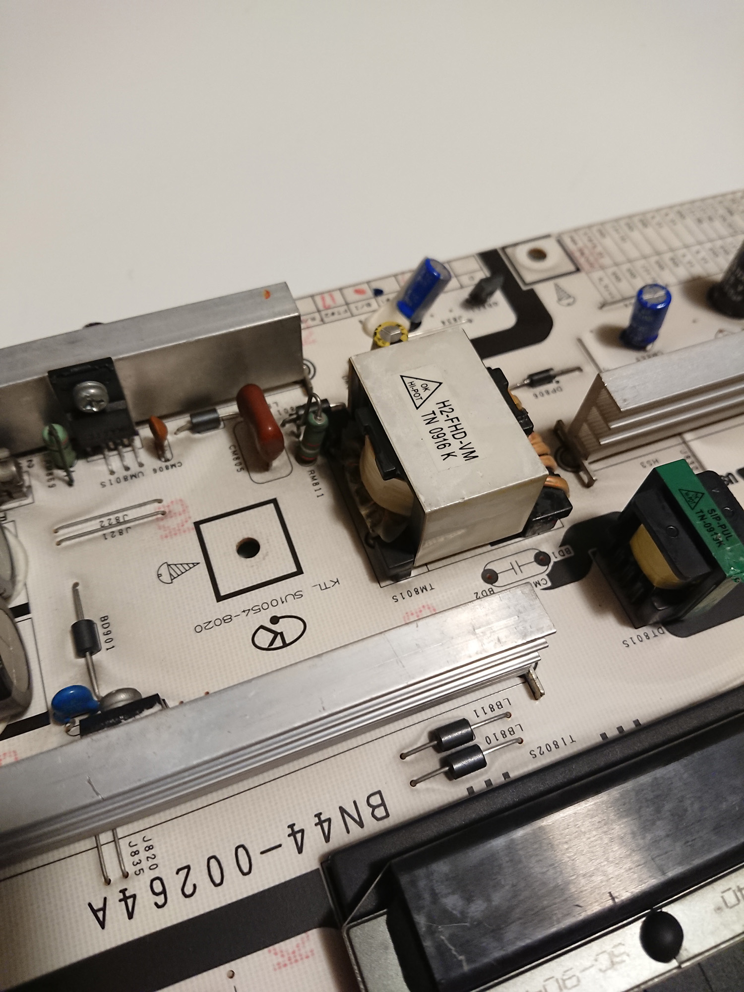

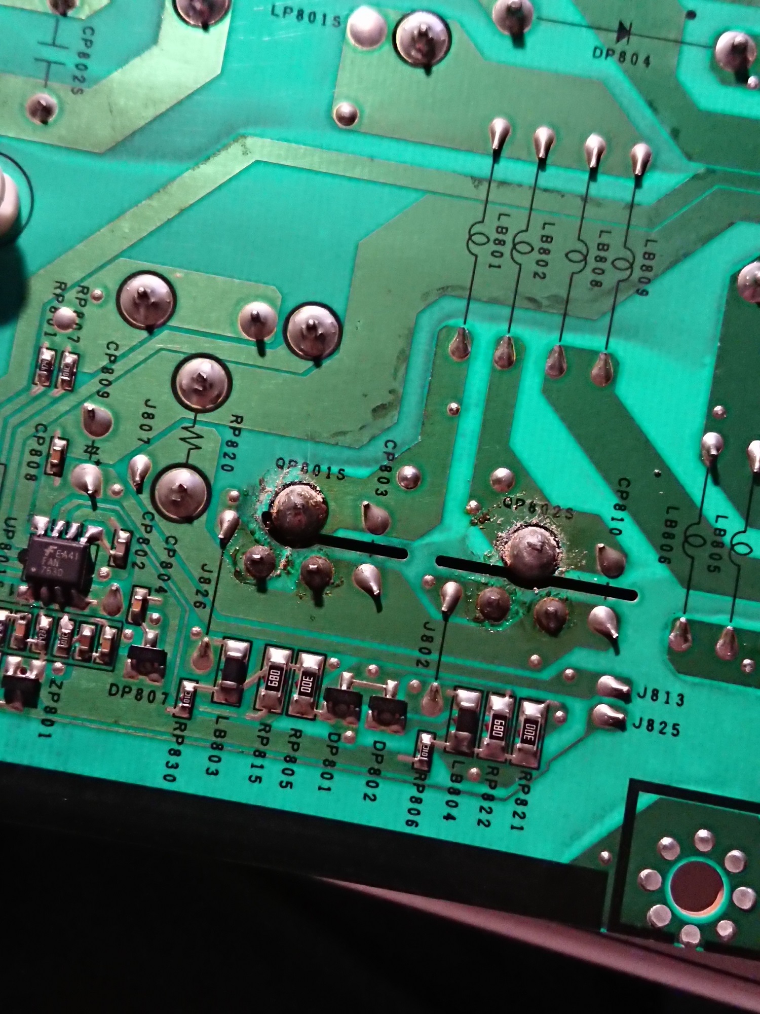

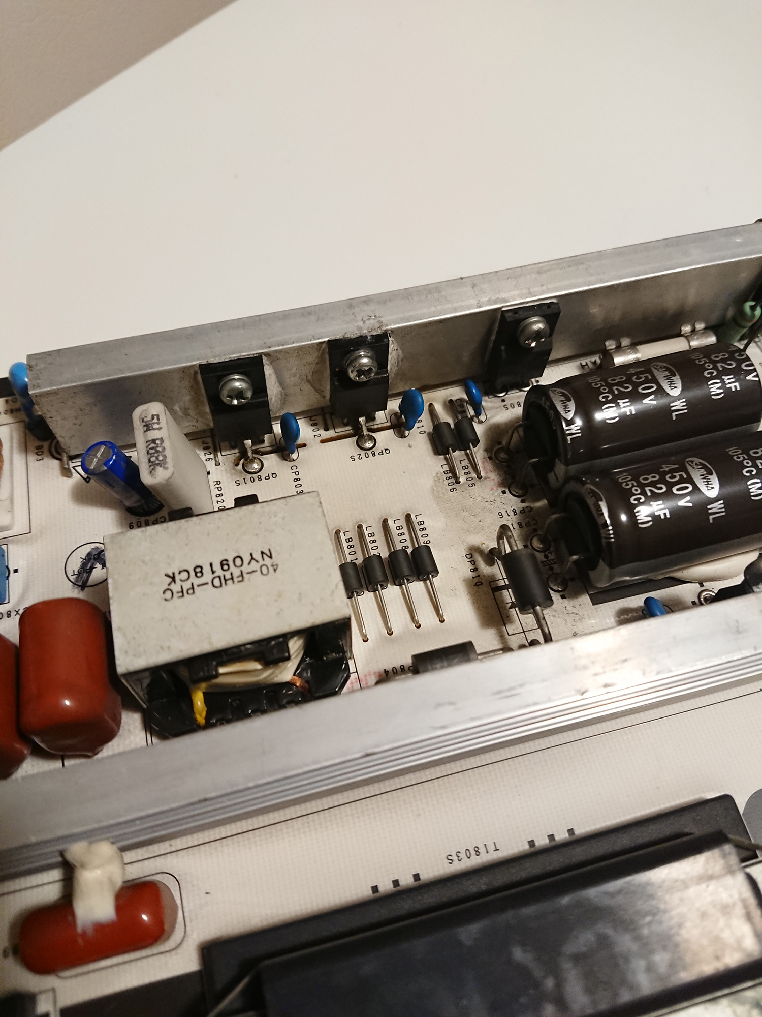

    Re: Samsung BN44-00264A Power Board
    Please attache good clear straight shots pictures of the whole top and bottom side of this power supply board.
    Also the pictures of the whole backside of the TV showing all the boards.
      Power board (front)
        Power board (back)
          I need straight shots of the WHOLE board.
              You should use attachment function to attach the picture, it takes a long time to see in-line pictures.
