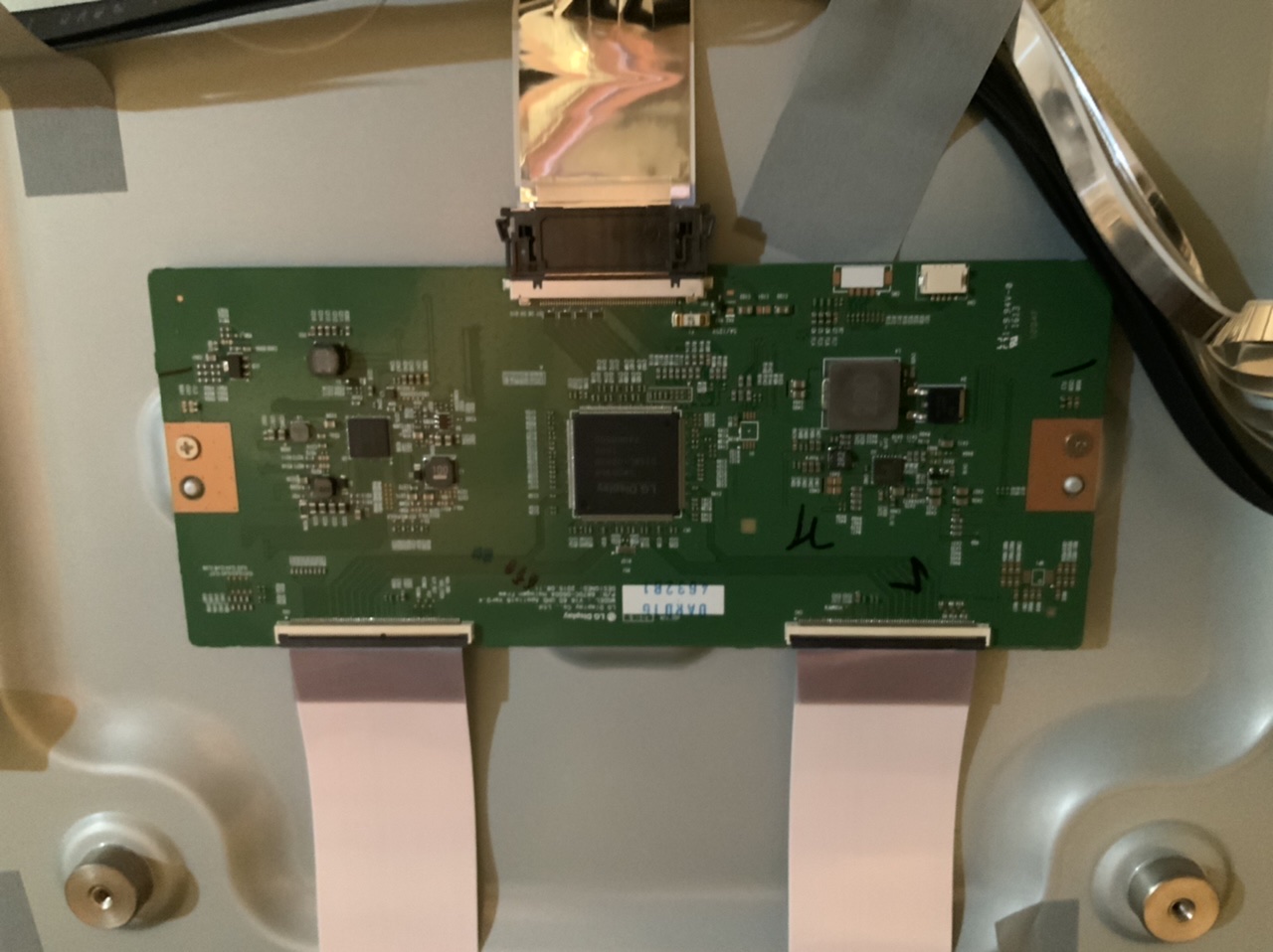

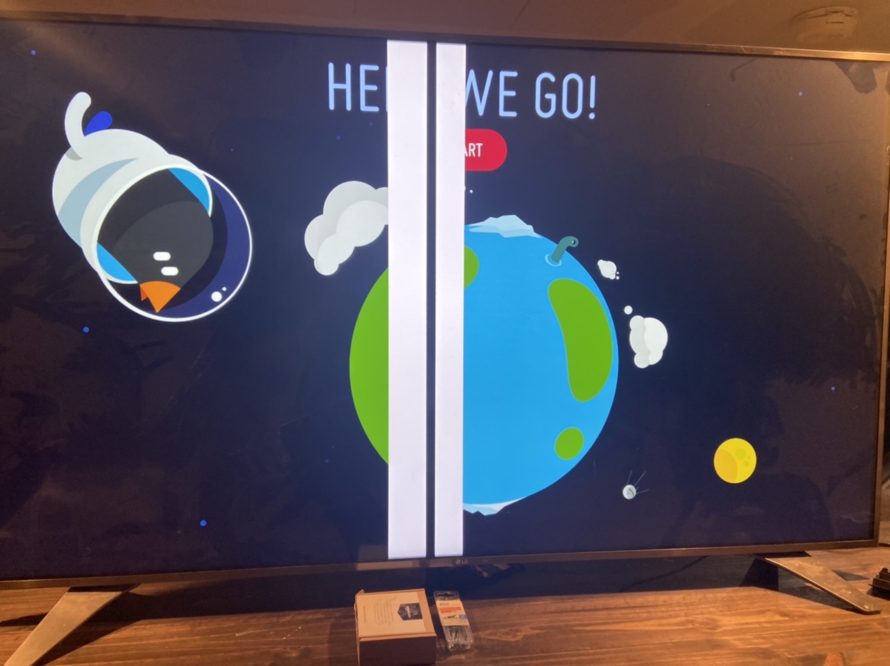

    Any help would be appreciated. I'm not sure if i have t-con, main board, or panel issue?
    Re: Lg 65UH655O BARS ON THE SCREEN
    More likely to be panel.
    You need to open up the back and see if the T-CON, tab bonding boards are on the bottom edge of the LCD panel or not.
    Did anyone spray the screen with cleaner to clean the screen?

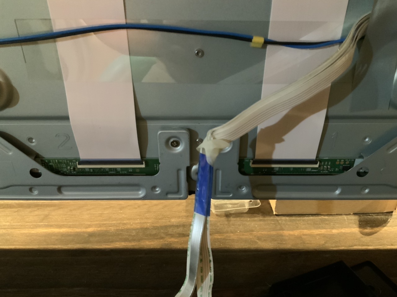

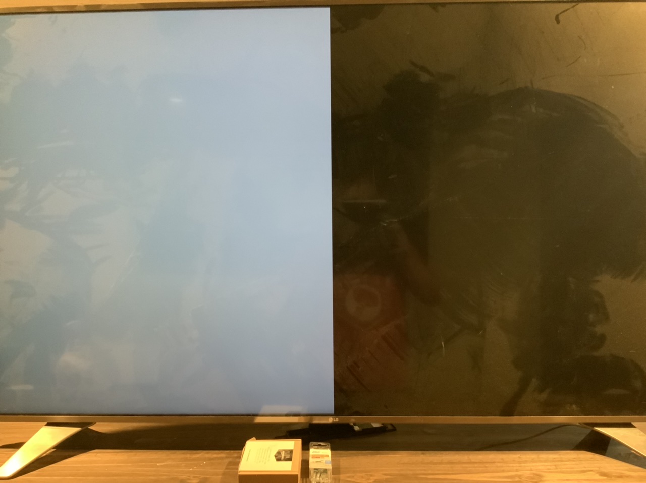

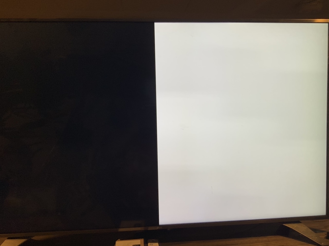

      1st pic is with cable 1 left side unplugged from t-con, and pic 2 is right side

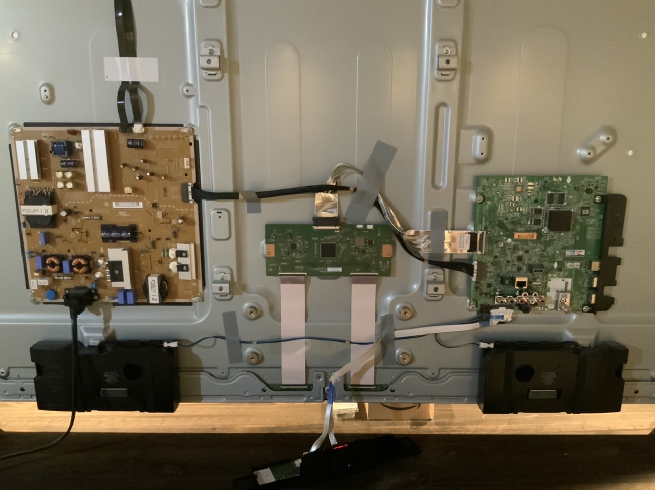

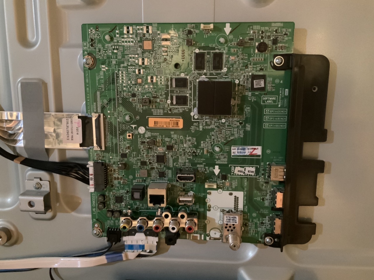

        So can we see the backside of the TV?
        • gabe1022
          • Nov 2016
          • 12
          • united states
          Here ya go
            were you inputting a signal during those tests.... the other side should have shown a picture.
              Just the home screen that was shown in the original picture. That is kinda what lead me to believe it wasn't a panel issue. Thoughts?
                So do you get picture just like in post #1 when both cables are back in place?
                  Yes
                    I had the same exact defect on a little older LG, it's a common issue on LG panels, the problem is on the source driver cof that began to slightly desolder, i have fixed it for some minutes but i had too much hurry to remount the bezel, the story is long, i ended cracking the cof due to shim mal positioned, its not easy when there is not a confortable plane of work. I think a better technique than mine can be used to fix it much faster and better with the use of a simple soldering iron stylus.
                    not on the LG..
                    NOTE: A COF is a chip! not the band that holds it.
                      Just the home screen that was shown in the original picture. That is kinda what lead me to believe it wasn’t a panel issue. Thoughts?
                      download the zip from this post and extract the test photos on USB formatted FAT32, then play them on yours TV show us the result..as:
                      !- BOTH ribbon connected
                      2- both side with one ribbon in place
