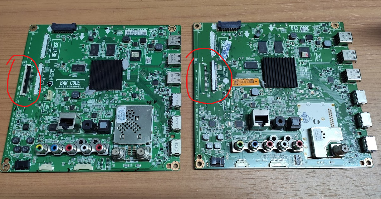

        Hello, I got the new board, but the connection is different, can I desolder the connection from the old board into the new board? Or will that not work?
          Re: LG 32LF585B (Flashes two or three times)
          Those two PCB assemblies are not the same.
          The same blank PCB can be stuffed to make many difference PCB assemblies for the needed TV models.
          As you can see, the LVDS connectors is not at the same, tuner assembly are not the same so each board is made to match with the LCD panel and for what ever model of the TV is made for.
          Do not try this new board with your TV since we do not know the pinouts of the LVDS connector, you can damage the main board or the T-CON.
          You need to match the PCB assembly as printed on the barcdoe stickers. when you try to buy the new PCB assembly.
          FW of the two boards also may bot be the same.
            Sending back the board is not an option now, tuner is not needed, do FW's have to match to work if LVDS pinouts match?
            If not, my last option is to do a comparison diagnostics to find out what's wrong with bad board, diode reading would be the way to go?
              1) What you can try at this point is to put the board in but do not connect the LVDS cable,
              then see if you will get the PWR_ON and DRV_ON all not.
              2) You will have to figure out of you have to move or install some parts fro the switched 12V feeding the LVDS connector power pin.
              3) I have no idea how you can verify the FW version of the old and the new board.
              4) When you force on the PWR_ON and DRV_ON with the old board in place. Were you able to see the image on the screen, get sounds, and all other functions?
              5) What are P/N as printed on the barcode stickers of both boards?
                1) Without LVDS connected, backlight and speakers are on as soon I plug cord.
                4) When I fed those pins I'm 70% sure there was no image (checked with flashlight) nor sound.
                5) They are both EAX65610206 (1.0) in PCB, however in stickers they are: EBL61400103 (old) and EBL61380101 (replacement)
                  I do not know what you can do to make this board to function the same as the original board.
