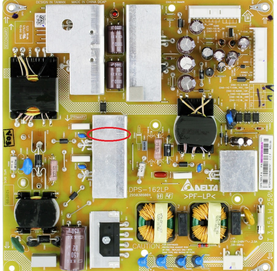

    Not able to power on, 6 blinks.
    Tested the backlight OK with backlight tester. The problem is the 4 series resistors R602A-D values increased. Looks like everyone is possible to change values.
    I jumped the R602D (it's underneath the heatsink) with a wire (on the other side of the board) fixed the problem.

    Did you check the DCV on the main filter cap 82uF 450VDC after bypassing the resistor?
    Delta DPS-162LP.

      Why not replace the 4 resistors if that was the problem?
