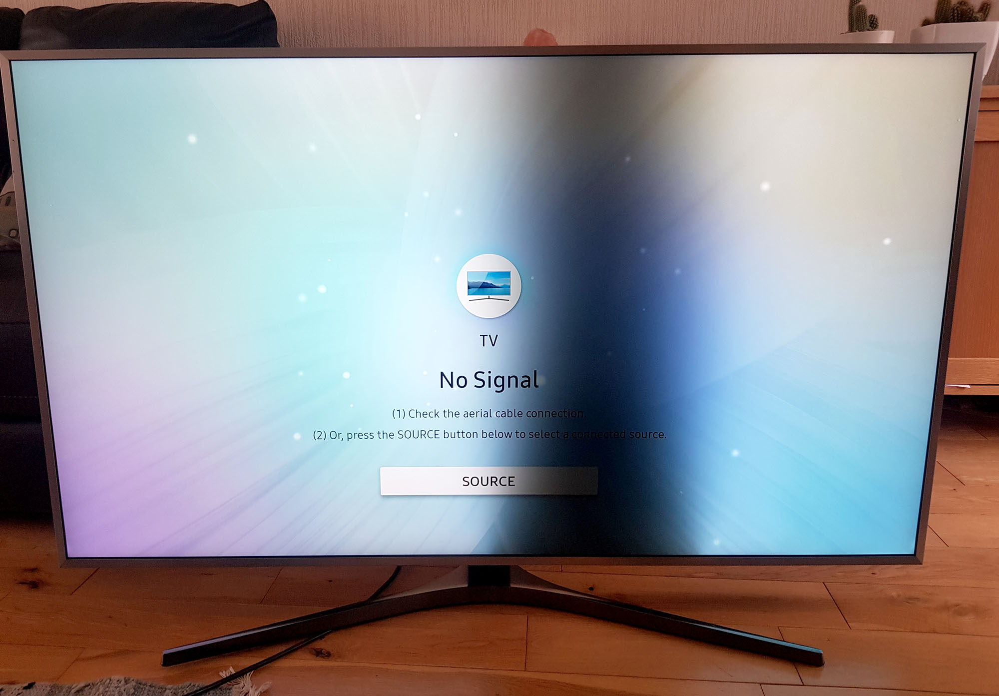

    Hi
    Got a Samsung UE55MU6400U TV here with a dark vertical strip. I'm thinking its one of LED strips. Does it look like a LED strip fault and is it a tricky job ? I'm familiar with TV's but never disassembled a screen. See attached.
    Cheers
    M

    Re: Samsung UE55MU6400U Dark Vertical Strip
    Strange that its from top to bottom
    Seems as though the set has 2 strips possible fitted top and bottom.
    Perhaps the led driver is faulty.
      Samsung UE55MU6400U had edge led backlight where mounted at the bottom of the set.. its look one group at the edge don't work
        Yes, same as Diah.. probably led gone short c., my brother has 49" version, after 1&1/2 year leds are not uniforms, so poor technology.. better to save money for local dimming sets.. they can't fail i think..
          Lots of edge lit backlight failures on NU and I guess MU series now. Strips are on the bottom in left and right banks. Screwless back cover as well.
