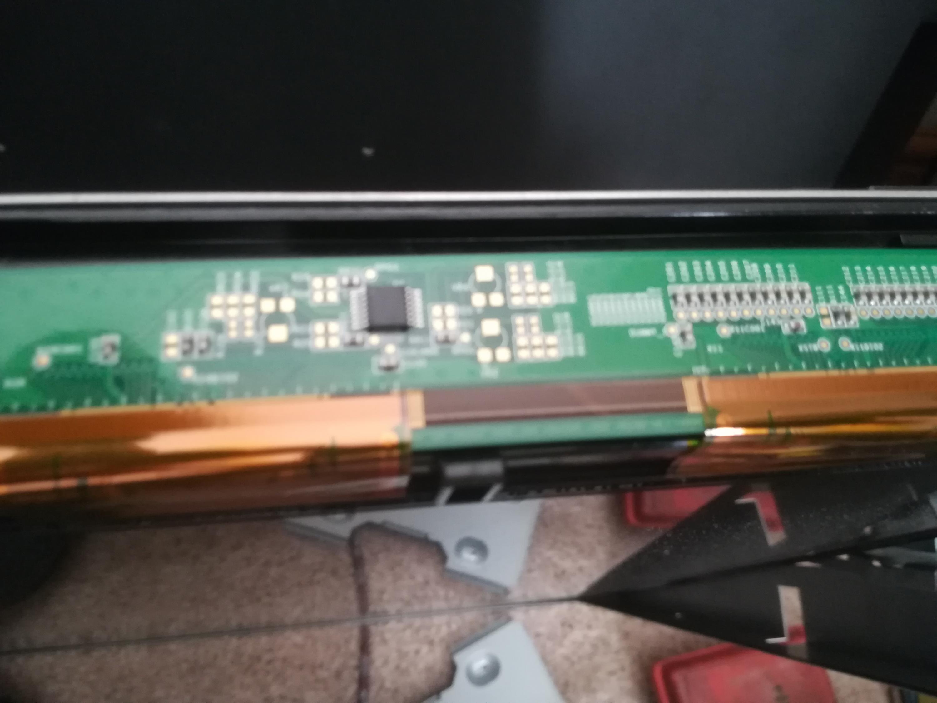

Samsung LE40A558P3FXXU Colored lines

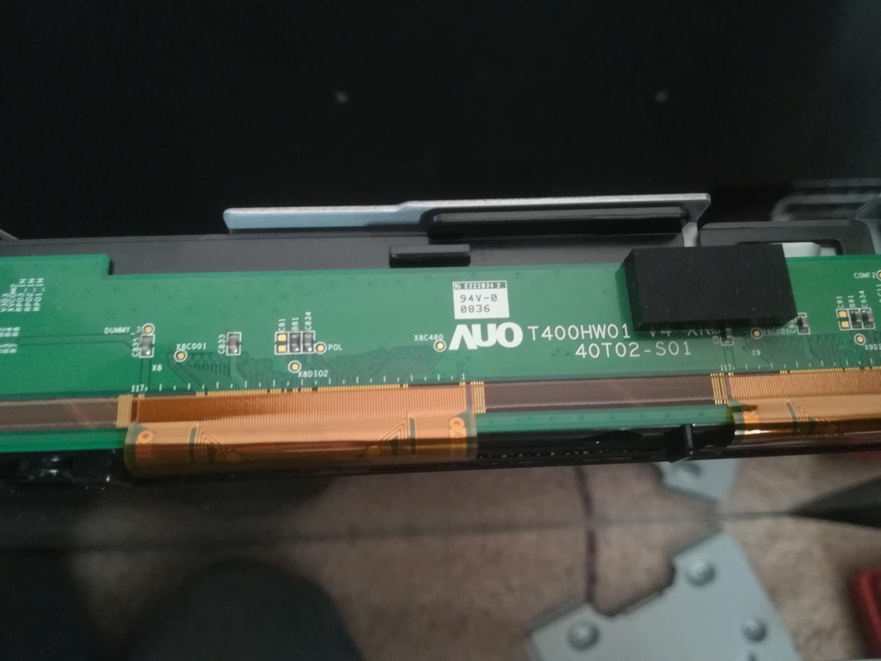

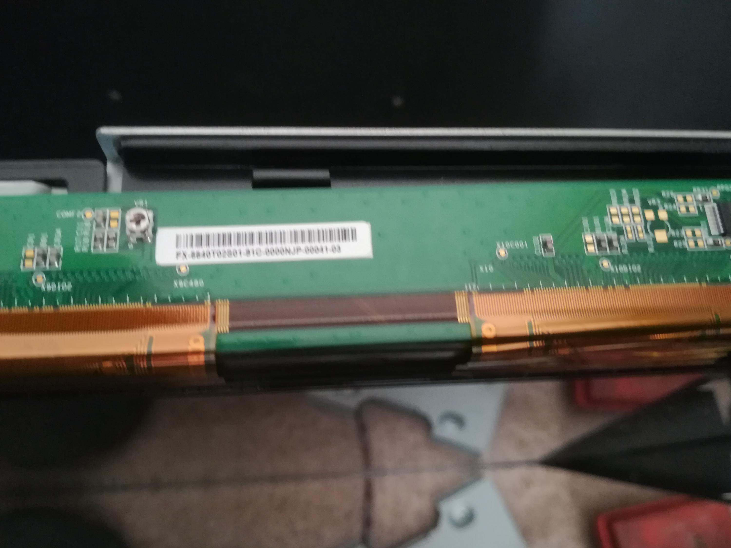

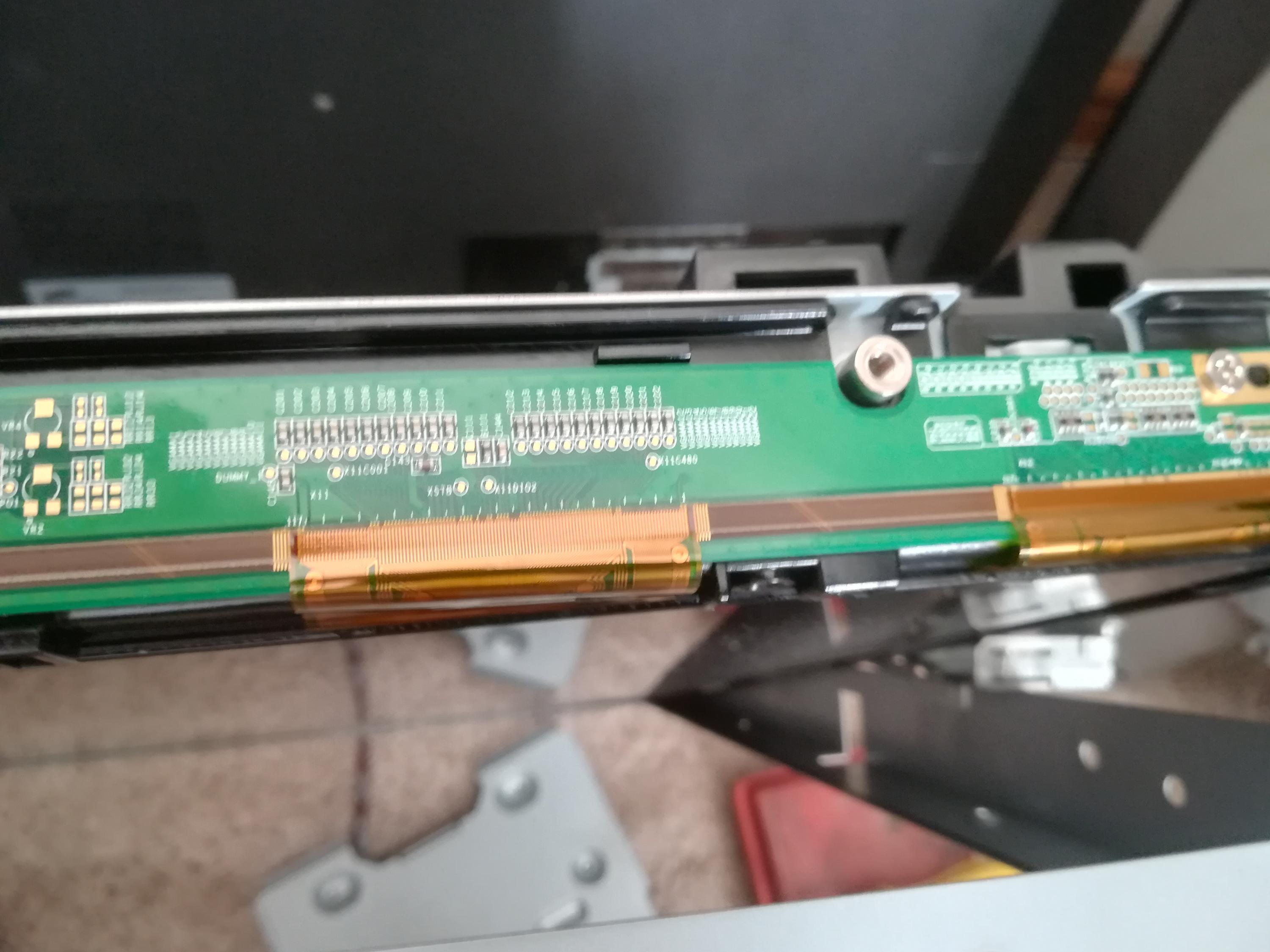

    Re: Samsung LE40A558P3FXXU Colored lines
    Originally posted by budm
    Pictures are too low res for me to zoom in to see anything in details.
    I have uploaded the unedited versions of the pictures are these any better or do I need to take more?
    • 24mech
      Badcaps Baby
      • Feb 2014
      • 103
      • United Kingdom
      I have checked the 12VIN on the T-Con and am getting 12.4v is there any other voltage checks I need to carry out? does this mean the problem is forward of the T-con? thanks
      • 24mech
        Badcaps Baby
        • Feb 2014
        • 103
        • United Kingdom
        anybody know what I should be looking at next? thanks

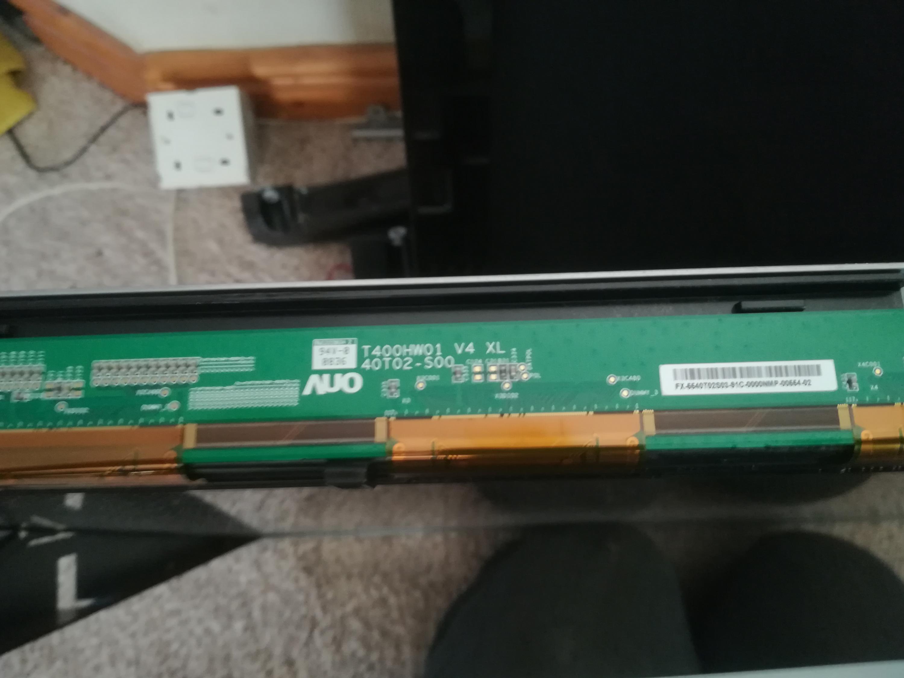

                • 21586
                In your first picture at post #20 it looks like there`s some sort of liquid residue,it could be flux, and i see a resistor thats not straight.Have you owned the TV from new or is it used/refurbished,have you had any previous repairs done to it.
                • 24mech
                  Badcaps Baby
                  • Feb 2014
                  • 103
                  • United Kingdom
                  Thanks for your response SMDFlea it's a used unit I got for my daughter a while ago that only recently started showing this issue no one has looked at it before me that I'm aware of which component are you referring to please?
                  I see it now R867, looking at the board several of these resistors are not straight R867,R850,R851,R278 there's quite a number of them so I've checked the 12VIN and got 12.4V does that mean the issue lies T-con forward then? component F1 is that going to be a fuse?
