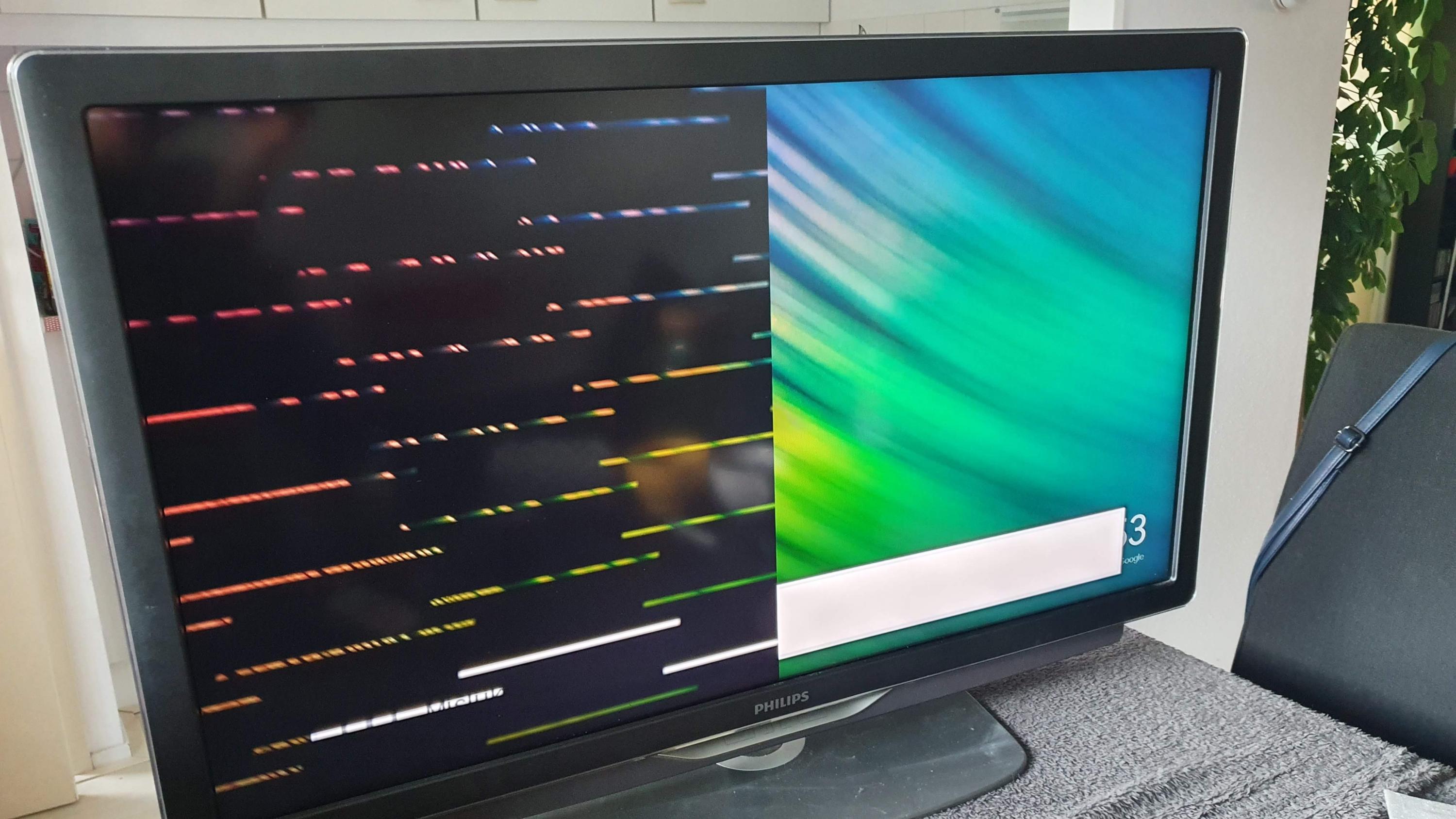

            okay i replaced the fets again by an new set i received today.. and the tv is working for an short moment! in the begining ive got a full screen image and now the image is like this

              it.seems that you have conected bad the output flat cables.. clean them and re insert..

                Re: Philips 40PFL9705 T-con 9 blinks
                Strange thing is when no source is connected ive got good image.
                When i connect mine Chromecast this happens

                  1. Are you repairing the original tcon or the Chinese one?
                  2. Have you ever made an attempt to reflow one of the processors that ThommyX says?

                    The orginal one keeps giving me error 9, allready changed both fets same result.
                    On the chinese one i did an reflow of the bad side
