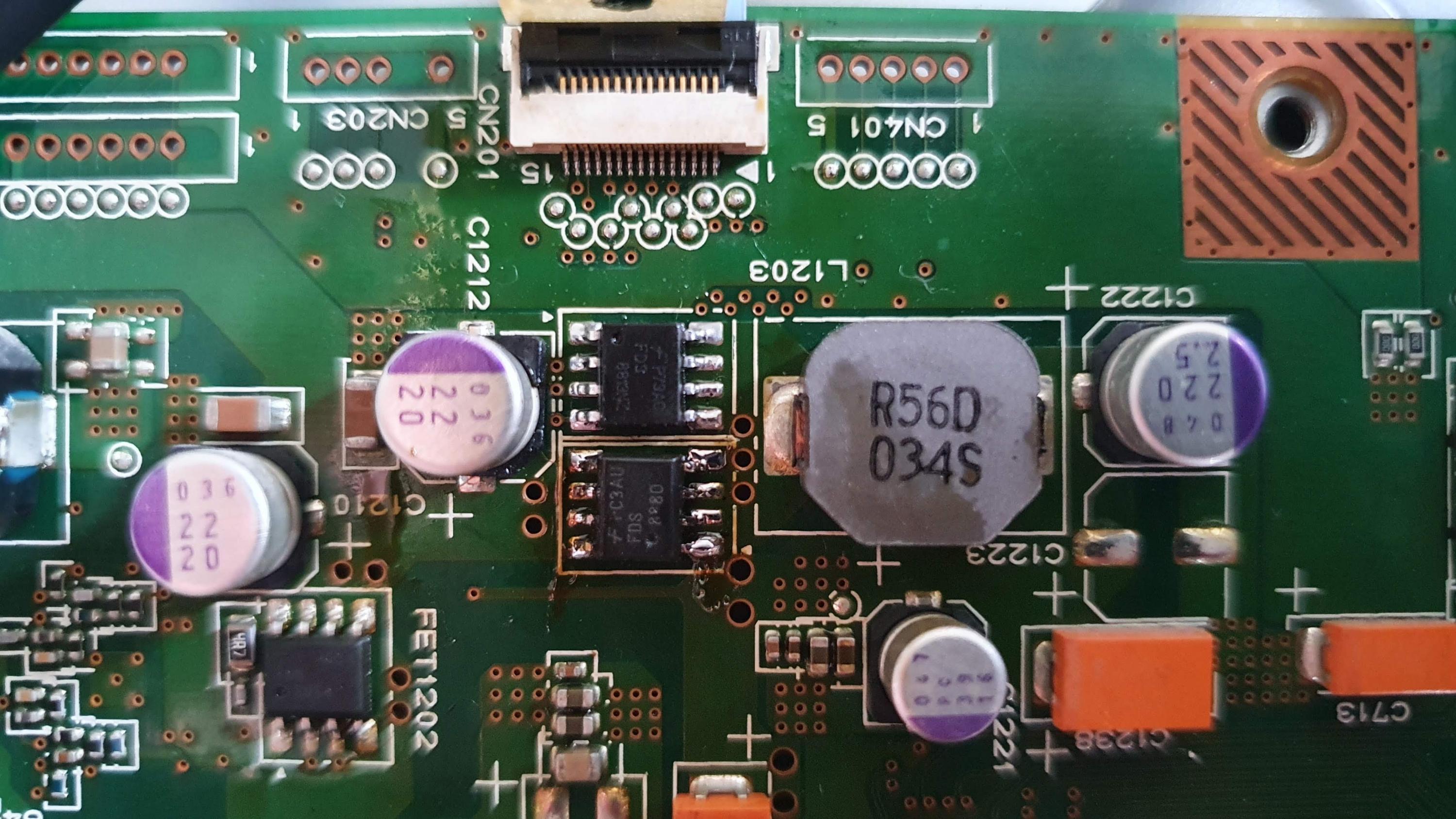

    Hello
    Ive got two screens of 40PFL9705 wit both bad tcons i think.
    I allready replaced Fet FDS8880 and FDS 8813NZ
    And i still getting the nine blinks,
    What could be an option is that both fets are defective again
    But iam out of options

    Re: Philips 40PFL9705 T-con 9 blinks
    do you have a short circuit on C1222?
    Greetings Thomas
      iam getting 35 ohms over that cap
        Replaced that cap but still an short
          Exactly the same problem as me. I am in the link to the German forum. Problem is IC302. The BGA causes this short circuit due to contact errors. Unfortunately I have to wait for my delivery from China before I can continue. BGA must be reballed.
                Why do you changed that 2 mosfets?
                This sounds not to be correct, a missing of a signal can't build an overcurrent, furthermore them are smps converters so them are surely protected against overcurrent. The upper mosfet in the couple of the photo usually fails, i have substituted the FDS8813NZ with IRF8734PBF. Don't get them directly from Chinese market, Chinese people are like the Devil, you probably get fakes, get them from your Country's professional suppliers, and i have also substituted the surroundings electrolytics 1x220u2,5v, 1x22u20v, 1x39u10v, them marked well on my esr meter but i'm unsure of them, probably are the main cause. If it is not so then is a power surge.

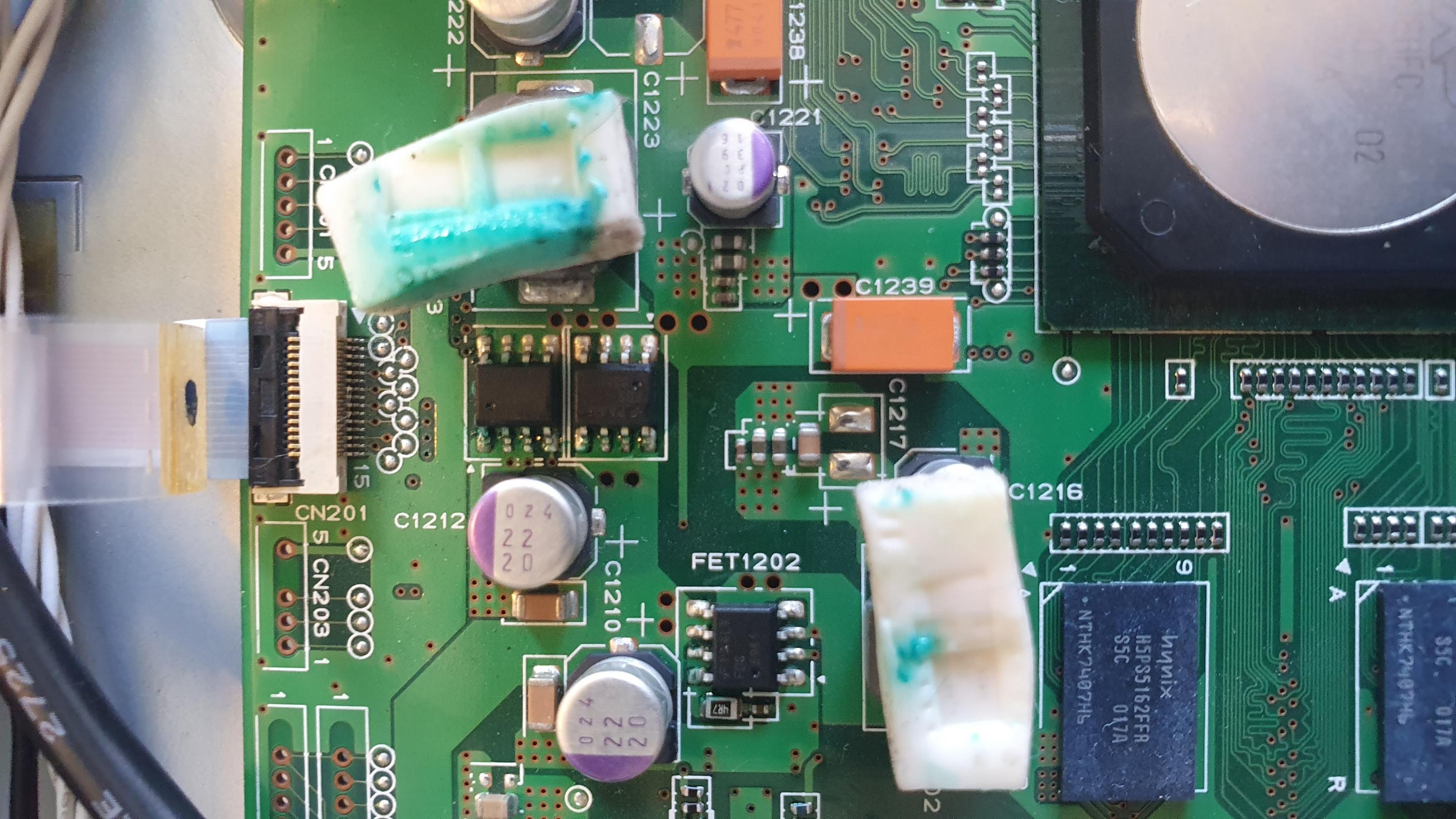

                                Today ive got an used board from aliexpress,
                                First thing i noticed is an green stuff on those mosfets.
                                So cleaned it up and hooked the board in the tv now the tv starts and ambilight goes and sound is there, but still no image only backlight
                                Now the tv gives 3 blinks instead of 9
                                On this board the caps measure 50 ohms
                                  How much $?? I don't know why you are not listening to someone (me) that had repaired 4 of them.. instead thommyx i don't know how many..
                                    FDS8880 needs soldering properly .
                                      Oke going to replace those fets again. They came from ebay so probably its from china.
                                        there's no "Farnell","RS-components","Conrad" etc.. in your country? Get IRF8734PBF instead...
