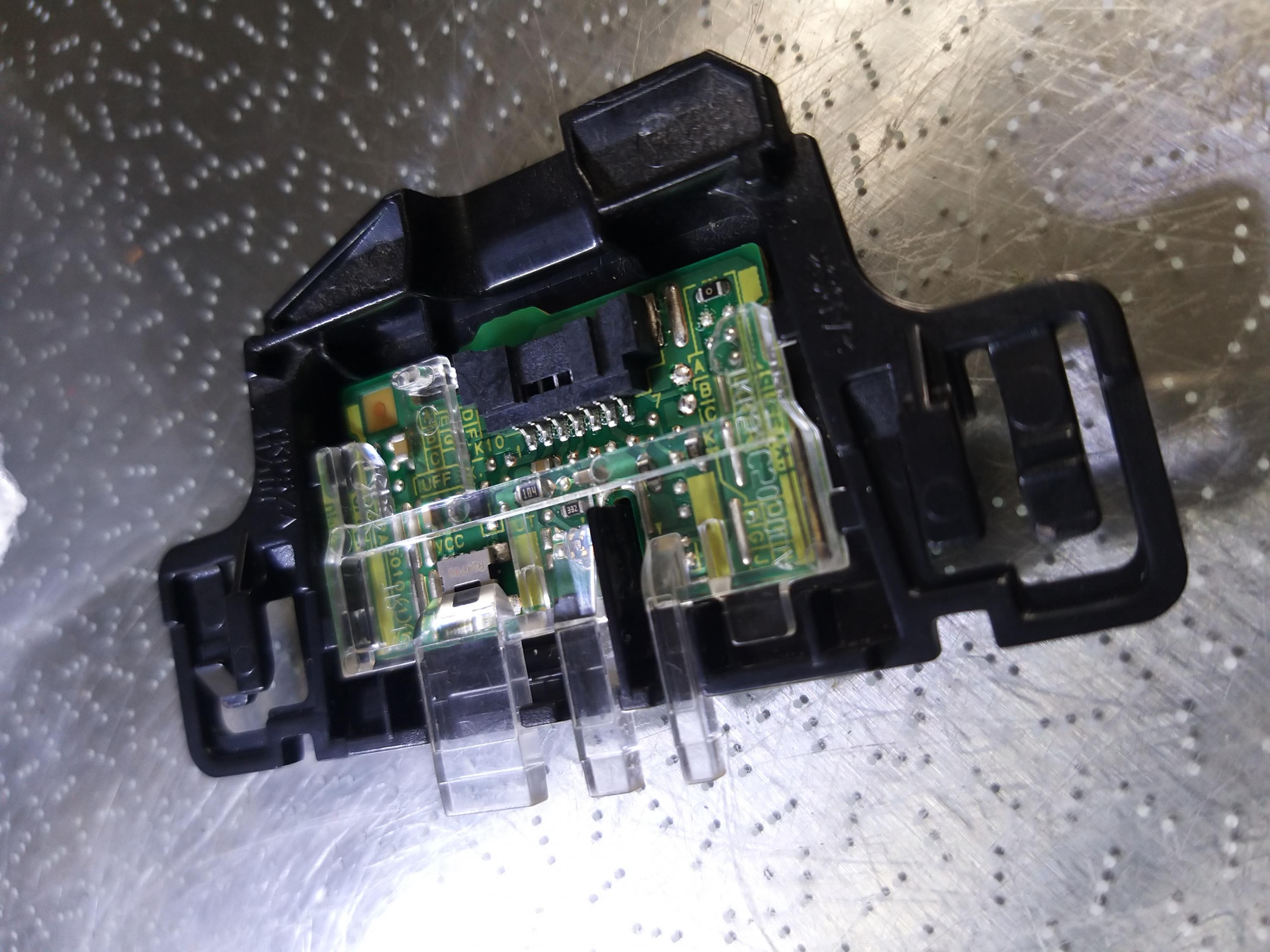

    Hi guys,
    Id like some input on this issue if possible.

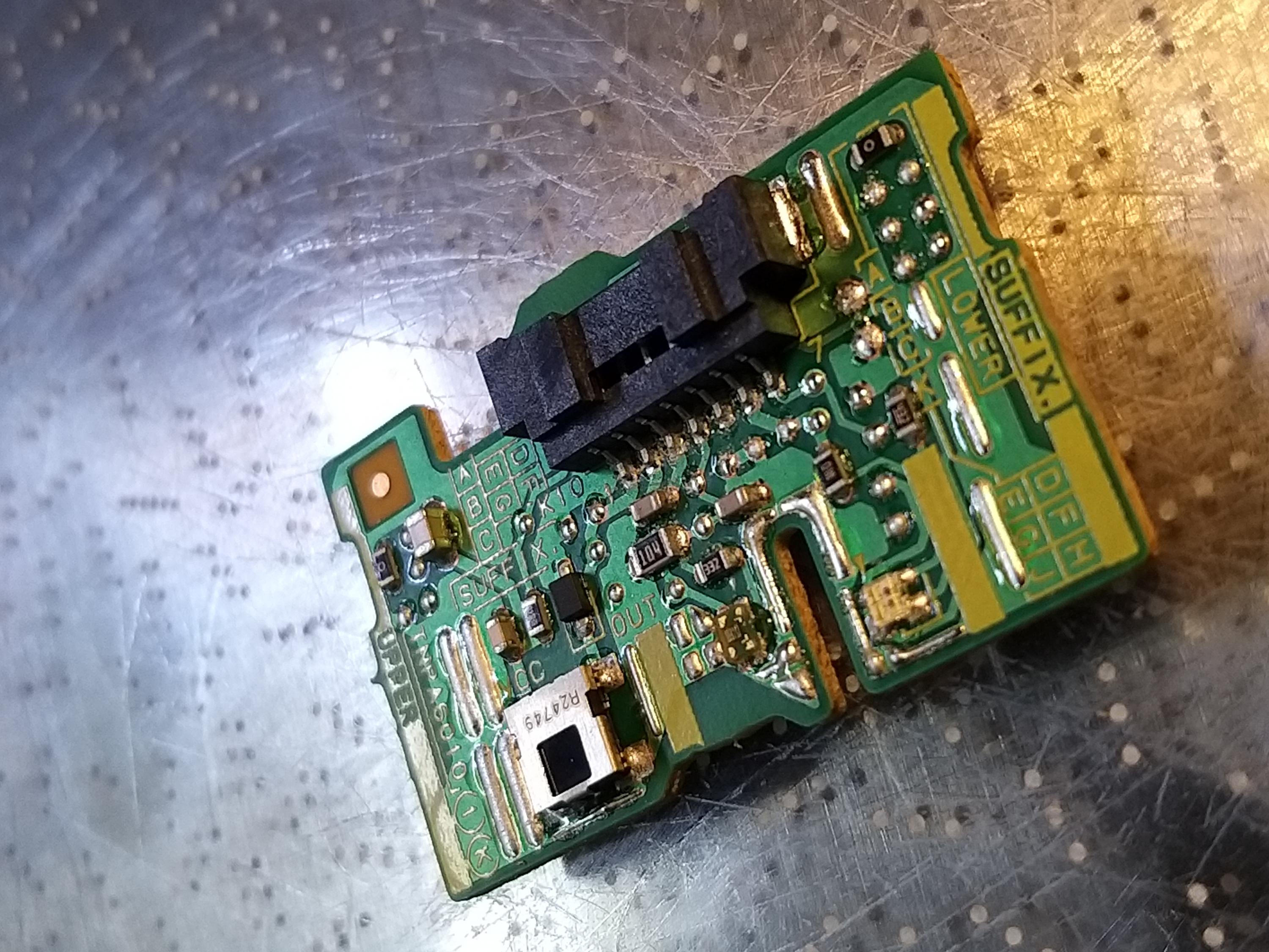

    I picked up this tv with no backlights.
    After the repair of the backlights the remote sensor on the tv doe not seem to accept any commands from the remote.
    This doesnt seem like a common issue.
    I have attached a pic of the remote sensor module.
    Any ideas pls.?

      Re: Panasonic tx47as650b no reaction to remote.
      is the remote itself working ?
            if you see it with a camera its working . does the tv acknowledge you pressing remote ? not sure if it should flash or not though .
            am wondering of you didn't plug the wires in properly or one broke maybe .
              1) So was the remote function work before fixing the backlights issue?
              2) No bent pins and connectors are put back in place properly?
              3) What Voltage testing have you done on the remote receiver board?
              4) Can we see straight shots pictures of both sides the remote receiver board?

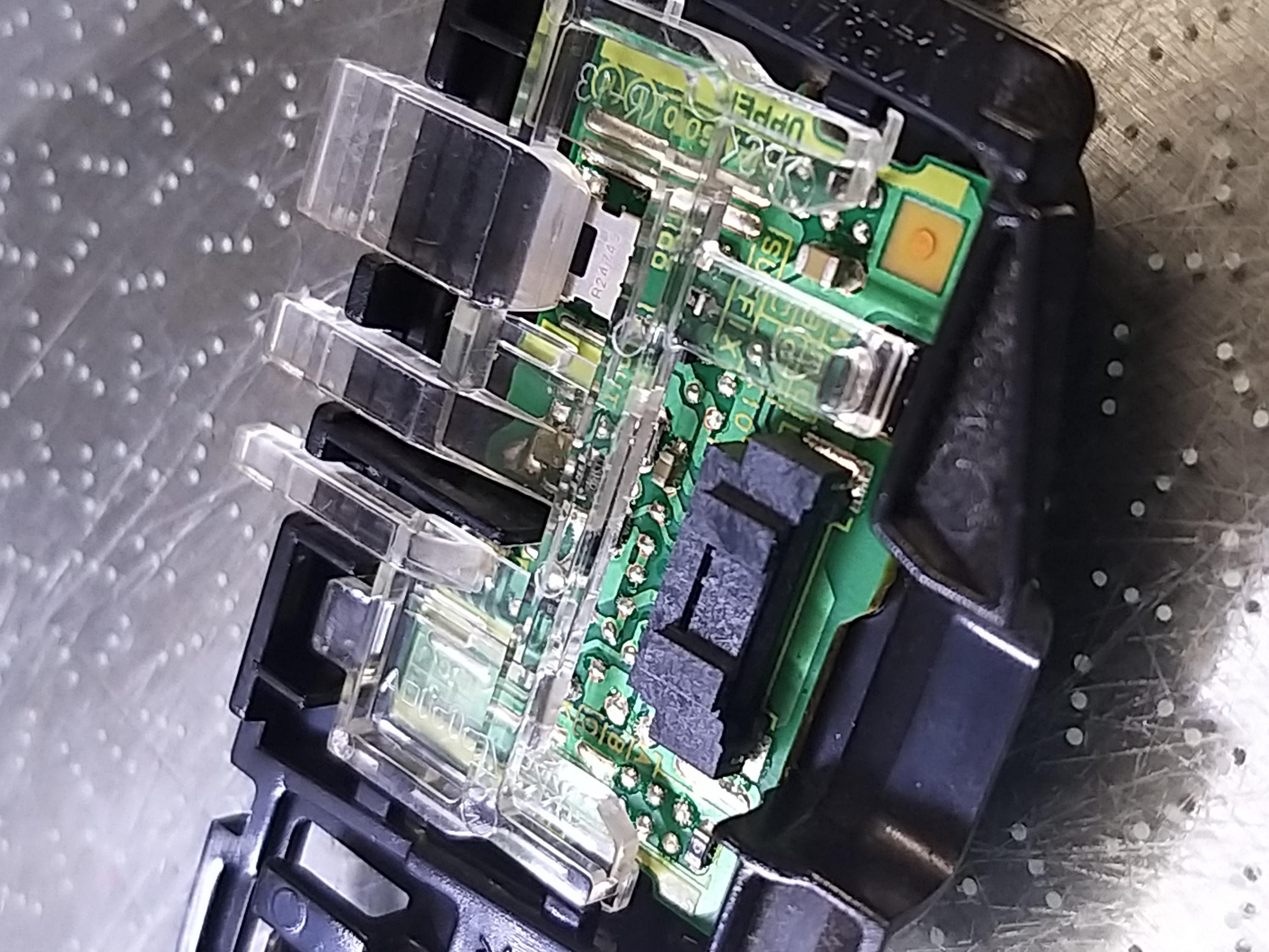

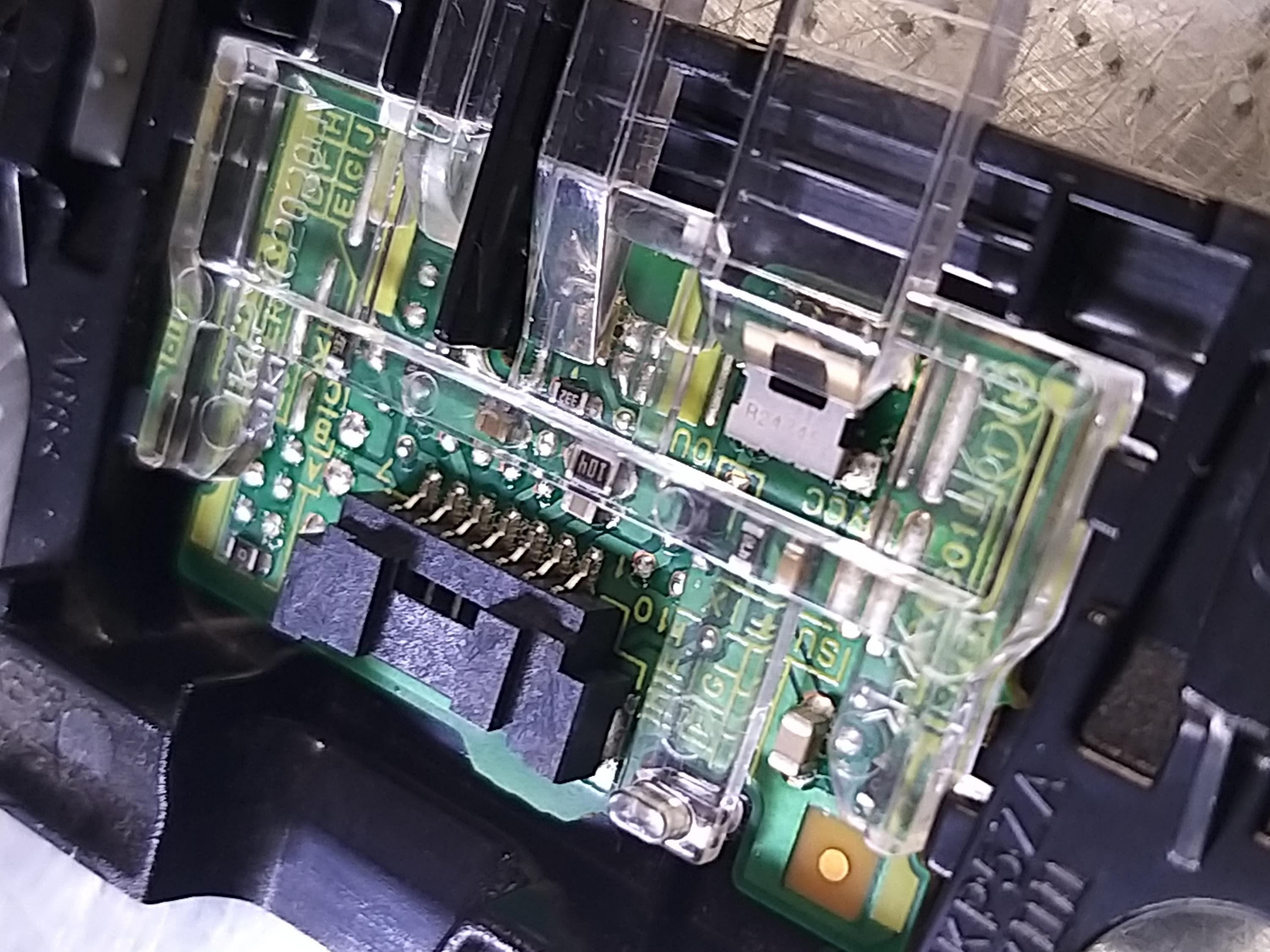

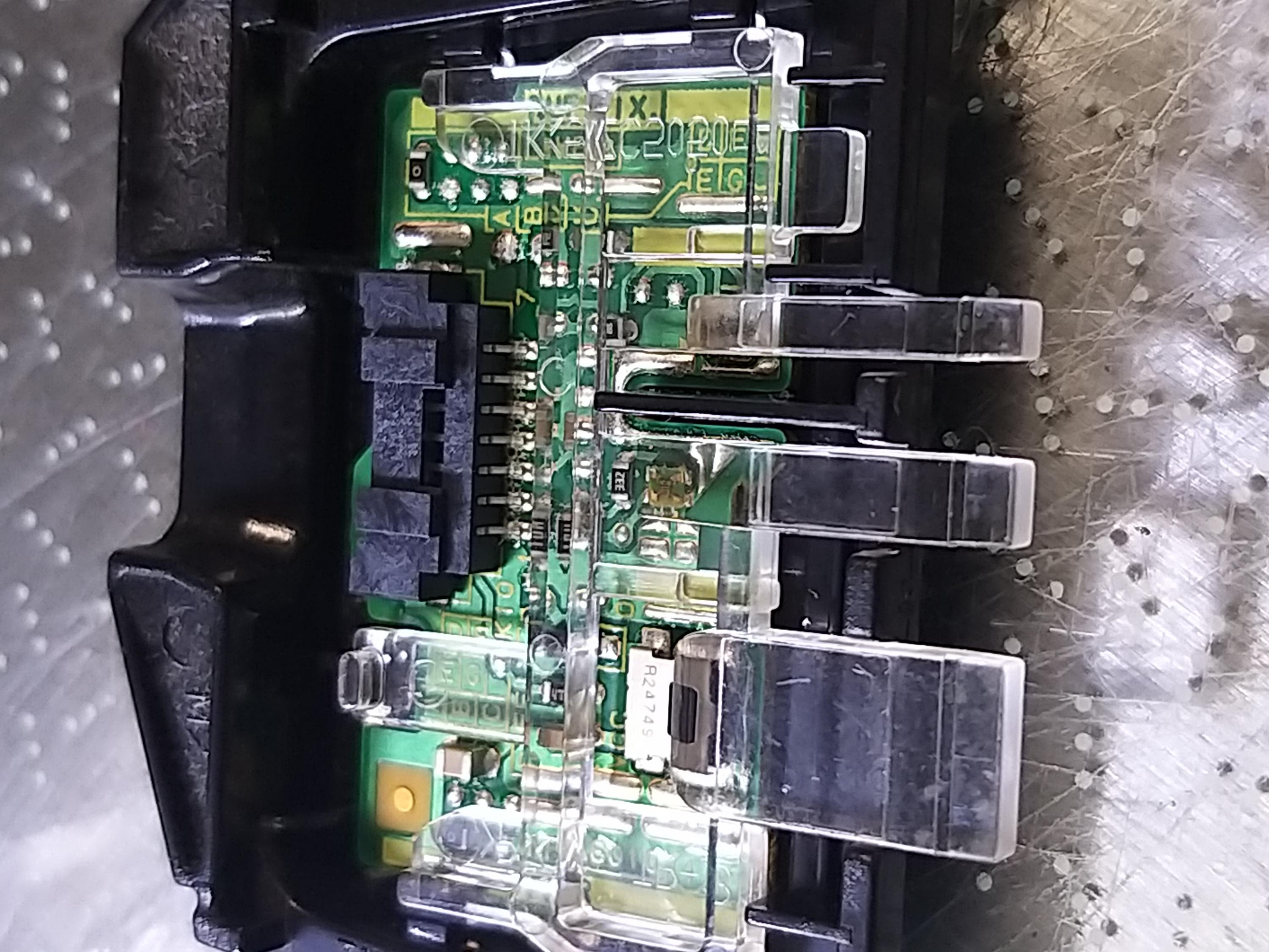

                Really appreciate the responses.
                Ok,
                I got the tv without the remote and had no idea if this function worked before.
                I cant see any bent pins.I actually didnt even touch this connector when I fixed the backlights.
                I dont know how to remove the board from this case.Anyone knows?
                I have attached pics of the front but have no access to the rear.
                I have not tested voltages. This actually the first time I have ever come accross this issue.

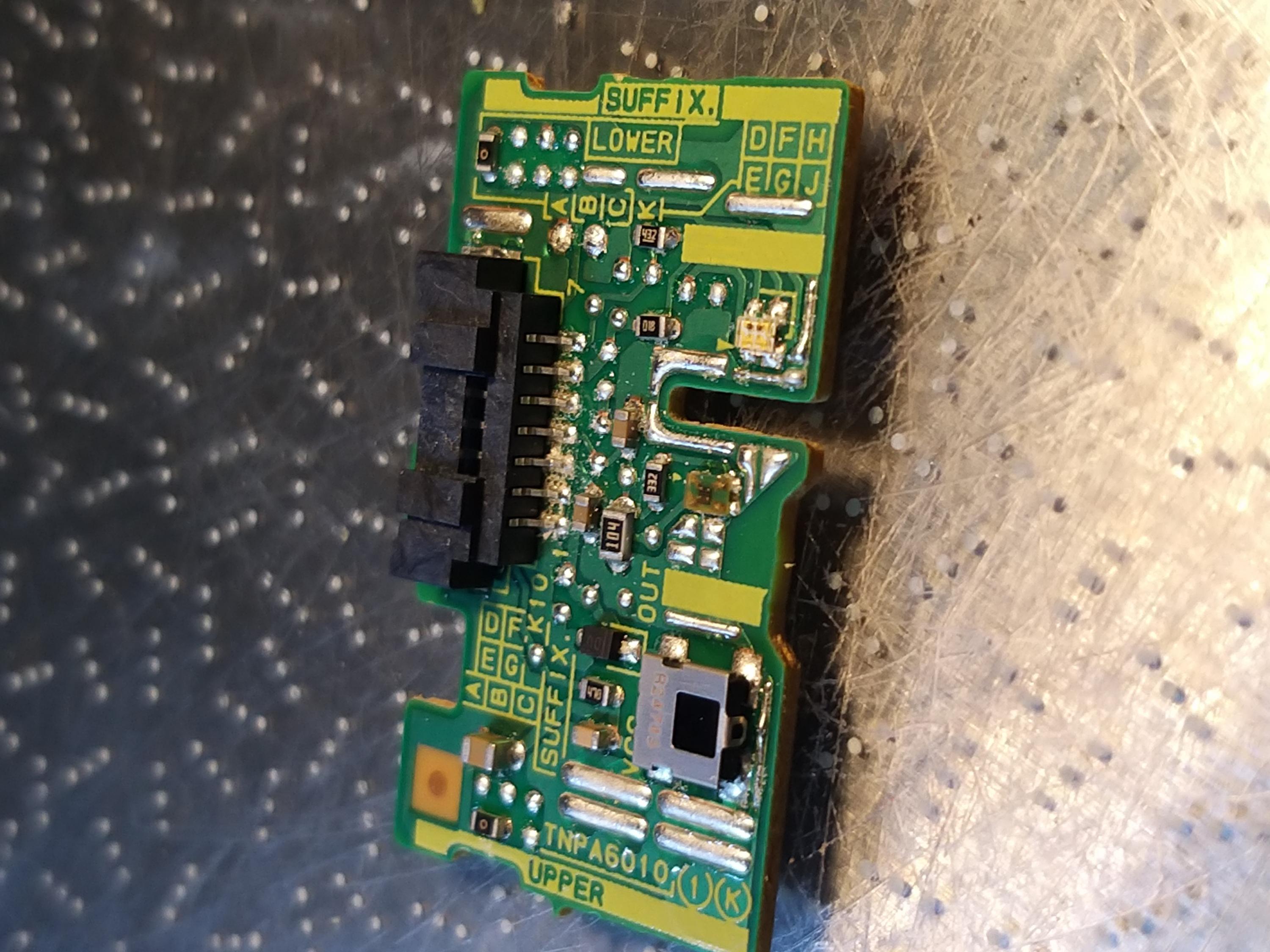

                  • vikivng
                    • Feb 2019
                    • 228
                    • uk

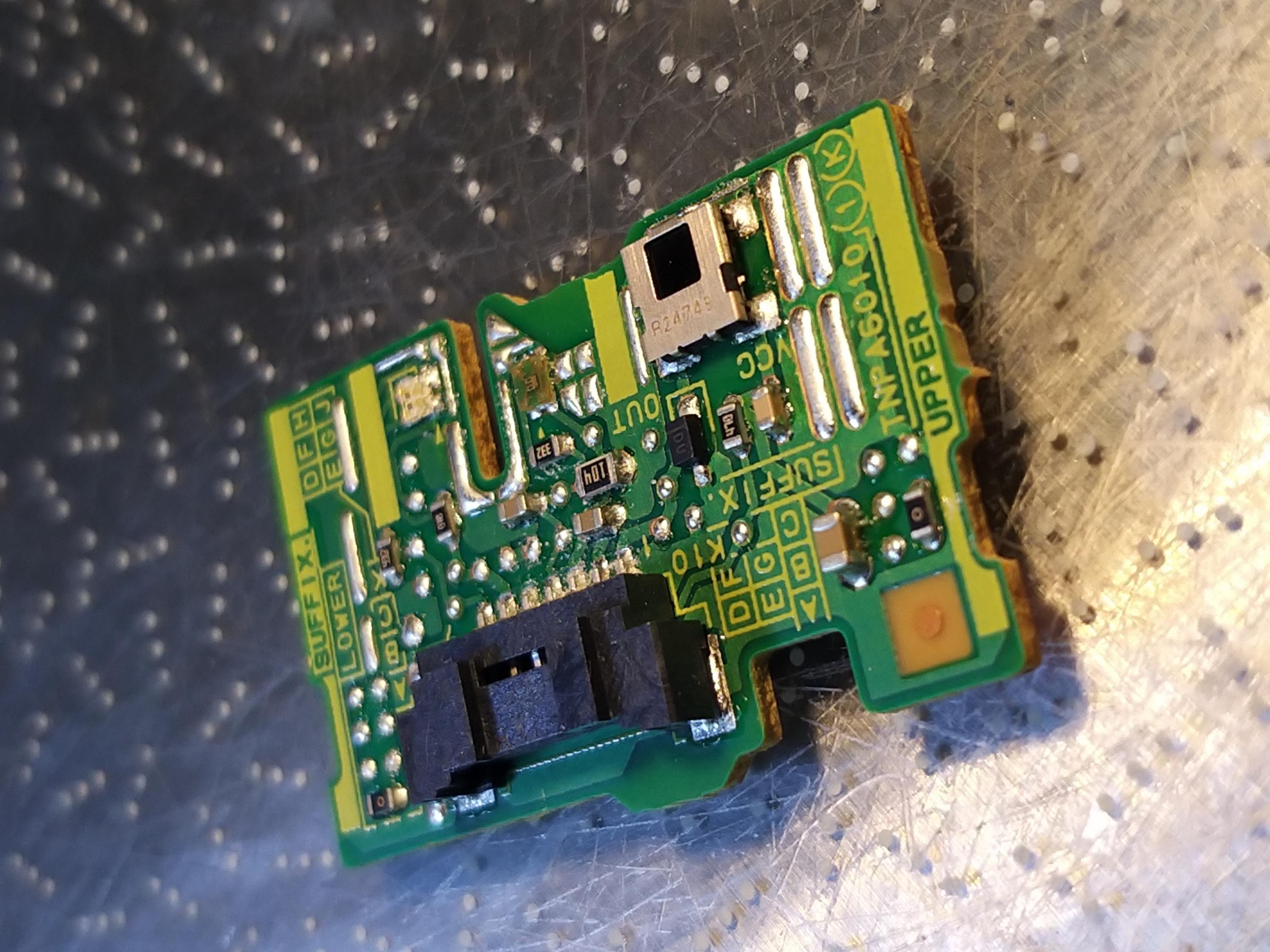

                    Ok I got the tiny board out.There are no contacts on the back of the board.
                    • dick_barton
                      • Aug 2015
                      • 6643
                      • Wales
                      You have a few 0 ohm resistors that could be checked out. VCC is printed on the board so there must be a test point there.

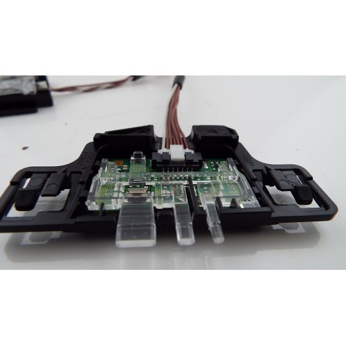

                          • budwich
                            • Jul 2015
                            • 3097
                            not sure if another model reference info provides any clues but maybe this portion might.
                            • vikivng
                              • Feb 2019
                              • 228
                              • uk
                              Thnx guys,
                              I have taken some voltages at the connector. Standby and full power on respectively
                              I have numbered the pins .
                              pin 7=0v/1.9v
                              pin 6=1.8v/0v
                              pin 5=3.2v/3.2v
                              pin 4=0v/3.1v
                              pin 3=0v/3.2v
                              pin 2=0v/0v
                              pin 1=3.2v/3.2v
                                    Do these voltages suggest anything obvious pls?
                                      IR module testing there, if voltage changes module is ok: https://www.youtube.com/watch?v=QmCwSA5u2H8
                                      • nomoresonys
                                        • Jan 2013
                                        • 12276
                                        • U.S.
                                        IR module there if yours is bad: https://www.ebay.co.uk/itm/IR-RECEIV...gAAOSwPvFdImsR
