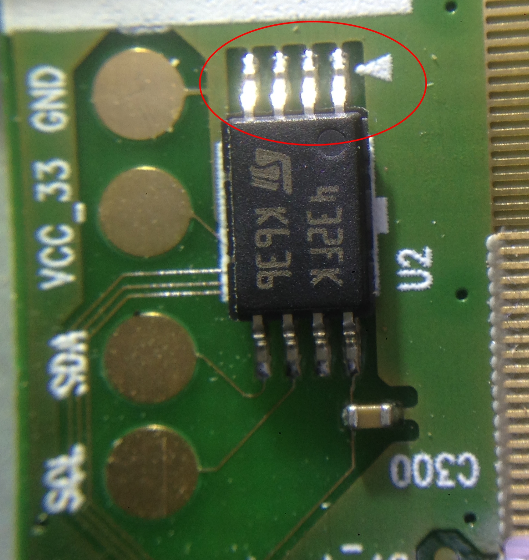

        checked the driver boards on the edge of the glass panel .. all look normal no corrosion or dirty connectors .. checked again with scope .. notice that the T-CON main processor is not running normal temp .. dead although there is clearly 12v on the main fuse and the diode input on the board
        .. unplugged all the edge panel drivers and now it runs but now the mainboard does not turn on the backlight
        .. connected to left alone and the t-con runs but no backlight .. connecting to right driver board and all the voltages get dragged down
        .. there is only a few caps and a single ST Micro controller chip on the driver board but I cannot find any info on the SMD code .. any help would be appreciated

          No cables between T-CON and the Tab bonding board, then check the resistance of all the MLCC (Multi Layer Ceramic Cap) on the tab bonding boards to see if any of them show low resistance (<100 Ohms).

            Re: LG 65UH615A - Backlight on with No Picture Black Screen
            It's an I2c eeprom probably holding EDID information. You can check the voltage at the VCC pad or check the resistance between that and ground. It's more likely to be a shorted capacitor.
              Thanks Bud .. yes did that all showed normal no shorted ceramics .. just checked there is a short to the ground test pad on the board to pins 1 2 3 and 4 on the chip so it is toast .. turned on the board one more time and the 3.3v test pad on the driver board shows 1v but the chip doesnt seem that hot
              Diif .. is EDID is unique to this specific TV or could I rip one off another broken panel?

                But pin 1,2, 3, and 4 are connected to Ground plane as you can see the traces. What is the resistance between GND and VCC test pads?
                  When your right your right .. kind of strange having a micro with 4 pins all connected I didn't look close enough .. pulled out a better ohmmeter with sharper probes and I found 3 shorted caps .. any suggestions on swapping caps so close to tab bonds? I guess maybe some low temp solder and a tiny iron
                    Could be only one is shorted, remove one on an end, see if it's shorted out of circuit and see if other 2 are still shorted.

                      Show us the pictures fo the suspected bad caps.
                      I use 40W wide tip soldering iron and add Lead solder to each end of the cap to remove it.
                        You guys are on a roll today Attaboy .. I put a meter on low ohms and found the ceramic on the driver board with the lowest value removed it and the others opened up guess they were in parallel .. swapped in a ceramic cap from junk board and now it's firing up .. I was about to give up this one
                        .. the LG 4K tv's have bad ceramics in them I wonder how long before the next one shorts out
                          MLCC failure mode is shorts circuit or low Ohm mode, this happens to just about all brands of TV not just LG, you will see lots of threads about bad MLCC, we all have lots of experience about these failed MLCC.
                          BTW, if you did not use good meter and good probes then we would not have found out the cause of the problem, remote troubleshooting requires valid data, I am glad you did find good meter and probes.
