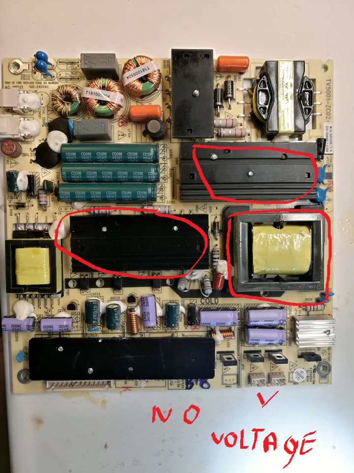

    hello i hope i can get help here on this tv, no back lights , all leds bulbs checked working had screen out , the power supply seems to be at fault. when powerd up all correct voltages are there, apart from led, con,1 con2, no power i marked that in red, common fault with tv set but cant find any repair tips ;-( power supply in question tv5001-zc02
    Re: jvc lt-50c550 power supply problem
    Put all connectors back in place.
    1) What DC Voltage do you have on the two legs of the 3 mail filter caps in the HOT side when you turn on the TV and measured right between the two legs of the caps? 380 ~ 400vdc?
    2) "when powered up all correct voltages are there" Are you saying the control Voltages are also correct, I.E. PS-ON, BL-ON, DIM...? What are the DC Voltage on each pin of the connector that goes to the main board? The pins look to be labeled so put down the pin name and follow by the Voltage reading for each pin so we can easily see what it has and does not have when TV is off and when power switch is activated.
    3) Please provide pictures of the whole backside of the TV showing all the boards.

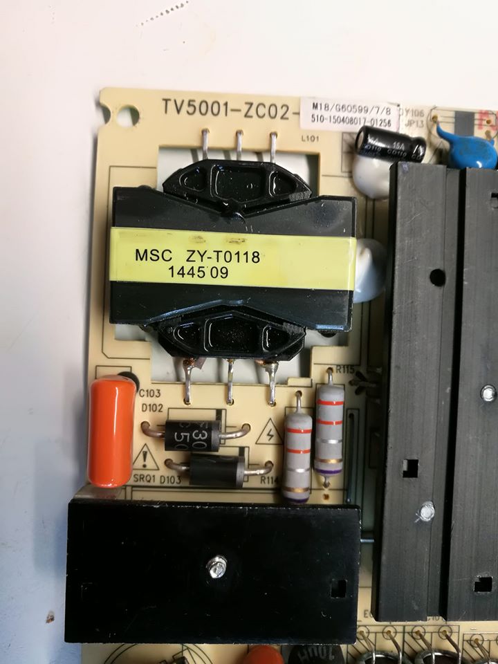

      i may have found the problem this yellow transformer has feed 326v but reading zero voltage coming out

        If the circuit that drives the transformer primary with an oscillating voltage is not working then there will be no output.

          Looking at circuit diagram this is a transformer in series with the PFC supply and whose secondary provides the zero crossing for U102 so I would say there's nothing wrong with this transformer.

              You need to check the voltage across EC101,2 or3 with the tv in standby (OFF) and then AGAIN with the tv turned ON. This will give an indication of the PFC circuit operation.
              In the first post you said "when powerd up all correct voltages are there, apart from led" So the power supply is likely working.
              Report these voltages.
              Next check the voltage on the + of EC202,3 or 4 as the tv is being turned ON. don't wait untill the tv is already ON to check this voltage.

                That is PFC Inuductor. You do know what PFC is used for in TV, right?
                You need to follow instructions and requests if you want to get help.
                1) We need to know if the PFC boosted Voltage is working or not.
