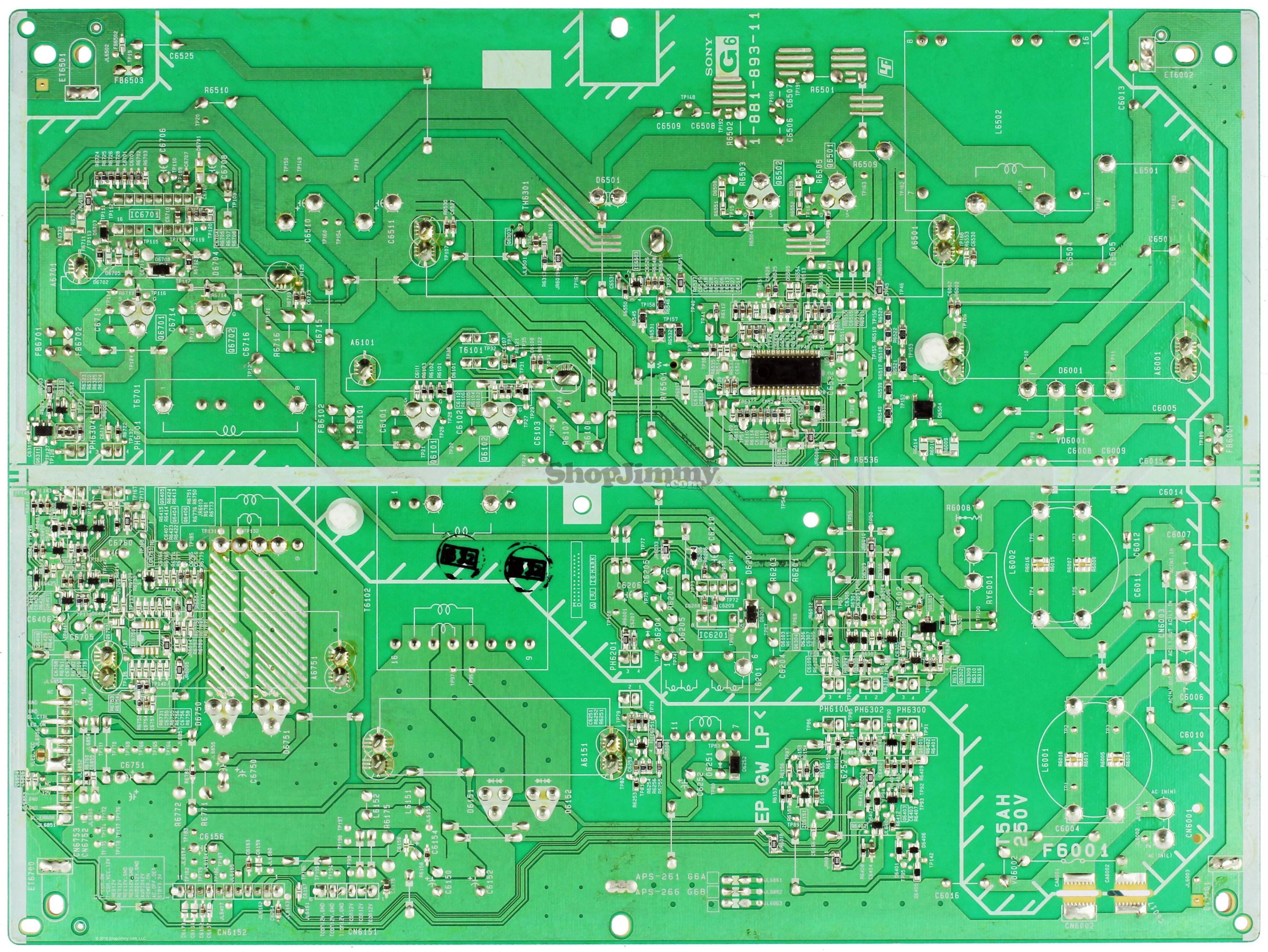

    Sony KDL-55HX800 no power
    No power. No LEDs.
    Purchased power supply repair kit from SJ.. Same symptoms. No power, no LEDs.
    Standby voltage is present = 3.3v (CN6152, Pin1). No other voltages.
    Jumpered Pins 1 + 3, Standby voltage pulses from 3v => 0V => 3v, repeatedly.
    Transistors and diodes seem to test OK. Not sure how to test MIP2H2(IC6201) or CXA3740M(IC6502), although both of these are new and installed with no issue.
    Power supply board for reference. Thoughts?

    Re: Sony KDL-55HX800 no power
    The standby voltage should'nt drop, If you can try loading just the 3.3v standby with around a 5Ω resistor to see if the standby voltage drops, If it does I would suspect C6205, C6210 and C6206 are weak.
      Do you mean take that standby pin(pin1) with a 5ohm resistor to ground? This would be different vs pin1 jumped to pin3?
        Looking for more thoughts on this..
        I've done a resistor from pin 1 to pin 3 as well. No difference. Only voltages shown is the standby, then when forced on its does up/downs from 3v to 0v (cycling).. Can't get this power board to turn on..
                  Yes, resistor to ground, this will check if the 3.3 volt standby supply is providing enough current or not. If the 3.3 volts drops with the resistor in place then the standby circuit has a problem, if it stays up, disconnect the main board and try a 1k between 3.3v standby and POWER_ON pin to see if the other voltages come up.
                  A 5Ω resistor across the 3.3v standby should draw about 660ma
                    Update: After triple checking my SJ parts kit, I was then getting a blinking red indicator light. Blinks = 12v issue. Could not troubleshoot any further. Ordered replacement power supply board from china. TV works now. Thanks for assistance.
