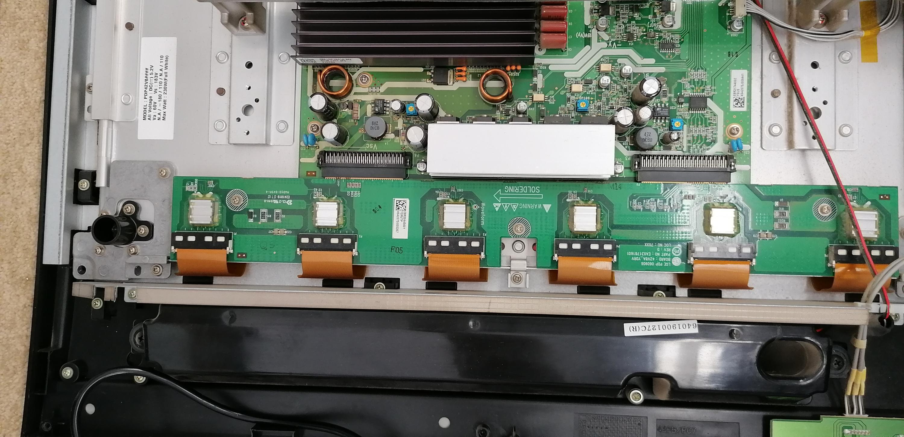

    Hi Guys.
    A week or so ago i asked how to get this plasma set into Auto Gen mode to see whether my drive panels are ok and now i know they are not. The set starts up by hearing a clicking and there is a slight pre charge flash, i have to cup my hands with my eyes against the screen to see it.

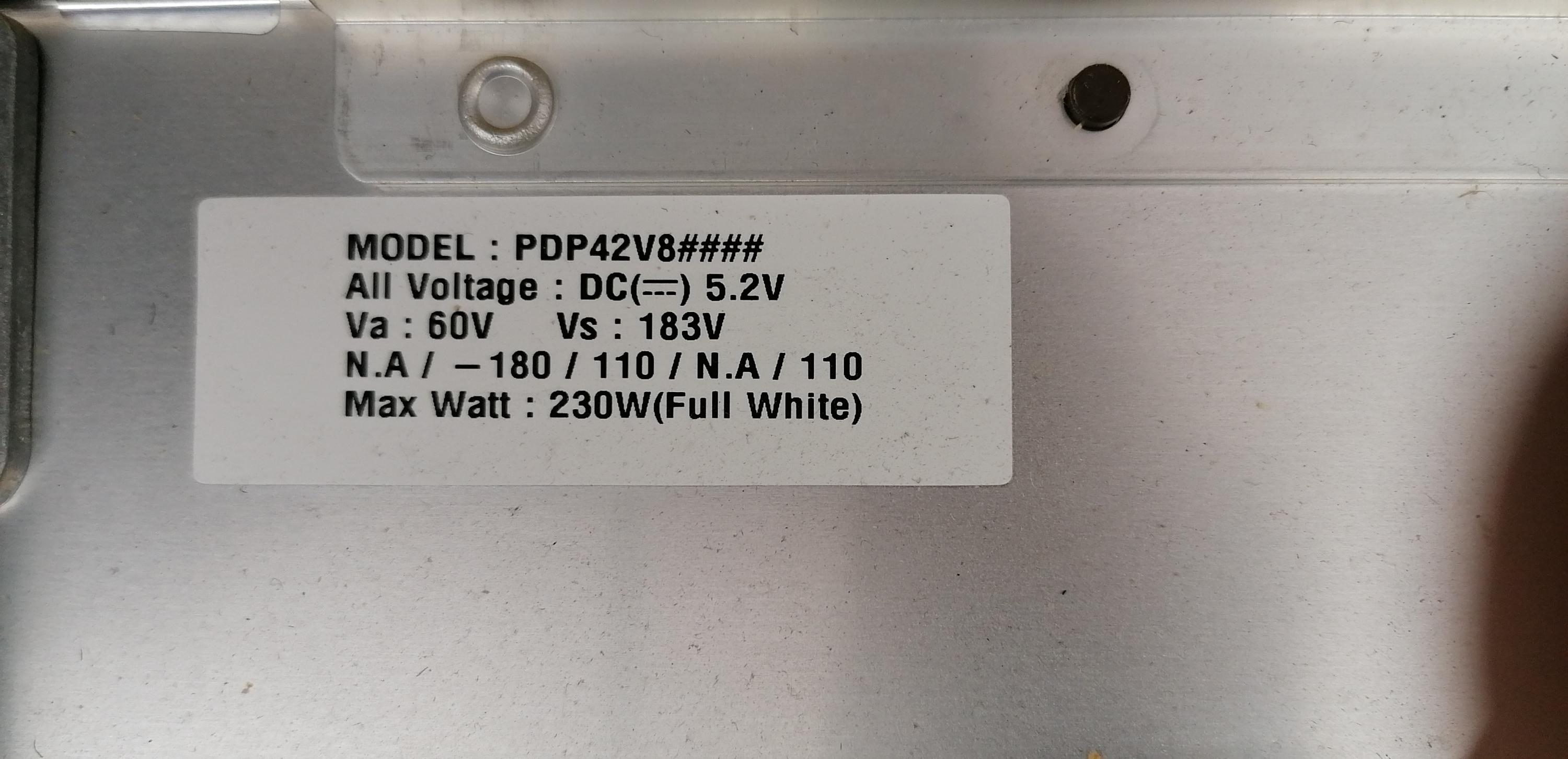

    If i pull the AC mains plug i get an image on the screen. It's the exact image that is being auto generated by the logic board and then the tv dies off as power drains. I think the image is the for about 0.2 seconds before disappearing. I wrote down the voltages that i could find on the board but i don't know... on the sticker which label is for which voltage. Can anybody clear up for me the what the sticker indicates, the format of Vscan, Vy Vbias etc....

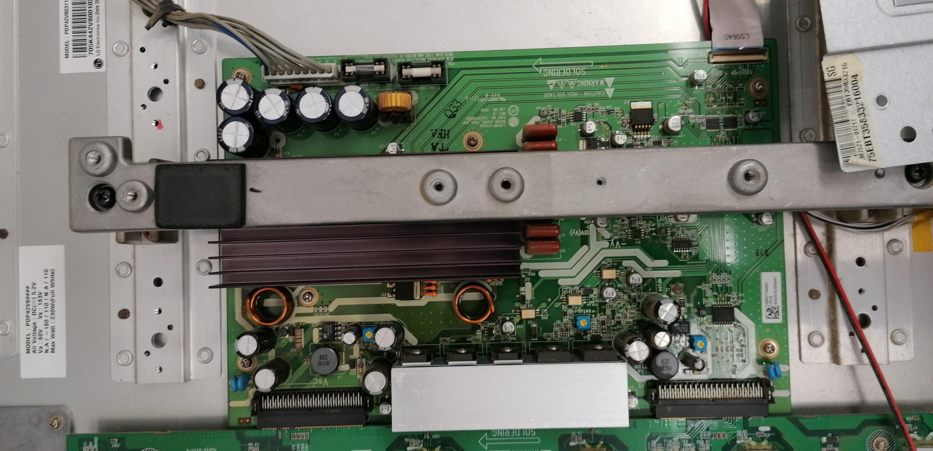

    Also i really suspect the Y-sus is to blame hear but hope to repair it since replacement part is quite expensive.
    I have noticed that someone has already replaced the fuse on the Y-sus board but this fuse is ok now.
    I have checked on the IPM that there are no shorts between its outputs and ground. Like i said no fuses are popping.
    How do i isolate where this issue is?
    Kind regards
    Angelos

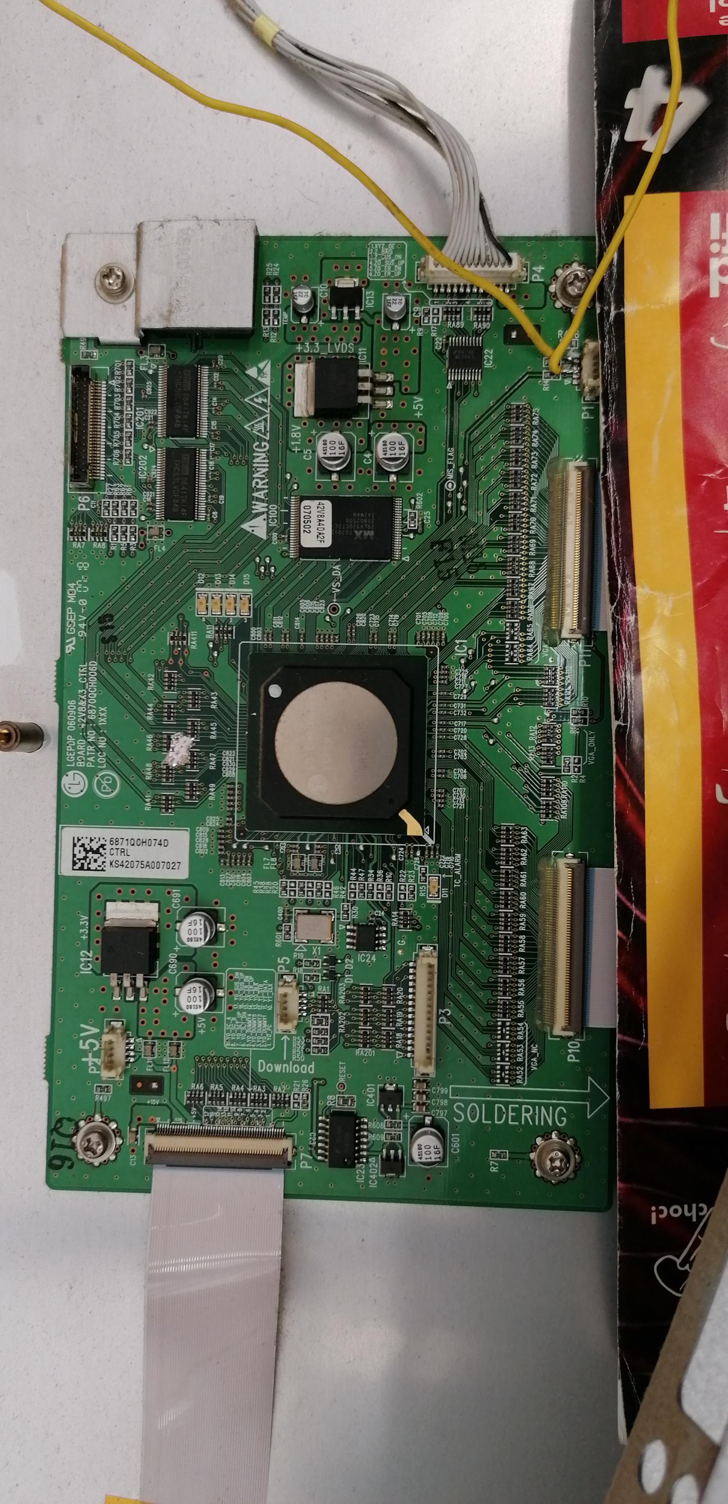

    As well as the shorting of the two points on the logic board did you also isolate the ribbon cable between the mainboard and the logic board and then power up?

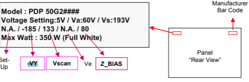

      Hi, this image is from an LG plasma 50PQ30R, 2009, newer than yours but the information on the sticker is the same, -VY/VSCAN/ZBIAS.
      There seems to be some disparity between your VSCAN reading and what the sticker says, are you measuring it correctly as the boards indicates the + and - reading points?
        Yes, i removed the cable going from the main board to the logic board, The LVDS cable?
        I also removed all power to the main board. There were two plugs.

          There is a marking on the Y-sus board showing Vsc, i assuem that is the Vscan? This measurement is on the plug going to the buffer boards.
          I must add that upon switch on this voltage slowly climbs to 188V taking about 6 seconds to get there. Not sure but perhpas the IPM IC is faulty. After all the client has replaced the fuse that feeds the IPM's SUS_OUT pin. I suspect this chip is not switching anymore. I did ESR all electrolytics and did not find any at fault.

            Re: LG Plasma Model 42PC7RVH Chassis PDP42V8 - No picture!
            When you have powered up the set does the led on the logic board blink 1sec On, 1 sec OFF?
            Strange that you can see the picture as you shut down. Can you turn Vscan down to match the panel @ 180V
              I think Biruslapio may well have noticed an issue.
              Your panel label indicates a Vsc of 110V but you give a reading of 188V in post #1?

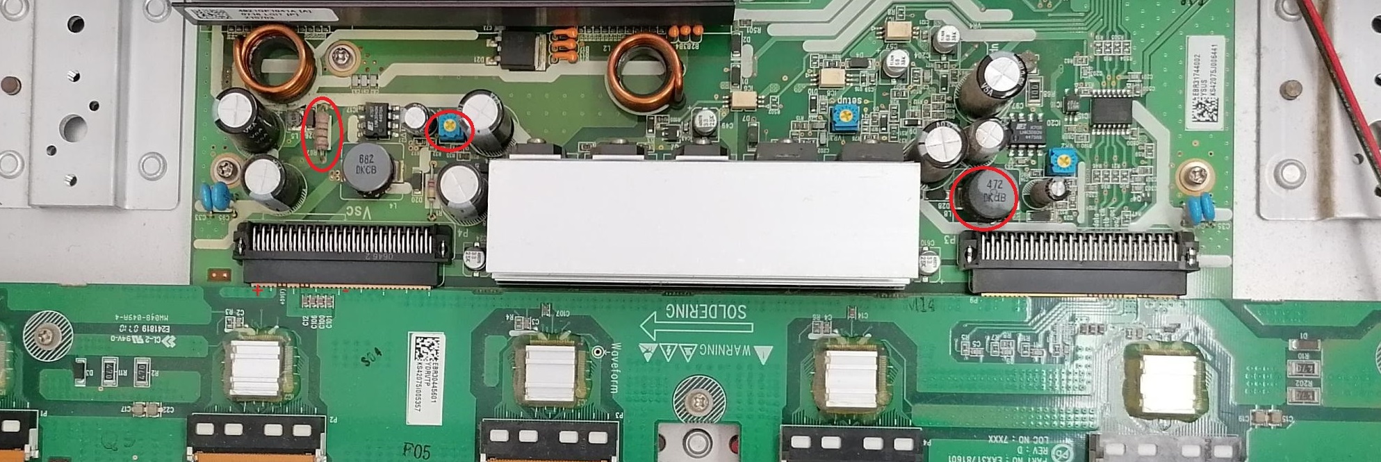

                I have MSPAINTed your image with points of interest that may have to do with VSCAN/VSCN/VSC (they mean the same in this case).
                That 1 ohm resistor, is it measuring correctly?
                The L8 inductor looks darkened, may be dust or something, but it looks different.
                VR1 may be able to lower or rise VSC, make note of it's original position and try turning it counter-clockwise to lower VSC, if it doesn't change, it is lowering something else, like -VY, try then VR2.
                IC20 or IC17, one of them are what generates VSC, from the looks of this board IC17 is much closer to the VSC checkpoint, as well as VR1, to me that area is what generates VSC, I cannot confirm that without the board in hands.
                Those golden pins at the top Y-Buffer can be used to measure VSC.
