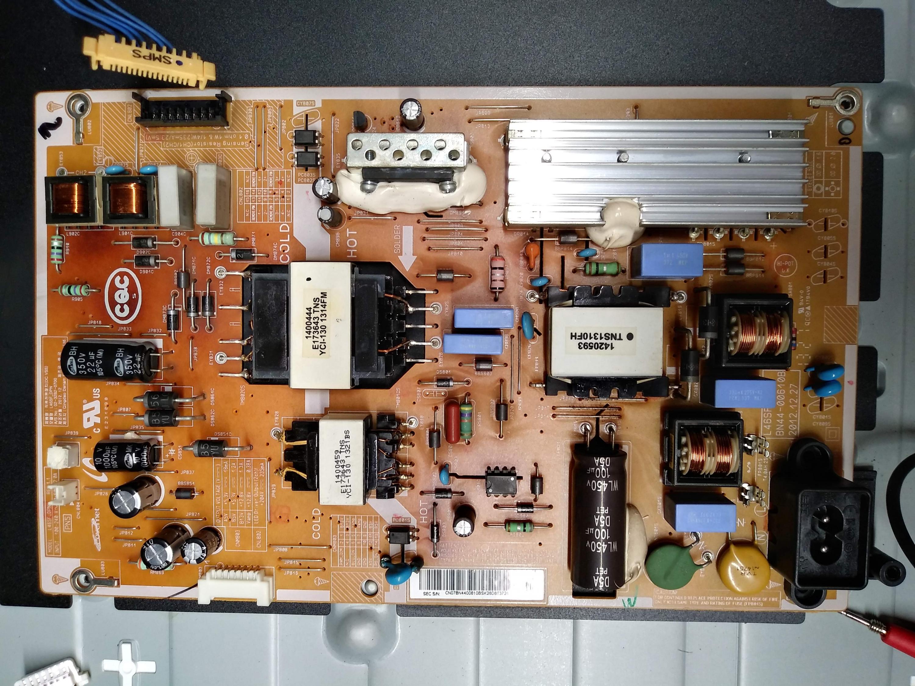

    Found my self a new challenge...
    Samsung LED TV UE46F5000AW whit fuse blown. I know i have a short because if i measure resistance between the + and the - from diode rectifier i get 0 ohms.
    Now how can i proceed... i could not find a good and complete schematic for the BN44-0010B power supply.
    Does any of you have one complete?
    Could it be the rectifier him self or maybe the capacitor just after this one.
    All diodes and resistor measure just fine.
    I guess i have to remove parts to measure cause until i don't find the short... well everything between + and - will read shorted!
    Any one that had the same issue and fix it?

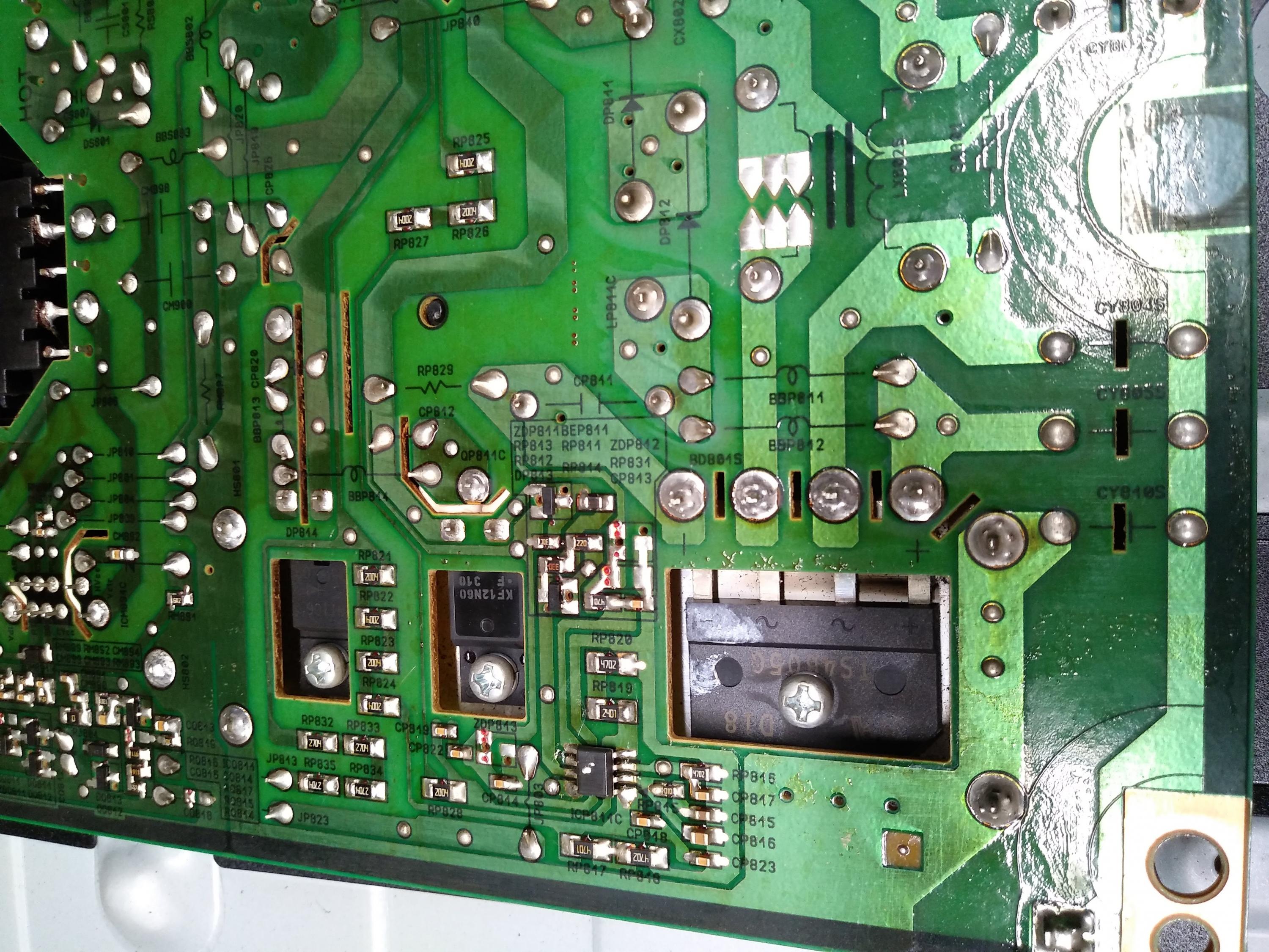

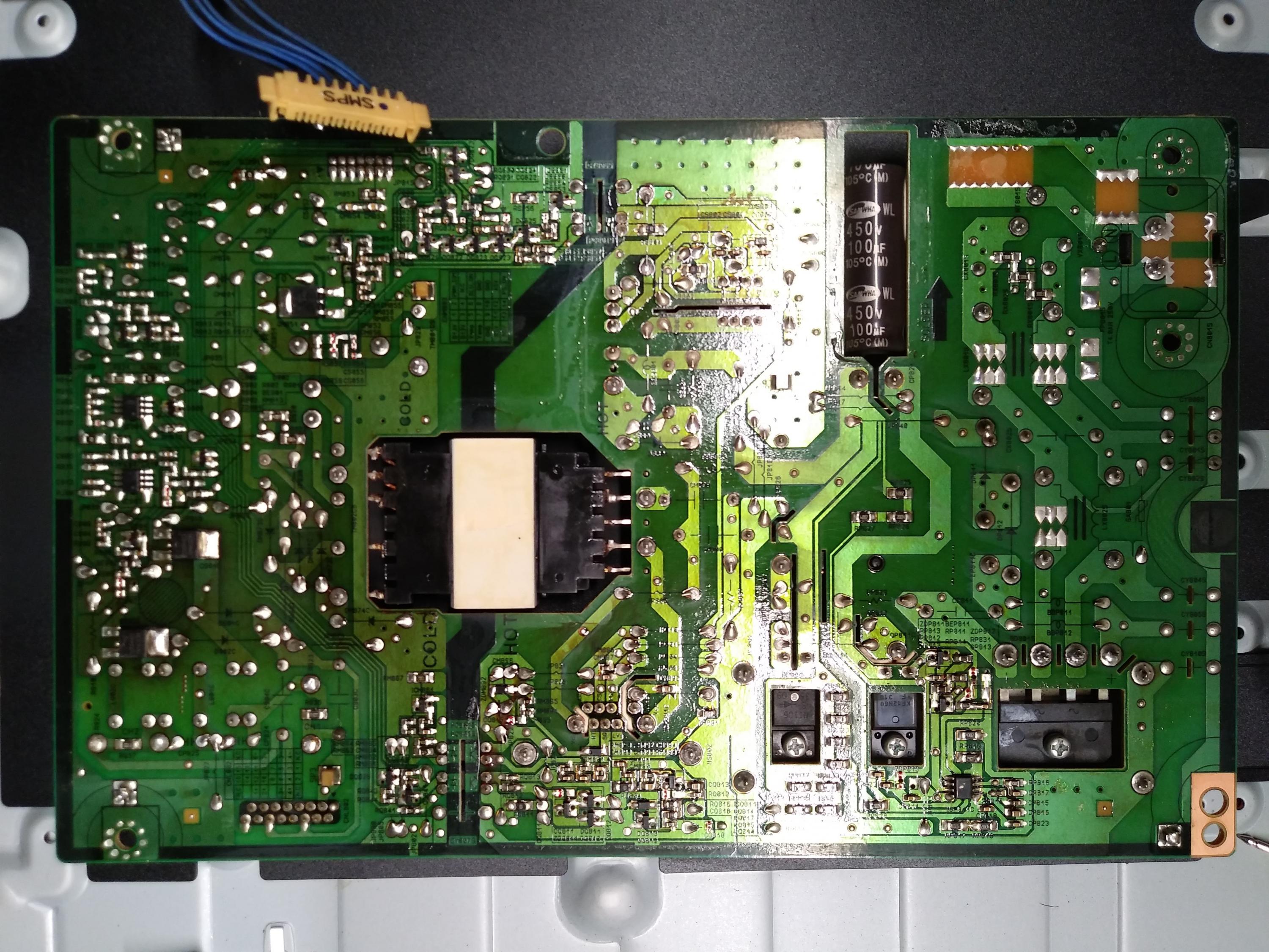

    I posted the pictures from the supply board.
    Thank you!

    Things I would check would be the bridge rectifier, the diodes and the mosfet.

      Maybe lift or clip a leg of that one diode you mention and check it out of circuit.
