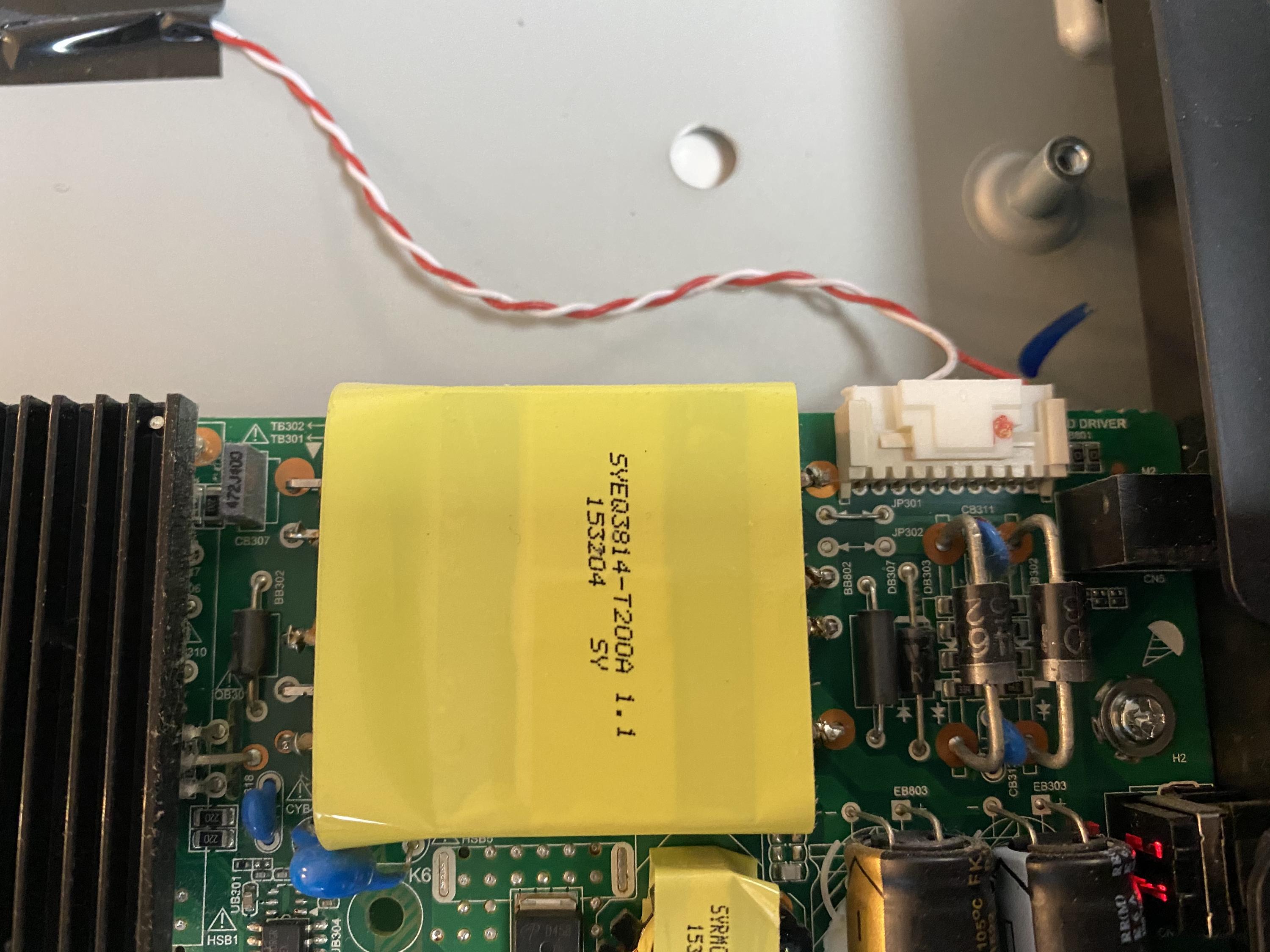

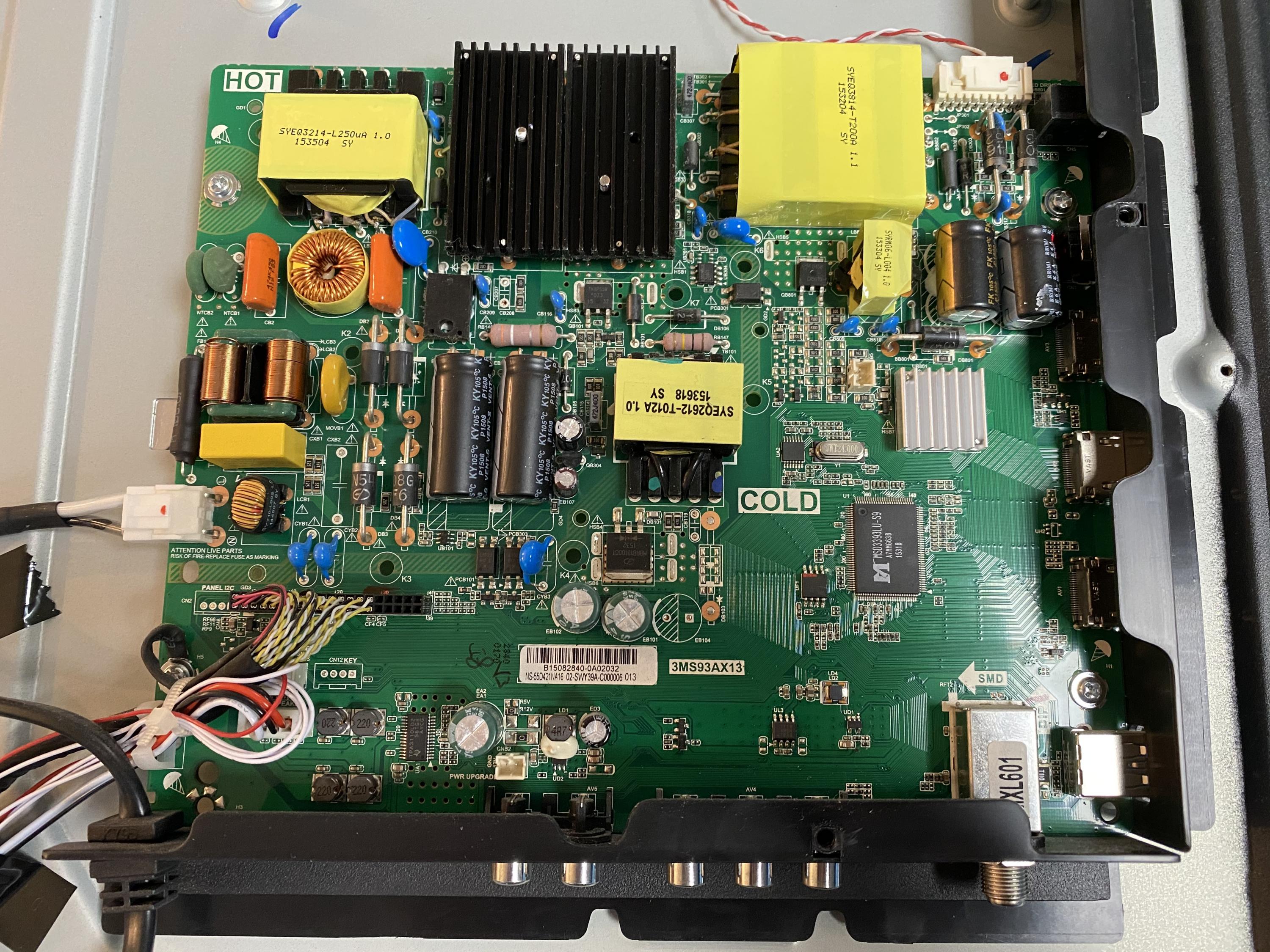

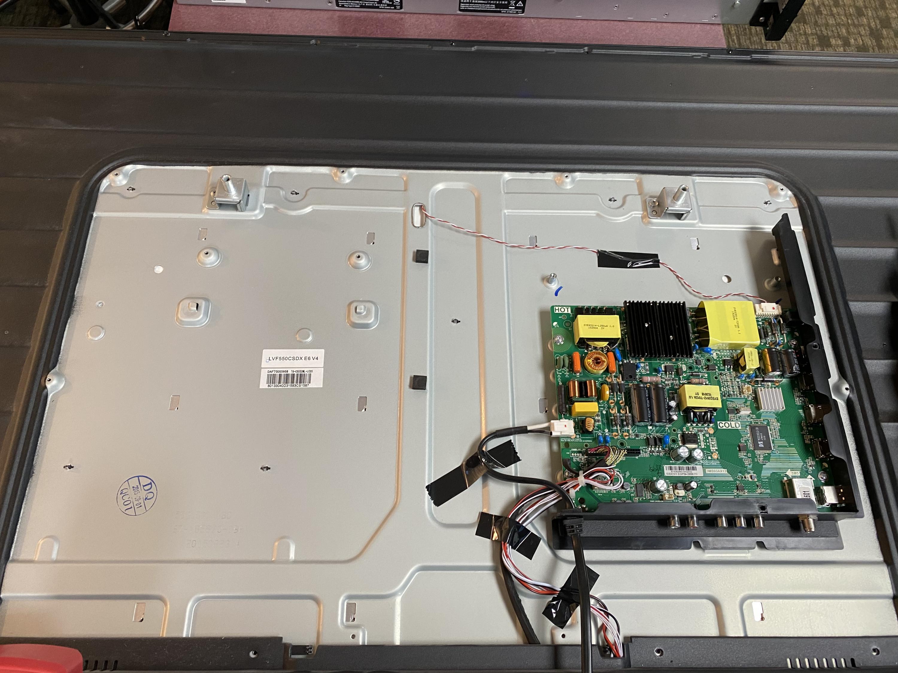

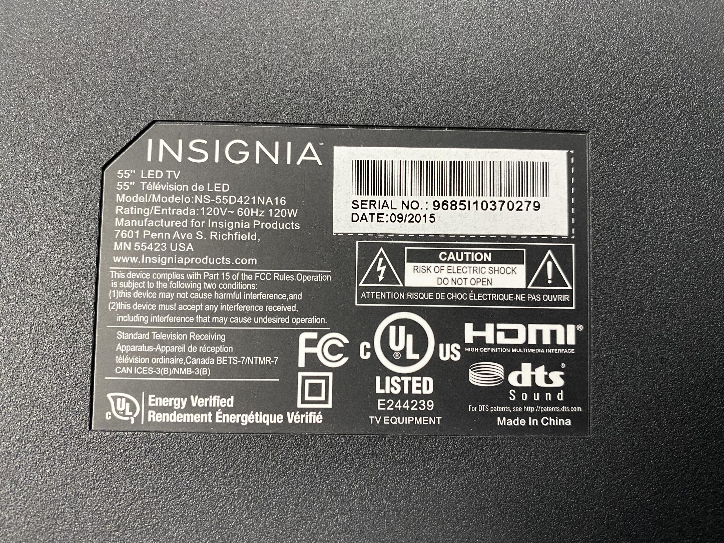

    I have an Insignia NS-55D421NA16 that, when powered on, shows no picture but the standby light blinks 8 times. No backlights at all either.
    Pictures are below.

    Backlight failure is very common in Insignias and your first suspect with no backlight or if the backlights flash. Insignias don't have blink codes (only Sony, Panasonic and older Sharp models) and typically blink when booting like LG and Samsung TVs. The TV should be on with no backlight if the front LED is off. You can perform the flashlight test to see if you have an image. With only one pair of wires to the LED strips, probably an open LED if they don't flash. if you want to repair TVs, you should get a LED tester. I use mine more than my multimeter. With a LED tester, you can determine if the string has an open or power the backlight independent of the combo board to confirm the screen is good.
    You can also monitor the voltages going to the LED strips when you power on. One side should be fairly high and then settle to a lower voltage if the LEDs are all good. If it doesn't settle and stays high, you likely have an open circuit in the string.

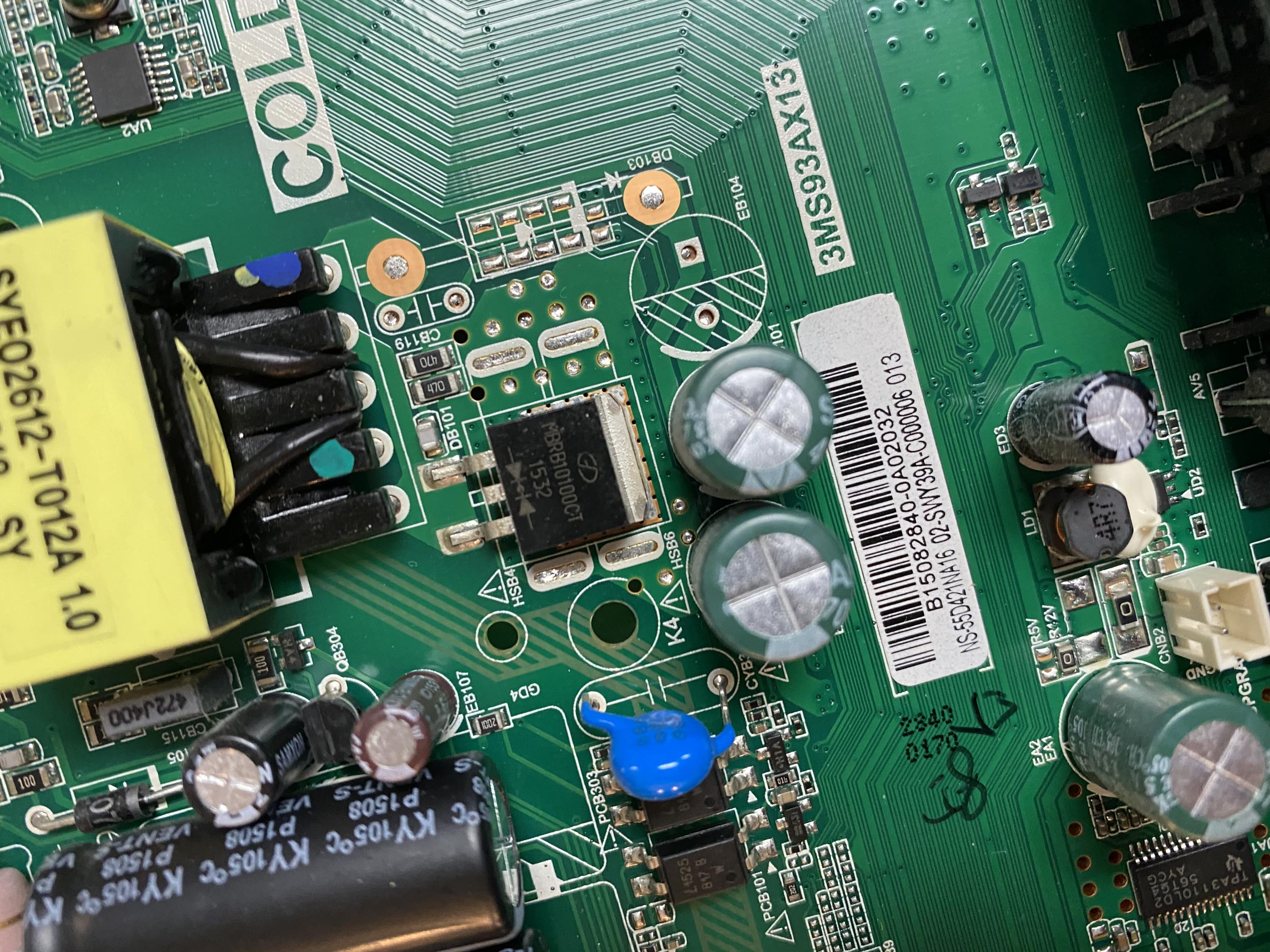

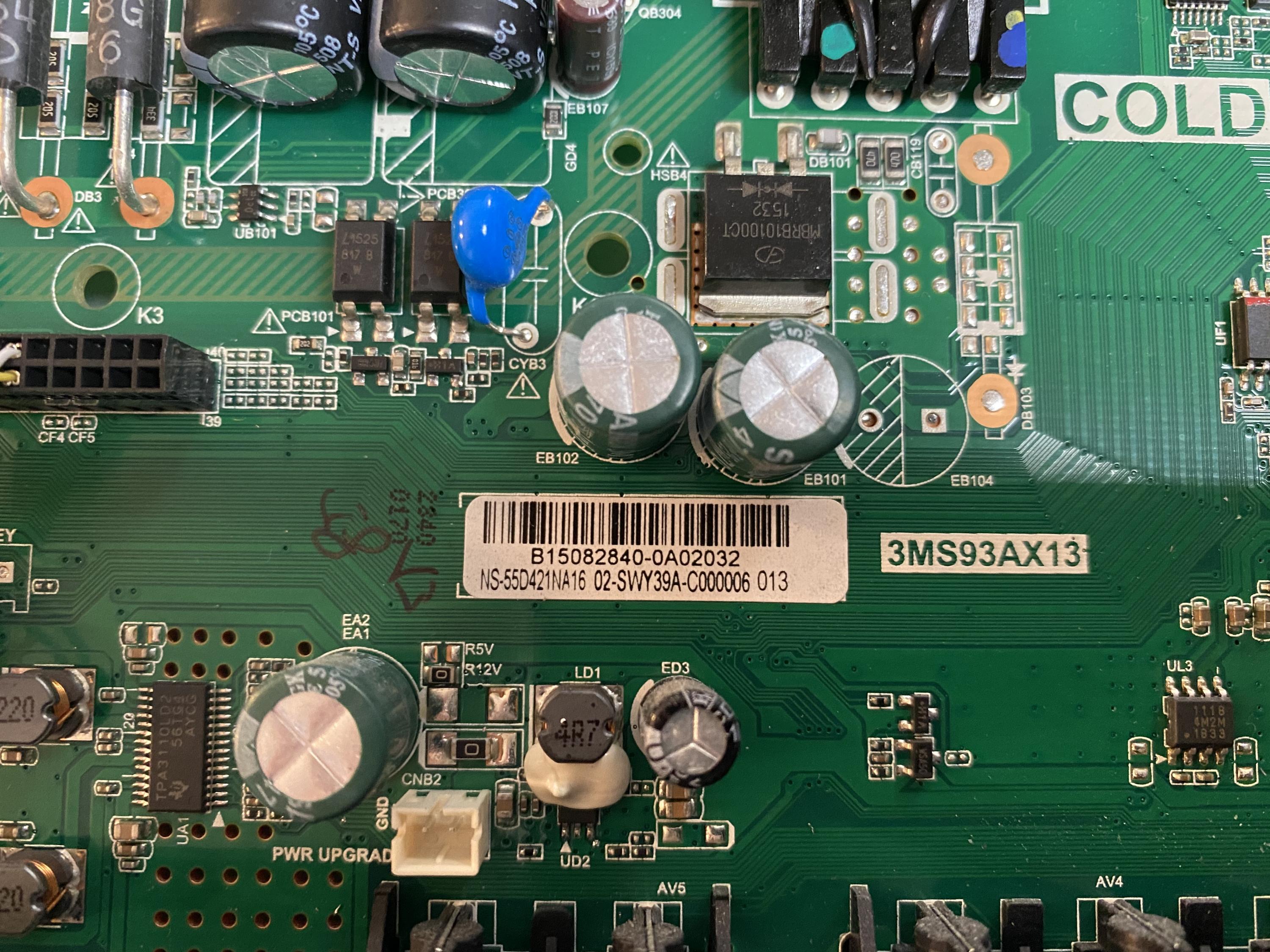

    Board looks like the white label Chinese TVs branded RCA/Proscan/Seiki/Westinghouse.... Curious if the Insignia has the backlight setting accessible or if it is hidden in the service menu in these models.
