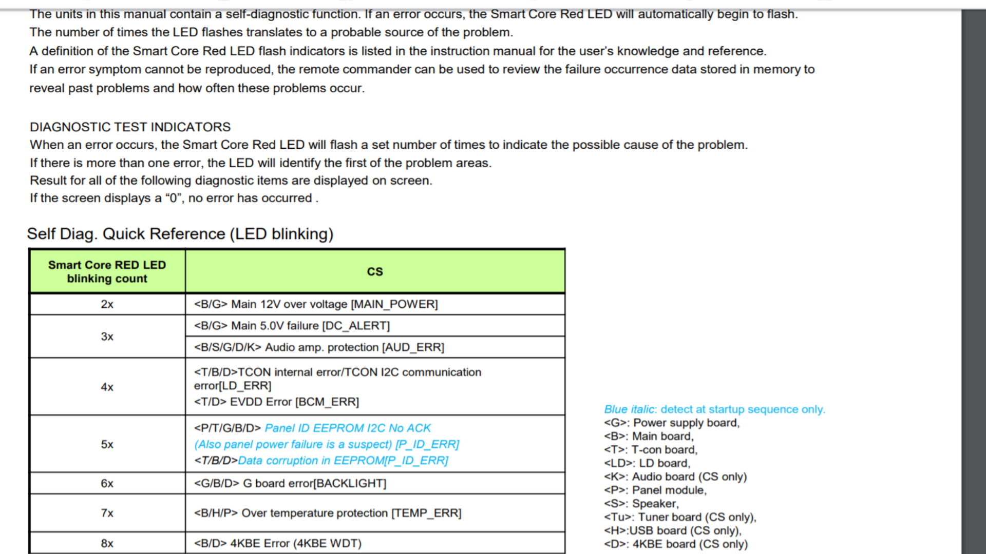

          Re: Sony Oled 4 or 6 blinking red lights
          When the Main board or T-Con board is replaced, or if you disconnect an LVDS cable and power up the TV, you will get no video on the screen.
          The only indicator you have to go by is the front panel LED.
          The TV may require a software download to re-establish communications between the two boards and also to the LCD panel.
          according to the flashes: 4 flashes indicate the LD/BCM board..... 6 flashes indicate the panel backlights.... both are linked to the LD board so id say that is the best place to hone in on first. Second would be the power supply board, third would be the main board and then finally the lcd panel itself.

                my apolgies...went back and looked at the source material and it indictaes that this troubleshooting is for led lcd.
                on another note....the service manual for the model listed indicates the most likely board for the 4 flash is the tcon (panel module) and the most likely for the 6 flash is the g* board. with the stationary line there, it indicates the most likely board being the b* board which happens to be the 2nd most likely board for the 6 flash led. the second most likely issue for a 4 flash is the oled panel itself.
                  hope this helps you guys:

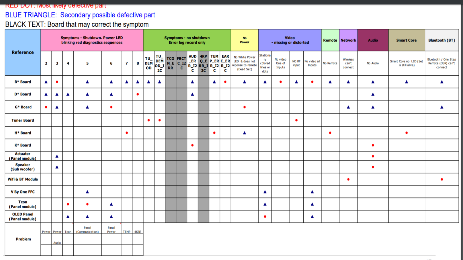

                    which boards are the b and g and d
                    thanks Gregg
                      thanks Gregg
                      sry...should have included this.

                          • j3scott
                            • Jul 2021
                            • 3
                            This table looks more applicable to LCD panels, not OLED?
