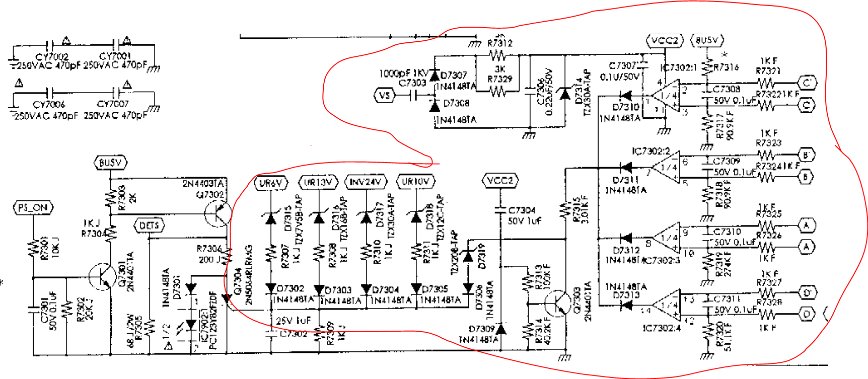

        Searching the internet i found the squematic diagram (Page 25 of the attachemnt) of the PSU. i've been studying it but can figure out what going on

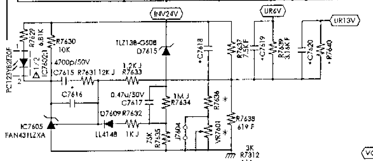

                but the optocoupler have 0.615V on the anode, i measure D7301 and its voltages are = C: 0.615Vdc, A:0.777Vdc
                Then i measure R7306 and its voltages are 4.92Vdc and 0.777Vdc.
                I think the problem is in the circuit that controls the gate of Q7304. But i really don't understand that circuit.

                  That looks like an over voltage/over current protection circuit, if any of the voltages are too high such as UR6V, then D7315 conducts and turns on the Q7304 SCR. The SCR turns ON shorting out ic7902 turning off the supply. Now this might happen if you are testing the board out of the tv without a load on the supplies. You did say the voltage appears for a second then drops
                  The over current part is ic7302, it monitors the current (UR6V is monitored across R7401) the "D" "D" So you could have a high load on one of the supplies IE INV24 (bad inverter board?)

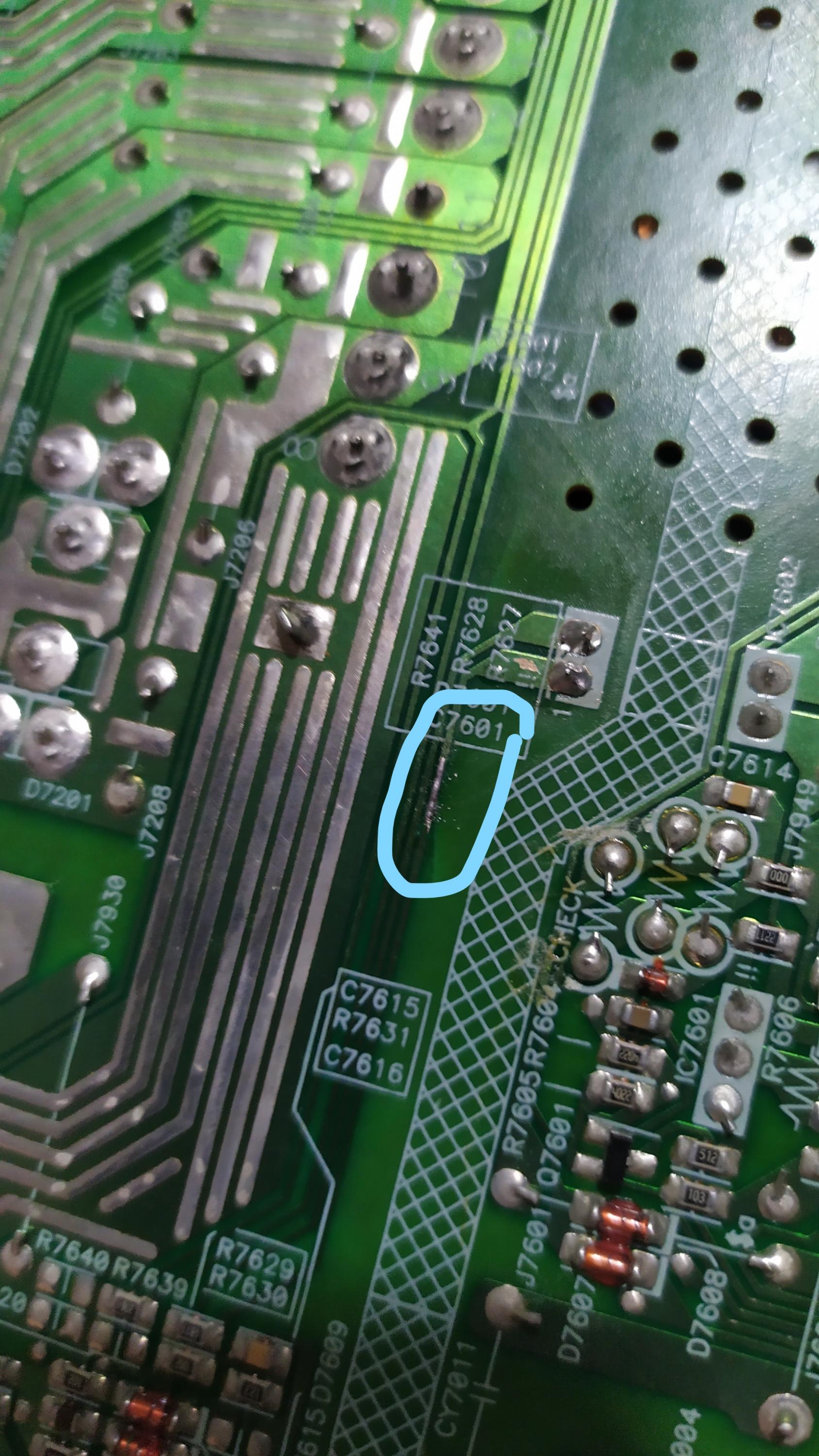

                                UPDATE!
                                I found the problem! it seems like the board got bend during shipping!. checking a circuit (i was checking values and continuity of all components) i found that i was getting a problem with IC76002, so i found out it didn't have continuity between its anode and the resistor R7629
                                I check real close the board and finally see that it was a little (minimal) bend, so keep checking and found were the conductive track were broken, now i just made a little soldering and test again the board! and BUMM it finally worked!! then i connected to main board and inverter and it works!!
                                Thanks everyone for the help!
