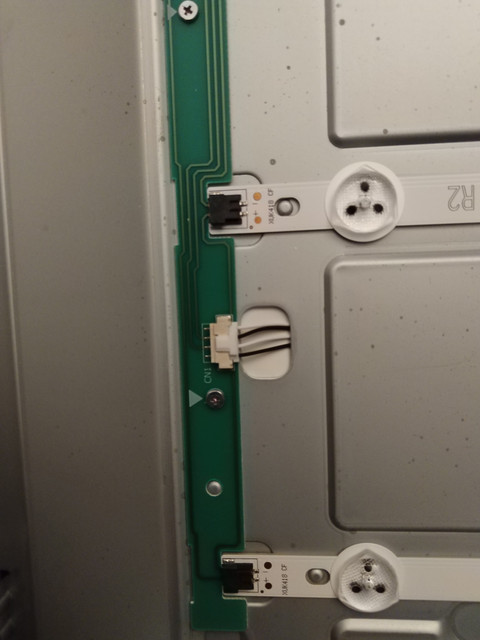

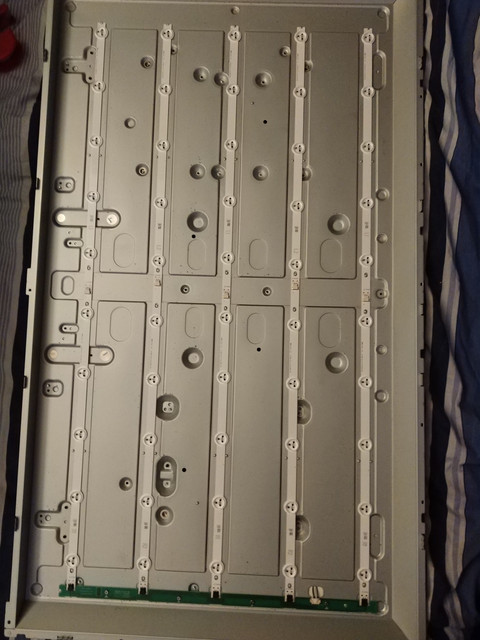

        I've got the TV apart and exposed LED strips, any guides on how to test with a multimeter in diode mode? LED strips look fine, no burn marks.
        • tekz
          • May 2020
          • 12
          • United Kingdom
          Re: LG 42LN5400 - No Backlight
          I think my multimeter diode mode is too lower wattage at 2.8V/1.5mA. Not sure where to go from here apart from ordering an LED tester. The LED's themselves don't seem to have anywhere to test individual LED's.
          I have seen this on Amazon, would this work? https://www.amazon.co.uk/Digital-Com...14&sr=8-6&th=1
          Added some pictures (not sure where the marks on the LED panel came from that look like some type of liquid, there are no marks anywhere on the TV apart from here and that area is totally sealed so I'm guessing must of been in the factory.

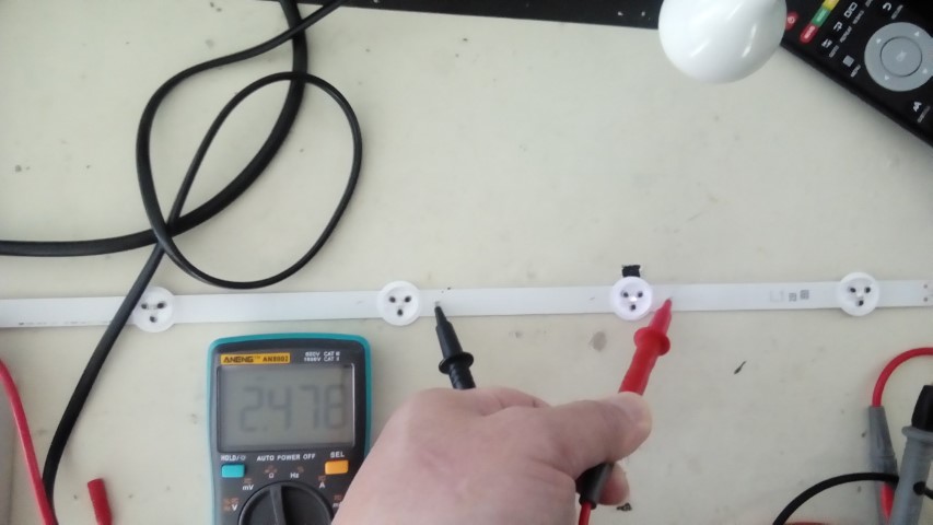

          • neilc6
            • Nov 2015
            • 1550
            https://techhometravel.com/testing-l...klight-strips/
            • tekz
              • May 2020
              • 12
              • United Kingdom
              Thanks neilC6, to confirm, I just scratch paint away either side of the LED's and test?
              • neilc6
                • Nov 2015
                • 1550
                For the LN strips, scrape to the right of each LED and not on both sides. Little trickier to find an open LED since you have to isolate it.

                  Looks like you have 10 across so three 9 volts should do it or scrape them all: https://www.youtube.com/watch?v=1n-Nq8HLK20

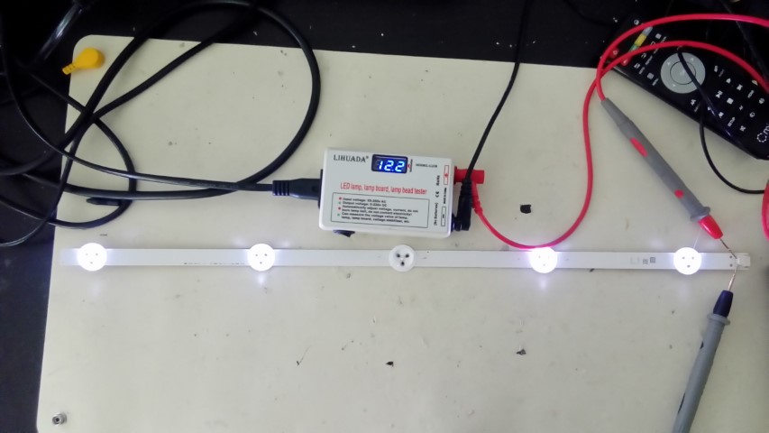

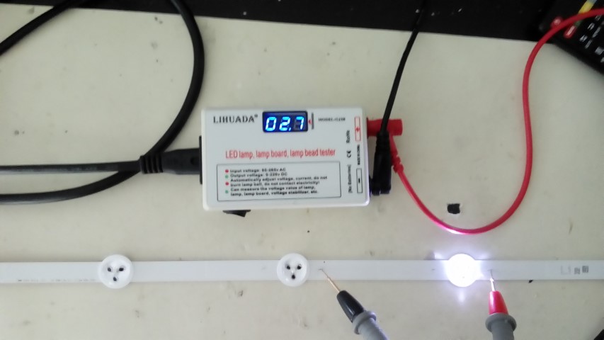

                    Hi all, I scraped and tested and I found one LED that refuses to light up, at the far end of one of the strips. Is it more practical to replace the whole strip as I don't have any equipment for changing LED's?
                    Any good sources for a LED strip quick delivery to UK?
                    Just to add a quick question for educational purposes, a stuck open LED means it failed in such a way that it opened up the circuit and now there's too much load on the rest of the LED strip circuit and the power supply is detecting excess voltage and turning off as a safety feature so the others don't blow?

                      With 7 years on those strips, probably best to replace all the strips, you could just replace one strip but usually when one led goes more follow close behind. If you didn't mind the job so much then you can save some money by just replacing one strip, be prepared to probably do it again tho, whatever you choose be sure to turn the backlights down to as low as you can tolerate to extend led life.

                                      Replaced the LED strip and TV is now working, thanks all, £12 fix
