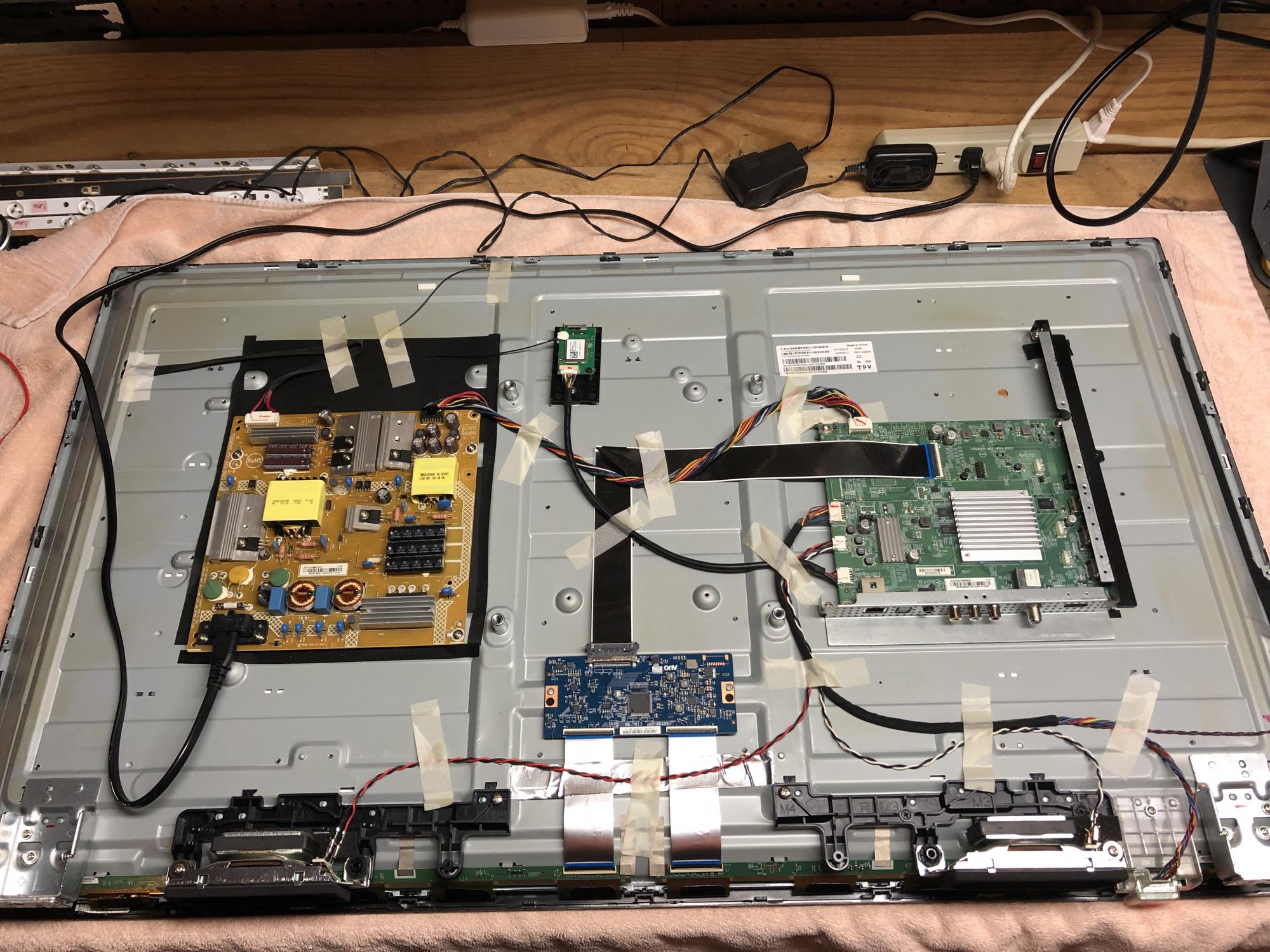

    I've got this Insignia NS-43DR620NA18 that has a blinking standby light after you push the power button (via remote or TV) but will not power on. No backlight, no image (flashlight test). I see that ShopJimmy offers a repair "kit" that replaces ALL boards but I'd like to try to pinpoint the exact issue if possible.
    The PS fuse has 120VAC going through it. No bulging caps or discoloration can be seen. The following voltages were measured at the PS connector with the wiring still connected to the main board. Voltages in parenthesis were measured after power button pressed.

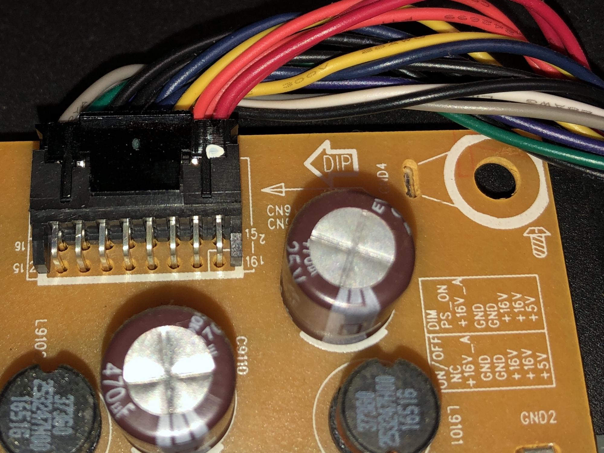

    I'm not sure where to go from here. It's odd that the two GND pins have 16.5v on them. Not sure if the board was misprinted or if there's something shorted to ground? I've also attached photos of the PS board (from ShopJimmy) as it's a clearer photo than I took, but mine looks the same.

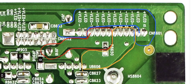

    A little update. I just went back down to my workbench and noticed that I’d left the TV plugged in for 10-15 minutes. I pressed the power button and I heard some audio through the speakers and then the standby light did two quick flashes with a pause between. Trying the remote, adjusting volume and pressing home button produces sound from the speakers. I was also able to verify that there is some words on the screen using the flashlight method.
    I measured voltage at the backlight connector. The +VLED pins have 27.9V on each pin. Tried with the wiring plugged in and unhooked. No change.
    I retested voltages at the main board wiring connector. The only change was the two +5V pins now read .3v

        Can we see the pictures of the whole backside of the TV showing all the boards?
        Please use attachment function to load the pictures, not using in line pictures.
        BTW, You need to verify your readings. Are you sure you count the pin correctly? For example, how can you have 16.5V on Ground pins?

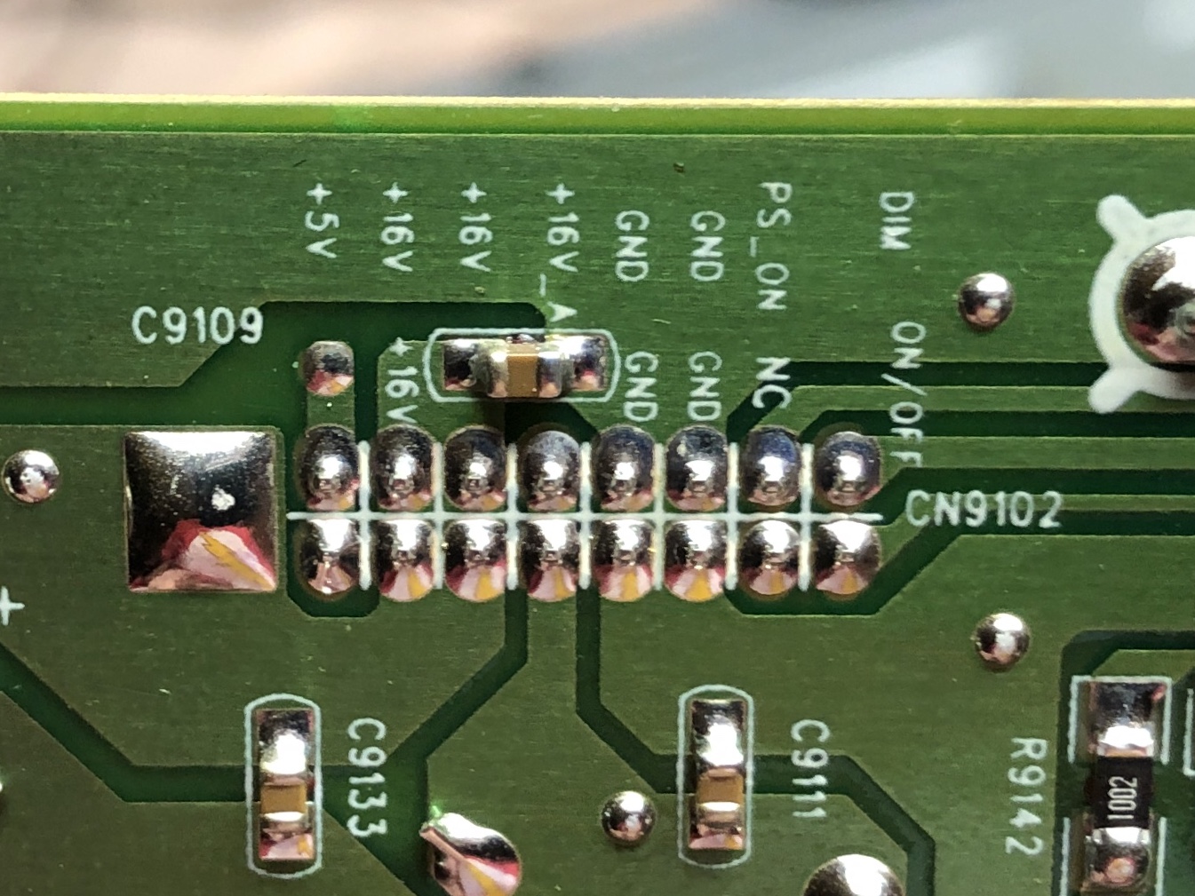

          So it appears that the markings on the top side of the board are wrong. Looking at the bottom of the board, you'll see that the two GND pins are next to the NC pin, followed by the +16V_A pins. The top side of the board is marked differently.

              1) Retest the connector using the label marked on the bottom of the board and report the readings.
              2) The 27.9V is the feeding Voltage to the Boost converter to boost the Voltage up high enough to bias on the LED. If ON/OFF control from the main board is not present then you will not have the boosted Voltage for the LED.
              3) Keep black meter probe on chassis, Red probe on the LED+ then turn the TV on while watching the meter to see how high the Voltage jumps up to before settling down to 27.9V.
              4) You should have LED strip tester to test the LED strips.

                Re: Insignia NS-43DR620NA18 standby light blinking

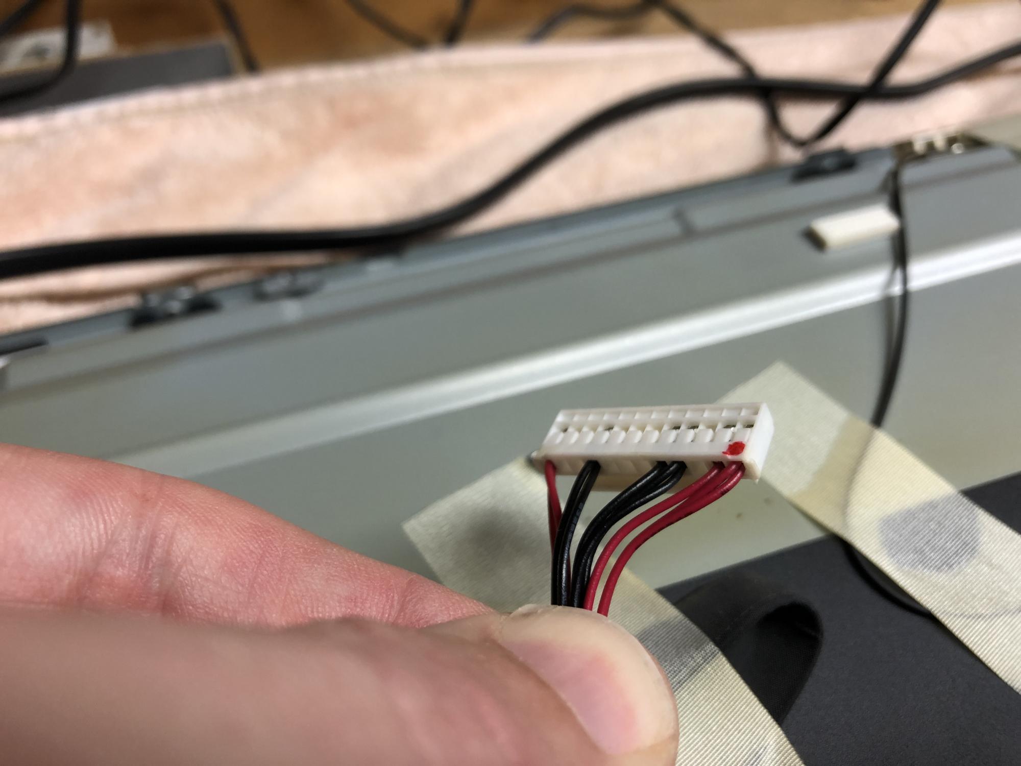

                BTW, I need closed up picture around the LED connector to see how many wires it has and what pins the wires are connected to.

                  Measuring voltages per markings on the bottom of the board is the same as before, but here's the updated labels.

                    So ON/OFF (BL-ON) and DIM control signals are fine.
                    There two sets of LED strings, the Anodes of each set of the LED strings are connected to the common boost converter output LED +, the Cathode (LED -) of each set of the LED strings are connected to U8505 and U8506 for maintaining the constant current through each set of the LED strings.
                    So:
                    1) Keep black meter probe on chassis, Red probe on the LED+ then turn the TV on while watching the meter to see how high the Voltage jumps up to before settling down to 27.9V..
                    2) Keep black meter probe on chassis, Red probe on the LED - then turn the TV on while watching the meter to see how high the Voltage jumps up to before settling down, you need to do this twice since you have two set of the LED strings.
                      +LED - 44.2V before settling at 28v
                      -LED1 - 0
                      -LED2 - 0
                      I’m guessing that I’m getting no voltage on either -LED pin due to one/many bad LEDs (open circuit) on one of the strips?

                        So LED - never jump up at all when TV is turned on, correct? It looks like you have open circuits in the LED strings. If you are going to do more TV repair, it will be good idea to have LED tester.

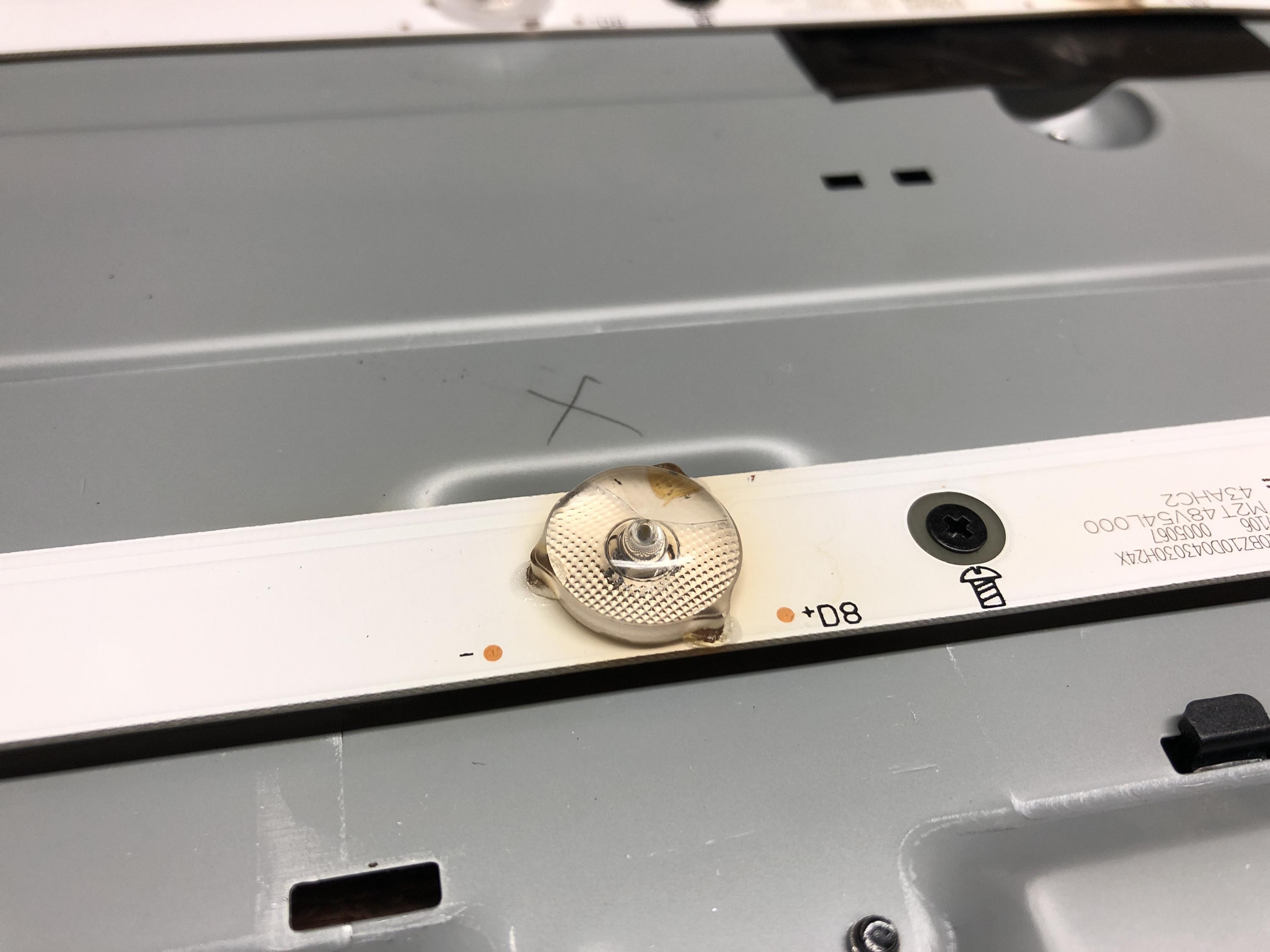

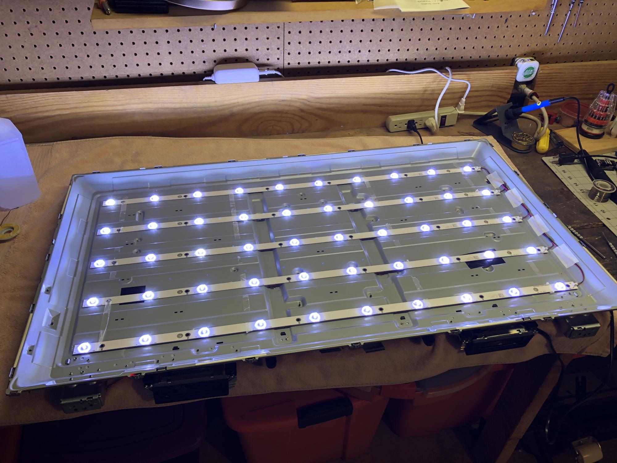

                          I pulled the panel and was able to use the diode/continuity setting on my DVOM to test each individual LED on each strip. There was a bad LED on each strip. I had some replacement LED's on hand from a previous repair so I went ahead and swapped out those 5 LEDs. I anticipate that another LED is likely to fail on one or all of the strips at some point, but this may get me along for a while longer until the replacement strips are back in stock at shopJimmy. The only indication that there's anything different is the slight discoloring from my hot air gun.
                          Thanks for the guidance budm.
                            That was fast! You should also set the backlights level to as low as possible to extend the life of the LEDs.
