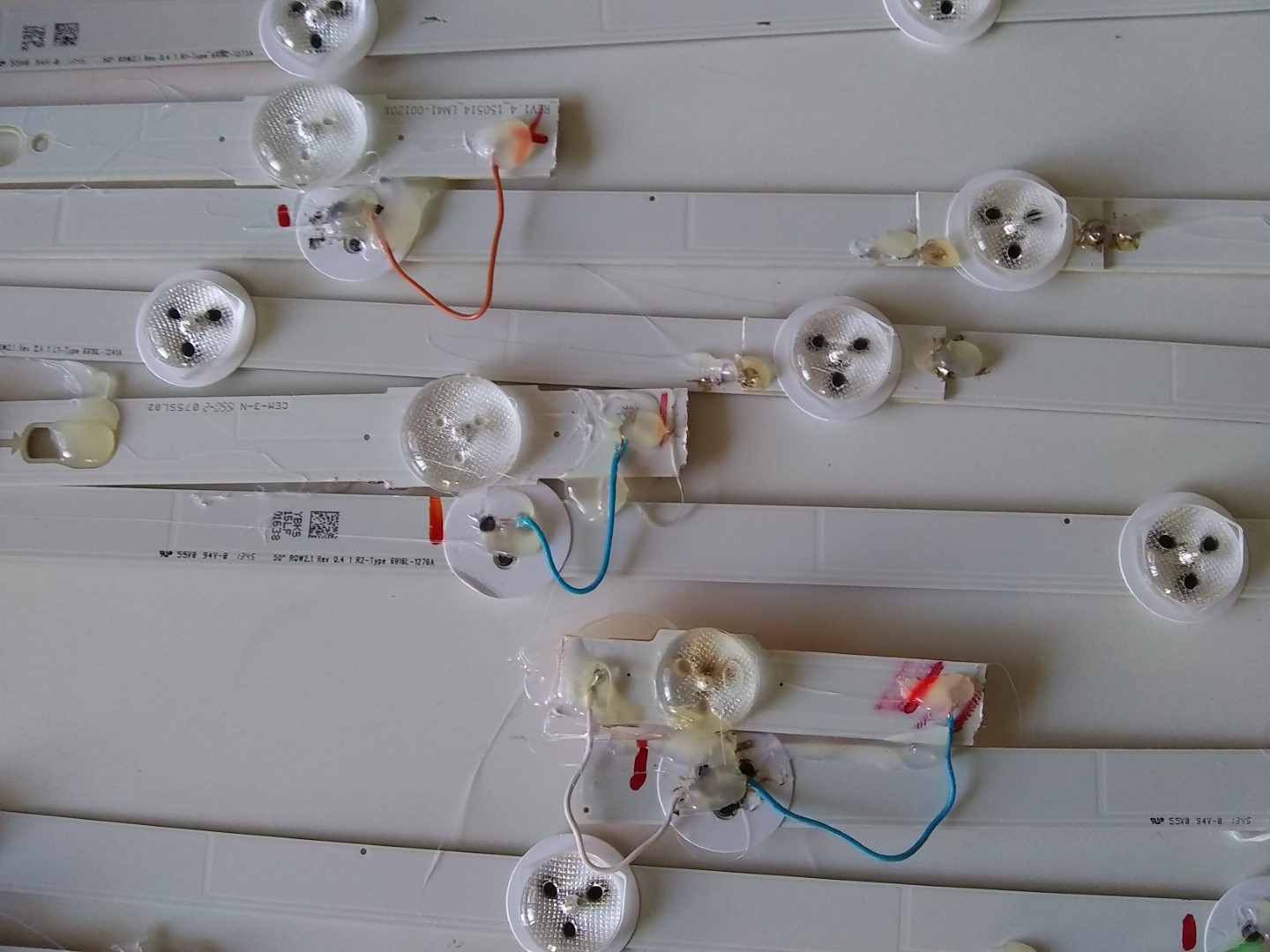

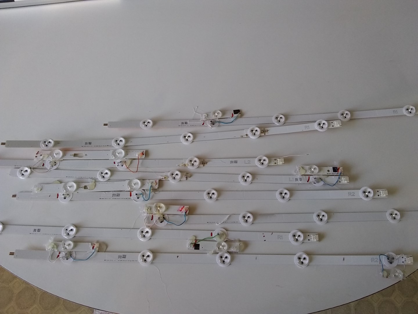

    Heard of the stacking method for LED repair. How about the side by side method.
    Looks like they repaired this just enough so they could flip the TV. Owner bought it used. Would have been less work to replace the strips. Had to patch all the holes in the reflector sheet. LG 50LN5750. Saved a diffuser panel for this one but not the sheet.

    Re: Heard of the stacking method for LED repair. How about the side by side method.
    That is such a shoddy repair I would never put my name to it.
      That is bad, hope I don't ever come across anything like that.
        I have also seen a 42LN strip installed in a 50LN. The narrower spacing caused the corner to be darker and I had to patch the reflector sheet which had new openings cut to fit the shorter strip.
          What a mess. Must have been smoking some of that legal weed. Shameful
