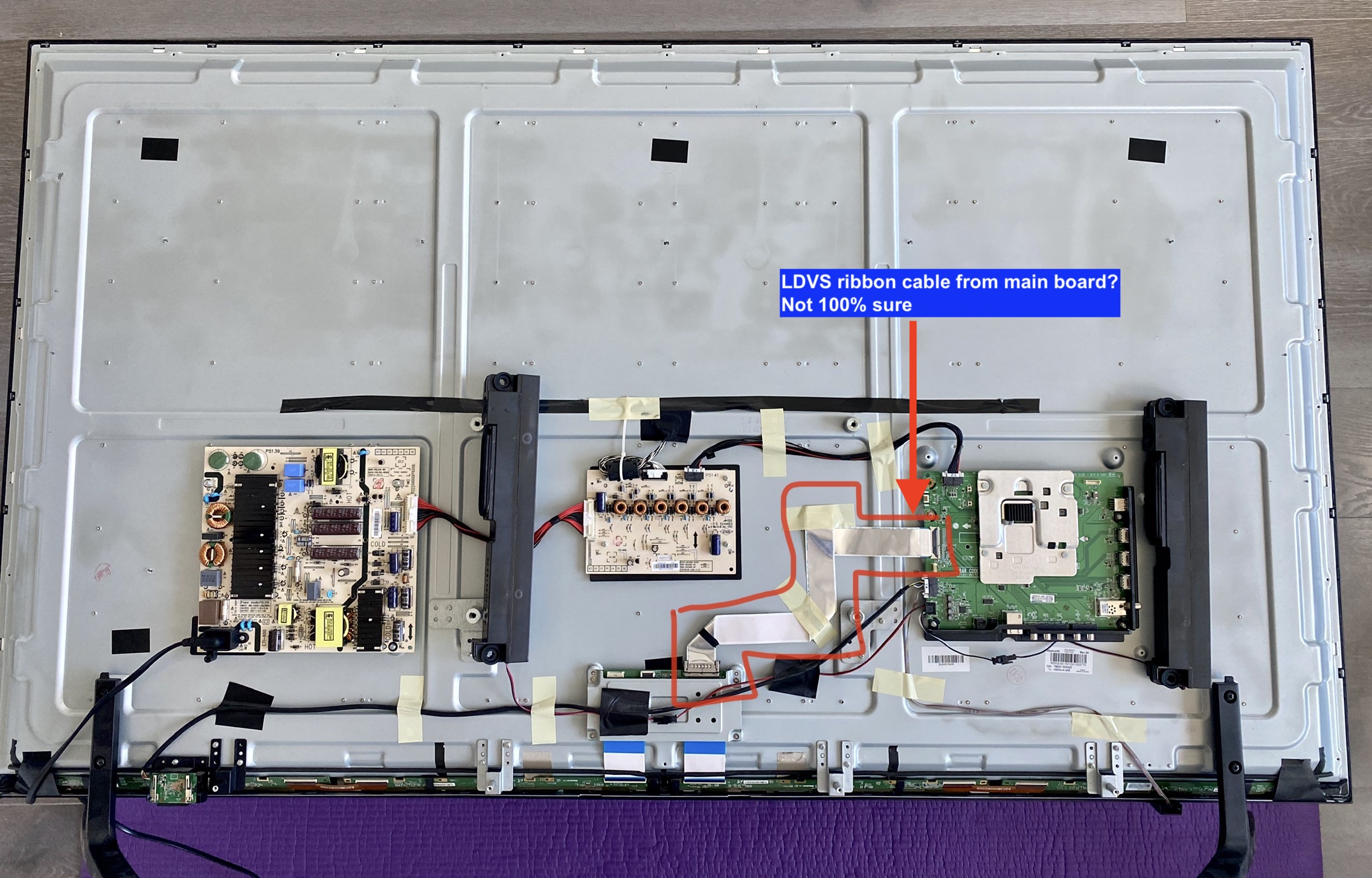

        ahhh have to work up the courage to swap from the working side to test. the guy from ebay shipped today hopefully those come in soon!

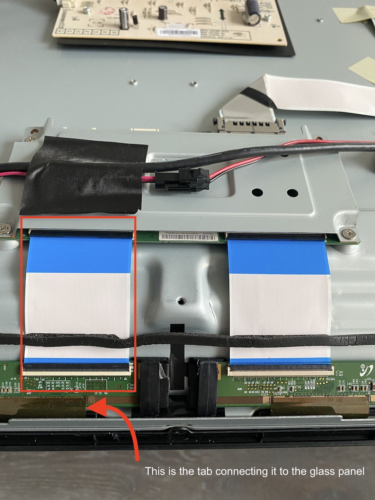

        • Diah
          • Feb 2013
          • 6435
          Re: LG 65UH5500-UA common problem?
          i don't think this pin the problem, see the tab of the effected side.. you may have U ribbon cable on it.. if yes then its just fitting it again,
          • hatinglgrightnow
            • May 2020
            • 24
            by tab do you mean the tab connecting it to the glass panel?
            • Diah
              • Feb 2013
              • 6435
              NOT this, on the board... take out the speaker and the metal cover of the effected side.. see are there U ribbon cable as its 65 it may have 2 or 3.. many UHD used U ribbon.. hope yours too
              • hatinglgrightnow
                • May 2020
                • 24
                There are no U ribbons that I can see. Only those 2 ribbons I showed and another ribbon that is not attached to the glass panel.
                Even after removing everything when changing the LED strips, there were no other ribbons besides the ones seen here. Moved the speakers in this pic.
                  of course you have U ribbon..i can see one on both side its the brown color you may have another one hidden on the photo... this U ribbon.. seat them correctly on the effected side
                  edit i marked them on yours photo

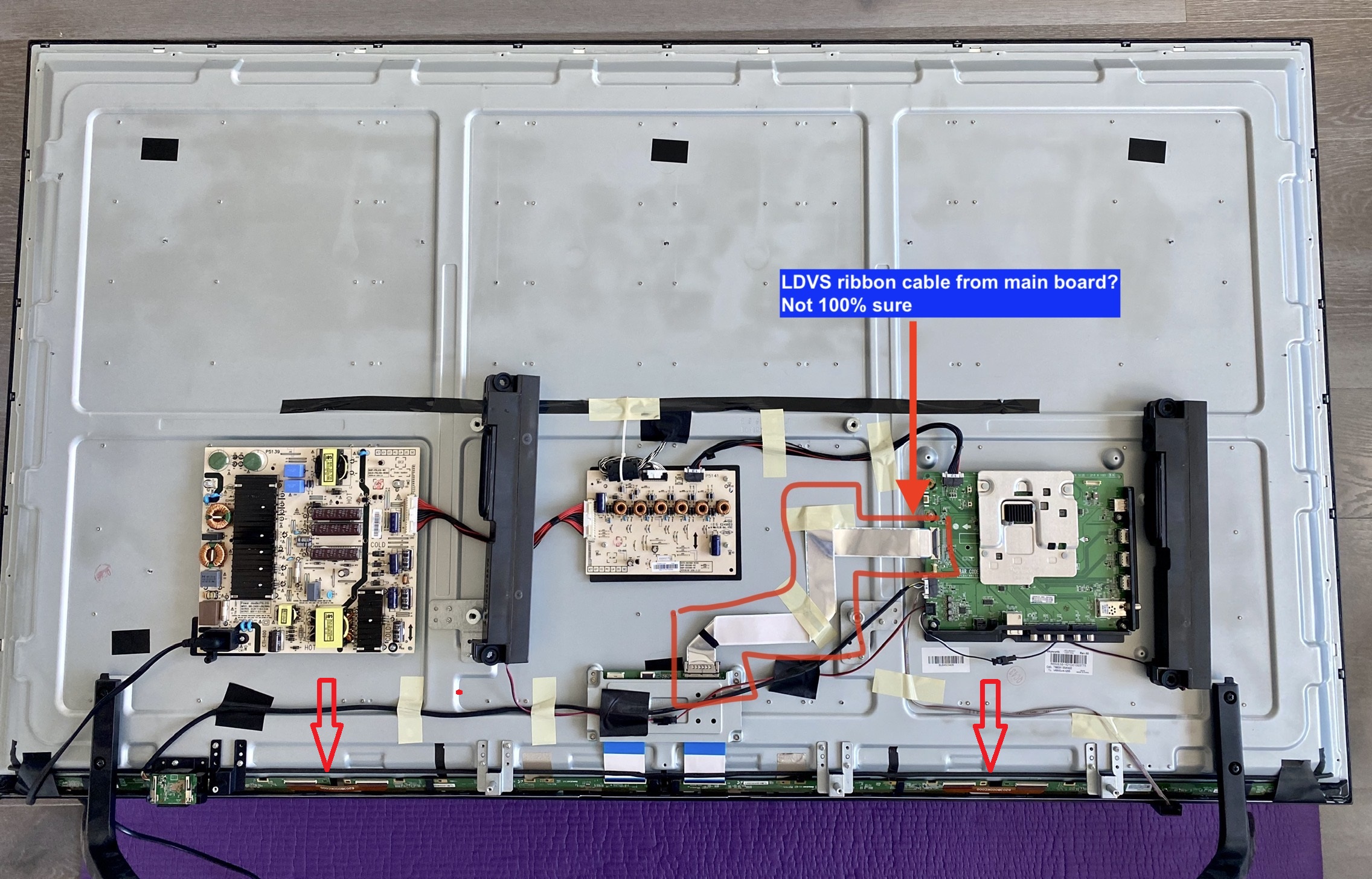

                  • dick_barton
                    • Aug 2015
                    • 6643
                    • Wales
                    #29
                    U ribbons see photo
                    • hatinglgrightnow
                      • May 2020
                      • 24
                      #30
                      Thank you for marking them! Yes there are two of them none hidden, I will try to mess around with them.

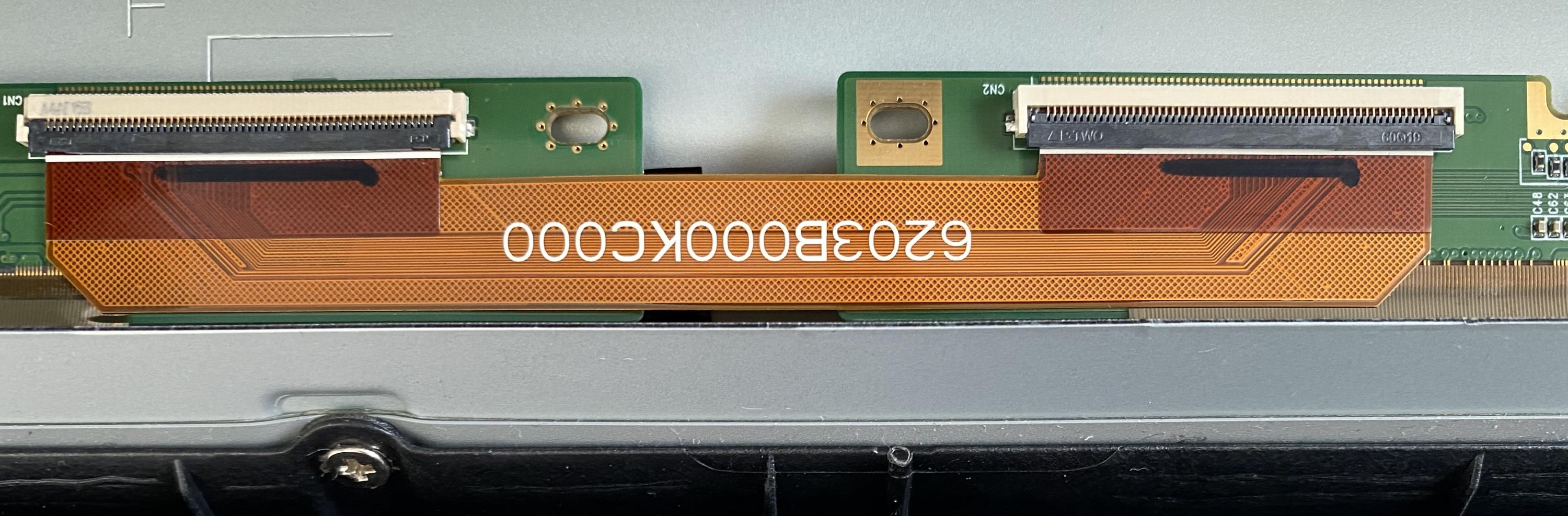

                        • hatinglgrightnow
                          • May 2020
                          • 24
                          #32

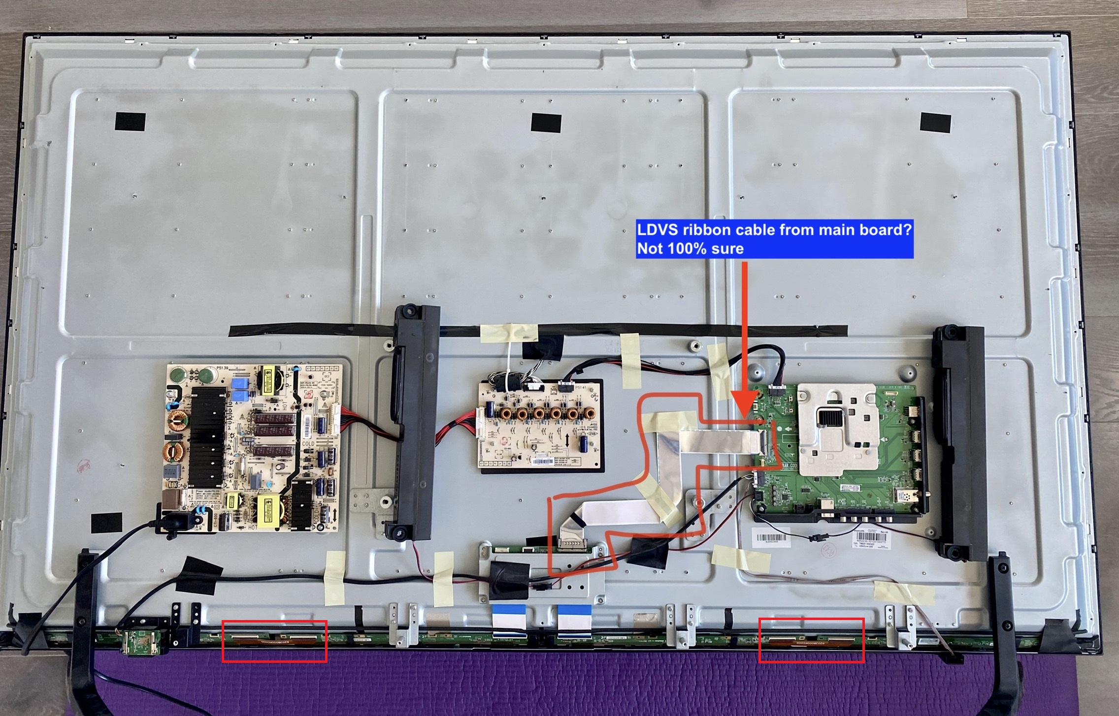

                          Just tried switching the ribbon from the side that was working to the defective side and same result
                          I will try messing with the U-ribbon on the side that is defective.
                          Hope it works.
                          I should probably return the ribbons I ordered from ebay then right?
                          • hatinglgrightnow
                            • May 2020
                            • 24
                            #33
                            Here is the U ribbon of the defective side, how can I seat it correctly? It looks to be in properly, I never took them out when replacing the LEDs.
                              you need to provide a better picture of the bottom edge board on the side showing the gray vertical bar so the forum can see how that side is interconnected. As pointed out, the "U" ribbon cables interconnect the bottom edge boards to complete the drive paths. However, on sets of this size, there may also be side tabs and / or side edge boards (similar to the bottom one) that also might have some interconnect cabling.
                              further as a test, you can disconnect the "u" cable on the "bad" side, you should then see about 1/4 quarter of the picture go white (or black) depending on design... including the grey area should be "gone".

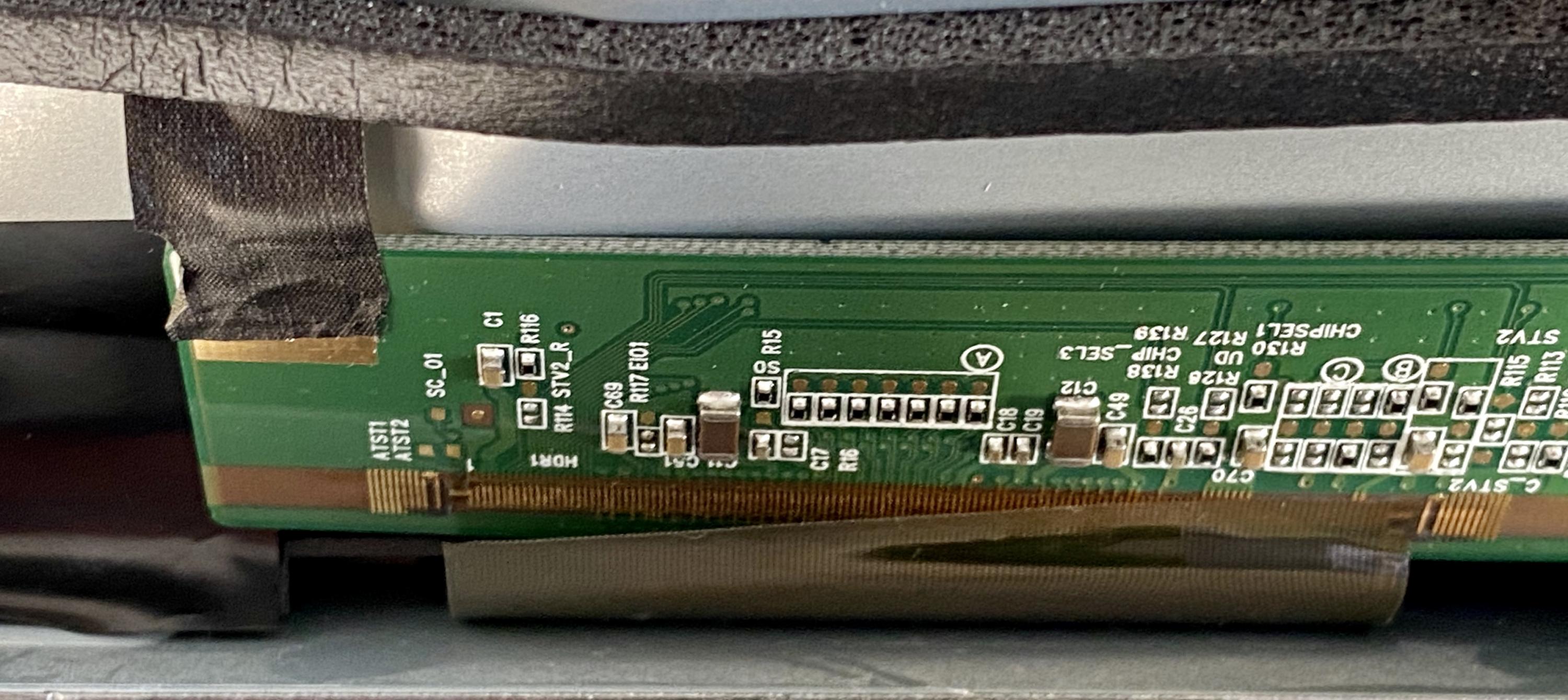

                              • hatinglgrightnow
                                • May 2020
                                • 24
                                #35
                                Oh man, think I just found the culprit
                                Removed the tape to see the driver board on the defective side and about 3/4 of that tab is lift off the board.
                                Is there anyway to fix this or am I a goner?
                                • budwich
                                  • Jul 2015
                                  • 3097
                                  #36
                                  yep that's the problem... others may have some ideas.
                                  • budwich
                                    • Jul 2015
                                    • 3097
                                    #37
                                    what ever you do, don't take it any further off as right now it is basically holding "alignment"... you might get lucky by very carefully cleaning what you can and possibly holding it back down with something.
                                    • hatinglgrightnow
                                      • May 2020
                                      • 24
                                      #38
                                      Yeah that is what I am thinking. But holding it down with what? Tape would work? People seem to be using ACF bonding tape. And what to clean it with?
